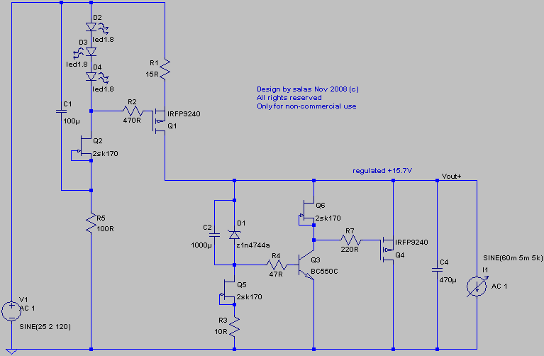

Guys, there's something that I haven't measured, which is using LED's instead of the zener, without a bypass cap. If you guys test that please let us know what results you get. I forget in which thread I came across a function to add the noise of each LED when using several in series. Something like sqrt of the sum of each led noise squared... but I don't remember exactly. In any case, the noise is additive. The question to be answered is, how many LEDs will it take to make the noise comparable to a zener?
The addition of noise in a led series is sublinear. I.e. Not so bad, but then again more. Gotta know the particular Zener and the number of leds so to compare. Up to 10-15V, leds are a manageable number and mostly preferable between 6-10V where Zeners are bad due to their physics.

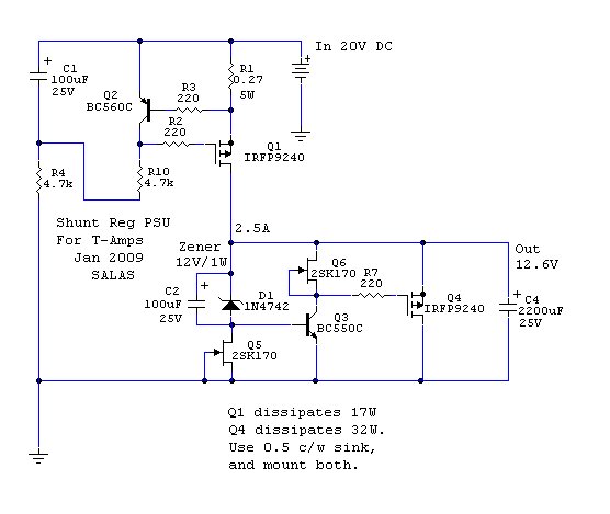

Ok, I started to begin a V1 build yesterday but then realised I had a couple of different schematics & options. I was missing some parts such as BC550C & BC560C. I also realised that I don't understand the operation of the circuit & couldn't make informed decisions on substitutes for these parts.
I'm initially looking to build a high current (up to 3A) 12V & 19V version then I wanted to try a V2 version for 5V DAC powering.
So, at the risk of repeating information that has already been posted here, could somebody give a brief description of the operation of the circuit, the options for low current & high current usage, the options for low voltage & higher voltage operation?
I started with Iko's schematic attached but realised I hadn't any BC550C or BC560C but had BC546C & BC556C which might substitute? I then saw another version that used LEDs instead of upper BC560C but don't know how much voltage these should drop or if they can handle the high current I need. Salas posted that approx 3k or 2k2 could be used in place of the zener for the voltages I needed.
Generally, I ended up chasing my tail - I need help to get a handle on this

Have a look at post 1191, that's the version with LEDs.
You can change the output voltage to what you want with a different zener. You can expect the voltage to be the zener voltage + 0.6 approximately.
For the LED version you only need one npn, the bc550c. If you have access to mpsa18, that works well too. bc546c should work, but if not ideal.
To set the CCS current make R1 small. The actual value will depend on the voltage drop across the LEDs. I usually start with a small current and small load to rule out any mistakes in the circuit. Then increase the current in a few steps. You could start with a 200R resistor as load, and 10R as R1. Then make R1 smaller until you get the current you want. Do not underestimate the need for heat sinks. At 2-3A you need to dissipate serious heat.

Remember you can always optimize it later for low noise and all that. If the zener is bypassed by a 1000uF cap you're left with very little noise; it takes some effort to beat that.
R4 and R10 are part of the CCS biasing. C1 further lowers the psrr; it's a trick which Walt Jung has used at some point, and I'm sure many others.
The main element of the CCS is the mosfet. The LEDs are used to drop the voltage so that there is a particular and ideally fixed voltage difference between the gate and source of the mosfet. But you see that it's hard to control the value of this voltage difference only with LEDs, because you can add or remove one LED, which takes away or adds about 1.8V, or 2V, depending on the type of LED. So the LEDs are for a rough choice of Vgs voltage, and then the finer setting is done with R1.

In the top CCS LED version are the LEDs expected to drop the input voltage down to slightly above the expected o/p voltage?

I can use 6 to 15 ohm in R1 along with 3 LEDs for a low current version to start with - I'm confused again, though, as in your schematic for the Tripath (below) you show 15 ohm for R1 but this would be a high current version?

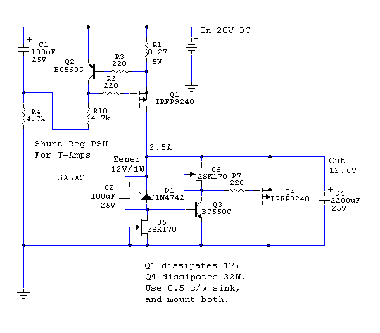

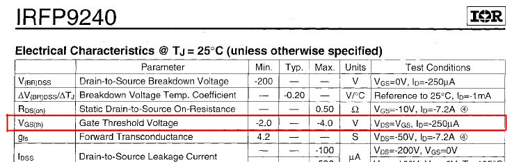

What VGS value are we aiming for across the IRFP9240? Does this vary depending on what voltage/current we want or is it not just a threshold value above which the Mosfet works?
Given that I get a prototype working how do I calculate what value 5W R1 I need to order to get the current I want - let's say 2.5A?

About 1R 5W, most likely a little less given the tolerances. Post 1219 says how and is only one page back!!! And has been said so many times before! These are hands on circuits, dead simple. Put one together, start doing simple measurements on a dummy load. If stable, connect the amp.

Vgs is batch and V&I related, not given. I have seen between 3-4V in such regs.
