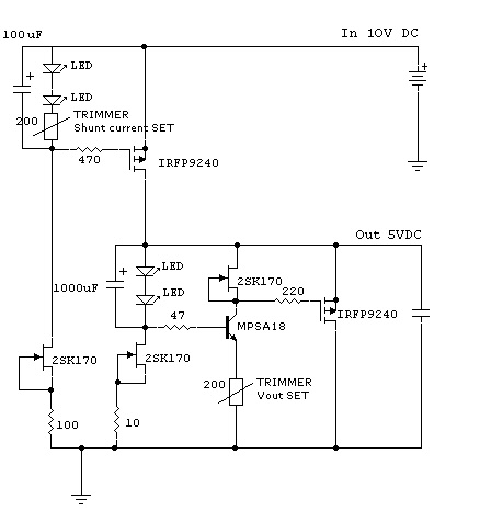

I read that MPSH81 (PNP) is to replace BC560C (PNP) in v1. This is for the neg rail. What is to replace BC550C (NPN) for the pos rail?
I am not recommending changing v1.
I will be building both. Iko, thanks for posting those schematics and simulating v2 for me. They are for 15.7V rails. I am using SOIC opa627s on browndogs and even the top one runs a bit hot on +/-15VDC and I can imagine the one soldered underneath the browndog may get less heat dissipation. So for +/-15VDC rails I prefer to go under instead of higher. I think I can use exactly the same schematics and component values you posted, only with the 1n4744 replaced with 1n4743 (v1), and 1n4737 replaced with 1n4736, to get about 13.6V instead of 15.7V, to reduce the heat on the opa627 for some peace of mind. Have you got an existing PCB design for v2? If not, I could use ExpressBCP to draw one in reference to the PCB layout of the existing v1.
Thanks,
Bill
That's right, all you need to change is the zener value to go a bit lower. As far as pcb goes, I built all my prototypes without a pcb. I'm working on one, but it's not finished yet.

+5V adjustable V1![]()
You can se here:
http://www.diyaudio.com/forums/showthread.php?t=143693&page=122

Did it get to improve with use and / or MPSA18?
Very difficult to make direct & fair comparision BC550 vs. MPSA18. Soldering/desoldering take time & sonic impression get lost. By my humble personal opinion MPSA18 is better.
More audible is capacitor C2 (see post #745).
I like there big value film capacitor, not lytic. Or lytic bypassed with film. Value depends on personal preferences, between 2.2uF and 2200uF
