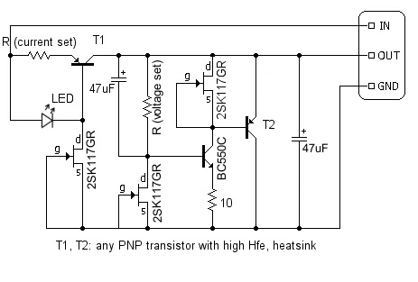

for low voltage input (like +5V) and low voltage output (+3.3V and lover) this shematic can be used
attachment.php
attachment.php
thanks Stormsonic i'll put this in the file too
