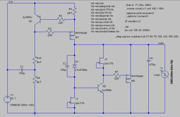

Dear Salas,
seems that your regulator works fine for many people, so this question might be superflous, but it has been nagging my mind for a while:
The 2Sk170 JFET, J1, in the attached schematic has only about 0.7 V (Ube of Q2) as Vds. Will J1 then really operate as it should, ie as a CCS, as J1 is in its linear range instead of in its saturated range?
Should Vds not be several Volts for J1 to work as a CCS?

That question has been replied before in this thread. But obscure to find anymore. 2SK170 has small -Vto (pinch off). -0.4 to -0.5V for BL. Lower for GR. With 0.7V positive Vbe to nest in, it gets over 1V VDS, more than double pinch off, not only to work, but to work steady, since it satisfies the double pinch off rule of thumb. It has low self noise as a part too, and enough IDSS to grab a Zener or some LEDs. Higher pinch off parts would demand a voltage lift of the error amp's emitter and AC decoupling for that, not to degenerate it and lose much loop gain. More parts and audible caps, less potential for working near to Vgs as in shunts for DACS.

Yes, the 2Sk170 is indeed one of the best JFETs around, and still easy to source.
Thanks for the reply!
