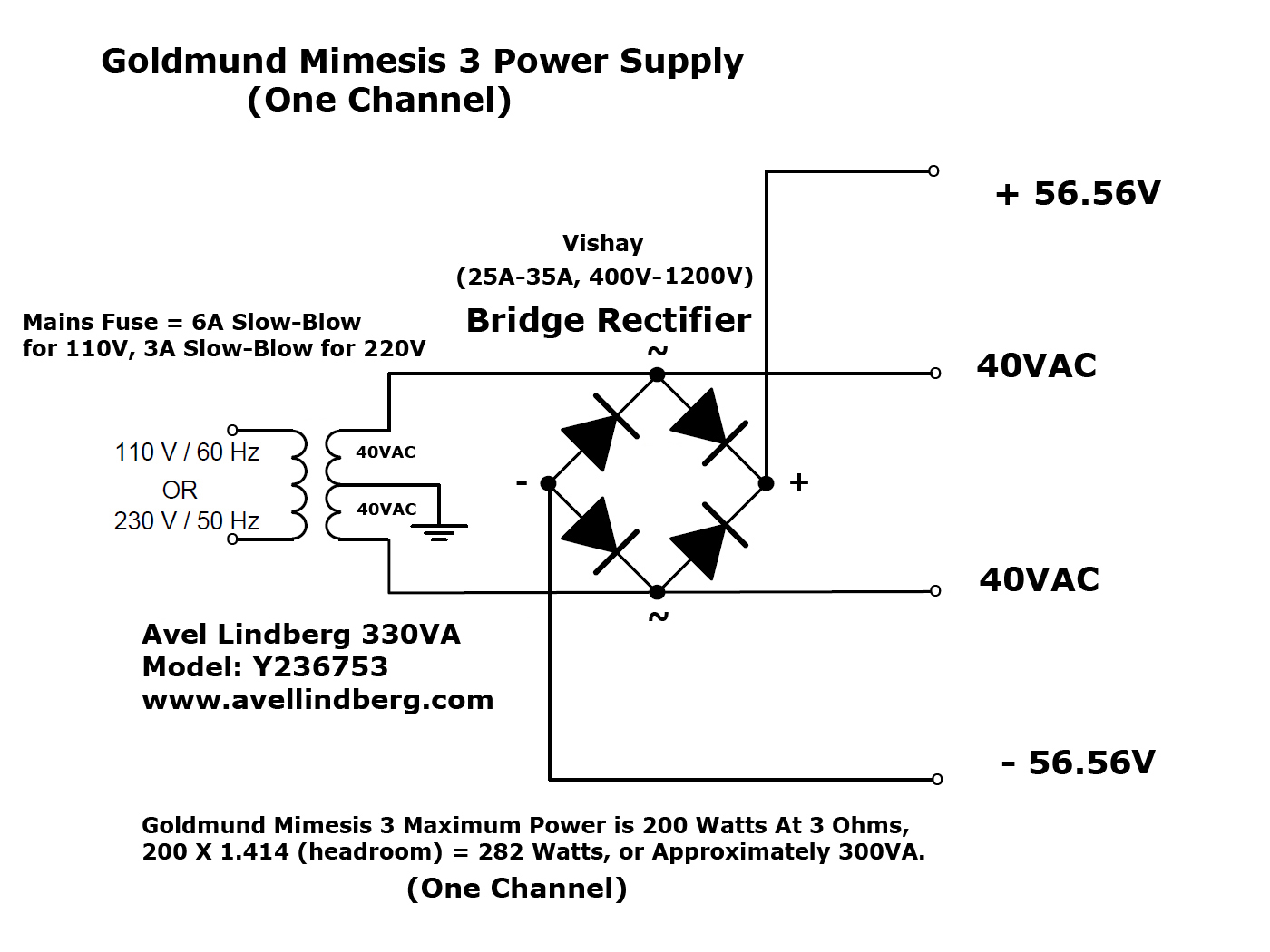

Power in device=[Vcc-Vo.sin(wt)]*Vo.sin(wt)/R
This is the difference between the power supply voltage and output multiplied by the output current.
Calculate this for a half cycle. Each half cycle will be the same but split between the output halves.
However, the worst case dissipation will be for a square wave with Vo=0.5Vcc.

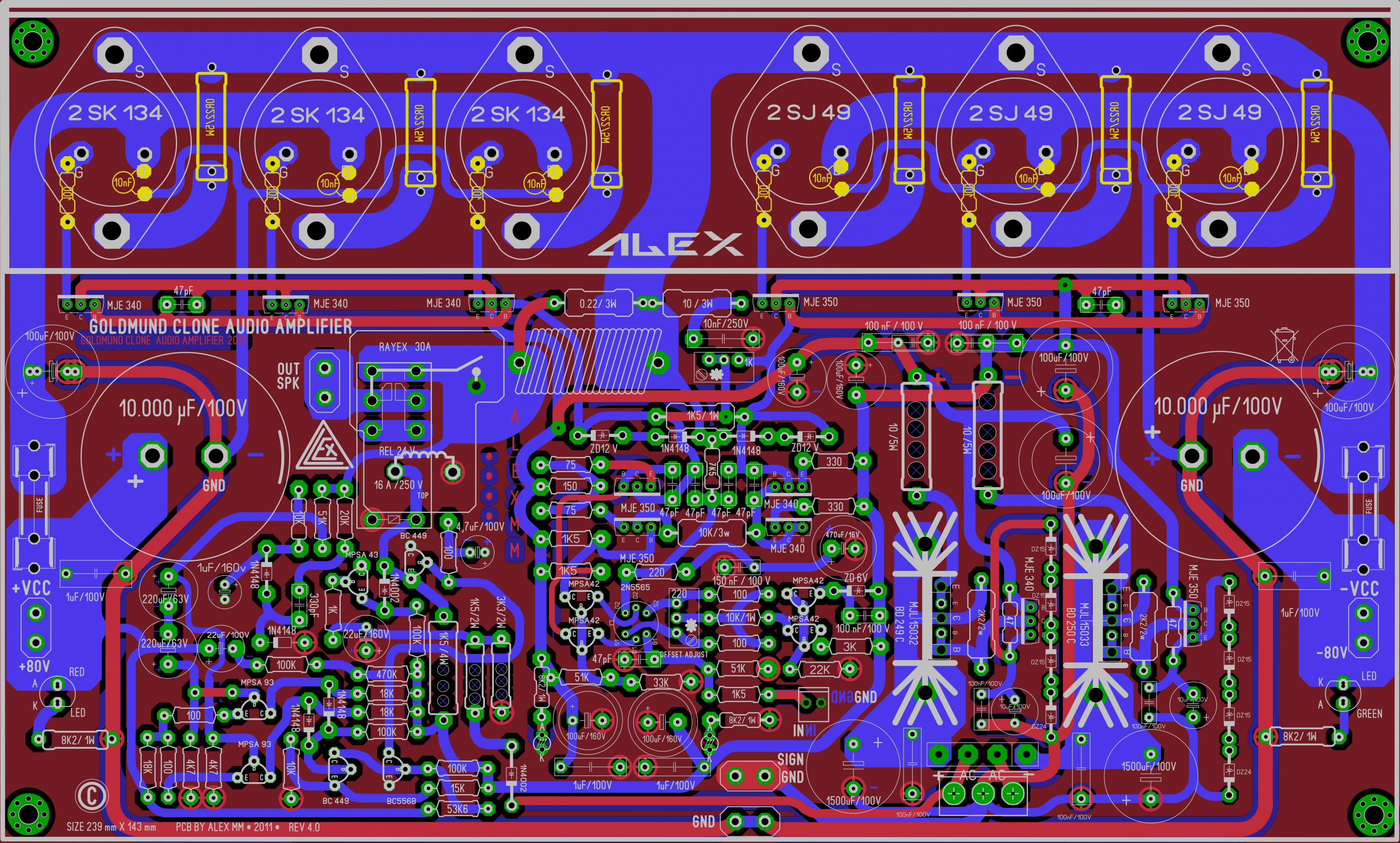

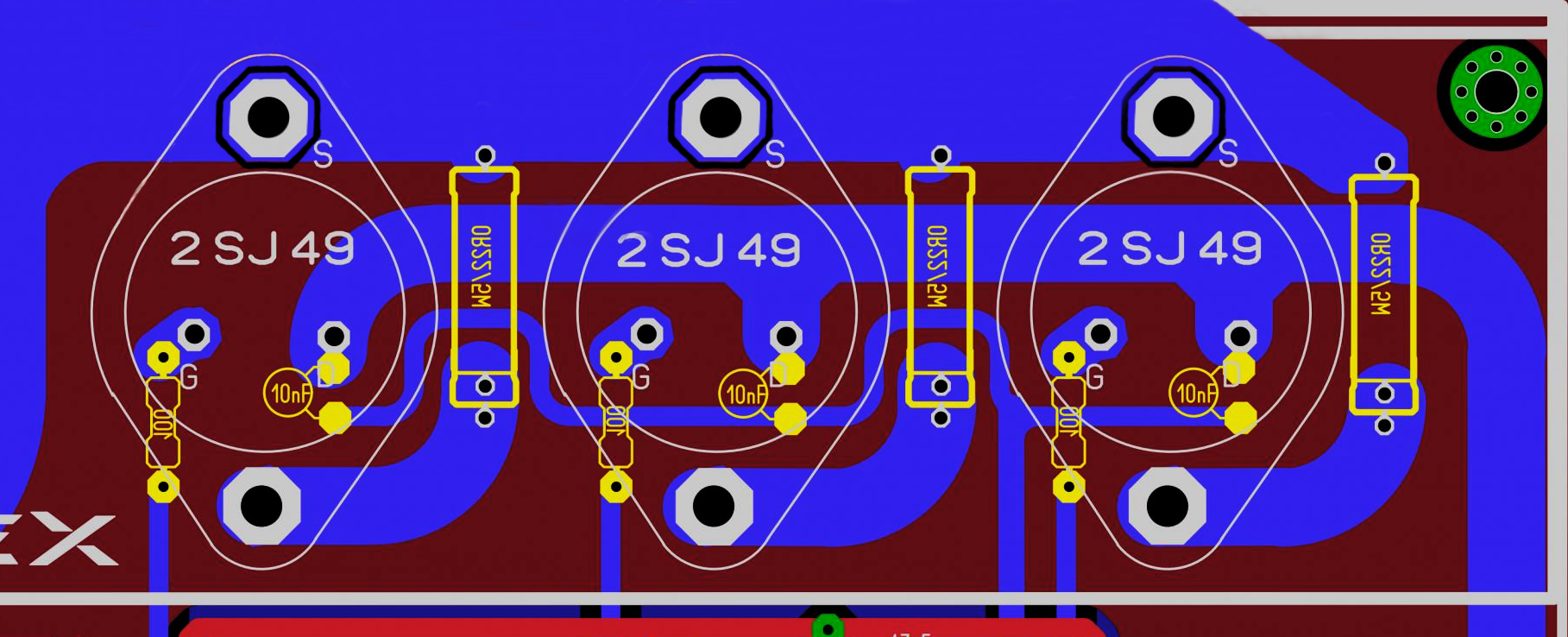

OPs - Source Resistors ?
Hello Alex,
You really perfecting Your Art . . . 🙂
How the 0,22R resistors can perform theirs duty if shorted?
Maybe this way they should become effective?

Hello Alex,
Best Regards,
Andreas

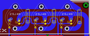

Hi Smilay 09 ,
What will be ,if you use screw ,with plastic insulator on top side of TO3 output transistor ?
This way 0.22 R are not shorted .......
Regards,Alex
Regards,Alex
+ SCHs
Great,
Both options are are fine, maybe without the xtra centered plastic washer is also a good option... 🙄
Beautiful Art Layout You made, did You actually made this Amp from the Post #2568 ?
BTW to which SCHs is this PCB Layout referring to? or simply Maybe You can also attach the related SCHs here
for the potential diyers to build this AMP attracted by this Layout 🙂
Best Regards,
Andreas
Hi Smilay 09 ,
use screw ,with plastic insulator on top side of TO3 output transistor . . .
Regards,Alex
Great,
Best Regards,
Andreas

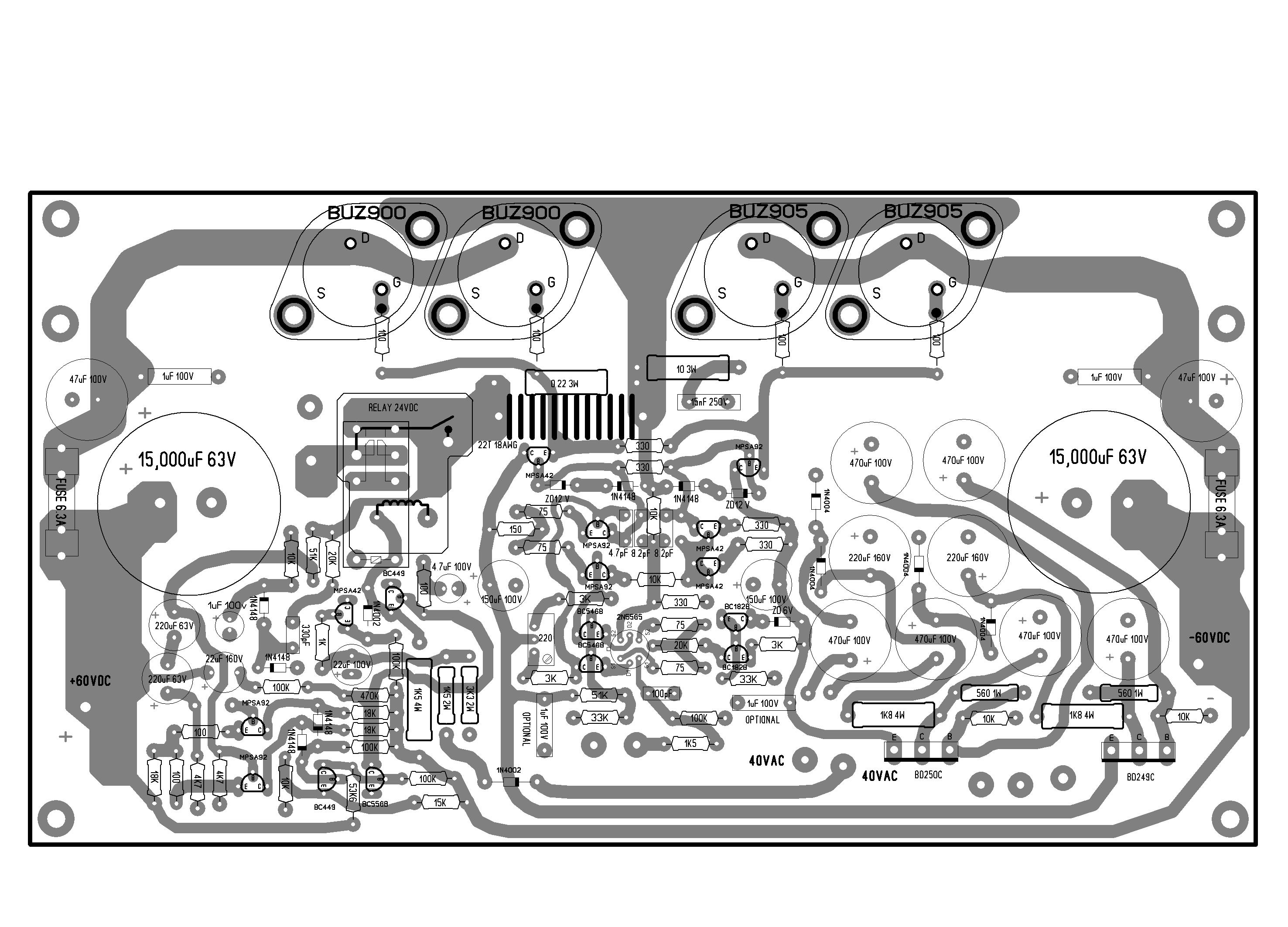

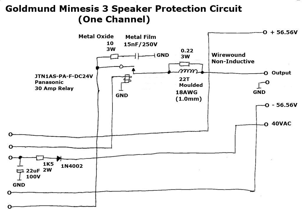

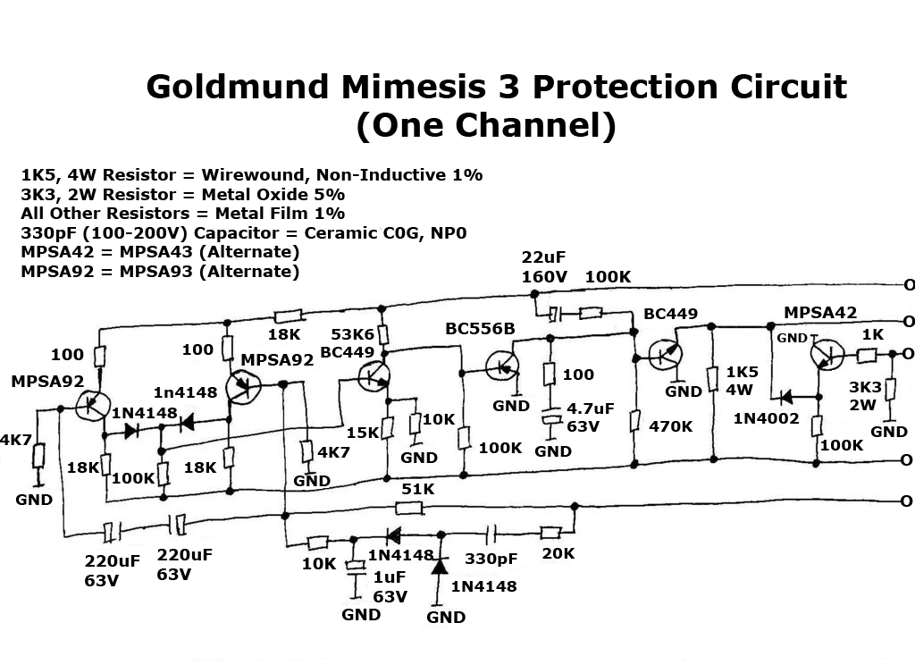

Hello nikosokey, hope everything fine !
I followed your advices and of course always kind. Unfortunately not everybody shared information correctly and many guys like me, following all the schematics, etc. couldn't join reliable information.

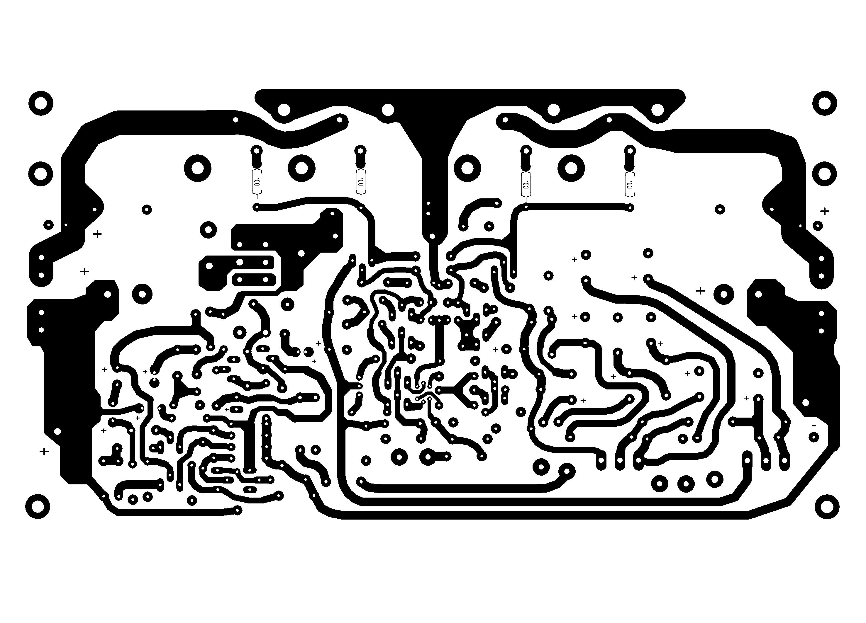

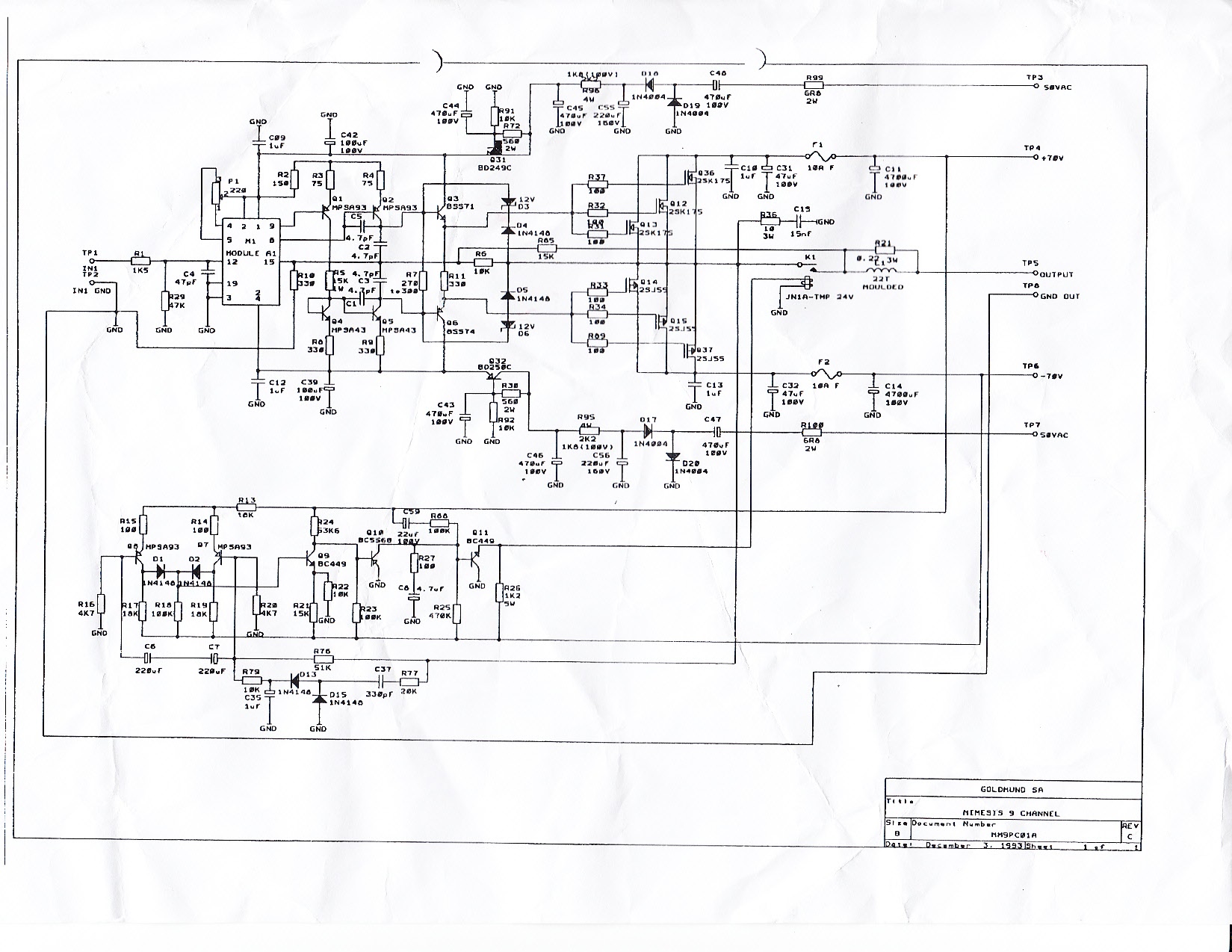

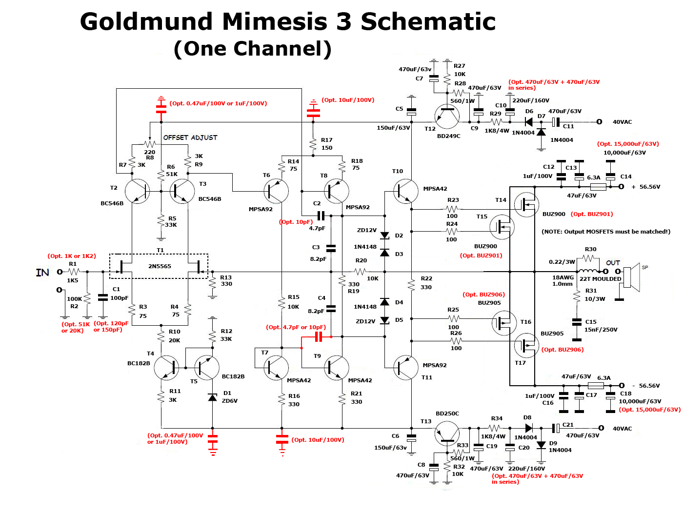

Again, I will attach the schematics and PCB I am talking about. Very little information and a complete mess of new projects mixed up with the original proposal, affected the possibility of building this amp.
I invite you to see the new thread in which I am trying to reconstruct this information and later place it on a Wiki, if possible, sharing it with everybody in complete detail.

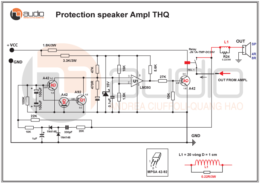

In post #1 of this new thread you will find a complete list of vendors of the most relevant hard to find parts, my original schematics, original 2 pair of output MOSFET's PCB, and also a new schematic that tries to put together the protection circuit that originally came untidy and hand written.
Despite any efforts done I could never get somebody help me with this circuit related to the original schematic posted by NagysAudio with 2 output power MOSFET's.
So when you say that everybody can follow the schematics and indications will have the elements to do the job right, please kindly tell me if you are talking of the version I am attaching here.
Goldmund Mimesis 3 Final Protection Circuit Schematic 2.jpg164.8 KB · Views: 1,601
Goldmund Mimesis 3 Final Protection Circuit Schematic 1.jpg262 KB · Views: 1,739
