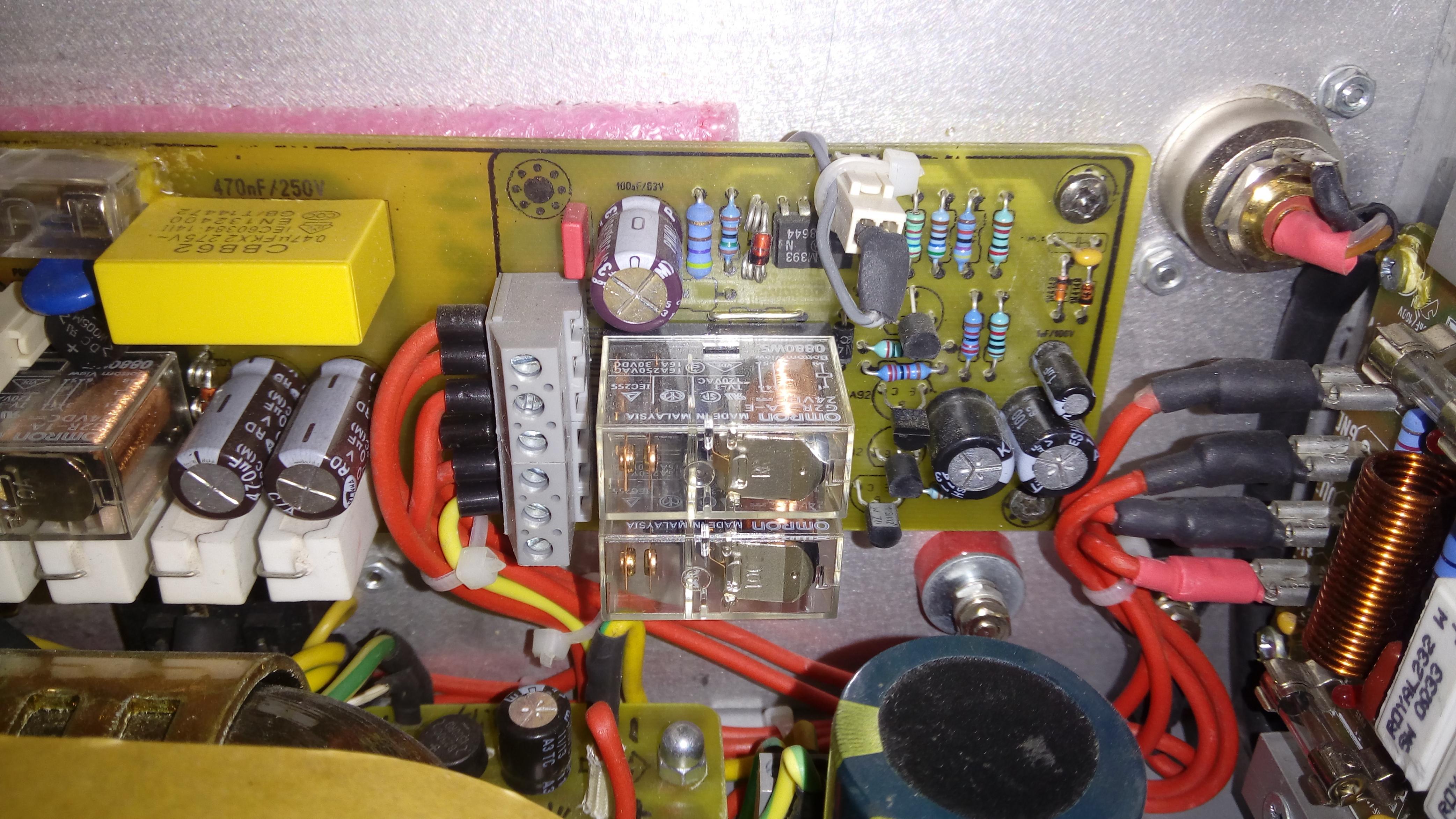

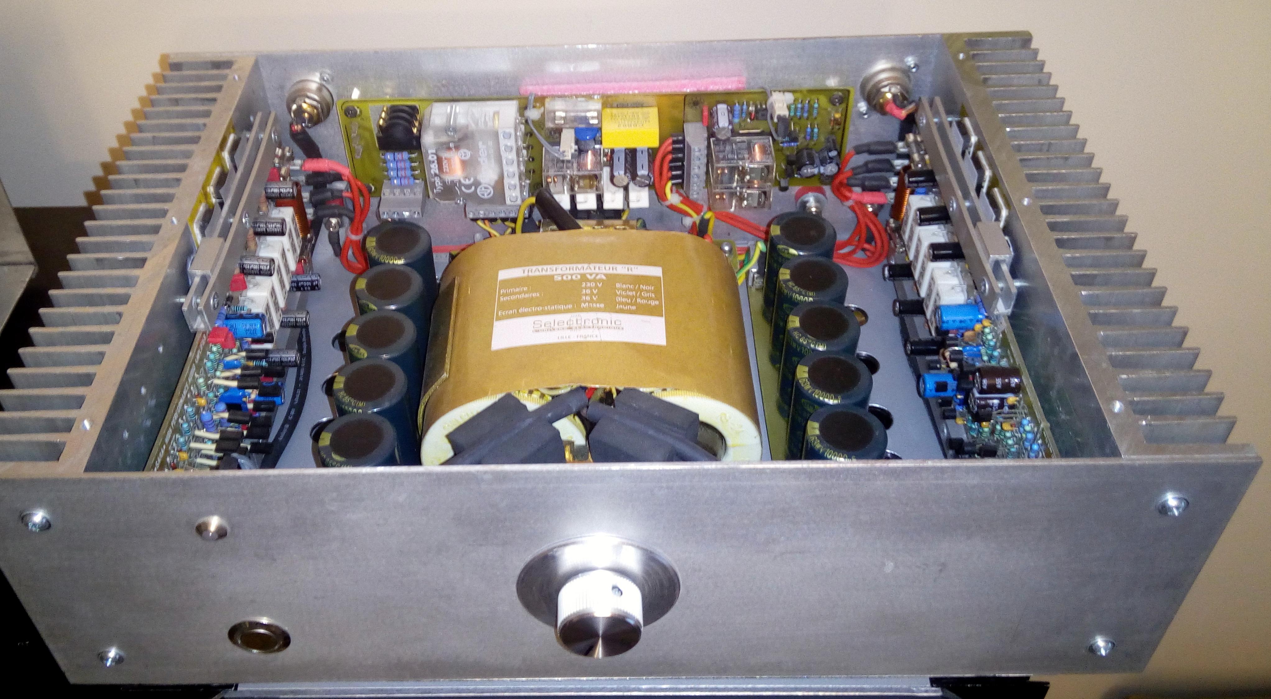

Have used, this protection in SARA amplifier with success :)
PCB attached ;)
Regards ,Alex
