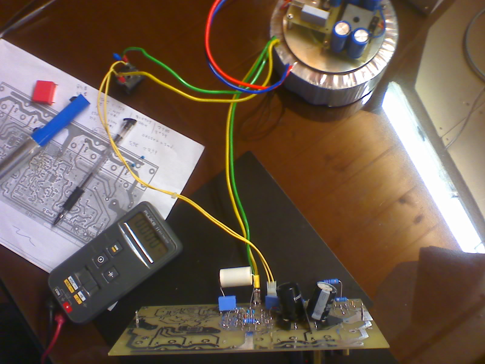

Golmund clone
2N5565 Motorola
BC 546B National
BC 182B Motorola
MPSA 93-43 Motorola
BSS71-BSS71 Motorola
Double Voltage
Positive rail 84.05V
Negative rail 82.03V

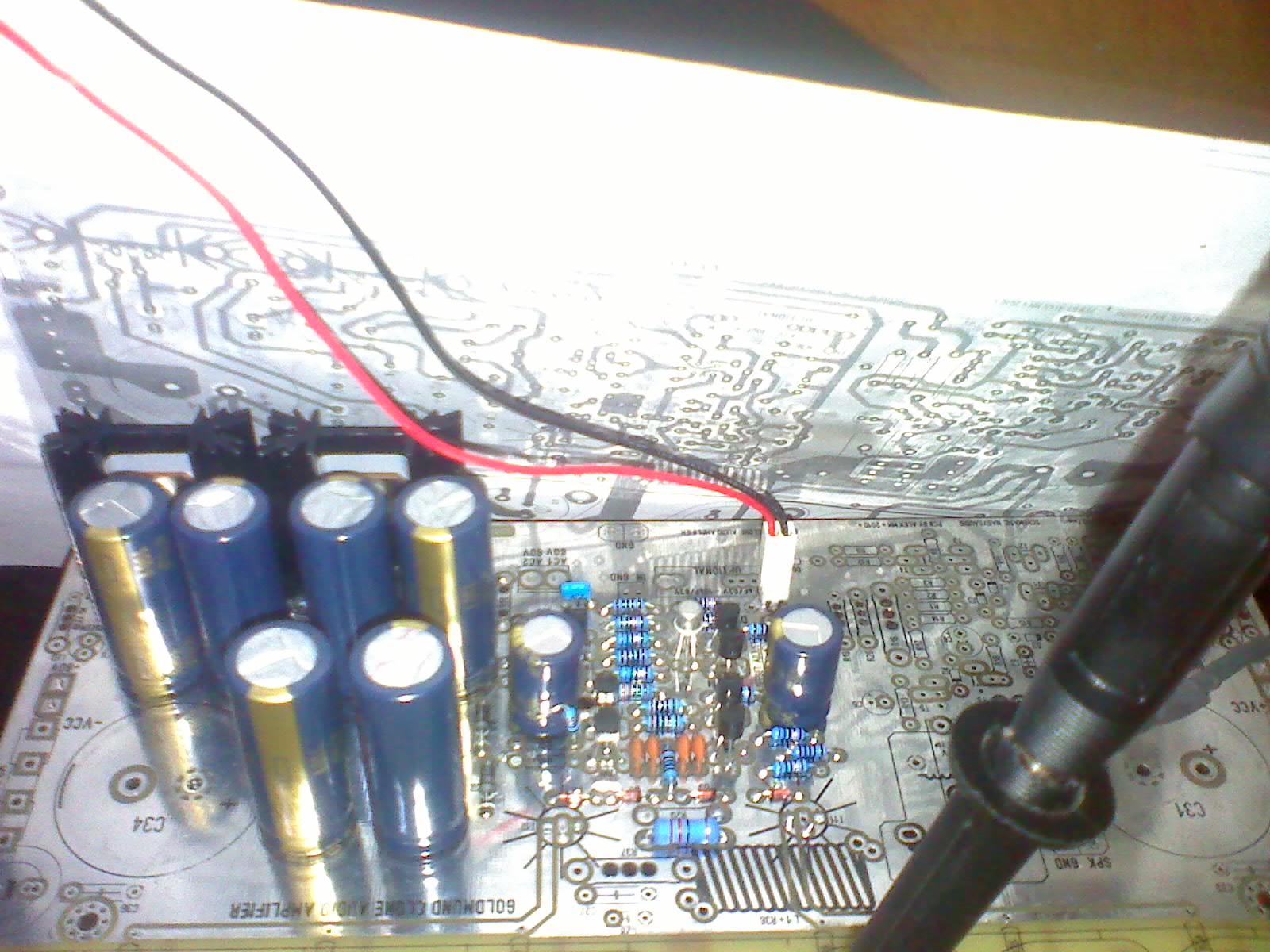

Pre-flight test joint R21 on Vas stage T8.
T11-12 out of board
Offset=0-3mV
R1=3.177V
R2=3.180V
R3=74mV
R4=76mV
R5=6V
D1=5.96V
R16=980mV
R14=481mV
R15=496mV
R17=2.090V
R18=2.200V
On resistor R23=1.8V

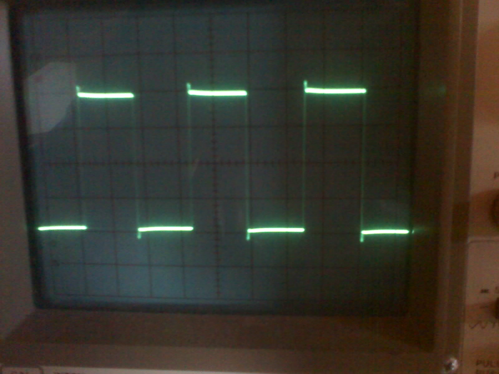

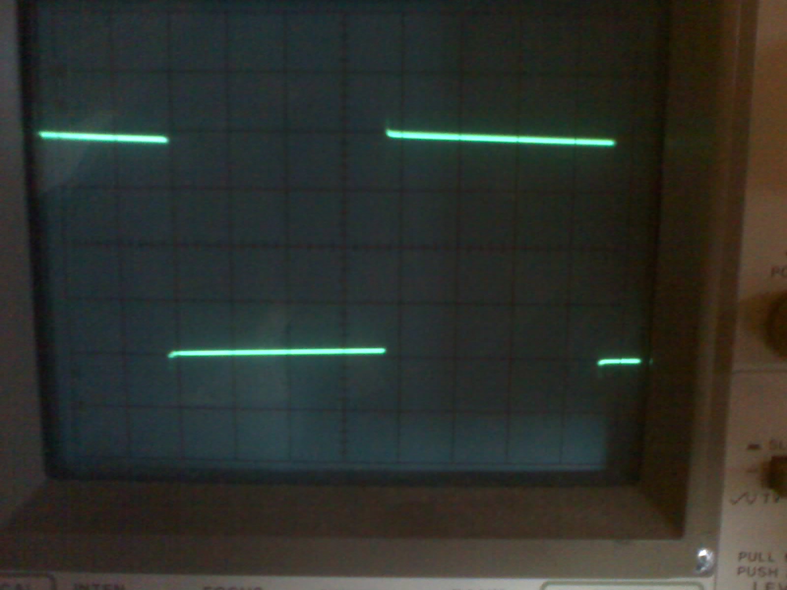

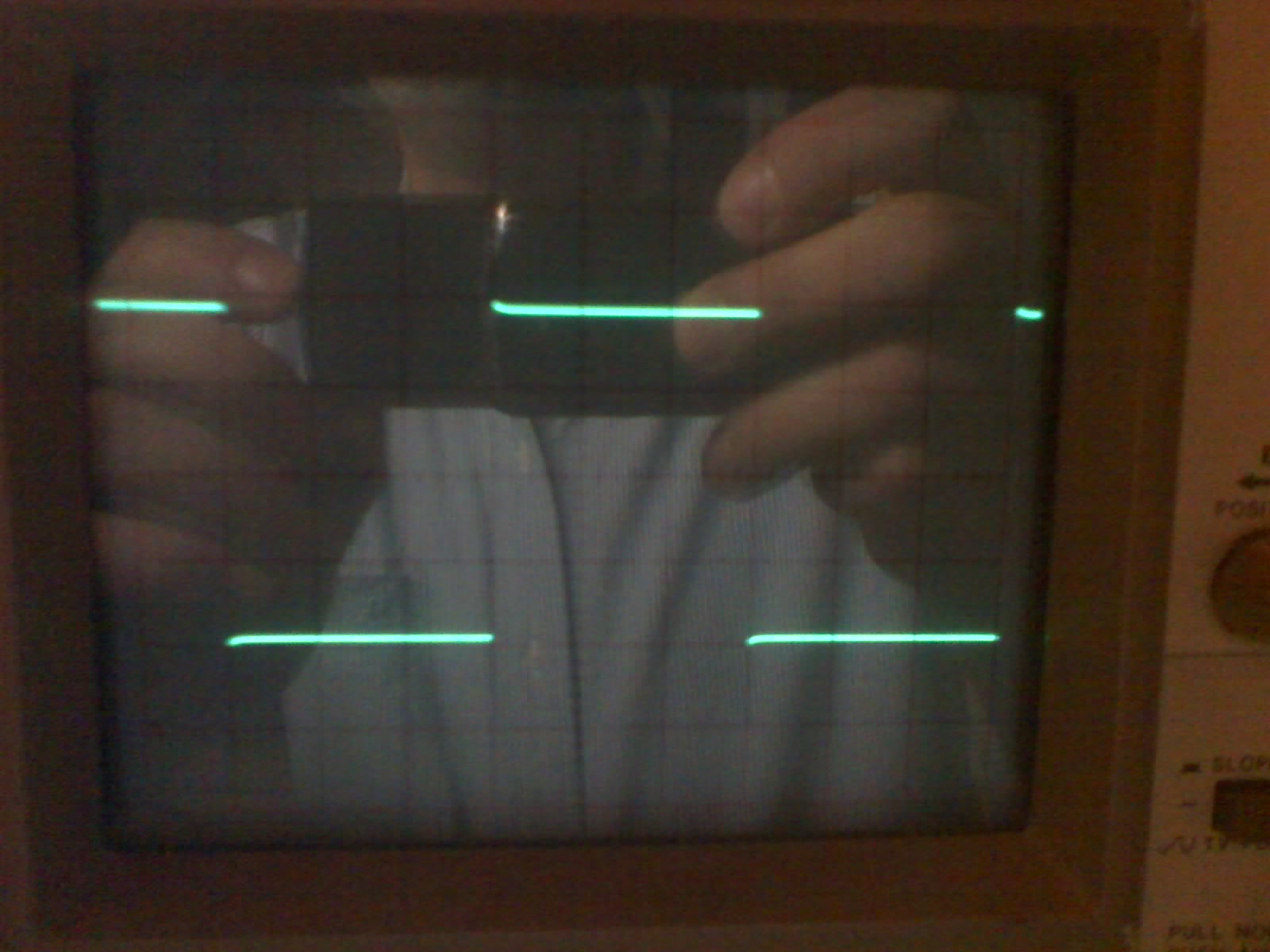

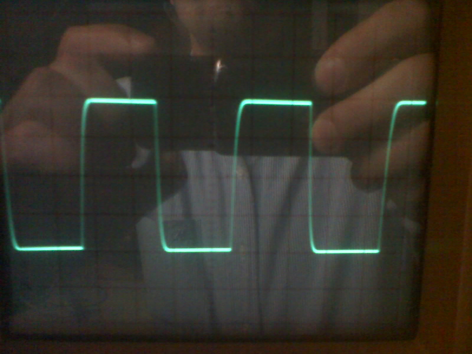

Square wave test 1KHZ , 10KHZ , 100KHZ

Golmund clone
100KHZ

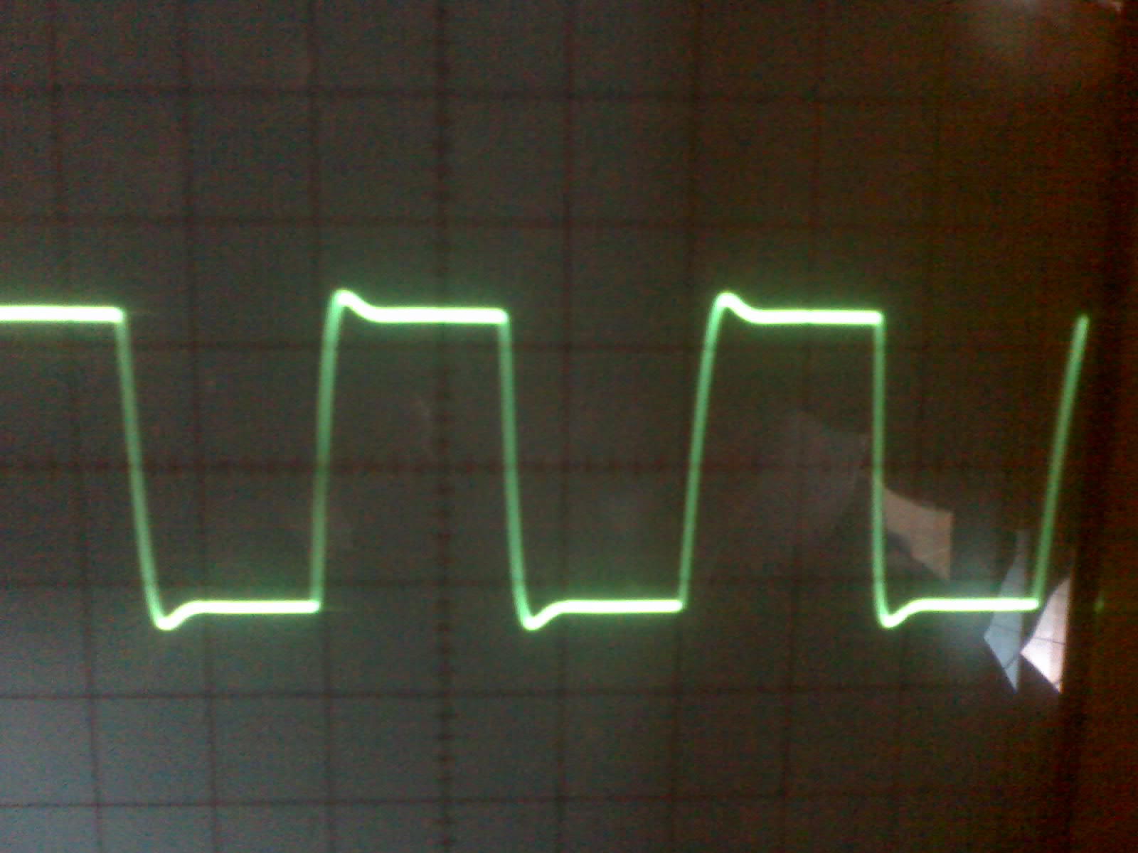

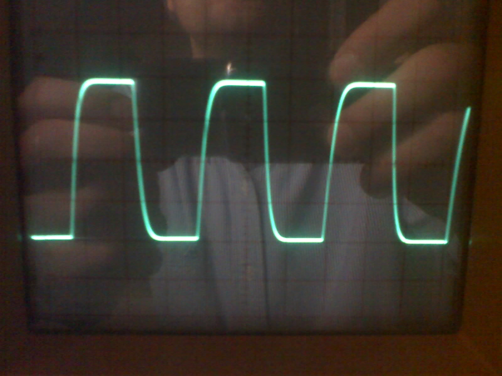

And after correction
1KHZ- 10KHZ- 100KHZ

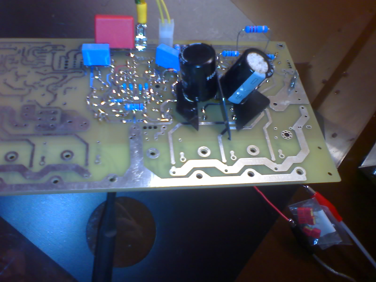

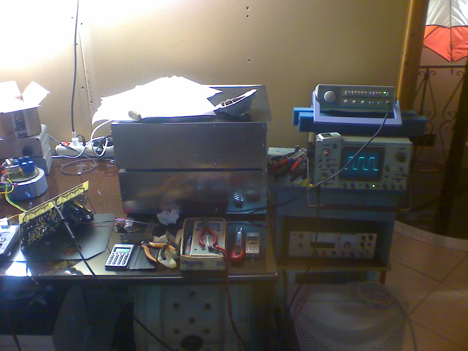

Until to be completed and the output stage is a long way to go.
I have little concern about the noise - hum when the amplifier enters the box because it hasn't star ground on ground plane and it will take some cuts on ground plane to properly isolated.
