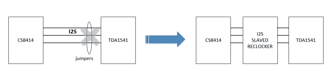

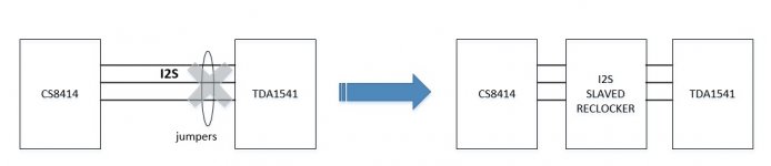

Dear Andrea, I want to use the I2S reclocker to regenerate the I2S stream coming from the CS8414 to the TDA1541(A) in my DAC. The idea is to use the three jumpers available in the DAC board.
Would it be possible to do like this?
My doubt is about the I2S format. The TDA1541 I2S input format should be OB/TWC so, would the I2S reclocker accept this format on its input?

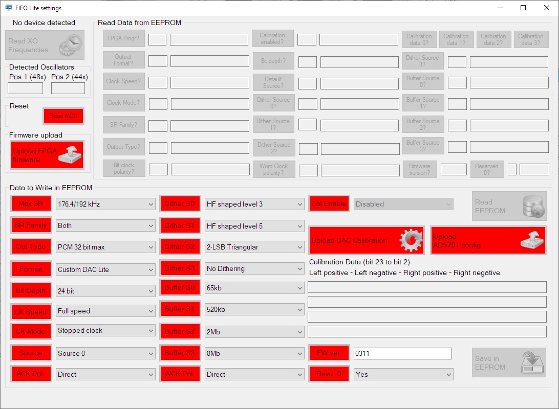

Work in progress
We are testing the firmware and the software of the FIFO Lite, the design is almost ready to be tested with some DACs.
I'm now working on the Windows software to be used to manage the board settings.
The board will come with the firmware for the micro already installed, while the firmware for the FPGA will be loaded by the user via USB using the Windows application.
There was a default for each setting, but the specific settings for the DAC to be drived have to be configured according to the DAC board by the Windows application.
There will be a manual to manage the settings and the configuration for the most common DAC will be preloaded.
This way one can simply select the DAC from a combo box and all the needed parameters will be loaded automatically.
I attach a picture of the Windows test application we are using to manage the settings.
The final application will be different but above all more user friendly.

Hi Eduard,
it's a little different, let me list some differences:
- 4 x selectable I2S input
- output format compatible with almost all modern and old DACs
- custom output format for TDA1541A (offset binary), our DAC Lite, Soekris DAM1021 upgrade, AD5791
- selectable stopped or continuous clock
- 8 x selectable dither depth separately for each source (used in case of data truncation, eg 24 to 16 bit for the TDA1541A)
- 8 x selectable buffer depth separately for each source, from 65kb to 8Mb
- digital DAC calibration to reach the best precision, DAC Lite and maybe other DACs
- all settings can be configured one time by USB connection to the Windows application
- user interface to manage some function on the fly like source selection, dither, enable/disable DAC calibration and so on
- T-switch configuration relais to select the sample rate family instead of multiplexers
- MCK and LRCK optical isolated from the FPGA and the micro to avoid interferences (BCK too with the OIR reclocker board)
- SMA connectors for external clocks
- micro controller in standby during listening (no RF interference at all)
- LRCK directly from the MCK (optical isolation) instead of from the FPGA
- very low phase noise outputs (MCK, LRCK, BCK with OIR board), plots published
Maybe I forgot some.
