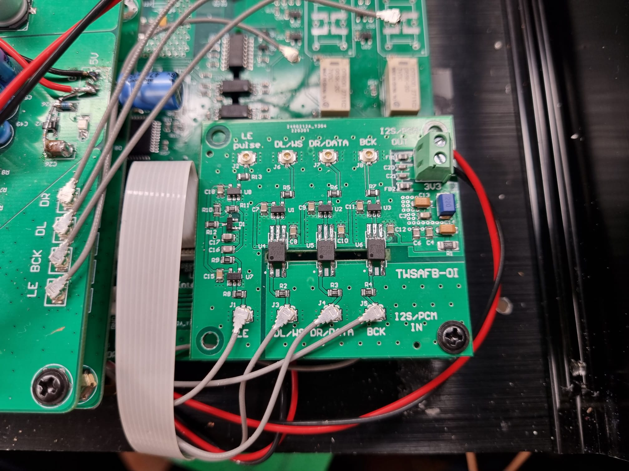

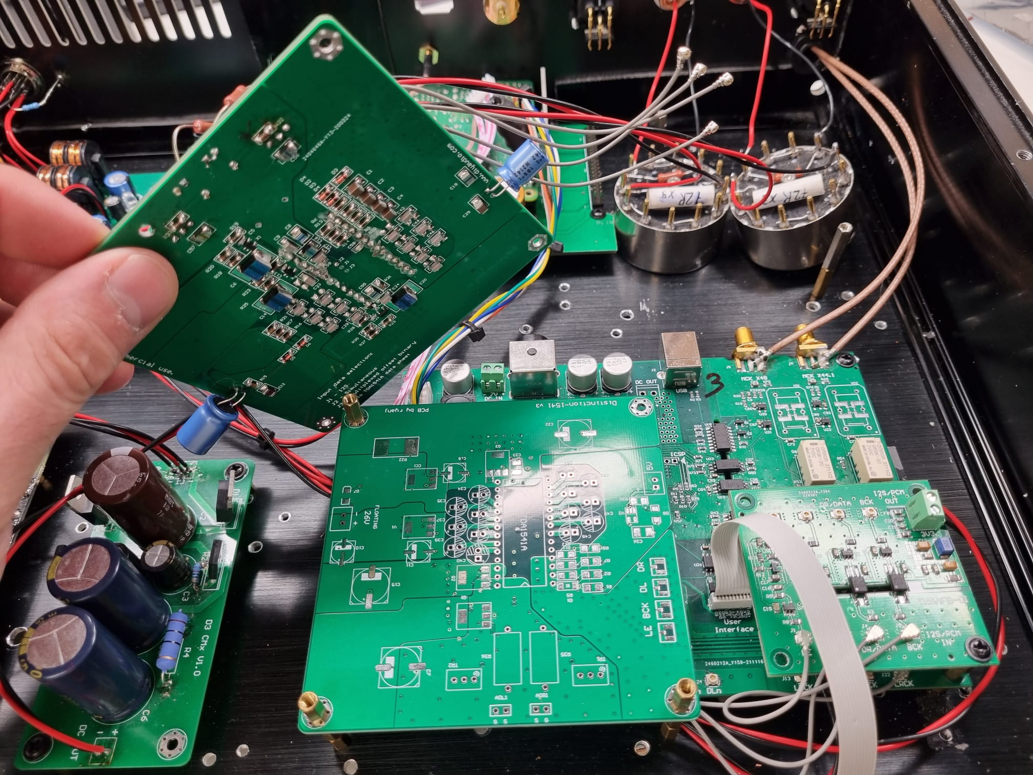

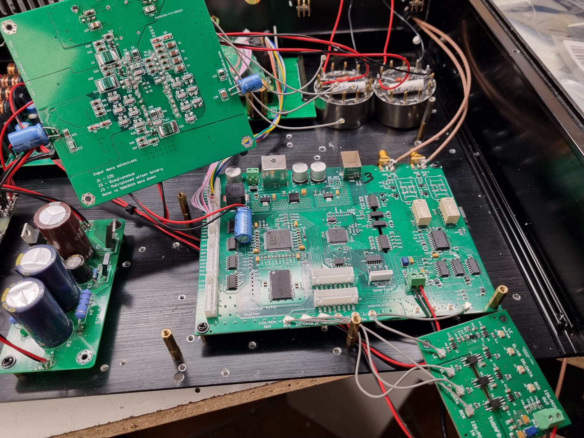

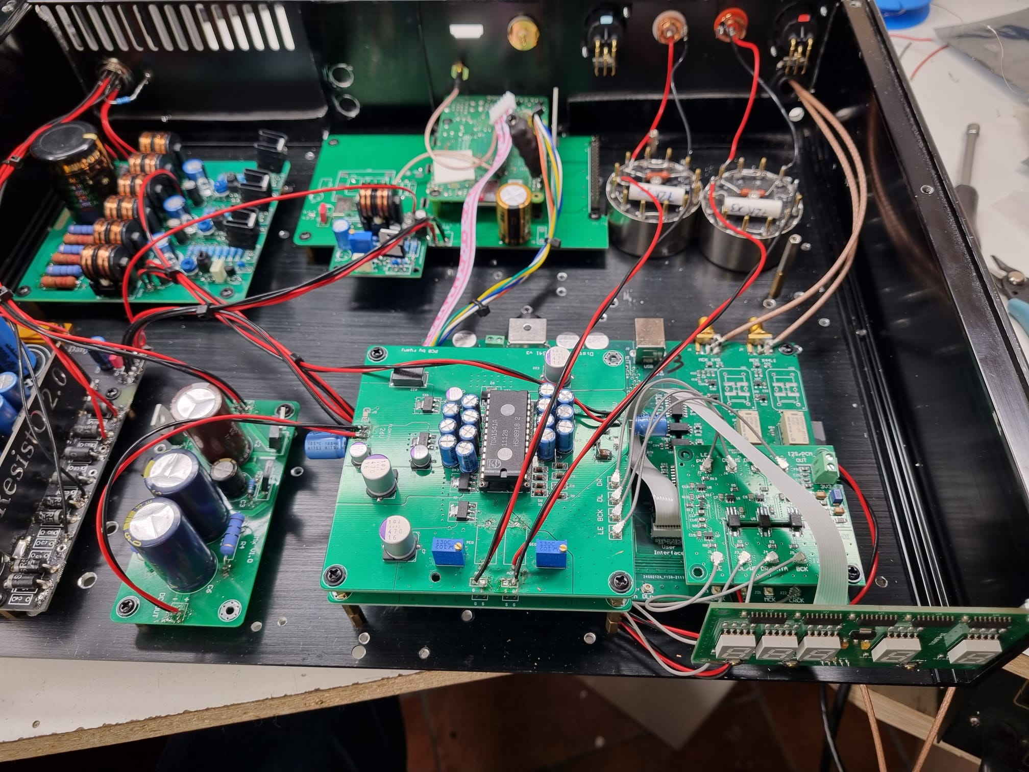

Just installed the little circuit board on the DDDAC mainboard. Will have to close the chassis, move it from kitchen table onto a temporary position connect the clock circuitry from Andrea, Roon Nucleus, pre amp to check if it works.
If it works i will make a donation to help Doede with his blog.
My conclusion so far won't buy circuitry anymore that uses these u.fl microscopic connectors. The only reason i proceeded was the big investment in money and time i made so far.
Greetings, Eduard

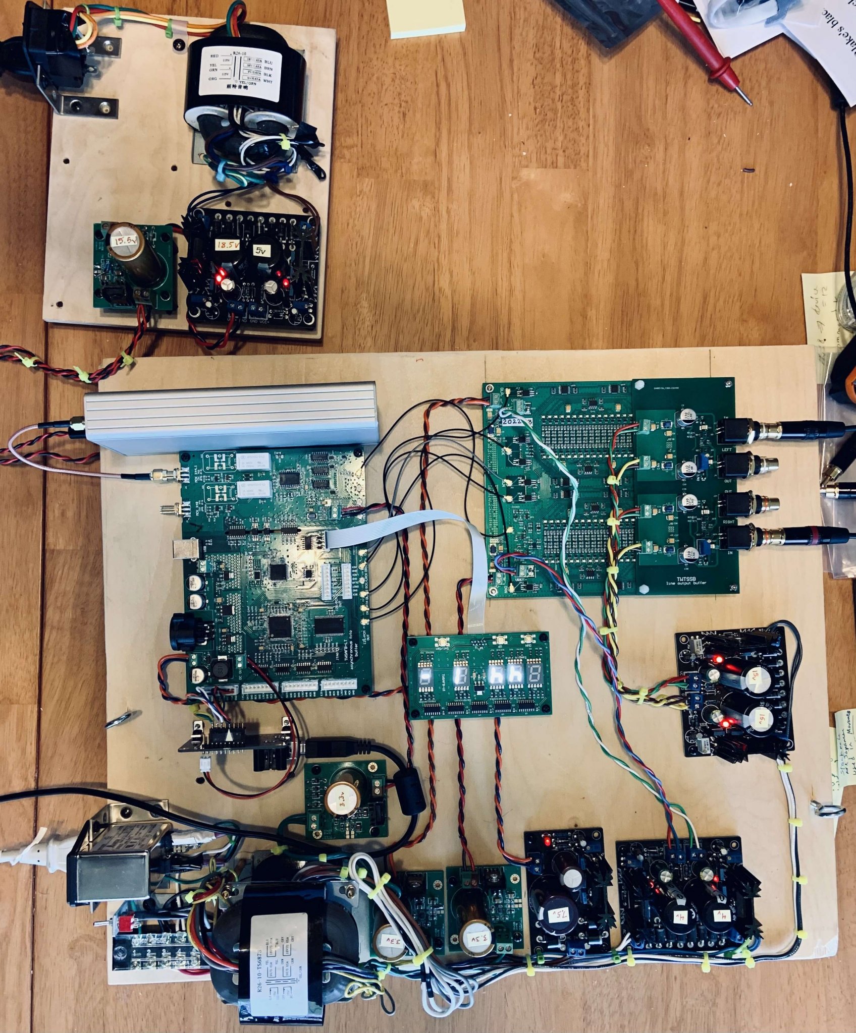

For anyone interested, attached is a pic of the test setup. The piece of wood more of the stuff is mounted on is sized to drop into an empty file server steel case. The metal case is for shielding to check if local environmental RFI/EMI has any audible effect on SQ.
All voltage regulators are on their own transformer windings. No center-tapped windings are used so that grounds/commons will be defined at the loads only. For +-15v regulation, dual positive regulators are used to provide matched regulator characteristics to both rails (e.g., matched FR, phase response, output impedance, etc.).
The dual 4v regulators are for DAC_Lite +-Vref rails. A different type of Vref regulator will be tried to see how that affects perceived SQ. That's being done because DAC SQ in general tends to be sensitive to Vref (sometimes referred to as 'AVCC' by some manufacturers) regulator design.

Finally, Andrea also has the TWSAFB-OI , which he uses to clean BCK, DR, DL from his FIFOS FPGA. Do you think this could help after the I2SoverUSB board too (I am connecting the I2SoverUSB to TDA1541 and AD1862 dacs)?
