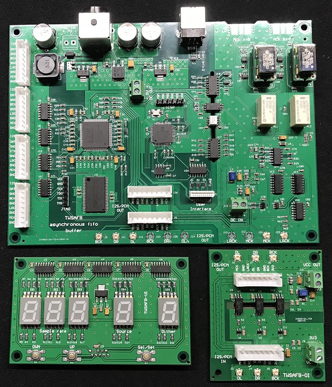

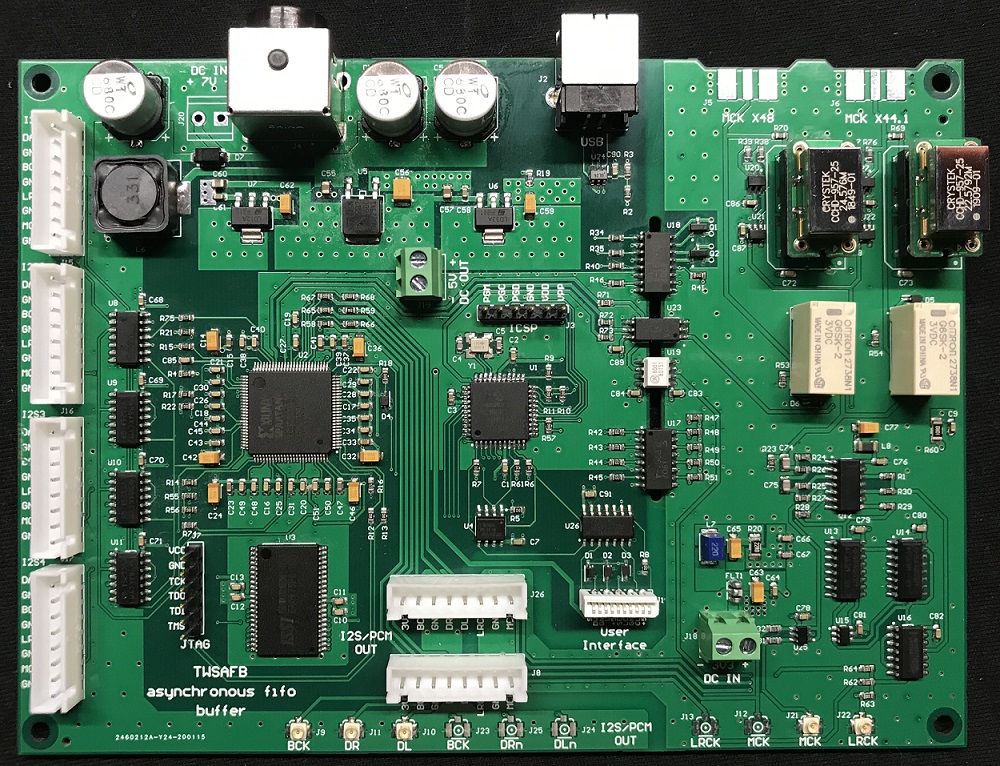

In order to clarify how this device works I attach a schematic block diagram.
View attachment TWSAFB_Block_Diagram.pdf
In order to clarify how this device works I attach a schematic block diagram. View attachment 816336
Andrea, Looks like a very good solution.
Looking at block diag, why do you need dithering?
Also what is latency / time delay through FIFO?
Also, is there provision for L and R justified PCM PCM179x uses R for DF bypass mode)

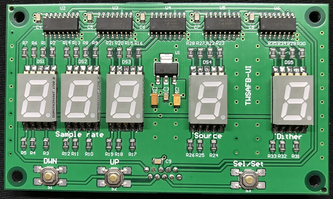

Dithering is an option to avoid data truncation when input bit depth is bigger than output bit depth (eg. from 24 bit input to 16 bit output). Anyway dither can be excluded and data will be truncated.
We are using 8MB SRAM so the latency is in the range 0.5-0.7 seconds.

Not in this version, maybe in a new release.
This version provides support for dual mono and balanced DAC.

Implement a volume control with dither?
No digital volume control, the only purpose of dithering is to avoid truncation when input bit depth is larger than the output bit depth (eg. 24 to 16 bit). Anyway the truncation is available setting the dither option to 0 (off).
