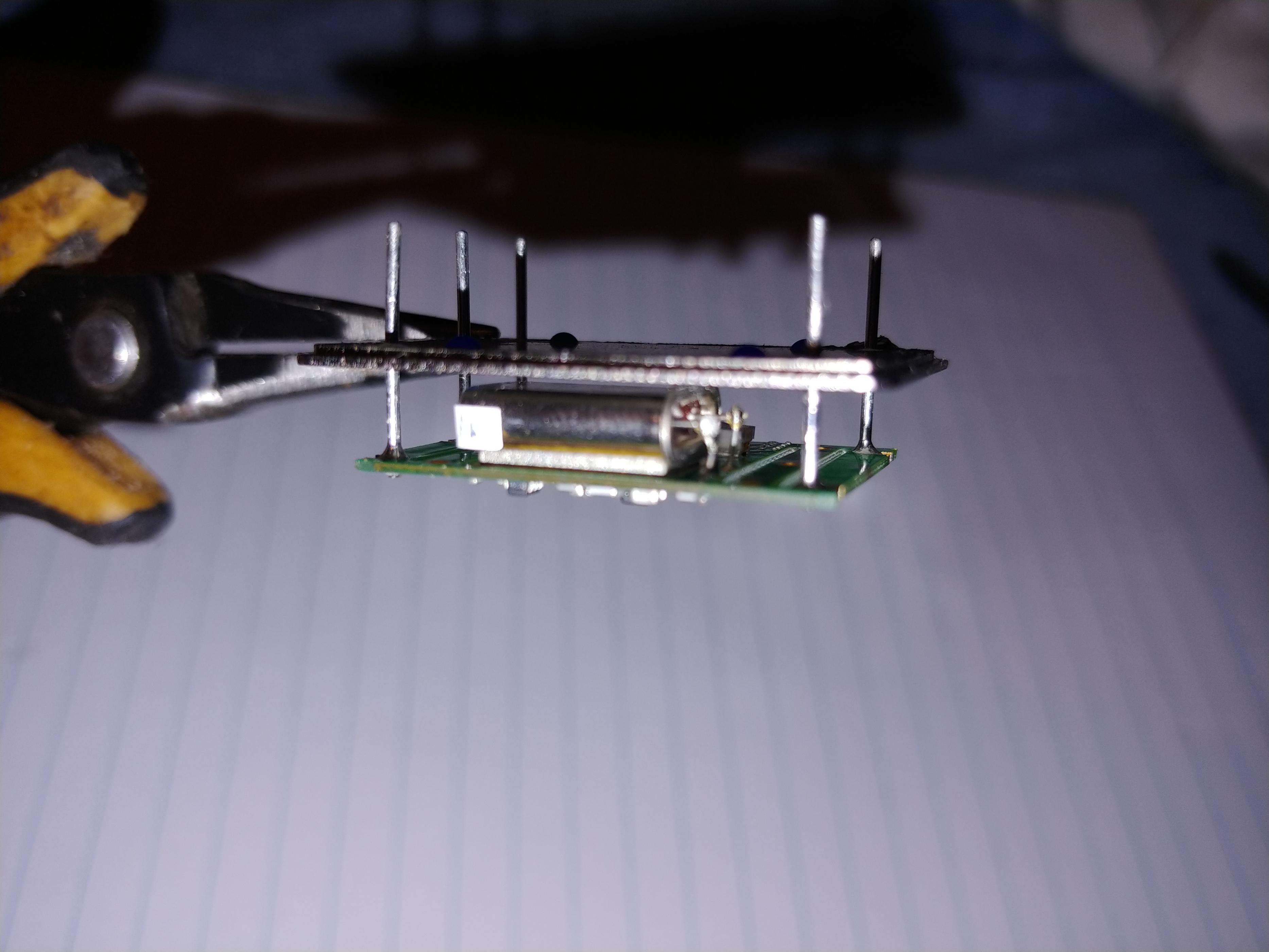

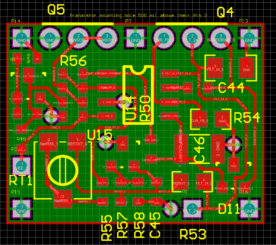

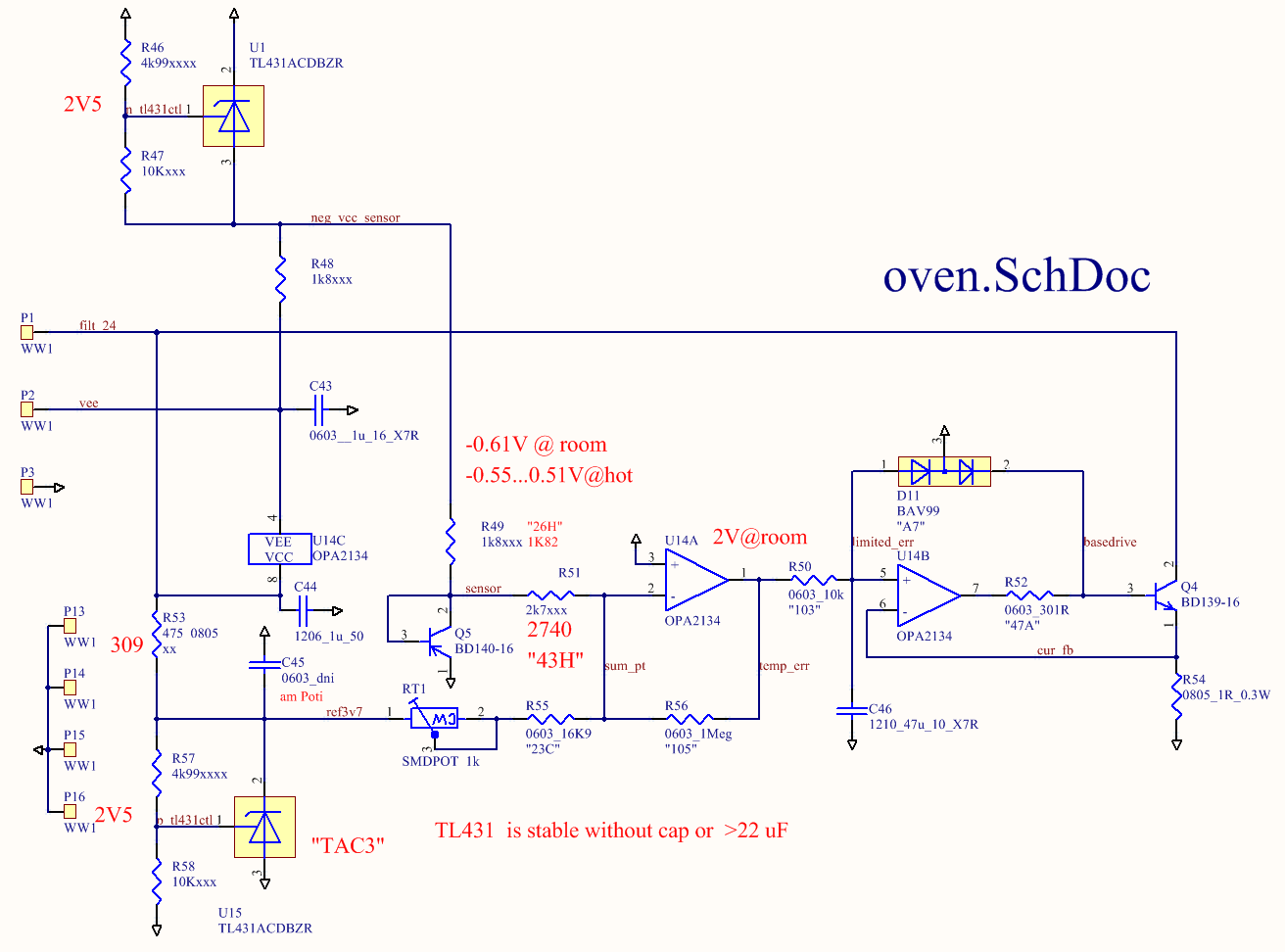

I recently finished my oven build. But I dont think it's working properly.
When powered with 16v dc on my benchtop PSU. The oven board is drawing 0.5A at 16V.
R1 alone takes 5V, and getting hot very quickly.
I turned it off after that, fear it's going to damage the board. Both of my boards are behaving the same, and all passive components have the correct values.
What would the problem be? or I should leave it running to stabilize?

This is normal. The parts on oven board will reach 90+ celsius easily. In my case the current consumption will gradually decrease to 200ma.

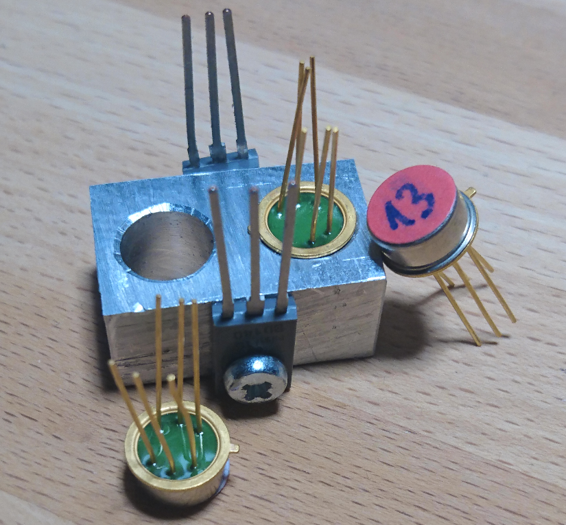

I have made an oven circuit as an option for something completely different
(keeping some FETs at 40°C). It is therefore a snippet from some larger circuit
and not of prime importance to me, but it seems to work.
Last summer there was a discussion about it in the LTspice users list,
including simulation.
The only hot parts are a BD140 used as a sensor and a BD139 used as heater.
I was surprised how fast the heat travels through the alu block.
Sorry, no boards or further interest from my side, but easy on perf board
if someone wants to play.
xxx on parts values means that the original part has been edited and should
be re-imported from the library with correct value to get a clean BOM.
cheers, Gerhard

I doubt that's my case, under 30 seconds running, you can clearly see my R1 cooking.This is normal. The parts on oven board will reach 90+ celsius easily. In my case the current consumption will gradually decrease to 200ma.
Also R1 is rated for 3W. With .5A running through it, it's working way over it's rating.
R1=10R, I=0.5, W = I^(2) x R, 0.5^(2)*10=2.5W
It's still under 3W at start up. However, my R2 fried once after 1 or 2 yrs of non-stop operation.

No. From the photo in #2007 it is just the input capacitor of the 7812, needed
to prevent the regulator from oscillating or other misbehaving in case of large
ps impedance. Half or twice the value makes probably not the slightest difference.
I think the 78xx data sheet requires it and the values can be checked there.
As long as the regulator does not go hiwire the capacitor has no influence on anything.
I have no idea about R1. If you make it smaller, the 7812 probably will have to
burn R1's share, too.

Thank you gerhard... the 90 degrees was worrying me... I have not the habit of such temperature nore I have jad a class A transistor amp...

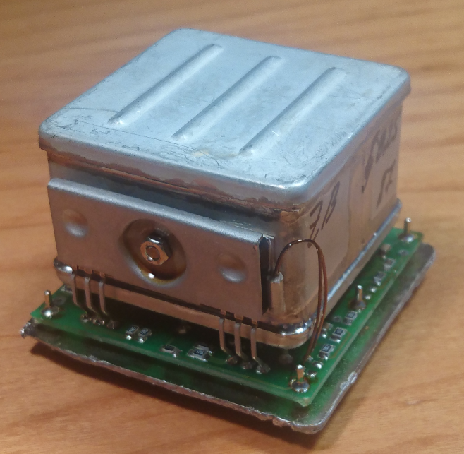

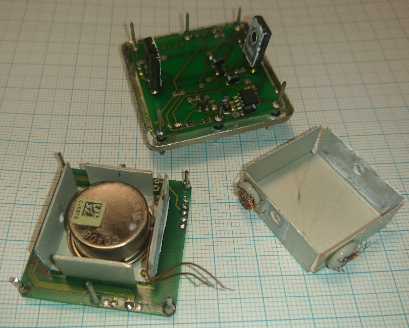

I have just opened a Morion MV89A that ceased oscillating with most
Vtune voltages, so I can at least recover the 5.000 MHz SC overtone
crystal for own experiments.
The box is the inner oven. It has 4 transistors for smooth heat transfer.
There is another fat transistor below the box on the board that seems
to be thermally coupled to the bottom plate of the outer case.
Apart from more uniform heat distribution, sharing the thermal load
between 4 transistors decreases their junction temperature.

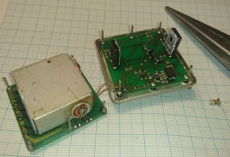

It was actually not very hard to open the outer oven. Once I had
filed away a bottom corner I could prune away the cover. It was soldered
but the tin does not bond too firmly to the steel.
Next weekend I'll open the inner oven.

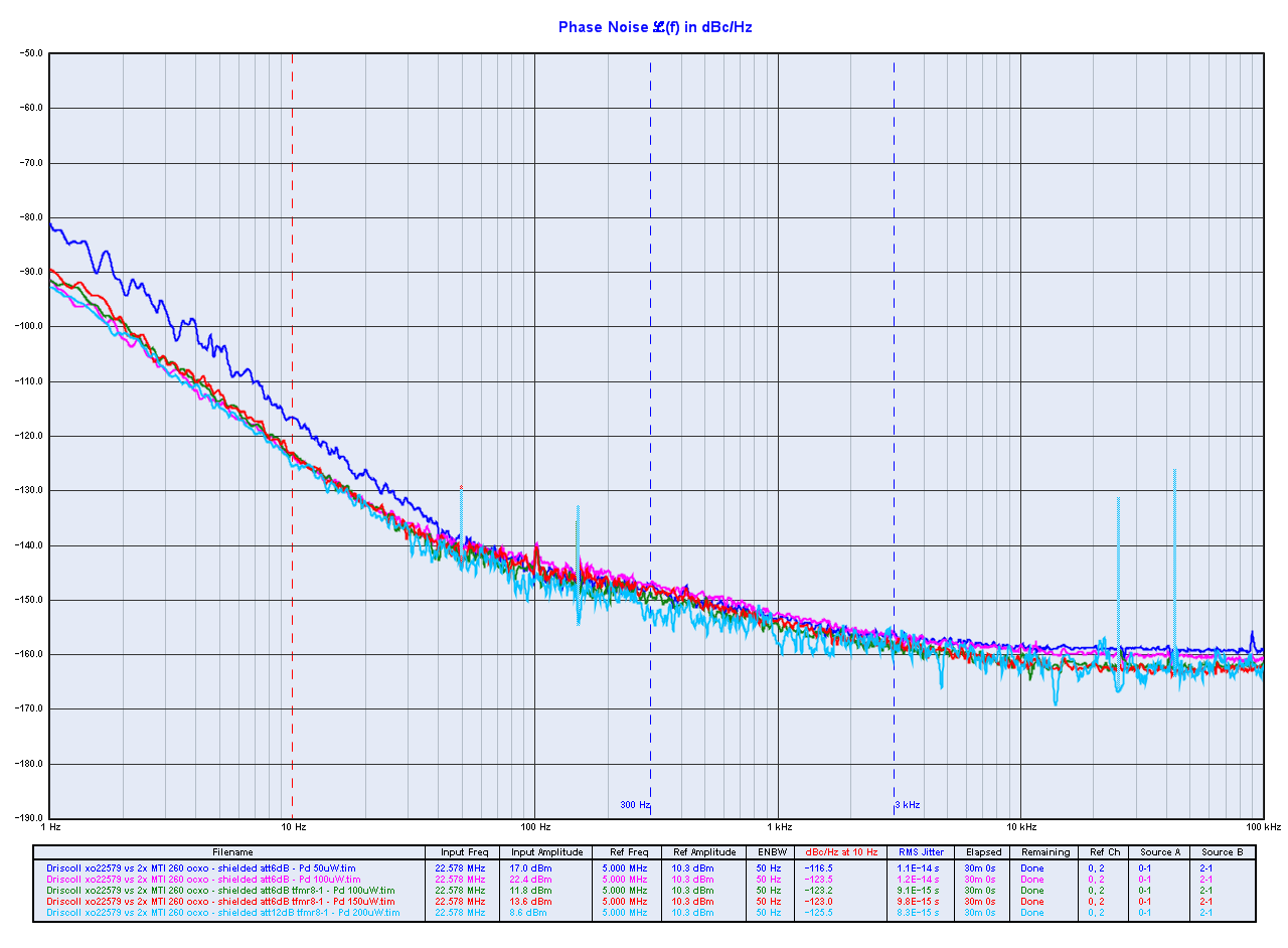

New Driscoll at 22.5792MHz
I attach the phase noise plot of the new Driscoll oscillator that implements the Laptech 3rd overtone SC-Cut crystal at 22.5792 MHz at different drive levels.
The plot of the SC-Cut 11.2896 MHz crystal coming soon.
Nice. 🙂
In
< Phase Noise and Frequency Stability in Oscillators The Cambridge RF and Microwave Engineering Series: Amazon.de: Enrico Rubiola: Fremdsprachige Bucher >
there is a chapter for interpreting these plots, including speculations on XTAL Q
and drive level.
WOW. €2300 for the hard cover. No wonder thet J.B. can donate 10 billions.
All traces but the dark blue one could be easily interpreted. What was different there?
it really seems to be 1/f**4 instead 1/f**3.

I have continued with the crystal recovery from #2013.
The outer box is not the box of the outer oven. The outer oven is
what's inside. What I identified as the outer heater transistor is
only a 10V regulator.

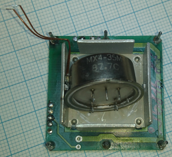

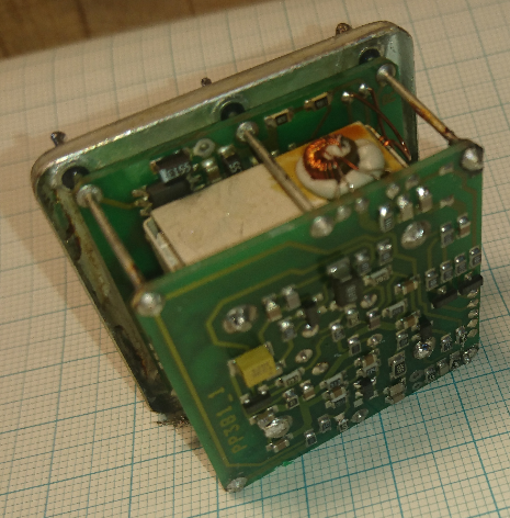

Now the inner oven. It is only plugged together, not soldered.
The coils probably belong to the 5 -> 10 MHz doubler.
Next thing is to measure the crystal parameters.
The crystal analyzer program of the DG8SAQ VNWA did not give
conclusive results.
conclusive results.
