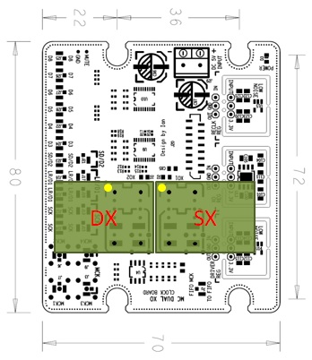

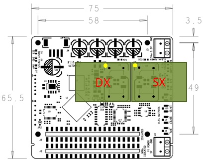

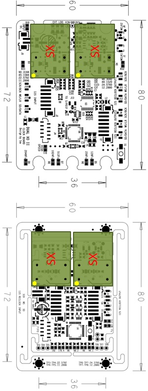

hello,
First, thanks for the slow coocking to you & "We", it is "gage" of quality & good taste.
A question please : is the frequency doubler works individually for each frequency family ? For illustration : can it x2 a 5.6 M hz and 24.5x2 on the same board ? In instance to work with Red book and choose the trade off one like most according the frequency family.
according to the price, whished to add with what I already have :
whisch list : first Xtal as manly asked : if compatible FifoPi first gen and the board needed : a 24 SC cut -whished to work with doubler but first want the fifoPi to work with the discroll and the 5 Mhz SC cut- If not possible second family frequency wish will change according what is possible between boards.
- New Discroll for the Sc-cut
- Pierce gate to coock better the AT-Cut
- New Sine - if needed for Iancanada layout from the first standalone Fifo to the compact FifoPi-
How the new Pierce for AT-cut vs the former Discroll for AT-cut please - in order to stack on the first Clock board from IanCanada? Could help me to push the trigger or not : don't buy double if former is good enough.
Many thanks to the team for all the work.
A wisch : i it simple to have the raw individual measurment of each SC-cut one purchase ?
best regards
edit : what quicly are the voltage needed for each board in order to know if the first gen PS boards are still compatible or not ?

The frequency doubler has different components for each frequency, capacitors and inductors used for filtering are related to the frequency.
About the FifoPi clock frequency limit you should ask Ian.
The new Pierce gate based comes only as finished board with crystal 22/24 MHz installed, no bare PCB or finished board without crystal.
The new discrete Pierce for AT-Cut crystals has to be tuned and measured, please be patient.
The individual measurement service is provided as an option.
The New DRIXO, EXO and PXO need a clean power supply, from 12V up to 18V (batteries suggested).
