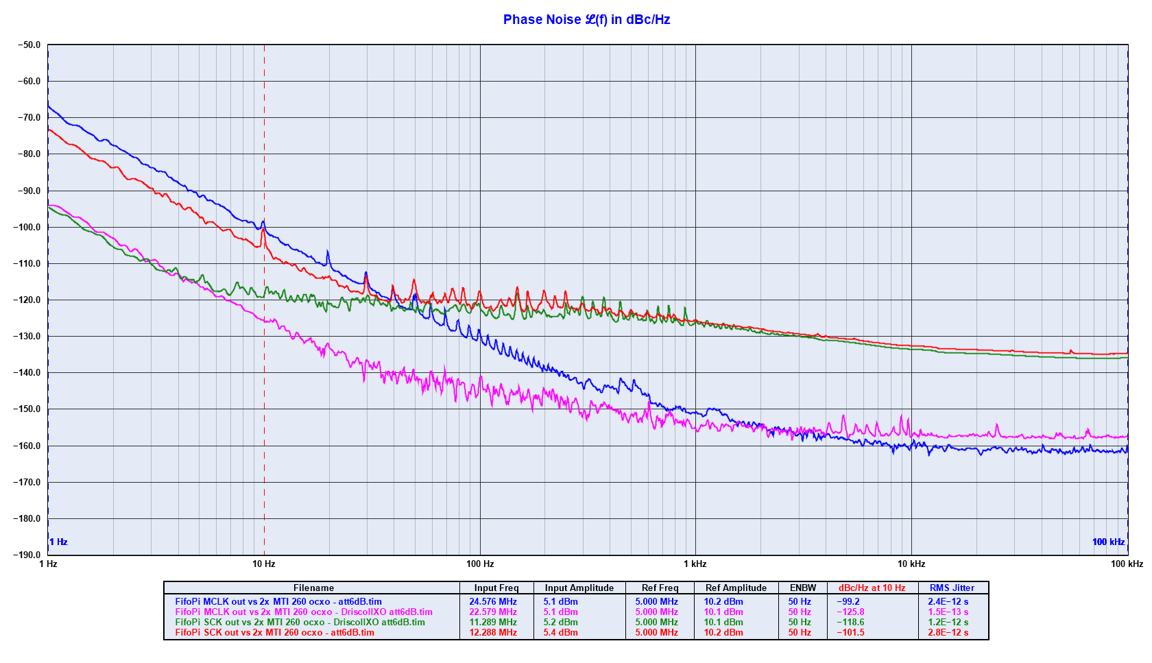

We have seen that the noise floor halves at each division by 2 of the carrier frequency.
From 11MHz to 176kHz there is an 62.5 division factor.
Let's round it to 64..
If the system would keep the physics all right, then it should show 2^6, that is -36dB difference in the floor, instead of 8dB.. and changing shape..
So there is something which is not perfect.
I expected exactly this reply, now please comment on this plots (I know the reply, but just to confirm ...)

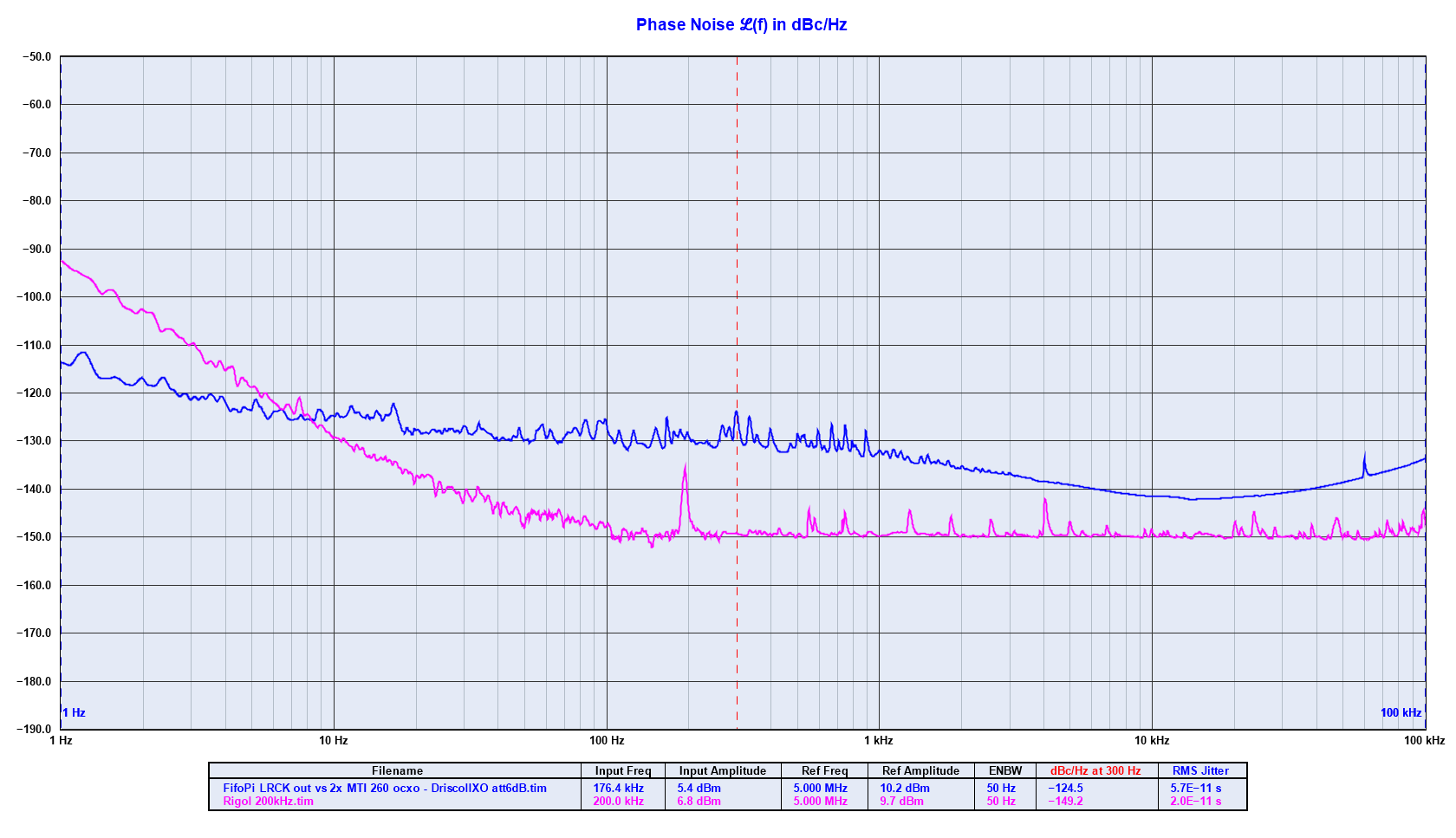

Just so as to annoy You, the applied Wilkinson splitter does have a certified lower bandwith at 1MHz.. and already there it's not totally the same as at higher frequencies.
I can understand that it continues to work somehow, but care should be taken.
We have to take the maximum care, since one time there is something which is not perfect (blue line) while another time it works as expected (pink line).
Maybe on odd days there is something wrong ....
I have already told my conclusion that the Fifopi seemingly does add a certain floor.
It does not have anything to do with your previous graphs and what I have told for those. I feel it's a bit of shifting the target
Very strange, I don't remember you told that.
Can you quantify how much noise floor is seemingly added?
Anyway I have not changed any parameters /environment, all the last plots have been already published (as an example the last plot was published in post #2433 The Well Tempered Master Clock - Building a low phase noise/jitter crystal oscillator).
No game here, simply measurements (and sometimes unheard suggestions).

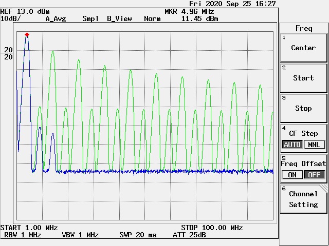

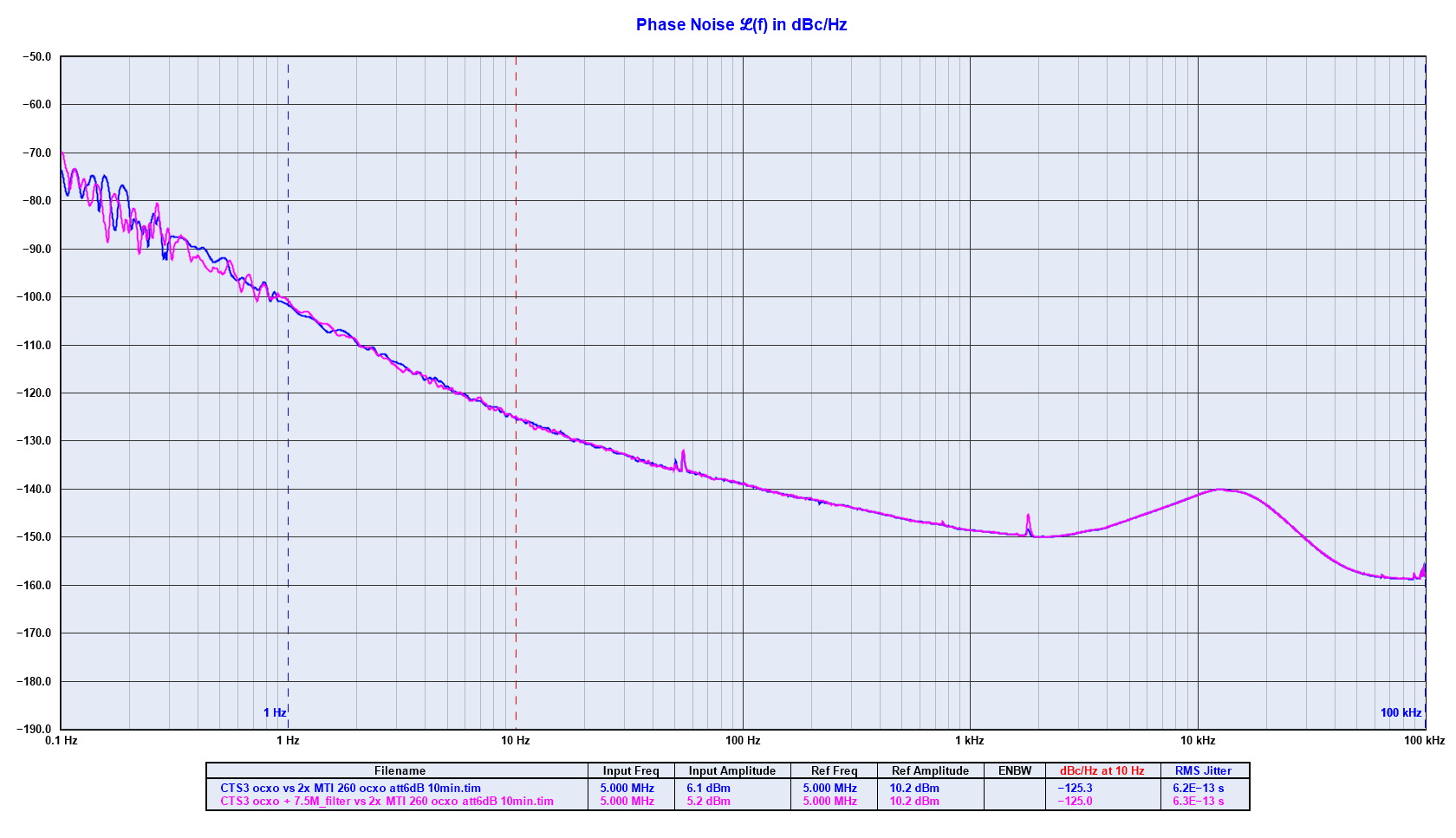

Just to clarify once and for all
This is the last time we waste time demonstrating what was obvious from the beginning: the Timepod measures correctly the phase noise of square wave clocks, the harmonics of the signal (unlike what someone claims) absolutely don't affect the phase noise analysis as shown below.
We have measured the phase noise of a 5 MHz CMOS output CTS oscillator with and without a low pass filter at 7.5 MHz before the input of the Timepod to suppress the undesired harmonics above its fundamental.
The first picture shows the spectrum analysis of the square wave at 5 MHz without the input filter (green curve) vs the same square wave with the filter at 7.5 MHz (blue line).
As you can see the spectrum of the signal without filter is charged with lot of harmonics, while inserting the low pass filter the harmonics practically disappear.
The second picture shows the AC characteristic of the filter we have used.
Finally the third picture shows the phase noise plot comparison between the 5 MHz square wave with (pink line) and without (blues line) the low pass input filter.
As you see the two plots are exactly superimposed, the harmonics of the square wave don't affect the phase noise measurement in the least.
And this was obvious for us since we are measuring the phase noise and not the amplitude noise.
Measuring a 5 MHz square wave its harmonics fall into the passband of the input filter used in the Timepod but the phase noise result is not affected, that demonstrates the reliability of the gear even with square wave clock.
I hope this helps to understand.

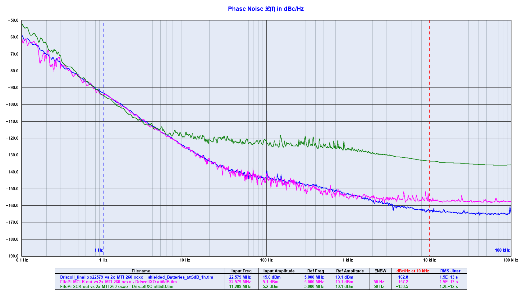

If we assume that the better the quality of the oscillator the better the sonic result (nobody seems to claim the opposite), the attached measurements plot confirms the theory.
Although the noise floor of the FifoPi (30/40 Hz from the carrier and above) is almost the same using whatever oscillator there is a big difference in the close in phase noise (10 Hz from the carrier and below).
IMHO, the better close in phase noise is the reason why we feel such sonic improvements when moving to a better quality oscillator.

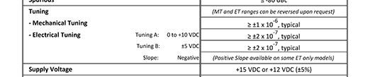

Joined 2004
The idea sounded interesting until I checked. I have 2 5 MHz Wenzel Streamlines coming for references. I checked the specs (below) and I could get maybe 10 Hz between them MAX. Not that useful.
However I have a modified Ballantine Time mark generator for scope calibration (I had to do some tweaking to get some hum modulation out of it) but its a synchronous counter and I really did not get any discernable jitter with it and the AK5394A demo board + quality reference oscillator. I'll dig it all out and check it with the RTX to see what I get but I have not seen evidence of jitter on the ADC side once the clocks are OK. I can run it from an external clock so it can be tuned to 12 KHz I think. It will be interesting.
