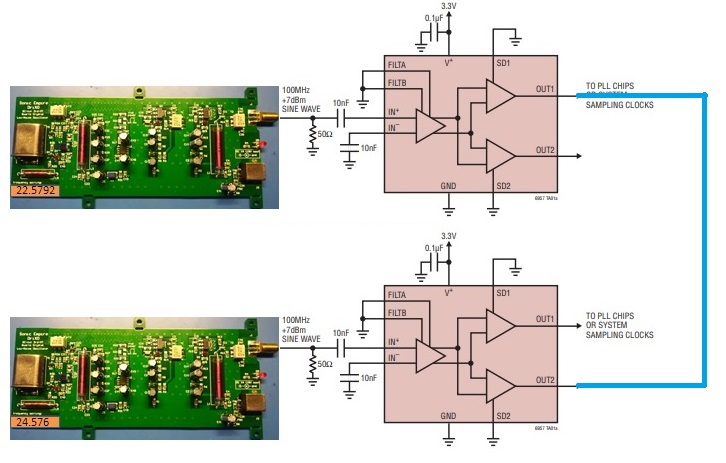

I will also probably need enabling/disabling functionality in my application. First I thought to implement this by using the enable signal to switch a relay and simply cut off the output. But now I'm thinking to maybe use the LTC6957 buffer. If I read the datasheet right, you could feed it sine wave and use it as squarer, and also do distribution into 2 signals, and finally it has enable functionality for both square outputs. I'm no clock expert so if I overlook something here then tell me...
Yes, you can use a pair of LTC6957, connect their ouptut and then you can use SD1/SD2 of both to enable/disable the oscillators.

Sorry, but I don't understand what you have to connect after the squarer, can you elaborate?
I didn`t get detailed:
Assumed, that I could shut down one oscillator (maybe the specific squarer), would it be possible to simply (after impedance matching series resitors, like in the schematic, that I`ve posted) tie both squarer outputs together?
You cannot tie both square outputs together, you get a short circuit.
The squarers do not provide the enable pin, therefore even if you shut down one of them the other sees the output of the first one that's not a high impedance level.
The Crystek you are referring has the enable pin, so it move to high impedance when is disabled.
In a few words it's not possible.

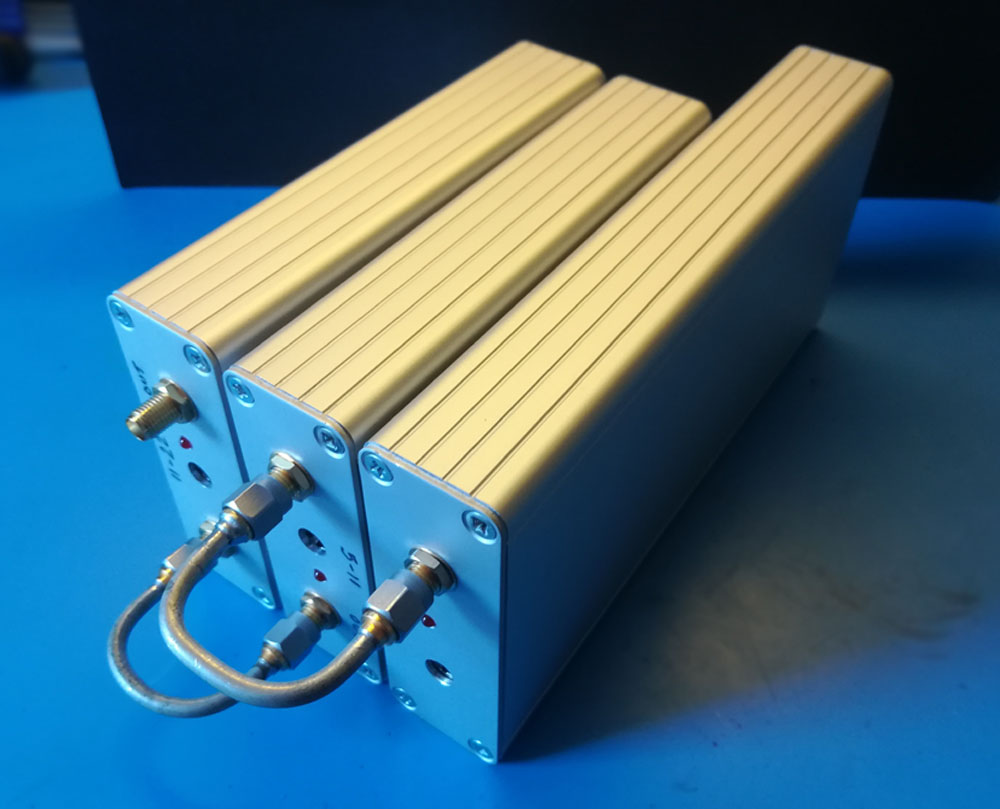

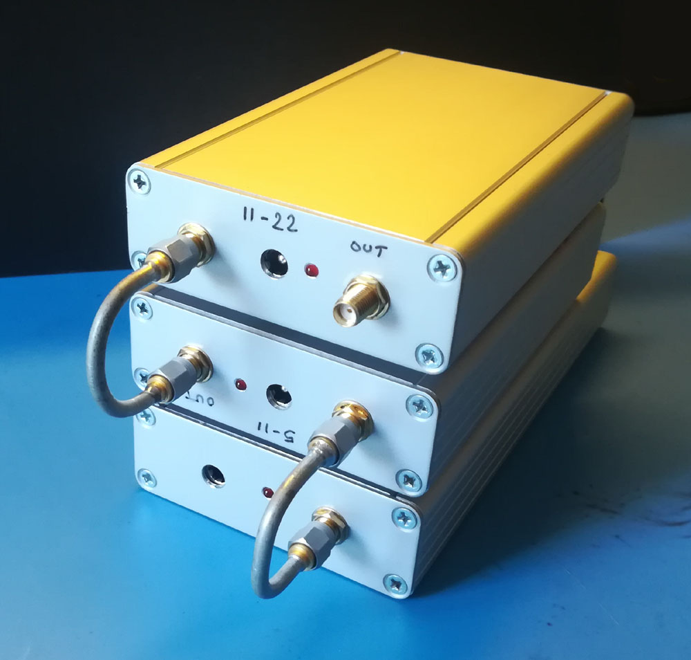

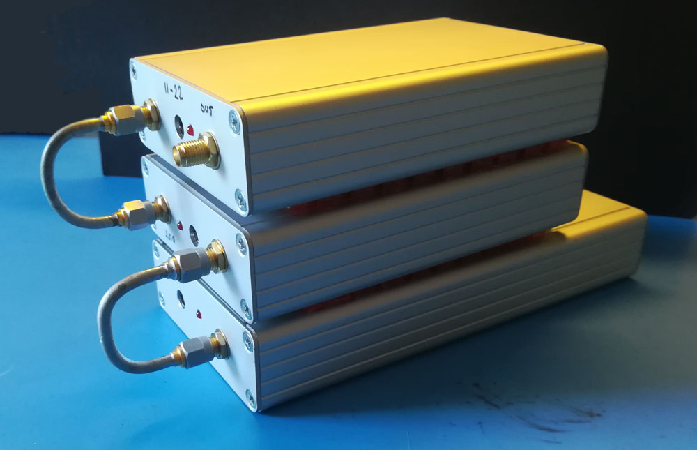

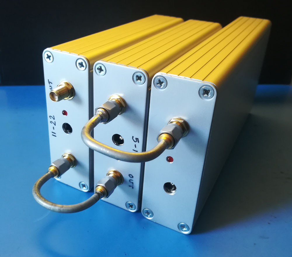

As short as possible like in the following pictures.

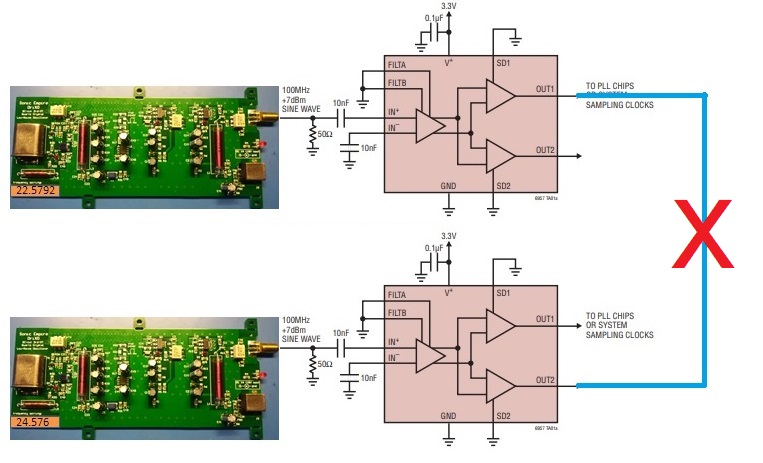

WARNING!
I does not work as a multiplexer between the two clocks because the output of the LTC6957 can not be put in a high impedance (3-state) condition.
You can only use the LTC6957 as fanout buffer to get 2 square wave outputs from a single sine wave oscillator.
If there will be enough interest I could design a dedicated board to switch between 2 clocks with enable inputs.
Please, let me know.
