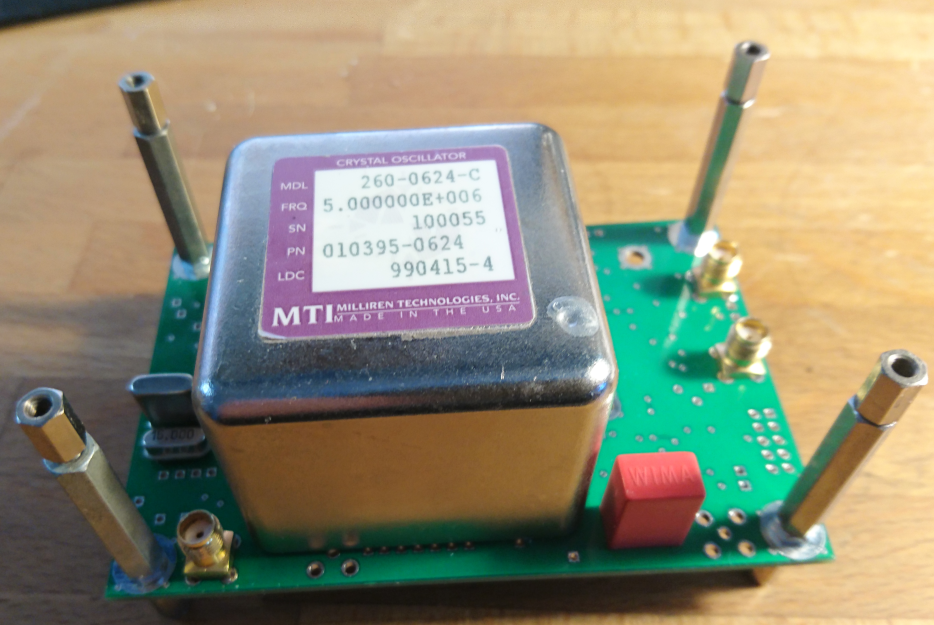

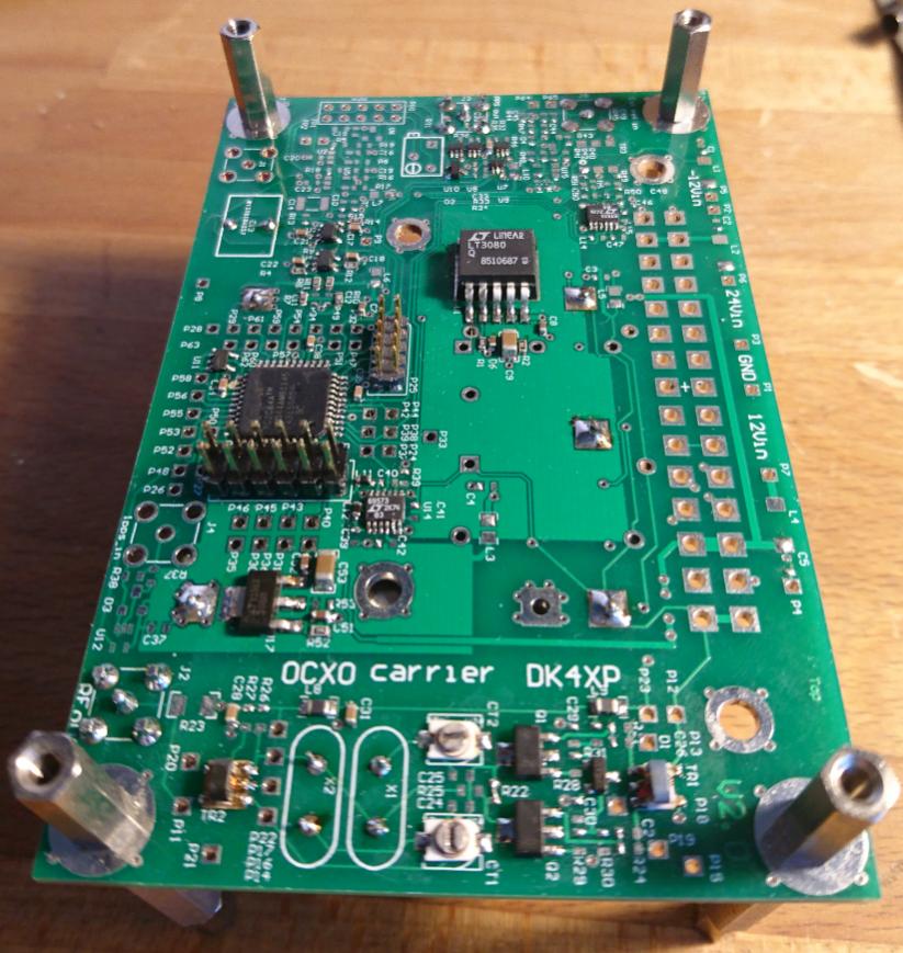

I have one soldered sample of my OCXO carrier board with
2 already mounted, so I can continue to work on it over the holiday season.
My circuit needs only one output to feed the CPLD, so I could replace the -3
on my board by -4 if needed. That would provide another two.
All are the MSOP12 version with leads.
I will not slaughter the evaluation boards before I have measured
their performance in original state.

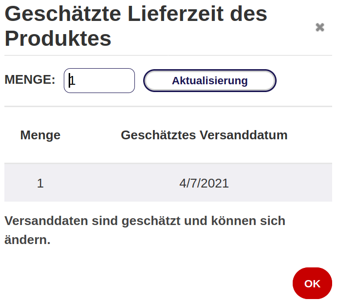

Optimism is only incomplete information. DigiKey won't get more
before April. :-( That would be the lucky case, that they use American
date encoding even in German text. Otherwise it would be July.

I have 2 of the dual CMOS output -3
3 of inv/non inv out -4, LVPECL and LVDS.
Send me your snail mail address again, I probably can't find it quickly.
