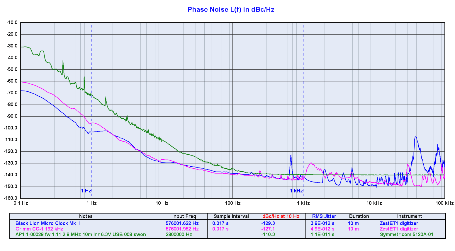

3 I found measurements of some very good commercial products (Grimm CC and Black Lion). Looks interesting
