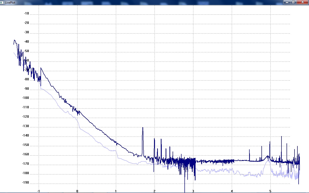

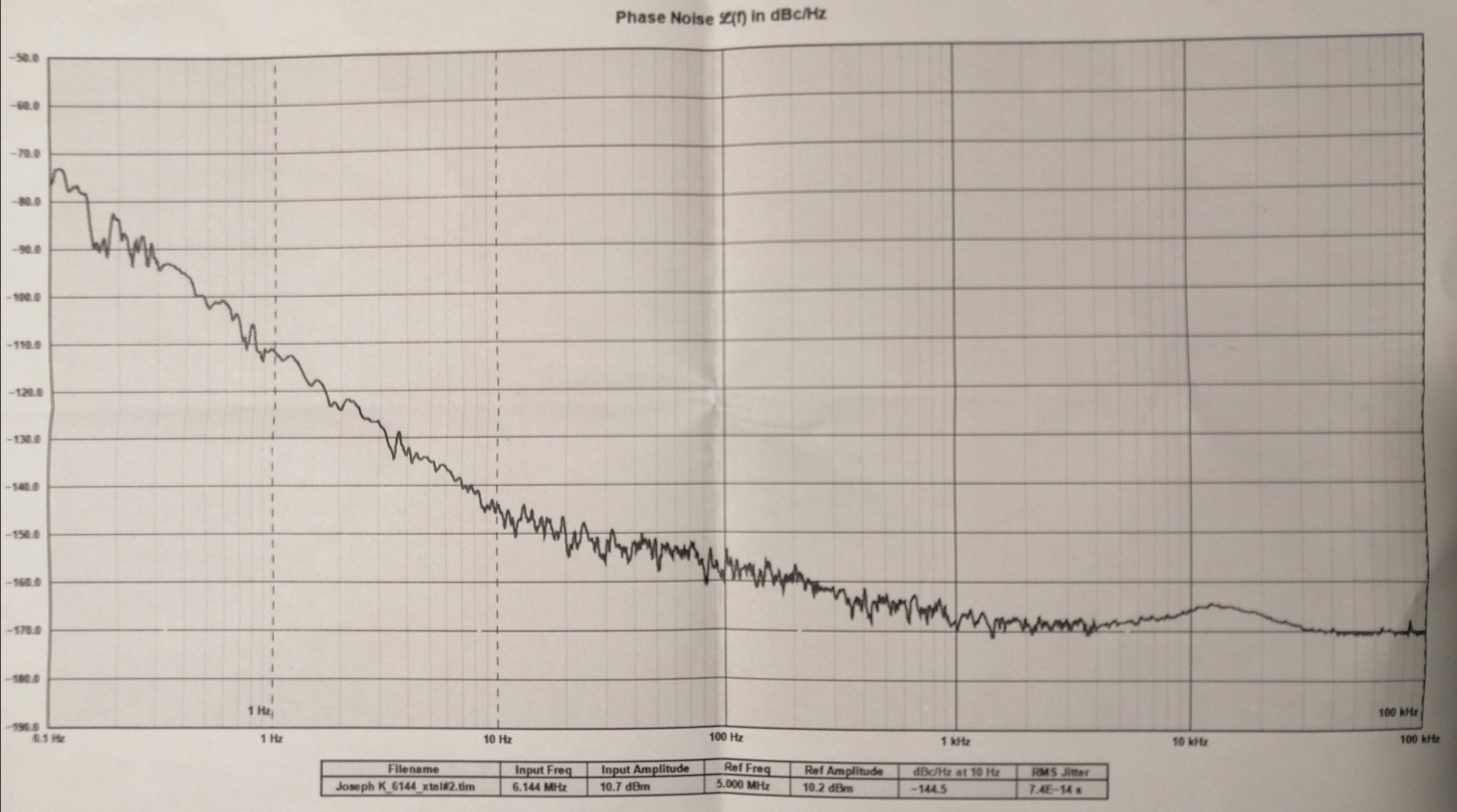

Sorry for this late reply.. Thank You, and I got this slow in reply because It's a bit unclear for me. Andrea definitely has a good point, the crystal can be a 'suspect'. Though, and Andrea knows that, my point is sligthly different: I feel that the measurement with the 5,6448 crystal is so much of ' scraping the bottom of the barrel', that the instrumental noise floor gets into the picture, too, cross correlation notwithstanding..
For this reason I was hoping for getting an another data point: Andrea had sent me the measurement result also for the 6,144MHz Laptech crystal.
So here they are, first is his measurement, second graph is mine. Full of 'artefacts, that extra sloping at 0,1Hz range is due to the' drift' effect that I had been talking about. It was a quick shot, the system did not fully settle, yet.
Apart from this, I think I can conclude that these two takes, by totally different instrumentation, even the oscillator is different, - but the same crystal -..
Are in quite a good agreement. Note that here we are ~15db higher, farther from the instrument floor..
Ciao, George

Completely agree Joseph. it will be hard to get better close in phase noise and looking at "normal" commercial clocks this measures way better. So we should not care too much about the small differences between setup 1 and 2.

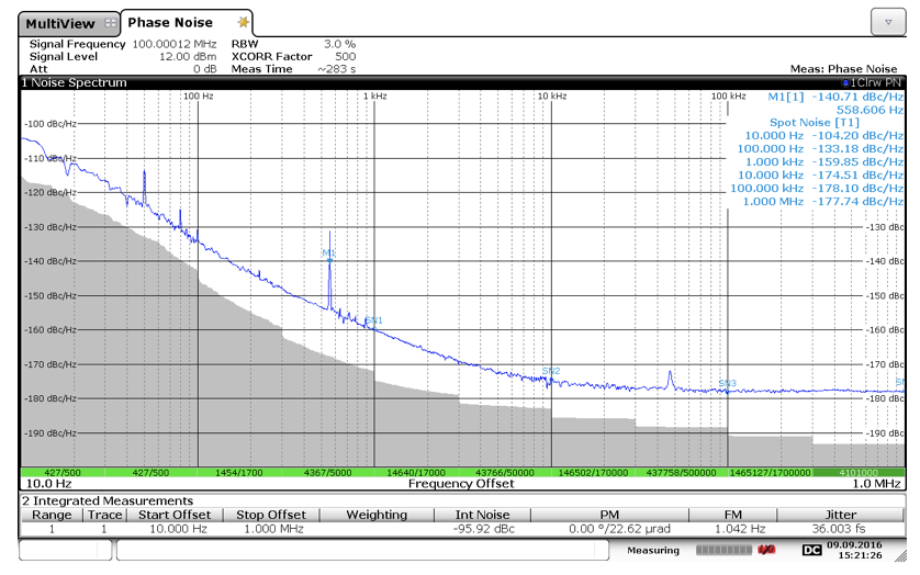

Hi
Im been watching this thread and can see a lot of pics of low noise osc.
So time to show the phase noise measurements of the 100MHz Oven-OSC from vectron. I use it together with ES9038 Dac.
Br
Caad
But a bird can shoot a plane, lol !
I'm now lost with this story of phase measurement between the Iancanada and Andrea ping pong game, I don't know anymore where to read when it's noise near the carrer and XO??
So the Vectron are bad but the analyser is spending the cost of an italian house ?
Ok I go back to my LP12, lol !

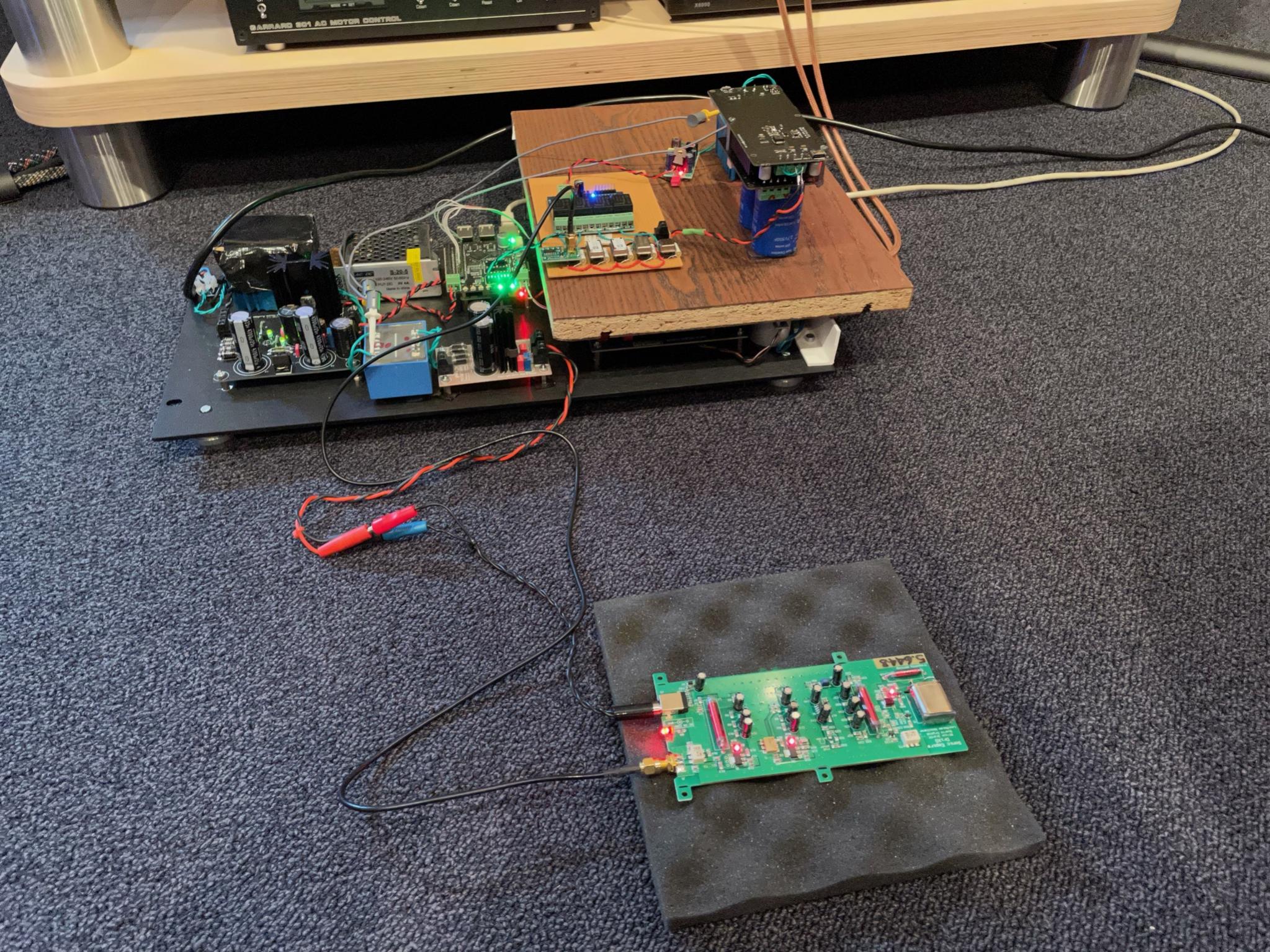

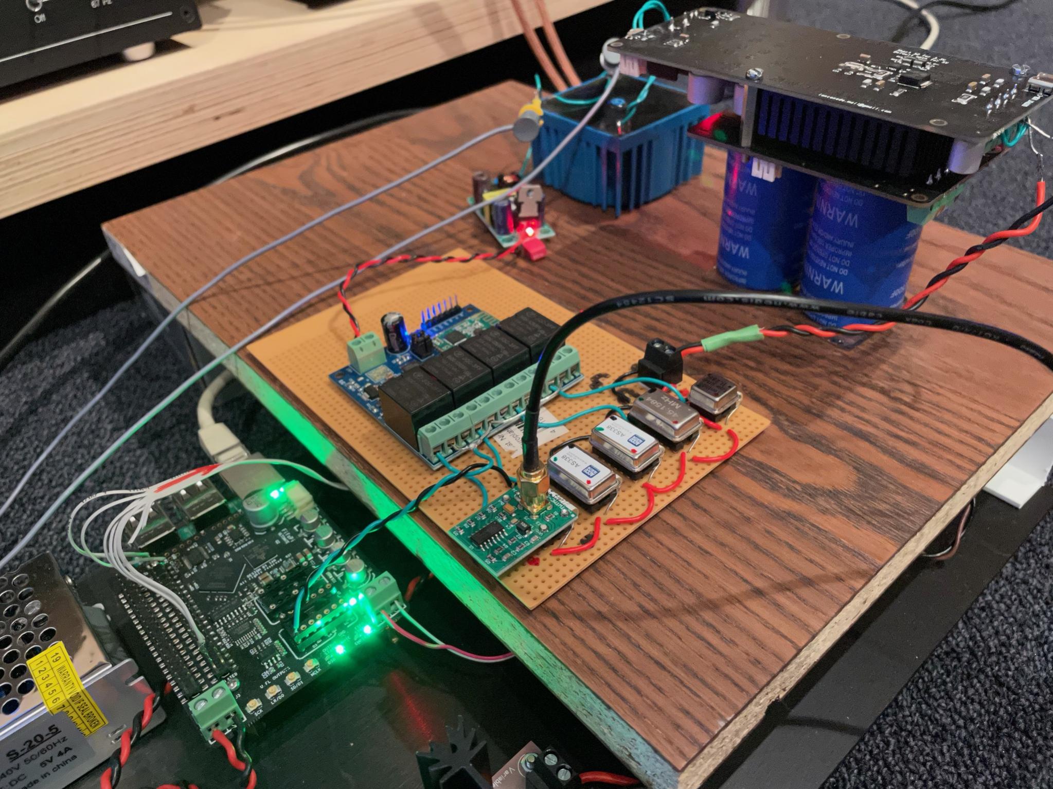

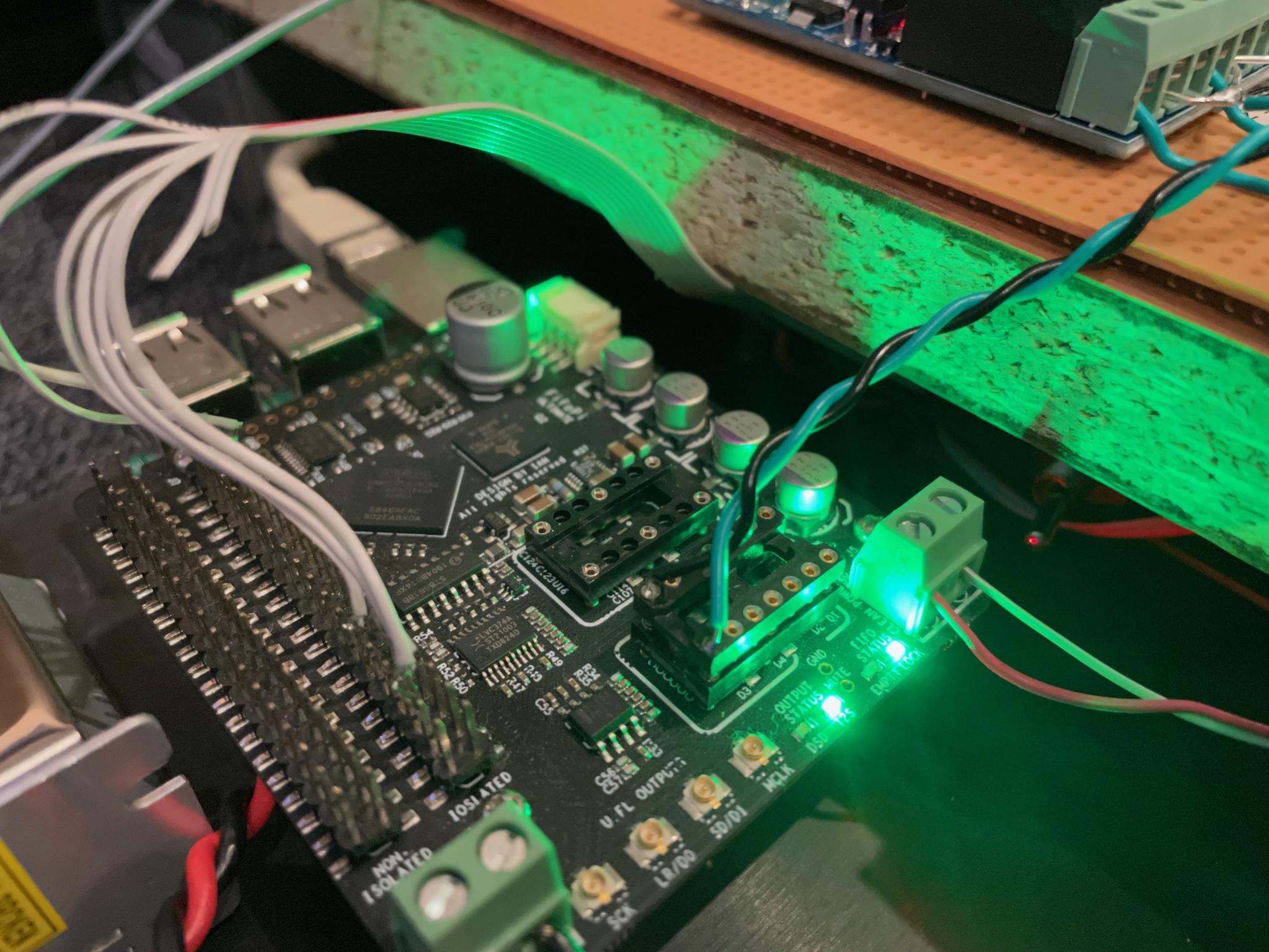

Hi Andrea,
I just posted part two of your clock Review !
This time versus Accusilicon 338 and improved clock power supply.
ANDREA's CLOCK - part 2 - DDDAC
Doede

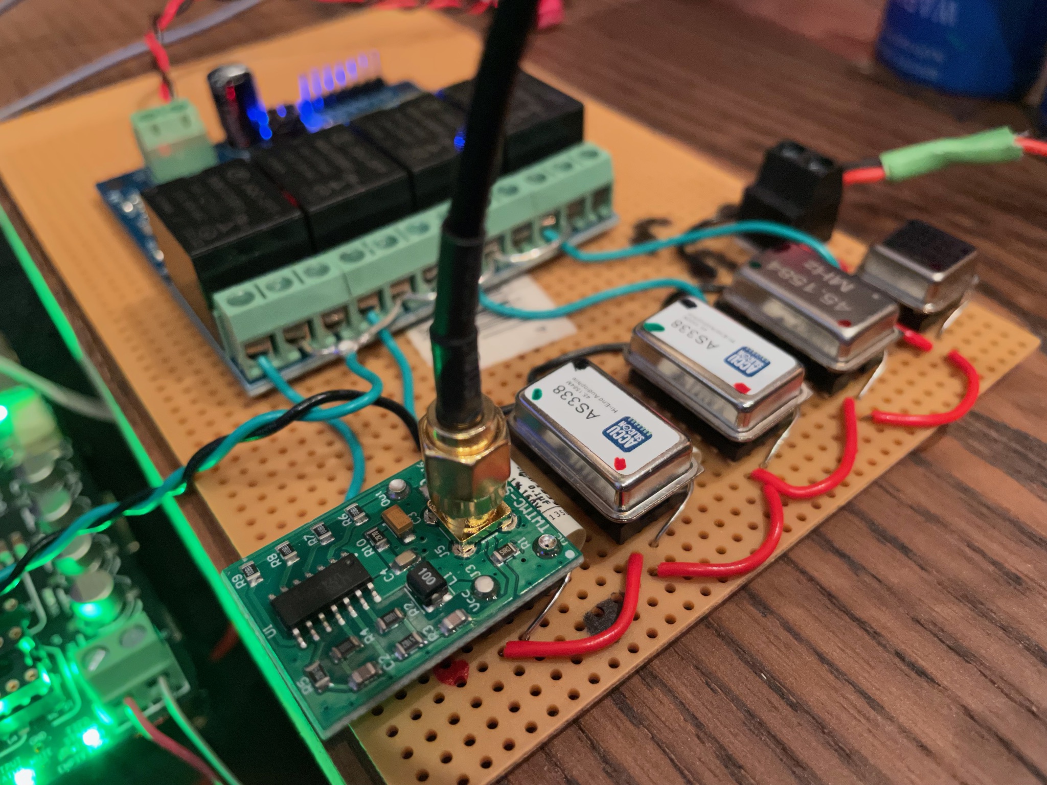

Hi Doede,
Nice work!
The previous driscoll with sc-cut crystal of Andrea is in a (sort of) dil14 package..... it fits on top of the fifopi but needs separate power supply.
If you like to do more comparisons I can lent you one of these and also a crystek (both 45mhz) Please let me know if you are interested.
You need 3v (or 3,3v) and 6v (or 6,6v) power supplies.
