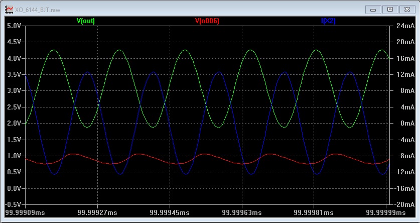

Hi Jesper,
due to the very high Q of the crystal I believe the Driscoll oscillator was the best way. So I confirm my previous suggestion.
I attach a simulation of the Driscoll oscillator using the Laptech 6.144 MHz AT-cut crystal. The green plot is the waveform at the oscillator output, before the squarer: around 2.4V p-p. The blue plot is the current flowing through the crystal: around 8.8mA rms. The red plot is the waveform at the base of Q1. With the component values suggested in the BOM of the TWTMC-D the power dissipated by the crystal is around 350uW. I think this is an optimal value, high drive level that means lower phase noise but below the maximum rating of 400uW. The loaded Q of the circuit is around 82%, so starting with the unloaded Q of the crystal around 780K you get a loaded Q around 640K, that's a good point to expect very low phase noise.

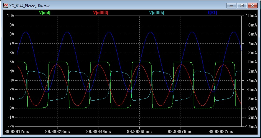

A sonic comparison with the Pierce type using the same crystal could be very interesting, since the Pierce is claimed to be very good at frequencies up to 20 MHz.
I attach the simulation of the Pierce at 5V power supply using the component values suggested in BOM of the TWTMC-P. The green plot is the output waveform after the squarer. The blue plot is the current flowing through the crystal: around 4.6mA rms. The red plot is the waveform at the input of the first inverter used as oscillator device: not more than 4V p-p, so well below the 5V of the power supply rail. The last plot (light blue) is the waveform at the input of the squarer: around 3V p-p. The power dissipated in the crystal is less than 100uW. Changing the values of some components (R1, C2, C3) one could increase the drive level, but there is the risk that the level at the input of the first inverter increases a bit, reaching a p-p voltage greater than the 5V supply rail, that's not a good practice. So I suggest to use the values indicated in the BOM.

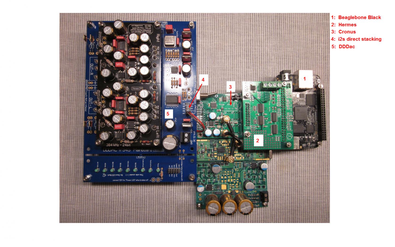

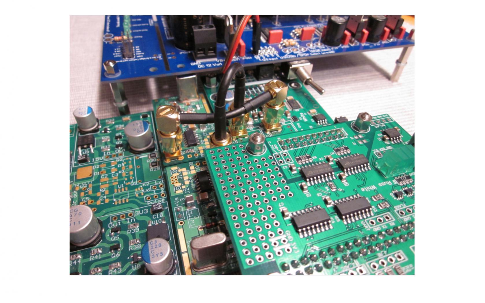

Hello Andrea,
in the meantime I managed to finish my project. The aim was to play a music file that was put in the ram of a beaglebone black (BBB) by a dedicated OS (Botic) directly via i2s to the dac ("DDDac"). There is only one clock that tells the whole system what to do - yours (Clapp). There is a galvanic isolation plus clock management (Hermes / Cronus). No conversion of the signal whatsoever. The signal path is extremly short. No cables at all. The connections to your clock I also made as short as possible.
Please have a look at the attached pics.

The whole system works perfect! I am using a 5-way all horn system that acts like an acoustic magnifier.
Before, I managed to play music the same way using a raspberry pi (RPI). Already direct i2s-connection, but no isolation and no dedicated clock. The system used the inherent clocking of the RPI. So a huge amount of jitter. Still one could imagine the potential of the direct i2s-connection...
But now I know what good clocking means! Simply fantastic...
