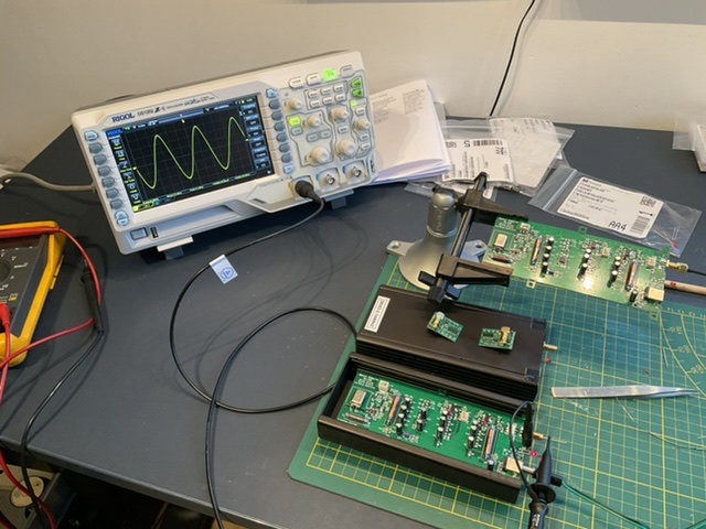

I have one 5mhz drixo running for a week, now the other three are also finished :cheers:
One set 5 and 6mhz for a TDA1541A dac.
One set 22-24mhz for dddac.
I have 4 doublers, one is finished for 5-11mhz. I will wait with the others to see what the most used doubling frequency will be.
I also bought me a 200mhz digital scope to replace my old tektronic 35mhz analog scope, I should have done this much sooner, the digital scope is much easier to use and has some nice features (and they are not so expensive)
Have fun soldering your boards guys. It is very rewarding!
