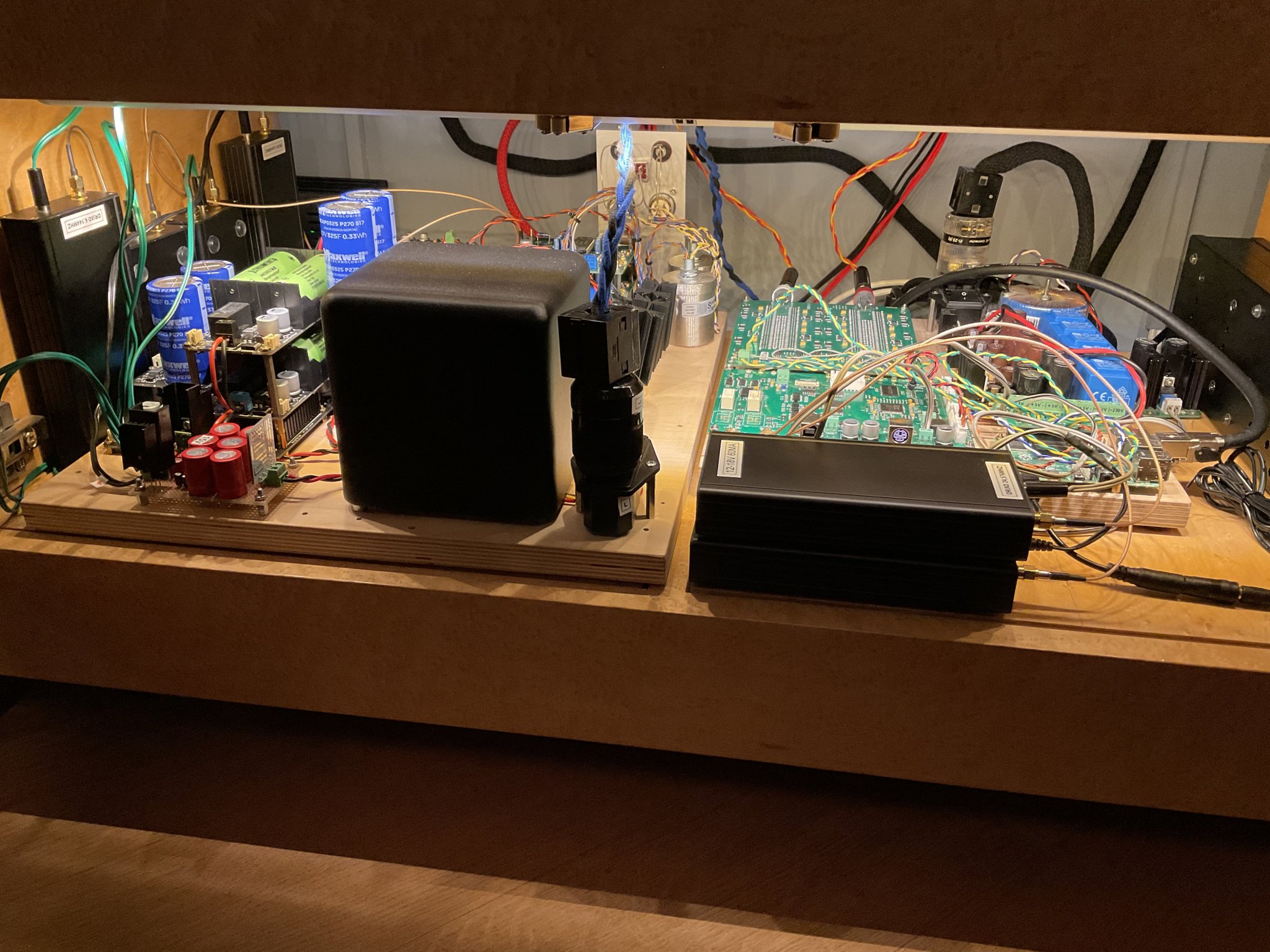

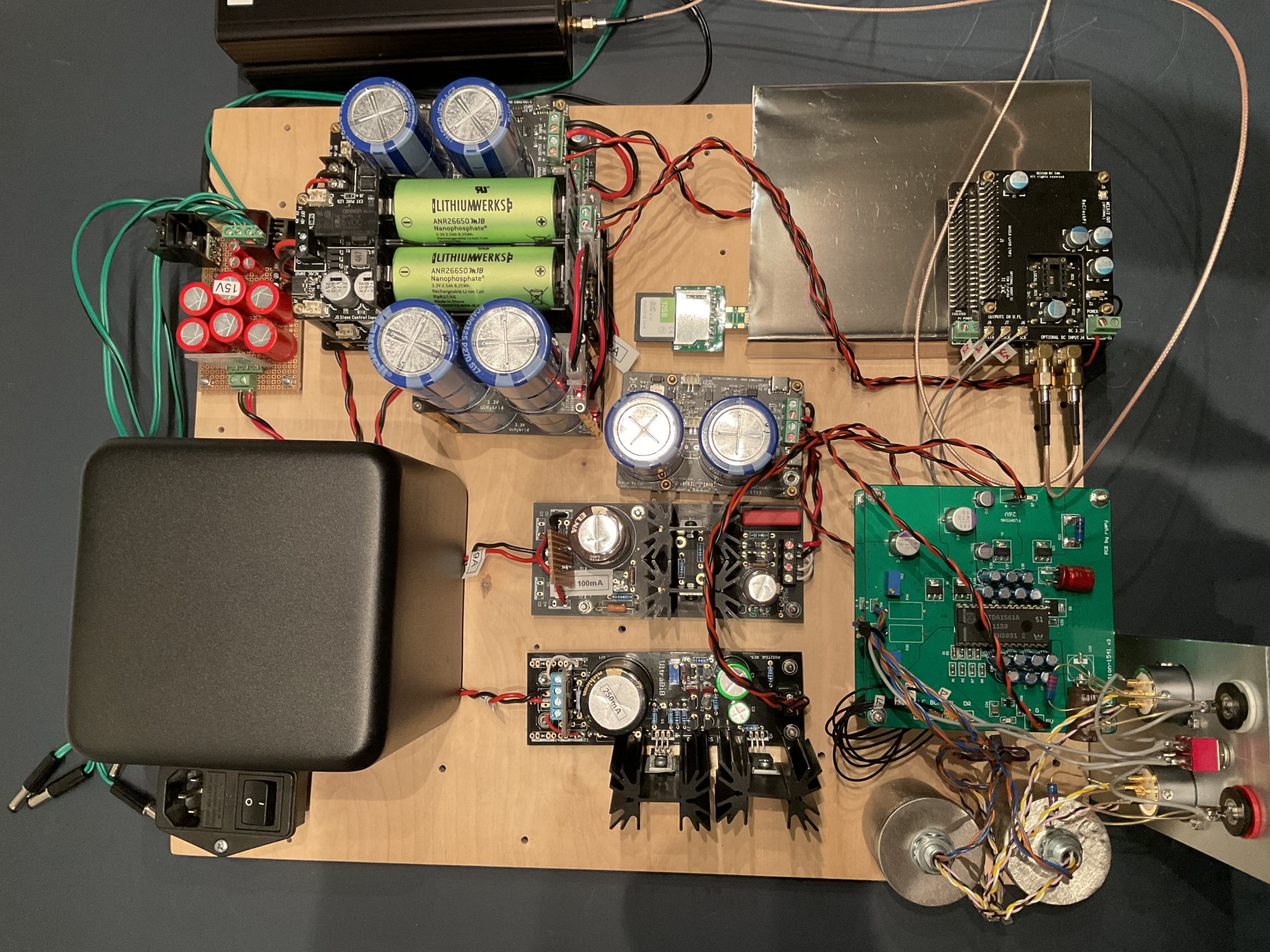

I got my sample of Andreas TWSDAC LT running!
The power supply for the dac is made with Sparkos Labs regulators and mosfet rectifiers.
It plays very well, very detailed, and dynamic. It is good, very good! I bet you will not find anything better for up to double the price.
But is it better than my current reference dac with the ancient TDA1541A in balanced mode? No, it is not. Voices sound so extremely natural on the TDA, and has a musical flow (an analog sound) that is very satisfying to listen to for hours and hours. I have never heard this quality from any digital source.
But I want the TWSDAC to perform better than my TDA dac, I need improvement😫
So now the experimenting for further improvement starts.
I am experimenting if the TWSDAC can be improved with changes in the power supply, l just lowered the VREF voltage from 5 to 4V to see if this changes the sound balance.
Another spot of improvement is maybe the power supply of the Raspberry Pi? I use an Allo Shanti now. And maybe adding some extra galvanic isolation will have a positive influence?
Has anyone experimented with this dac yet? I am interested in your findings.

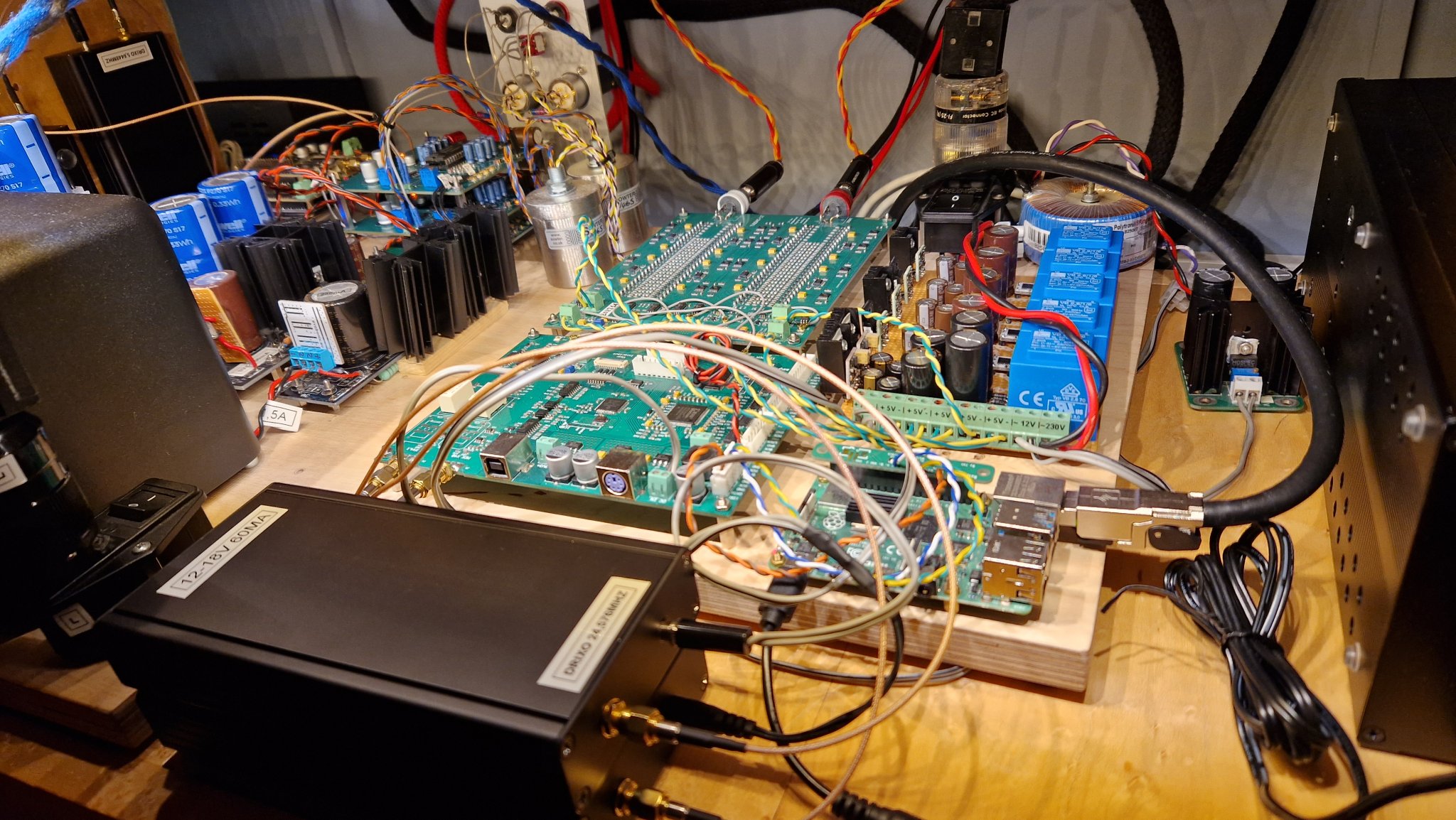

Supersurfer, interesting comparison and from the pics it seems you have a serious TDA1541 setup (if I am not wrong you are using the D3 boards).
Andrea mentioned in his forum that he noticed no difference in sound quality in the range of 4-4.7V for Vref, but that there are some who have preferred the sound using shunt regs there.
Are you taking the I2s signal directly form the Rpi? Have you tried going trough Andrea's HDMItoI2S or with the JLsounds I2SoverUSB cards? Have you used the same source and connections for the comparison of both DACS?
Finally, I see you have higher freq. clocks on the LT than on the TDA1541. I have no way to compare, but from measurements alone the lower freq. ones are better and Doede Douma (DDDAC) reported hearable differences too. Perhaps you could swap them form some time and check if the LT improves, most probably you already have.

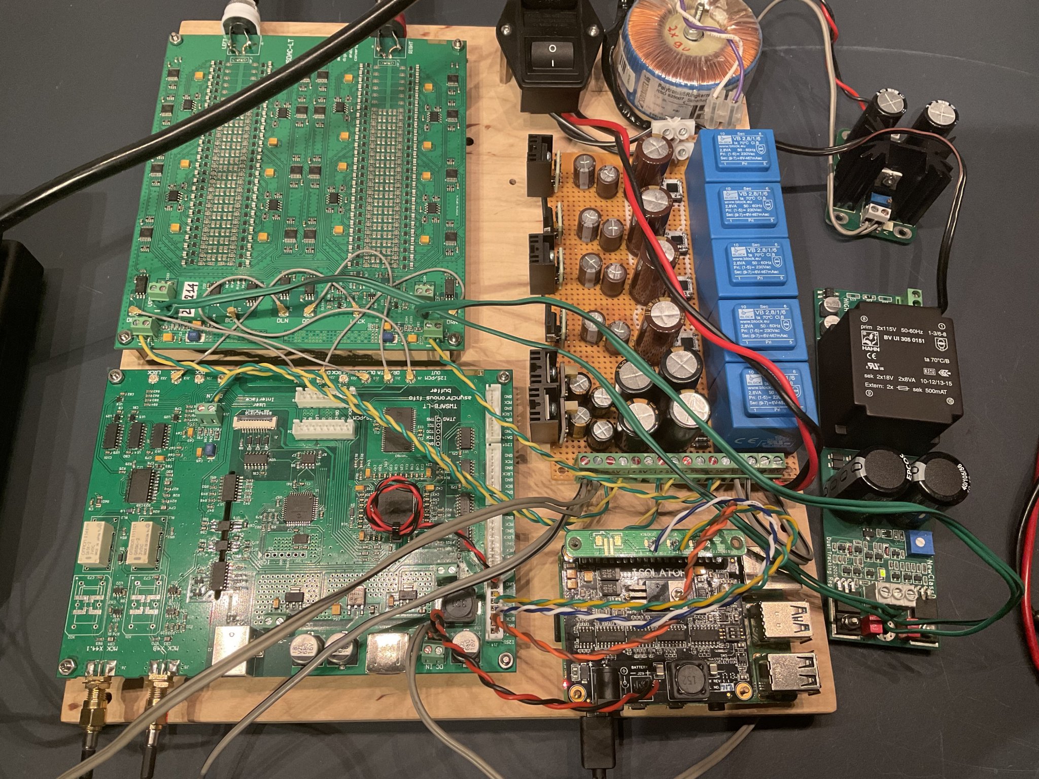

Supersurfer, I can see all those blue little power transformers, I think their primaries are connected in the same way. I mean, pin 1, as an example, to neutral and pin 2 to the 230V phase. For ALL of them. Try then swapping the two wires. And listen again, critically.

The TDA1541A is indeed the D3 boards in balanced mode with the I2S-SIM board from Ryanj. I have planned to build 2 extra boards to add them in parallel. This dac is fed by an Allo USBridge sig with fifopi Q3 and reclocker, power supply of the streamer with supercaps and the dac with ultrabib and reflector shunts.
I have the 5 and 6mhz clocks from Andrea on the TDA and currently the 22-24mhz clocks on the TWSDAC LT, will switch them later to evaluate but I have already extensive experience with these on the TDA dac; the 5-6mhz are indeed better sounding but in a different way as the differences between both dacs I am hearing.
subjectively the 4V on VREF sounds a bit better than 5V, but as I have also changed the regulators from 5V sparkos to 4V new class-d there are more differences than only the voltage. Looking at the specifications the Sparkos would perform better though.

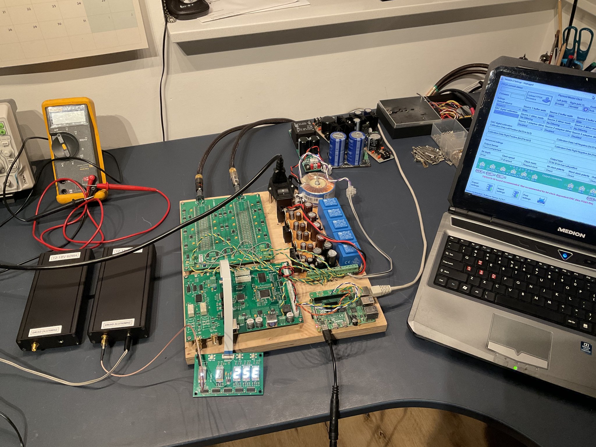

I had an Allo Isolator in my parts cabinet and just installed it to see what kind of effect this has.
You mean to put the phase on the other pin for all transformers? Just like plugging the ps cable reversed in the wall socket (you can do this in Europe you know)
Supersurfer, I will definitely be following your experiments with the FIFO+LT, I should be getting mine soon.
I believe the source (plus source PSU) and clock should be the same for a closer comparison. While the FIFO (+ iso) should decrease the impact of the source, I don't trust much the direct I2s out of the RPi.
What kind of regulation does that newclass-d have?
Even if you find at the end that the TDA1541 DAC suits you better, you can compare Andreas FIFO to your other one, who knows if it will still make it better for you.
