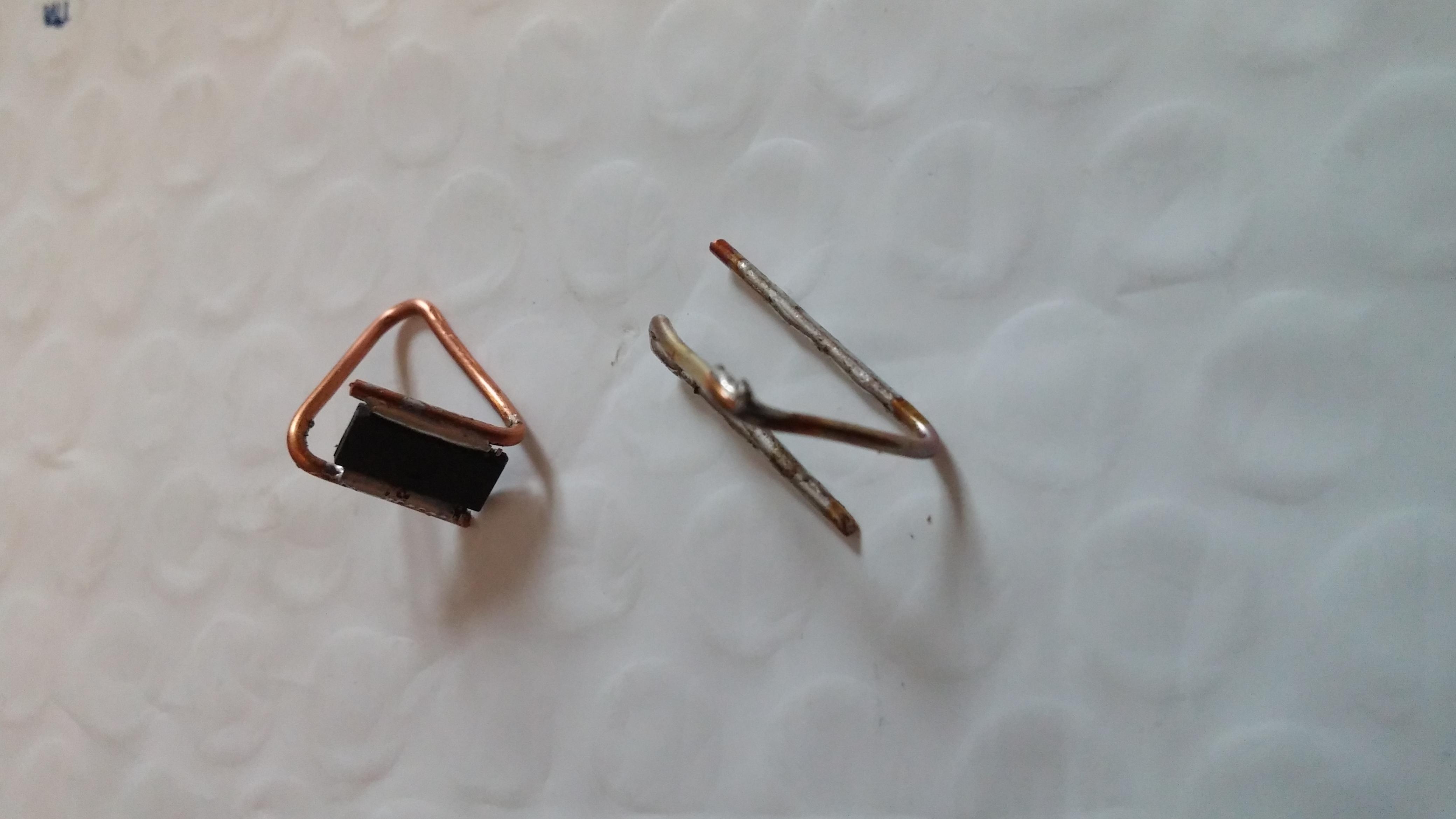

I read a trick from Elektor mag, to remove a TSSOP (TPA) or pqfp. I tried it, works great. I used two Weller soldering irons or a big one if you have it. Take some bare solid 18AWG Cu wire. straighten, and form/run wire along the first row, bend 90 at the end of the first row. Leave a little over hang on both ends. Form so that wire has about ~2cm height, fold back to opposite side & corner, run along other side of leads, cut to fit. straighten, flatten against pins. Looks like a cone when done. You want the wire to be up tight against the place where the leads bend to form the solder land area.I installed the TPA backwards on the 2nd board (that's gonna be a fun rework job...)

FRYING PAN WORKED! Worked extremely well and didn't damage the PCB at all. I did yank off the TPA, 78L05, AVR, 10uF caps and lots of other things to salvage but I'm wishing I only took the TPA off.
Probably #3. That's my "overclocked" burner though, the stove runs off propane but I've got a natural gas jet in that spot that flows about 60% more. Great for searing thingsHere is a pic of the IC remover gadget, nice to hear about the skillet removal method as well.
So you put the pcb in the fry pan and set the temp for around medium, #4-6/10?
