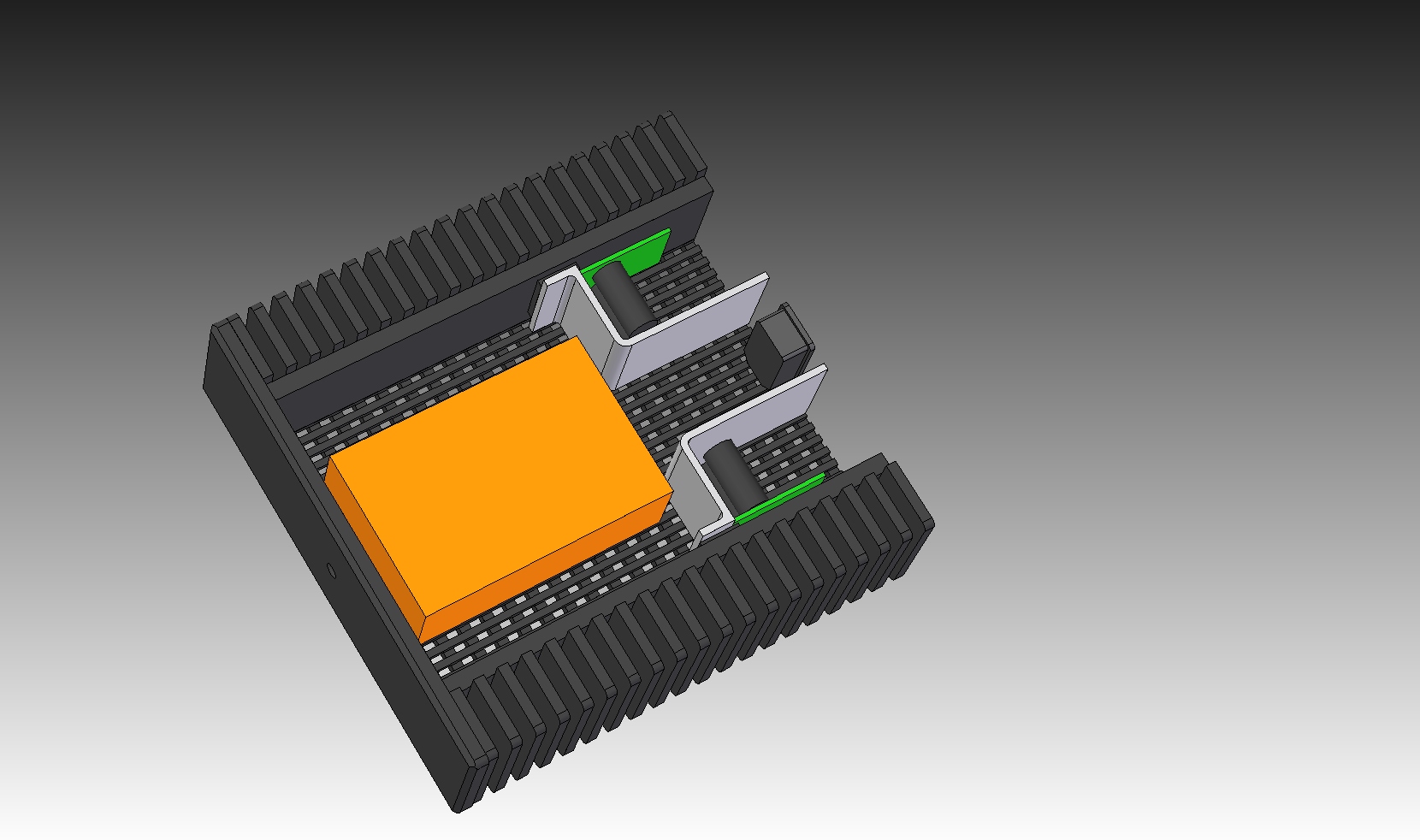

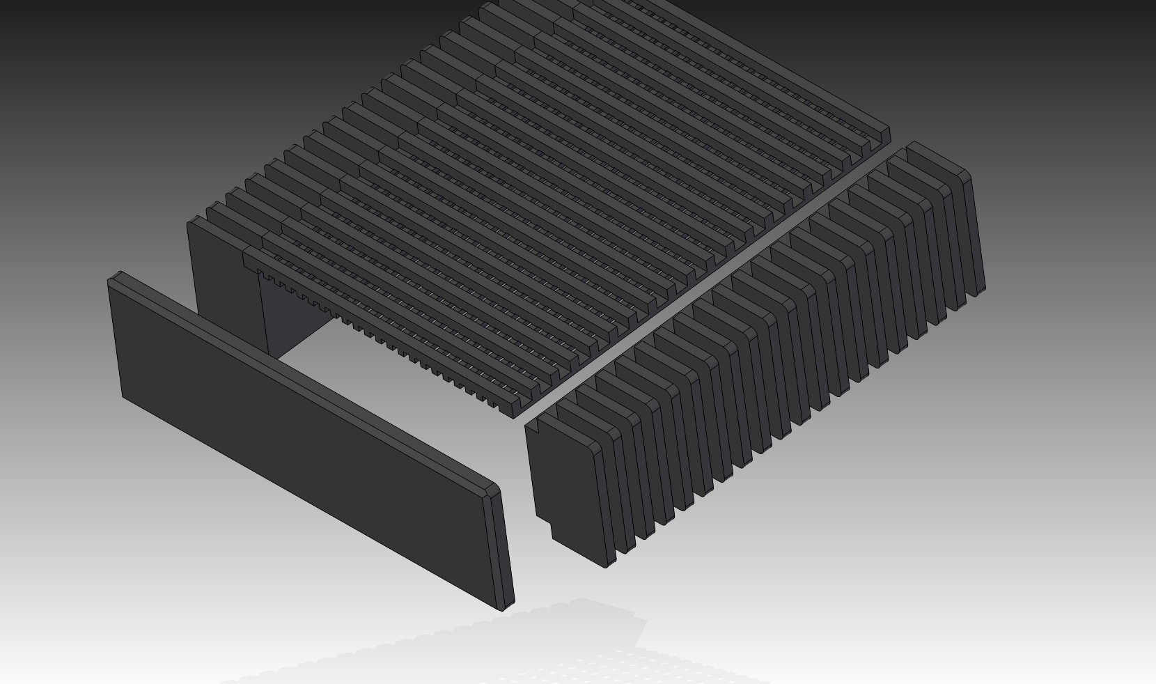

I've started thinking about a chassis for my amps. Previously I was thinking of fitting all 8 channels in one large chassis, but I think I will build them as 4 separate stereo amplifiers instead. This will give me more flexibility in future.
My goals are to make the chassis as compact as possible whilst still providing adequate heatsink area. With this in mind, I thought about the possibility of using the lid and base of the chassis to act as an extension of the main heatsinks.
I did a quick model based around the assumption that I'll use an SMPS, and probably mount the amp modules sideways, with the input towards the rear.
Any thoughts on this approach?

Nice drawings Can you get extrusions or castings like those?
If the sinks are thin and the output devices are toward one end, that end tends to be hot and the other end cool and not helping much to dissipate. That's when a thick base is needed. As I said earlier, Meridian 605 has a 22mm base and they are still quite a bit hotter at one end.

I'll be CNC machining the components so don't need extrusion or casting.
I'm only planning on running one pair of fets per board. My woofers and subwoofers are 4 ohm and with Cristi's new SMPS I will probably chose something around 50-55V. This might be pushing the pair of fets a little, but I will probably run quite low quiescent current on the woofer/subwoofer amps to help keep them cool.
Mid and tweet amps will only see 8 ohms, and I might go for a lower voltage. For these I will push the bias as far as required for best results (Assuming temp doesn't become an issue)
I'm not too worried about sharing one SMPS between 2 amps, as they won't be sharing left and right channels.

Very nice work on the chassis! I like the symmetrical layout, and the way you've kept the power section shielded from the amps. Using the shield as a heat spreader on the top of the output devices is also a clever idea, and will definitely help to keep even pressure and might even dissipate a little heat if you use a thermal conductor between the top of the fets and the shield.
As for orientation of the amp itself, I don't really think it makes much of a difference overall. You're talking about a difference in cable length of about 2 inches which is nothing compared to the several feet needed outside the enclosure. If anything, it would probably be best to keep the inputs as far from the AC inlet as possible, which would probably mean orienting the boards with the input to the back and the outputs to the front. This also allows you to get the fets as close to the middle of the heatsink as possible.
On that note, Ian is correct about using a decent size base for the heatsinks, especially if you mount the fets way off centre. There are diminishing returns on that though, and once you hit a certain thickness, there's not much sense in going any further. Same applies to fin length.
As for the crosshatch top and bottom, I think it would provide a huge amount of passive cooling capacity if you can thermally bond it to the side sinks in an effective manner. The cross hatch pattern would definitely encourage convection cooling, so it's just a matter of getting the heat into those parts.

The heatsinks I've drawn there have a base of 10mm and fin height of 40mm. Anything you see there is very much open to suggestion and those models are more of a proof of concept at this stage.

Yes, base thickness and fin length/width/pitch can be anything I want within the limitations of my tooling.
I'm using MiniDSP.
