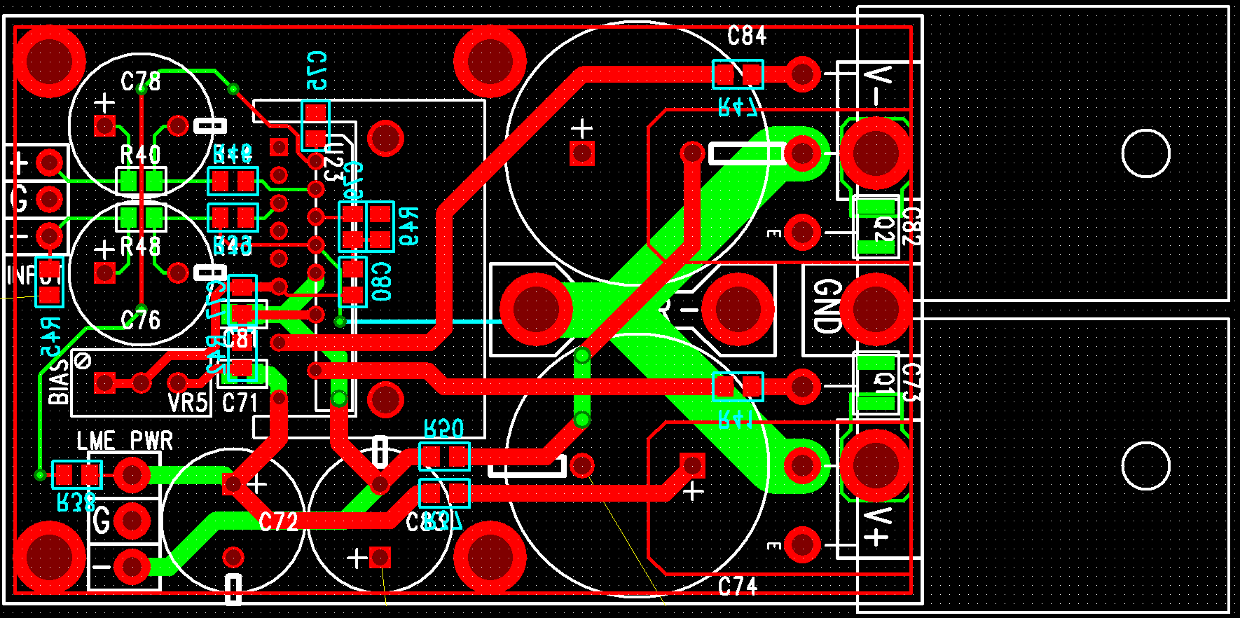

Very nice design, thank you for sharing and organizing the GBs.
Schematic Comments:
1) Datasheet says Cmute should be no less than 47uF. I see a 10uF cap.
2) Datasheet recommends a decoupling cap across Vcc and Vee. This is shown in the demo board design as Cs13. It seems to be missing.
Thanks!

Hi Guys,
I've updated the list and it should be accurate up to this post. Please check it every now and again to make sure everything is correctly entered.
I've also updated the schematic and the layout to remedy the error with the D-S swap. I've attached both for review.

Thanks for the comments! the more eyes on the schematic the better.
They are specifying a 47uF to avoid clicks and pops when using a mechanical switch to mute and unmute the amplifier. I think it's essentially acting as a an RC debounce for the switch.
In our application, we won't be using a switch, but rather tying the mute pin to the VCC supply for the LME itself. We do this by using a high value resistor and a capacitor to essentially create a turn on muting time constant. In that application, the capacitor and resistor are used to keep the amplifier in a mute state until the power rails and up and stable, usually about 1 or 2 seconds. For that application, all that is needed is a good 10uF ceramic and the appropriate resistor for the chosen rails. The resistor value is listed in the spreadsheet. Hope this clarifies why a 47uF is not being used.
I generally don't feel that this is necessary as long as the existing rail to GND caps are properly implemented in the layout. the LME reference board is surprisingly poor in its layout, and the use of PTH caps makes for generally poor decoupling. In this board, the large SMD caps allow for nearly perfect decoupling of the rails directly at the input, and again on the LME pins. If these caps are properly placed, as they are on this board, there is no benefit to adding a rail to rail cap.
