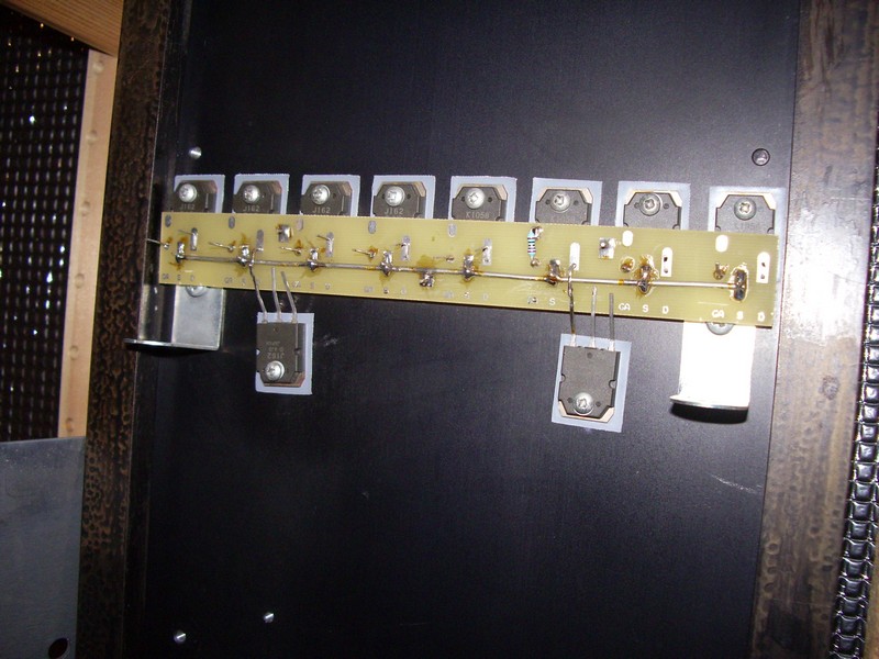

...a rats nest of wires hanging off the end of a very high BW amplifier
They wait and wait and one day a circuit might join them :)
Just the two supply wires and the two gate wires and the output to join on.
The 9th and 10th were just to see if they fit neatly. I think they do :)
The plan is to affix the 6 or 8 main res caps on a support board just over the mosfets so the ± wires are as short as possible.
The circuit was to fit between the lower two mosfets.
The 1000VA bolts just up from there to a standoff plate (leaning on the left in the pic).

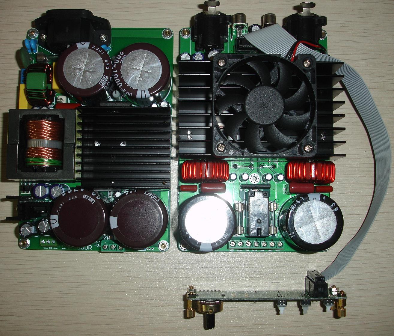

SMPS800R
The topology used for SMPS800R, SMPS500R, SMPS300R and SMPS2000R is LLC resonant converter where the primary switches are soft commutated, at nearly zero voltage and secondary diodes are commutated at zero current.
One of the main advantages of using this topology is that it does NOT require an inductor on the secondary side, between the rectifiers and capacitors, and adding an inductor would worsen the performances as would be seen as another series inductor with transformer from the primary side and would affect the resonant tank parameters. Another important advantage is that the maximum voltage on the secondary diodes does not exceed 2x the output voltage for the single output version and the nominal voltage for +- version. This would greatly reduce their voltage stress, allowing lower voltage rating diodes to be used. Also the diodes are switched at zero current, reducing the current stress. For SMPS300R, SMPS500R versions with output voltage up to +-60V i used Shottky diodes only, given the fact that their reverse recovery charge is nearly zero, and the forward voltage drop is very low, under 1V and tipically 0.6-0.7V for 100V devices. The suggested diode would be only be suitable for high output voltages, above 150-200V on each rail, as it's Vf is higher, 2.1V
When i designed the SMPS800R the main use was to be paired with a TA3020v3d amplifier module, to build a compact amplifier. Both boards have same size, 100x150mm and the empty space next to the SMPS800R IEC connector was used install the speaker output terminals. The supply cable from the power supply to the amplifier would use a ferrite bead 16x30mm similar with those used for computer monitors signal cables, which would be a very effective common mode filter. The choice of the secondary side capacitors was made based on the highest capacitance per volume ratio, and i found that using a single large cap would give more capacitance than several smaller ones.
For the current project, i consider designing a power supply from scratch, and beside the LLC topology, a simple QR half bridge might be used as well. With both topologies are advantages and disadvantages, and i will try to expose them in a future post and disuse upon then before deciding which one should be used.
