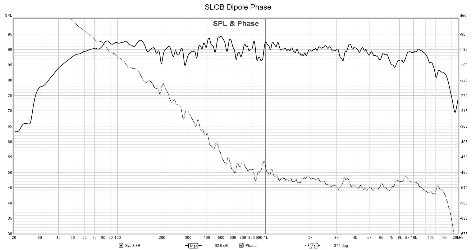

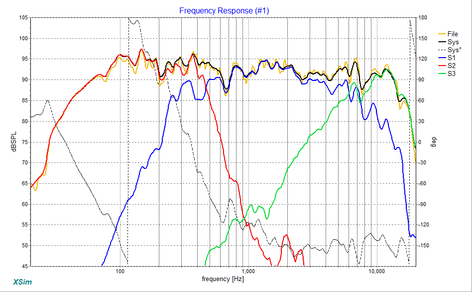

Predicted (black) and measured frequency response (yellow):

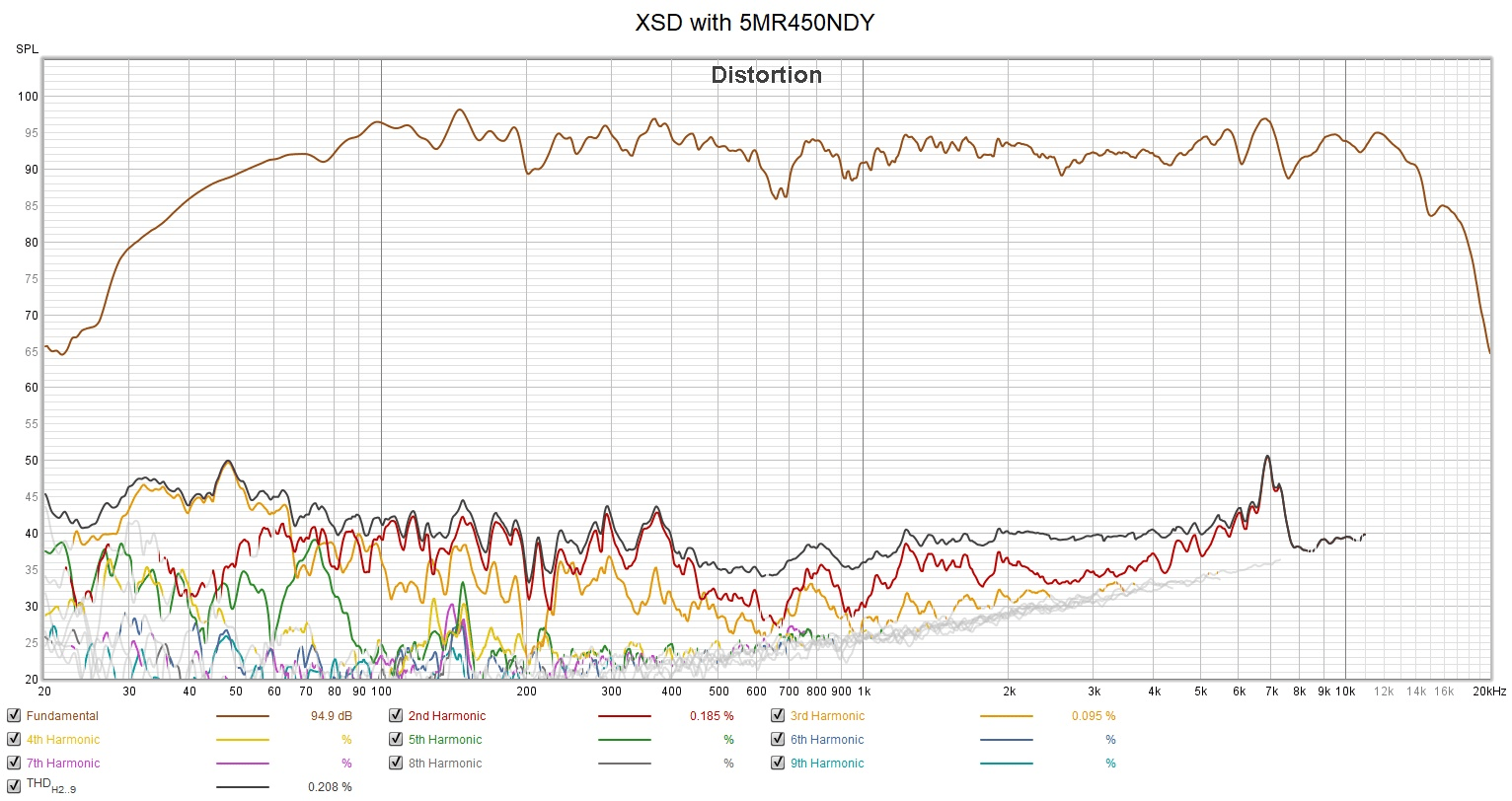

Harmonic distortion at 1W:

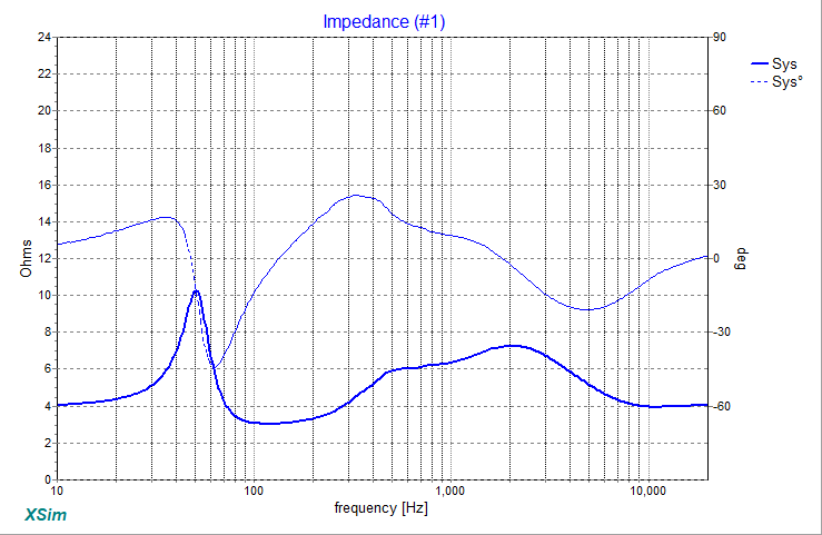

Impedance as seen by amp (it’s a 4ohm speaker):

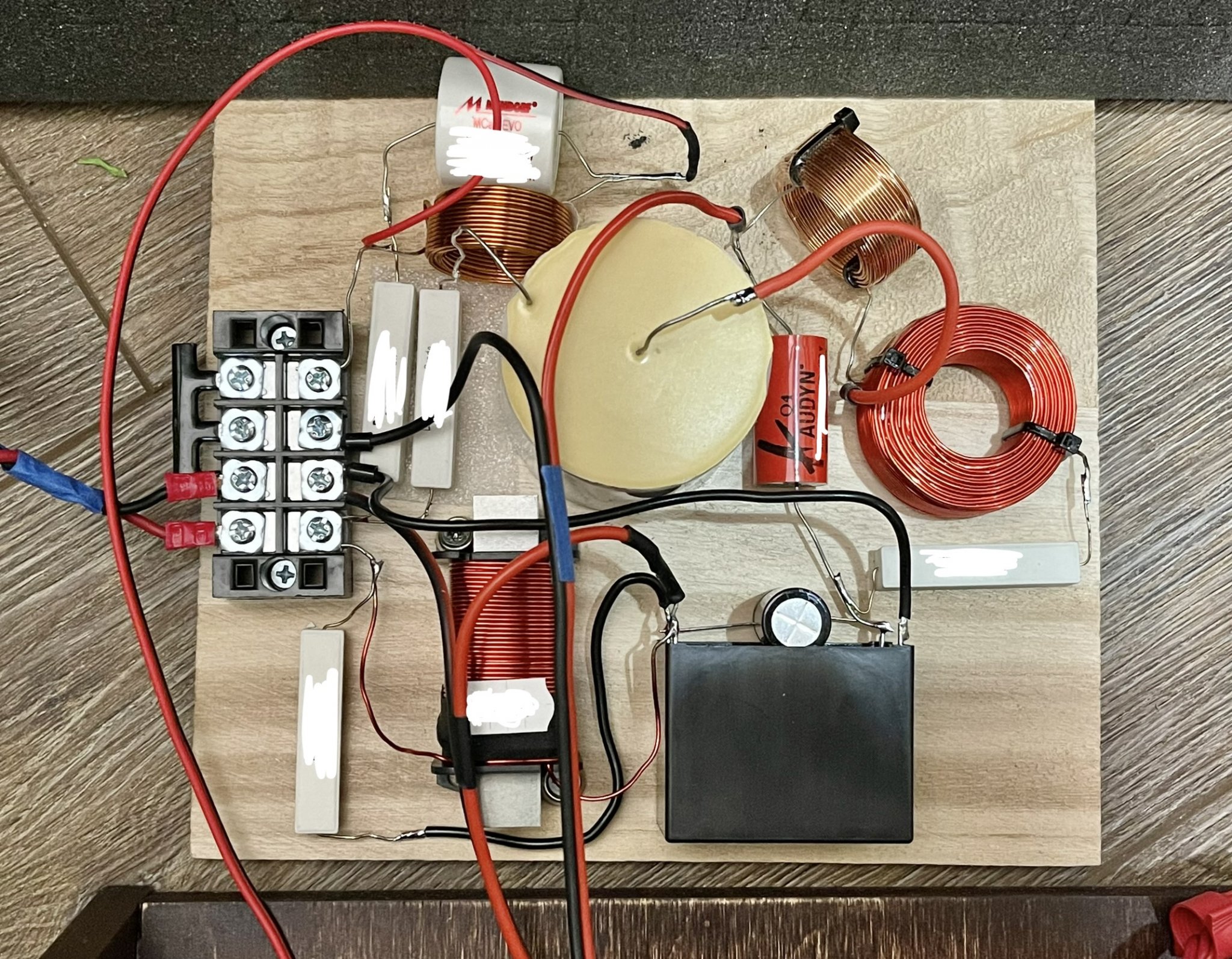

Passive crossover design (values redacted because this is a commercial design):

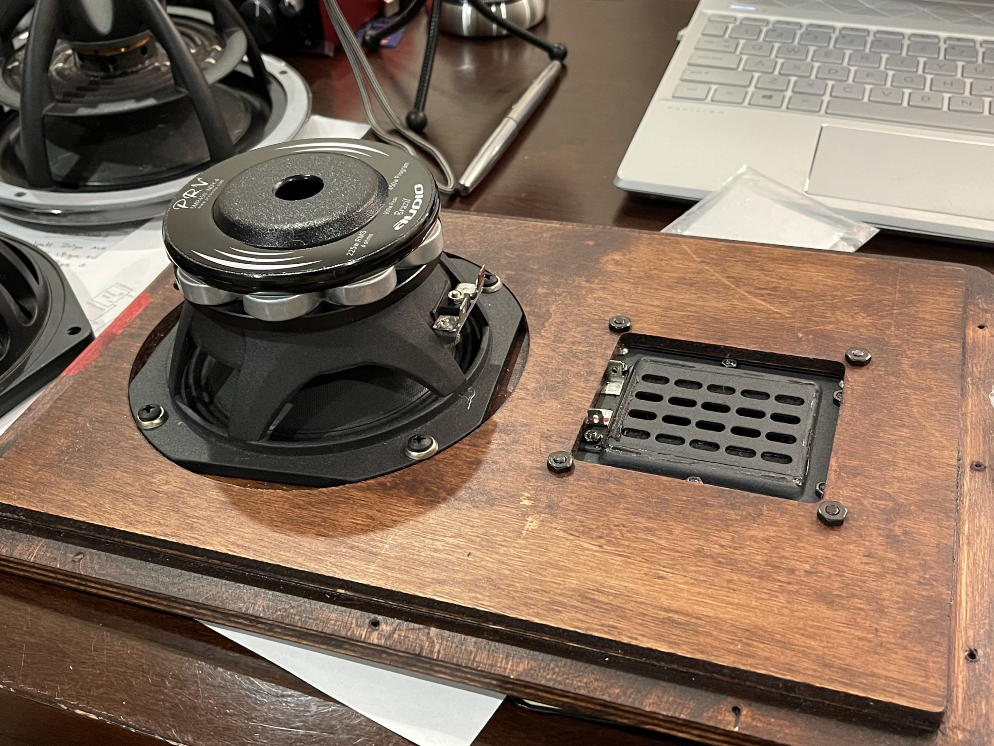

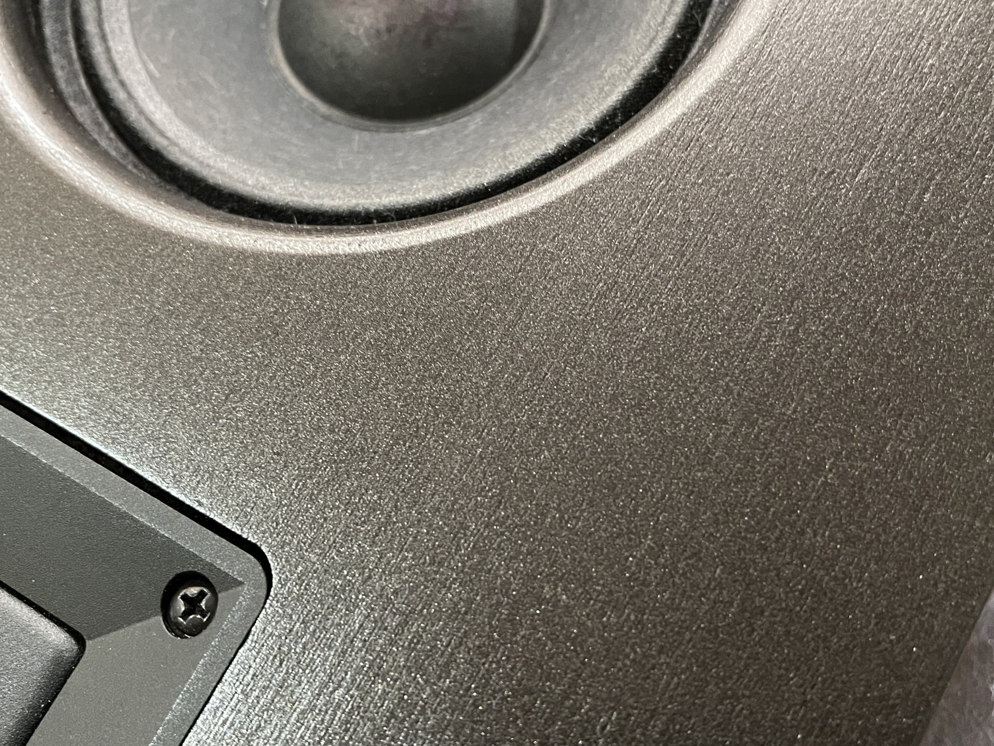

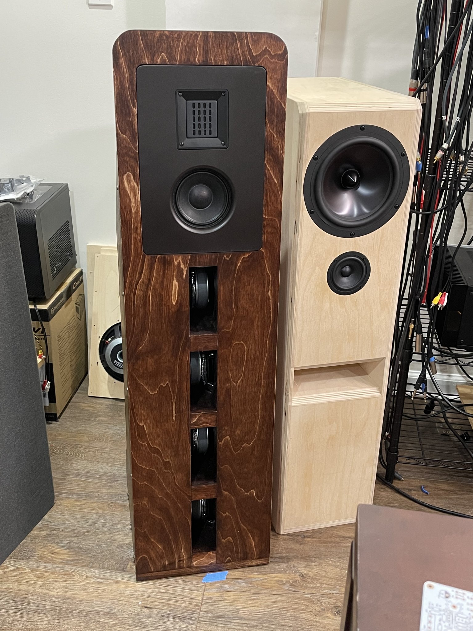

Detail of the planar tweeter (GRS PTT2522-4) with custom CNC’d waveguide and PRV 5MR450NDY midrange (those of you with hawkeyes might notice the PRV is labeled 4ohms - it’s actually an 8ohm, mislabeled as 4):
Detail of midrange and tweeter from the front with painted baffle board (paint is Rustoleum Uni“Oil Rubbed Bronze” for those interested):
Here’s an earlier version using a 6FE100 mid. Very nice but the PRV is better:
You can see that the phase variation of the tweeter and midrange through the 4700Hz crossover range is very smooth as the phase is almost flat. This would indicate a near quasi transient perfect time alignment of the midrange and tweeter. This will give very convincing percussion and snap for things like drums, guitar, piano, stand up bass etc. The woofer however, because it’s a slot loaded design, has some inherent time delay that’s not so easy (impossible) to make transient perfect with a passive crossover and a flat baffle. However, this doesn’t detract from the realism as the bass below 500Hz doesn’t define the timing realism from a listening standpoint. Plus, this is an open baffle design and the sounds come from many reflecting surfaces front and back of the speaker just like a real drum or bass would sound in a live performance.

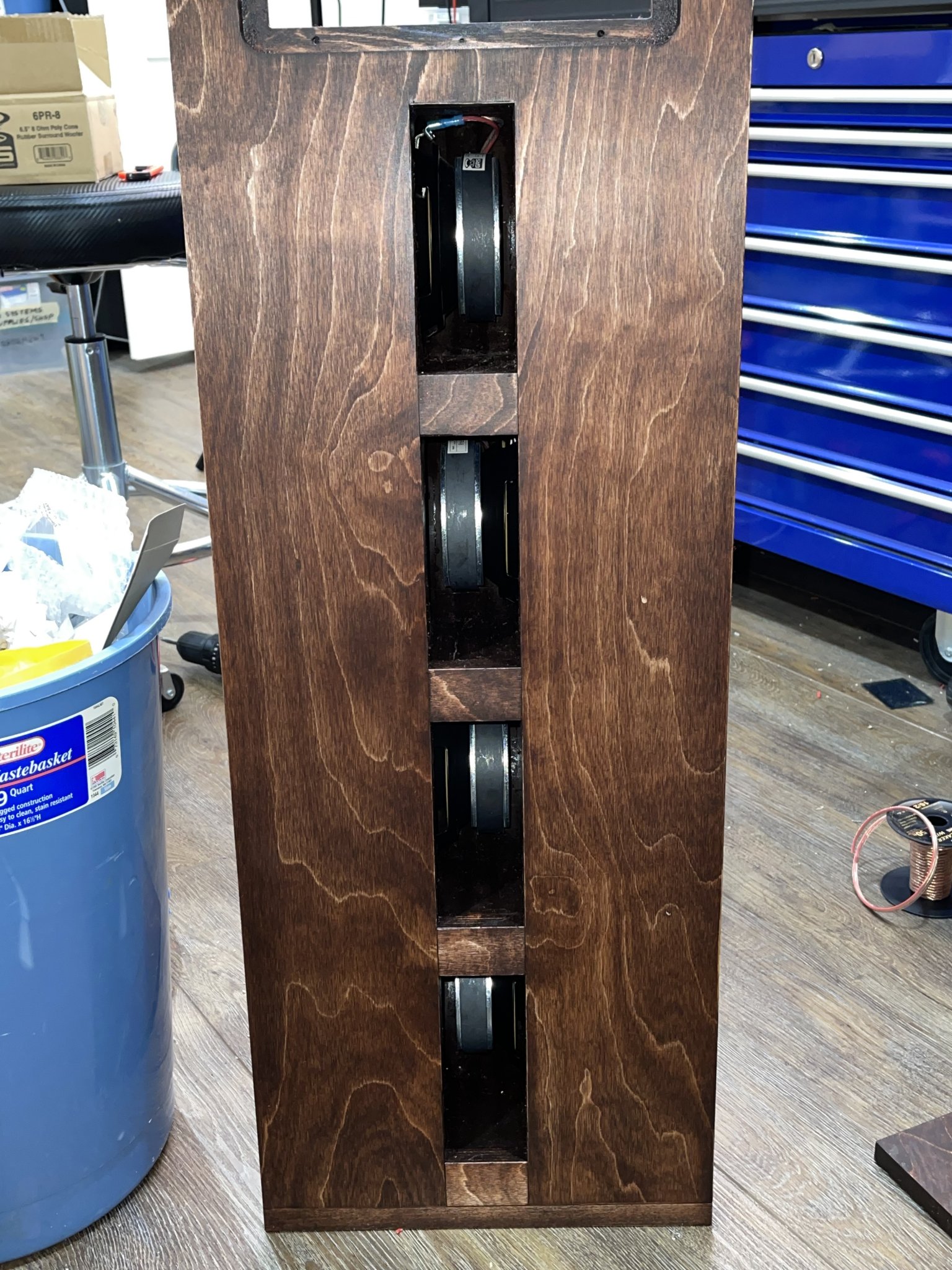

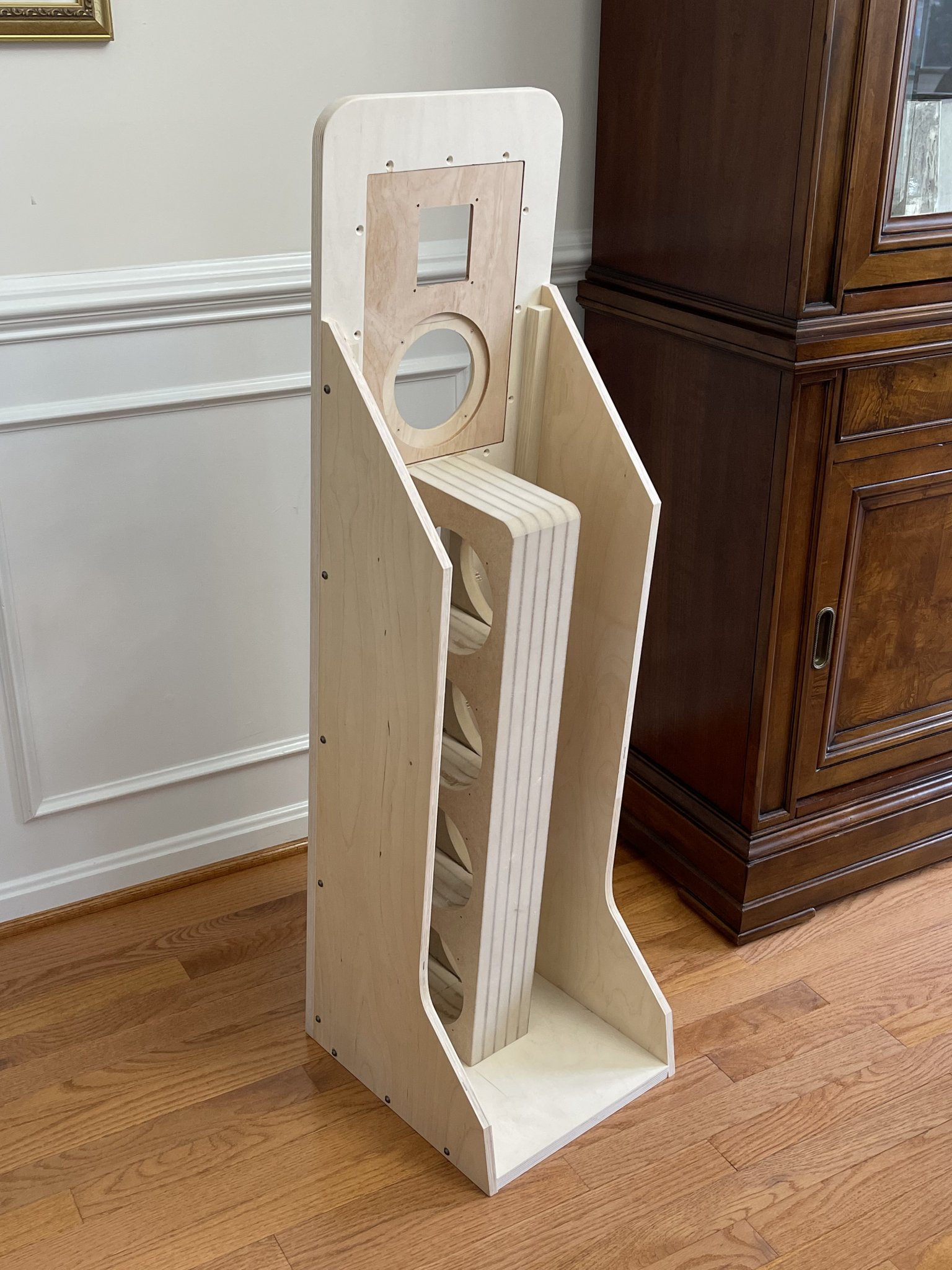

Here is how the slot loaded woofers are setup. They are arranged cone to magnet but wired so both diaphragms push the air out of the slot on a positive signal. This allows the natural asymmetric suspension non linearities to self cancel. The magnet inside the chamber also reduces the chamber volume and this allows a higher upper bandwidth for the woofers. The chamber depth from front to back dominates this but the volume plays some effect. The slot dimensions are 2.25mm wide x 5.5in tall each. The idea is to have the slot cross sectional area to be about 33% of the cone area (Sd). This will give a good tradeoff in slot loading to enhance the bass efficiency and to not have too much of an overshoot. By keeping the depth of the slot as short as possible, we can keep the upper bandwidth higher. We are able to get this woofer array to play up to 470Hz before a natural band pass fall off occurs. We can use this natural falloff coupled with an electrical low pass filter at the same frequency to get a 4th order steep falloff for using only a 2nd order filter. This reduces woofer mid range leakage above its passband. Also, with opposed drivers, the cone motion vibrations end up self cancelling. So the speaker has very little vibration despite delivering a massive bass punch.
Speaking of punch and slap, this speaker has perhaps one of the best I have heard. At 91.5dB (some mid bass is at 94dB), it does not take much amp power to do this. I can easily reach loud (but clear) 85dB to 90dB SPLs at listening position with only maybe 6Vrms. It’s a very dynamic and powerful big sounding speaker. But at the same time, can play softly while still delivering very nuanced bass. Bass from dipole that is tall like this 4 slot array also has less floor bounce issues and almost no room modes. You can walk around and the bass is very uniform. The woofers I used are GRS 6.5in poly cone rubber surround 8ohm budget drivers. 16 of them will cost you a little over $200. The amount of air that can be moved by 16x 6.5in woofers is not to be underestimated. It is incredible and about a little more than two 15in drivers per side. But the front profile is much more family (wife) friendly 12in wide. The floor footprint is 12in wide x 14in deep. It stands about 45in tall

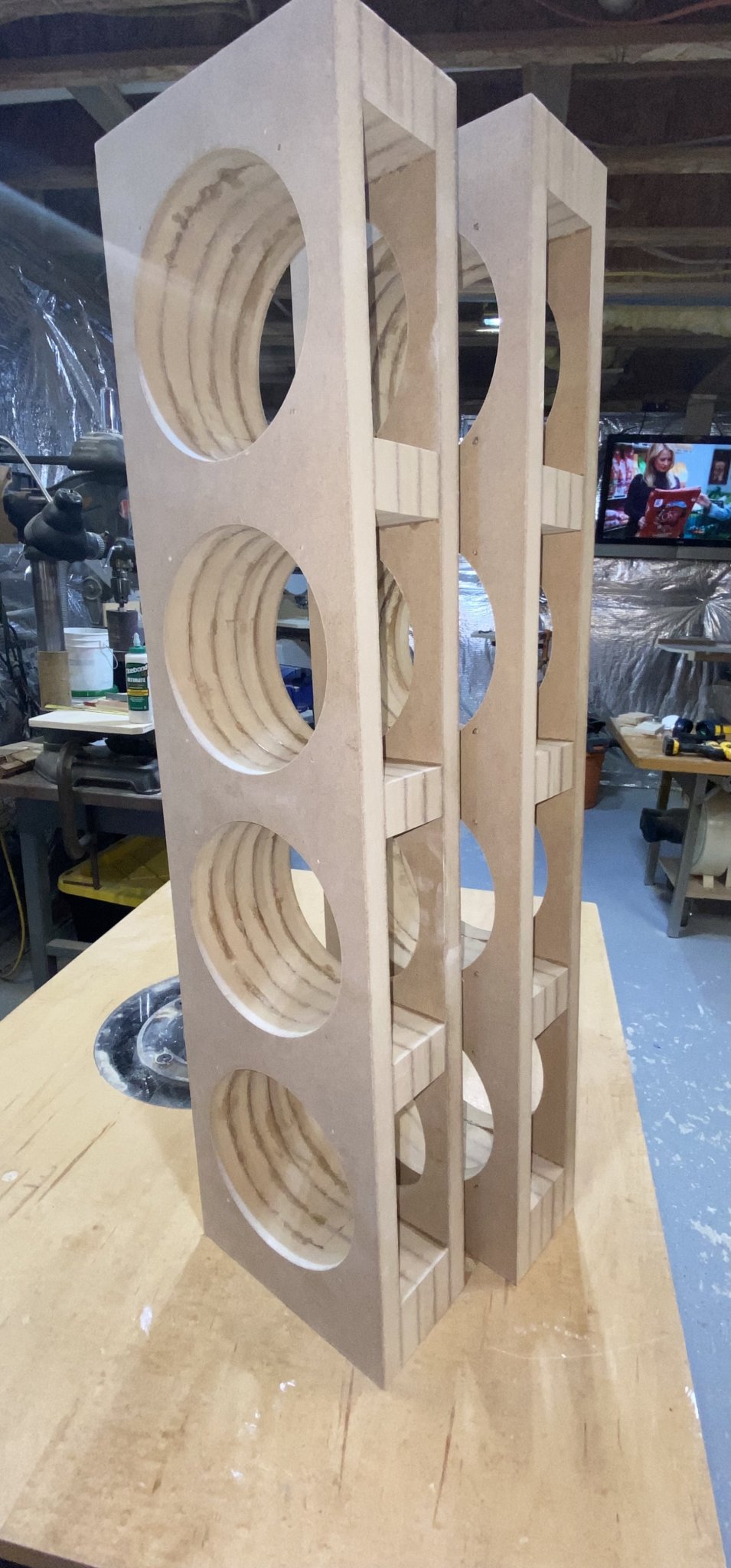

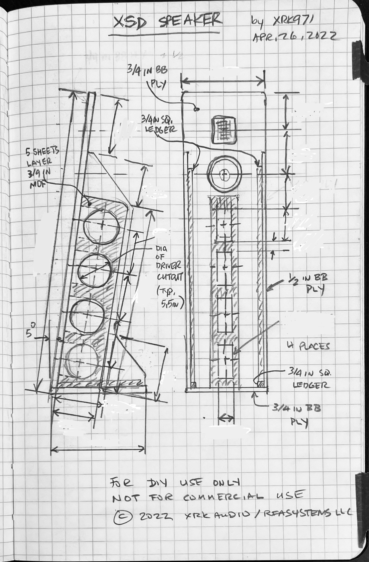

The bass arrays are built using 5 sheets of stacked 3/4in MDF:
About 8in deep side U wings surround the woofers to extend the bass as if the baffle were closer to 28in wide:
Lining the back wings with felt it acoustic eggcrate foam helps to make the sound cleaner. It’s optional though. Sounds quite good without it.

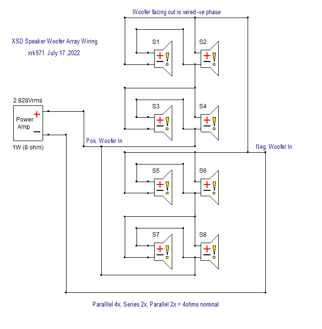

I should mention that the woofers are wired 4x parallel, then two pairs of those in series, then a pair in parallel at the end. Make sure the opposing ones are wired correctly so that they both squeeze air out when the signal is positive. This results in a 4ohm nominal impedance and a sensitivity of about +12dB on top of whatever the nominal 8ohm rating is after baffle step losses. So for an 85dB driver we get about 91.5dB at 2.83v (that’s 2W into 4ohms). What this means is that the drivers barely move for significant SPL and that leaves a lot of headroom so that the distortion is very low.

I’ll give you hints on how to do the passive crossover if you like but I would recommend going the active DSP route with three amps. Make sure you use one capable of 4 ohms for the woofers. It’s an easy to make DSP crossover.
In my opinion, it’s one of the best sounding speakers I have built or heard. The dynamics and visceral impact staggering. It is very realistic and can play any music genre well. It excels at dynamic music like orchestral stuff, complex metal guitar bands, jazz ensembles, classic rock, hip hop, techno, pop, and of course girl and guitar easy stuff. I am really impressed by its abilities and hope you give it a try.
If you like to listen to music with large dynamic peaks, this speaker will not disappoint. Bach’s Toccata and Fugue in D minor has a pipe organ crescendo that is registering here at 98dB at listening position 2.5m away in perfect clarity and the speaker isn’t even breaking a sweat. Nominal volume was around 83dB.

Edit July 17, 2022: Woofer array wiring diagram

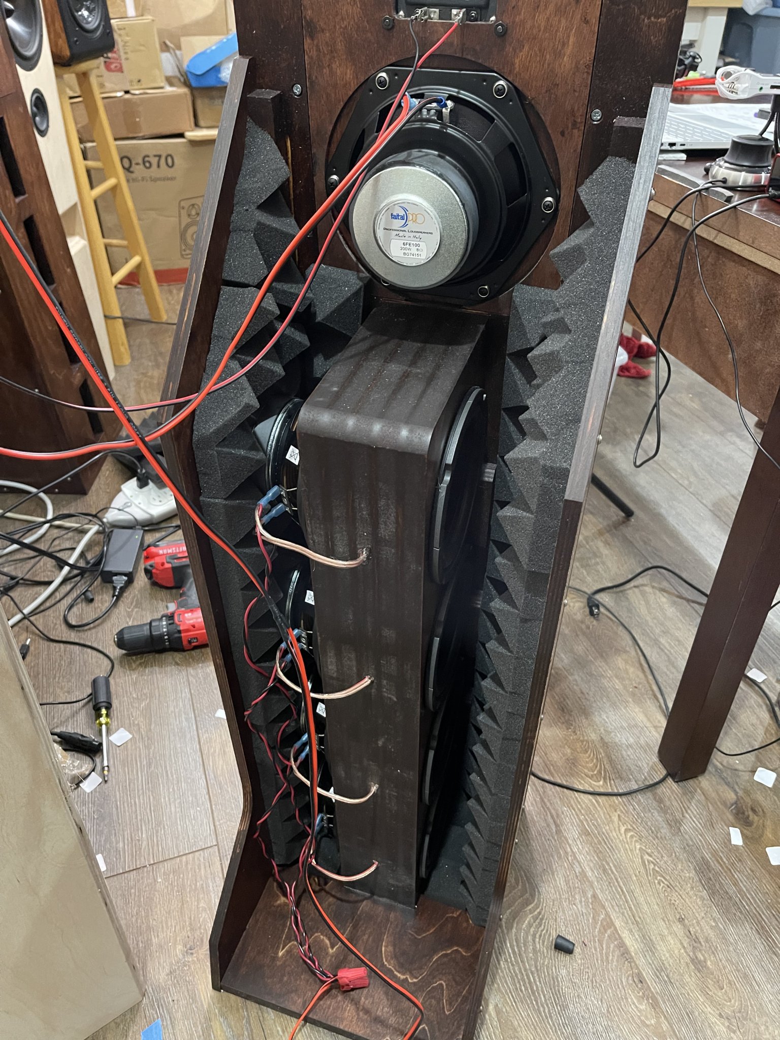

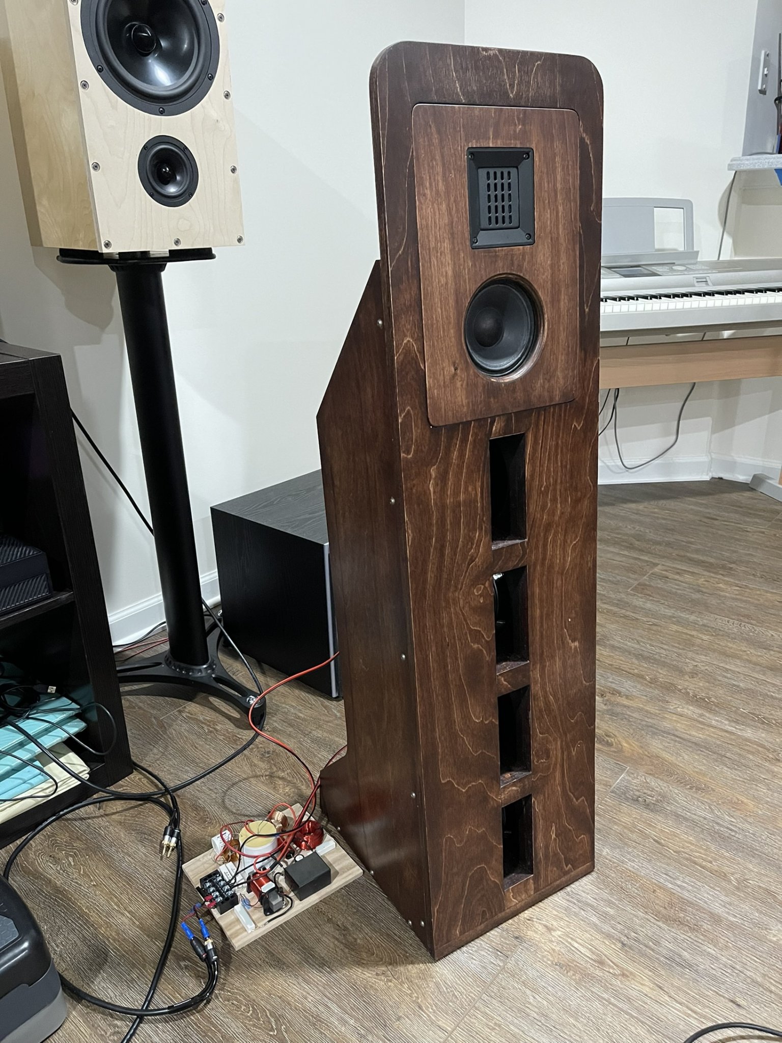

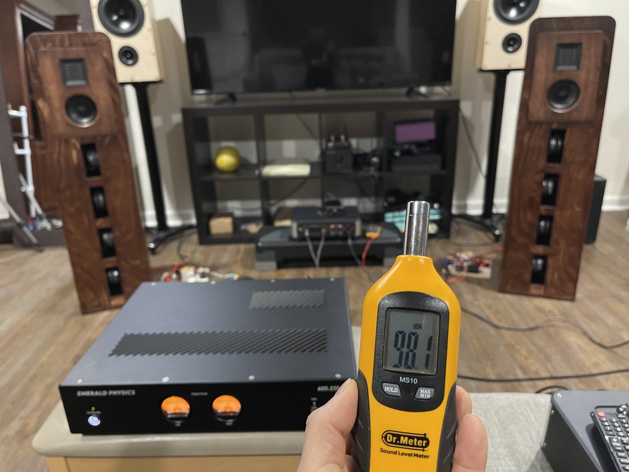

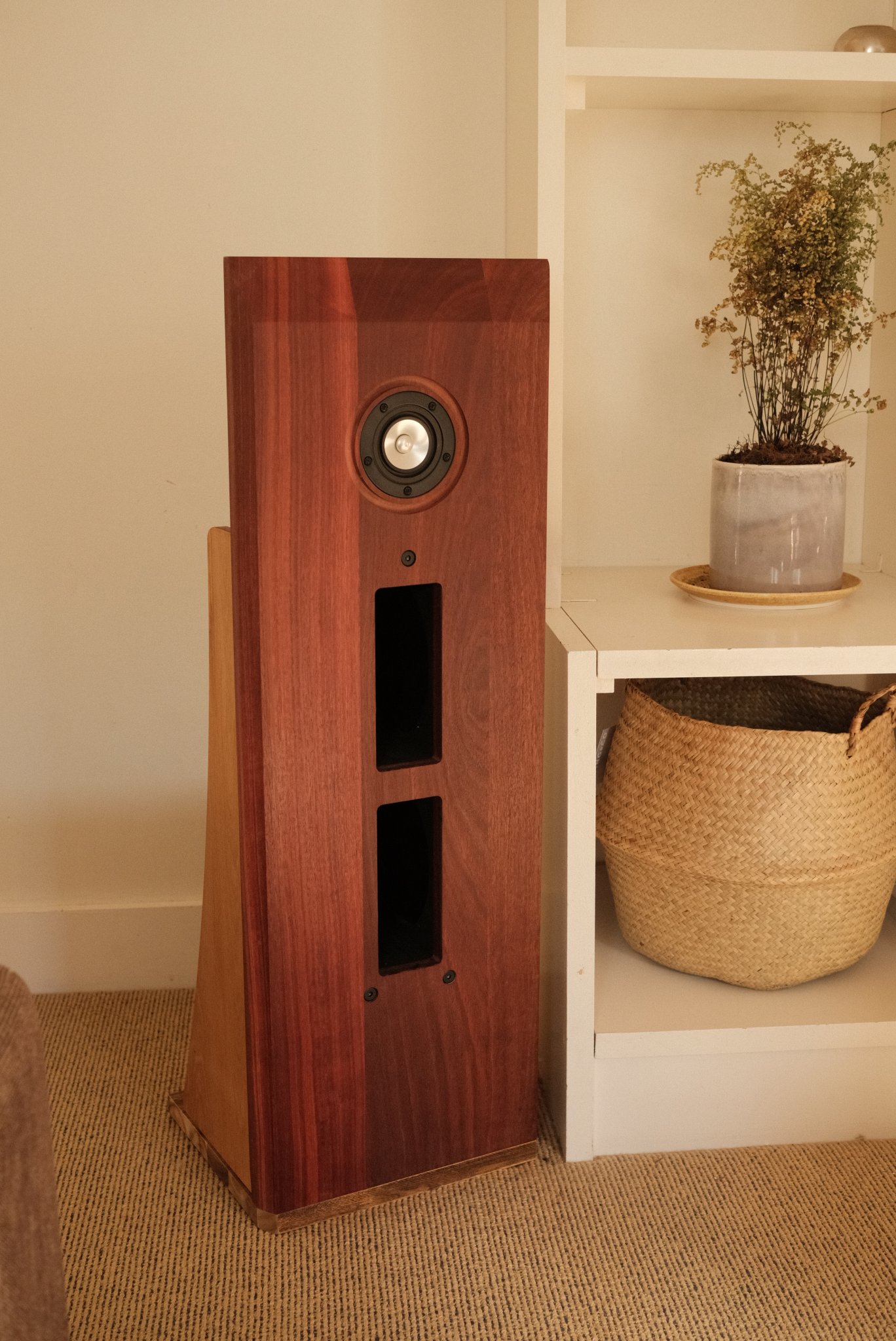

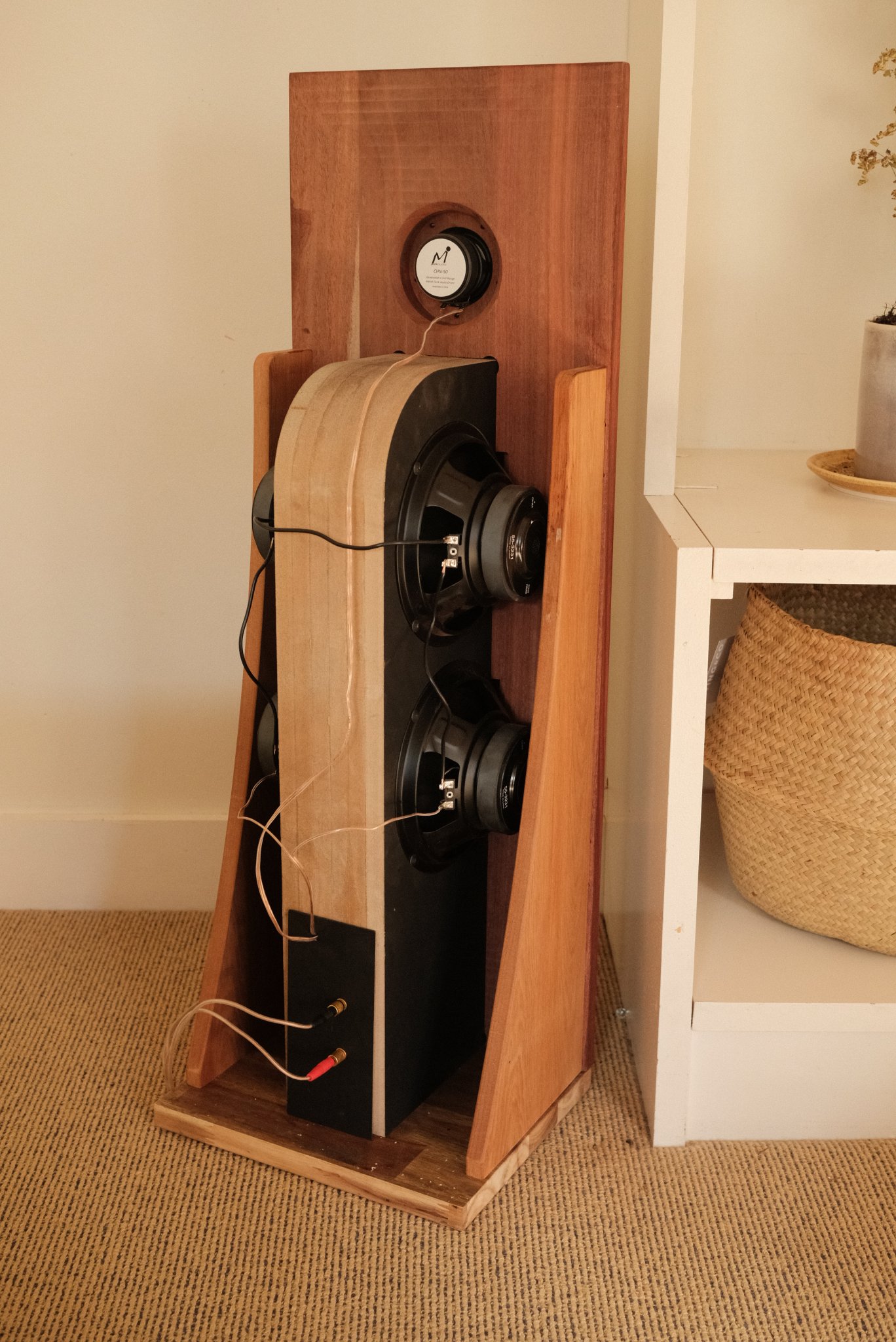

Just popping by to say thanks for the inspiration! This is a much lower budget/power version but was a good excuse to play with drivers on hand. Still a few cosmetic and crossover tweaks to go, but sounding good so far.
😍😍 Those are lovelyJust popping by to say thanks for the inspiration! This is a much lower budget/power version but was a good excuse to play with drivers on hand. Still a few cosmetic and crossover tweaks to go, but sounding good so far.
The cabinets look superb! Did you just build these after seeing my build or you had this all along? What size woofers are those?Just popping by to say thanks for the inspiration! This is a much lower budget/power version but was a good excuse to play with drivers on hand. Still a few cosmetic and crossover tweaks to go, but sounding good so far.
Where is your crossover point and is it DSP or passive?
Well done!
![cheers :cheers: :cheers:](https://files.diyaudio.com/forums/images/smilies/cheers.gif)
Thanks - they certainly look better than my previous open baffle monstrosities, which was the main appeal. It's all modular so I can disassemble and try a different top driver one day.

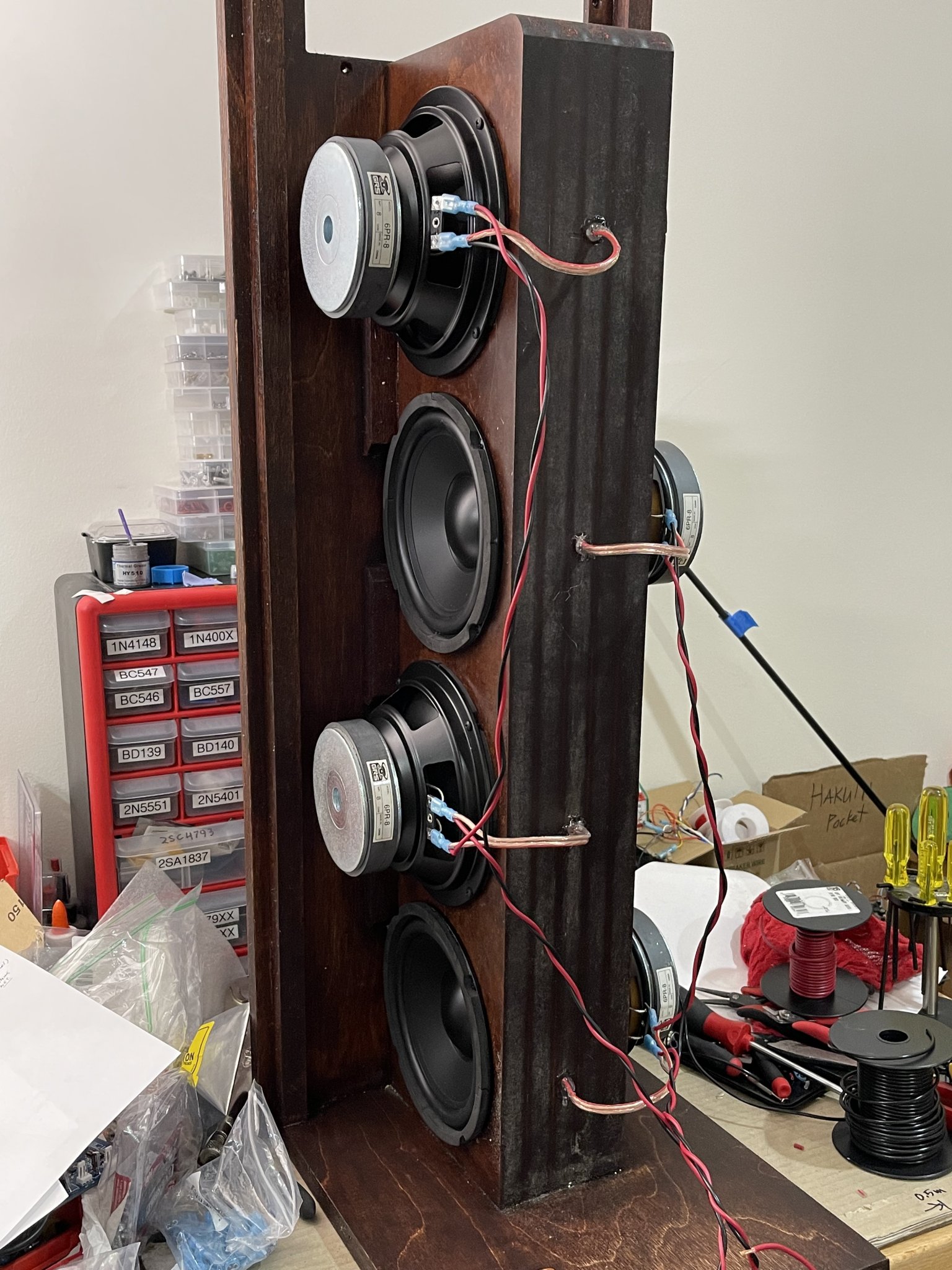

Mostly built in the last few days, had some reclaimed mahogany I'd been dragging around for years so figured it would suffice - super heavy, and machines up nicely.
Woofers are MCM 8 inch model 3231 (I think). Currently passive crossover circa 3-400hz, but needs work!
The mahogany look is fantastic and was what I was trying to achieve with my stained BB but it did not come close. Now I see what can be done with real mahogany. Very nice look.
That's great work for the past few days. Do you feel there is enough bass with 4x 8in woofers? Deeper wings would allow deeper extension. The 8in woofer will have a natural 350Hz low pass so best to use that to your advantage.
Low end seems sufficient so far, although it's not the last word in bass. Woofers apparently have an Fs of 28hz. I figured SD was roughly equivalent to one 15inch. Definitely punchy.The mahogany look is fantastic and was what I was trying to achieve with my stained BB but it did not come close. Now I see what can be done with real mahogany. Very nice look.
I tried measuring without wings and it was literally about 1db difference so I agree some deeper ones would help! I'll post some measurements when I get a chance.

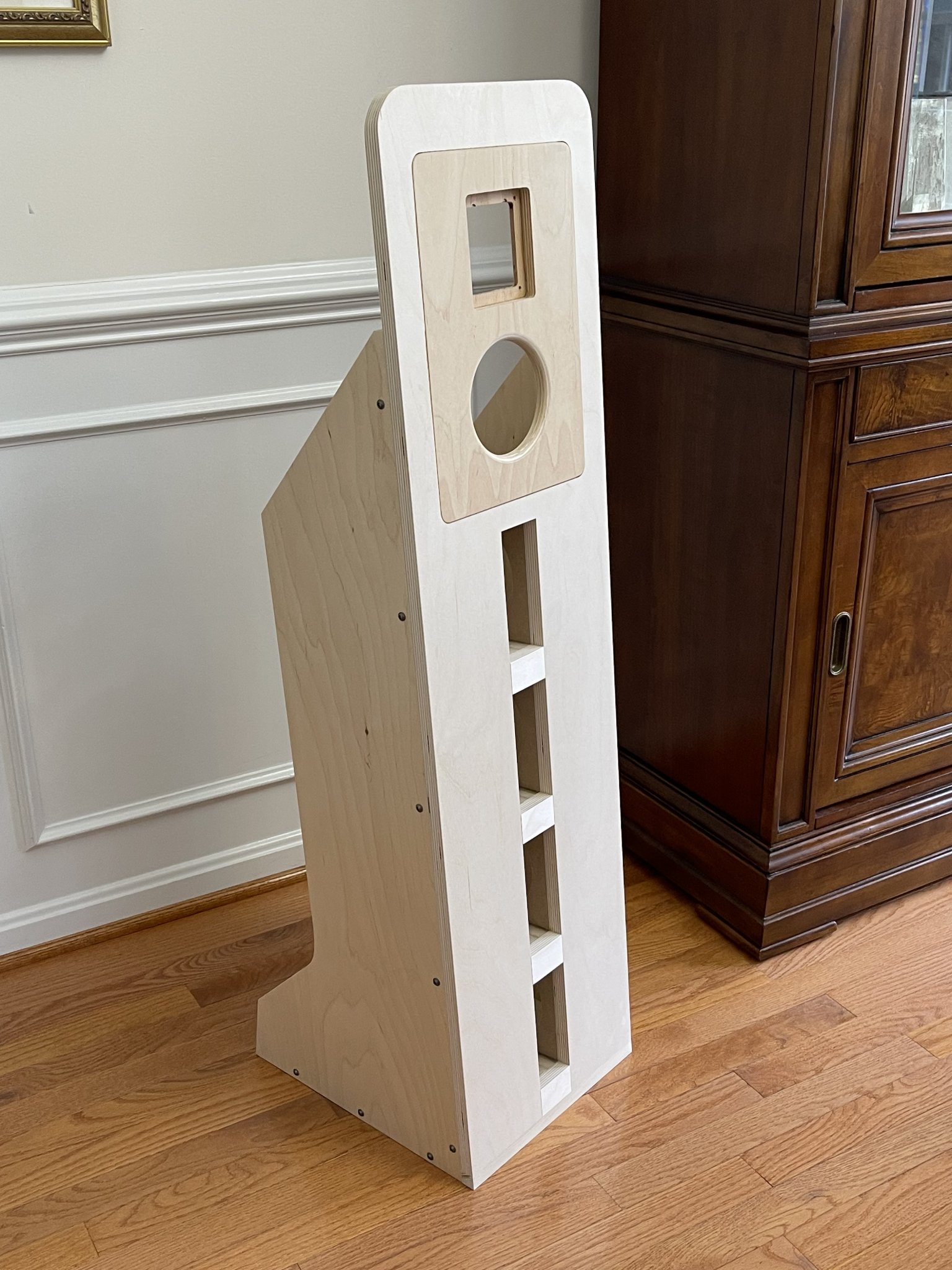

Baffle is 34cm wideEarplay2020,
Your build looks beautiful.Enjoy!
How wide is the front baffle?

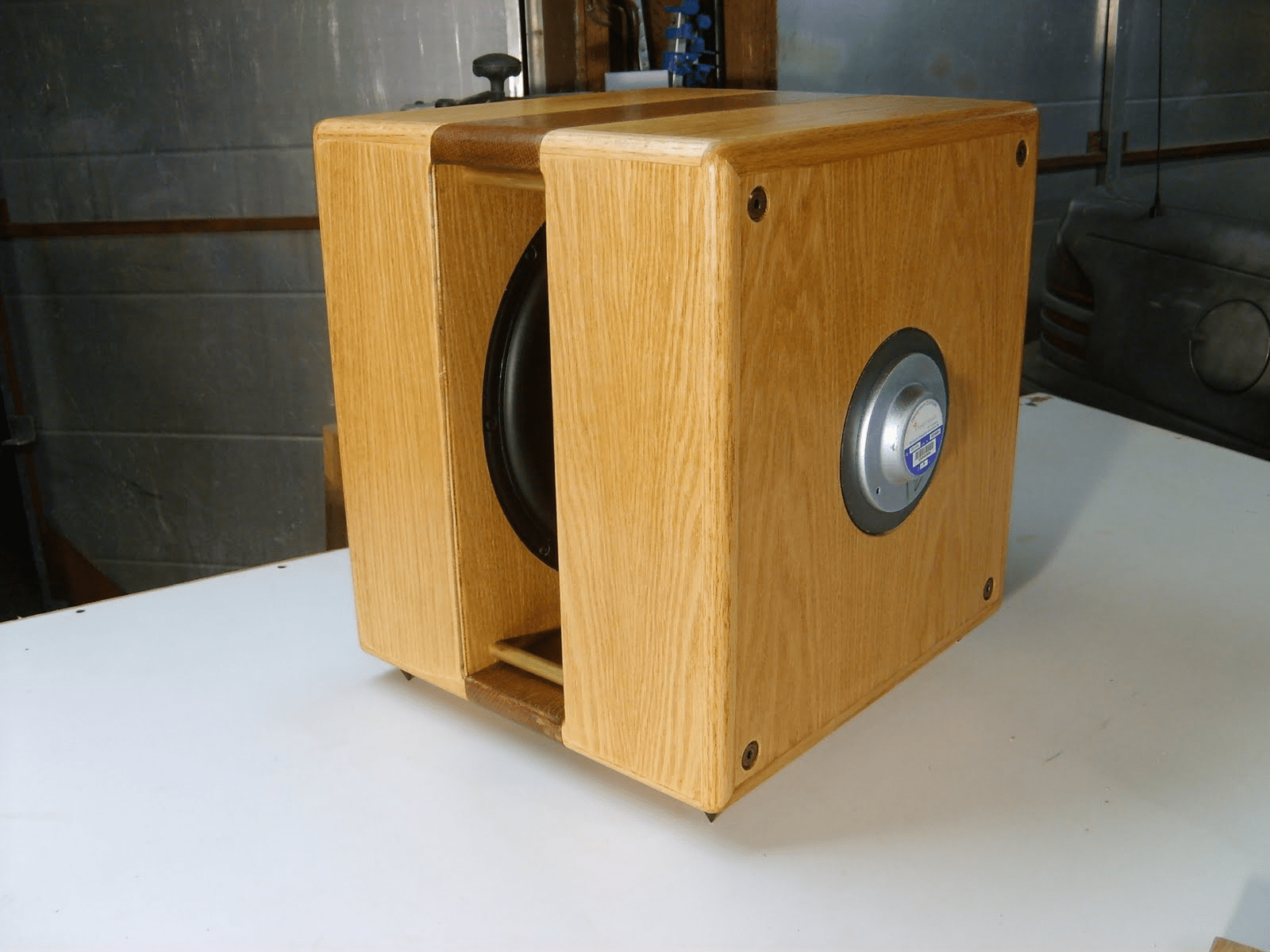

Looks like X's XSD is encouraging more folks to try out the slot loaded open baffle. I had been meaning to play around with one, a bit like you with a wide-band driver on top.
