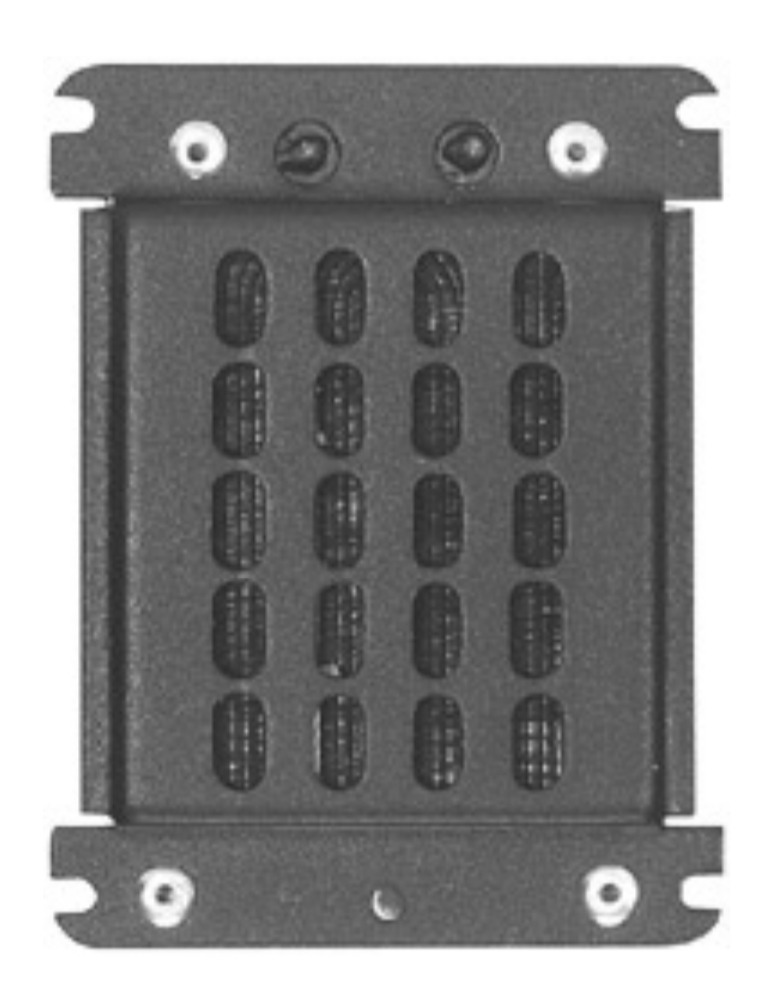

I've learned the the GRS 2522-4 is out of stock at Parts Express. As an alternative I've purchased the B&G Neo3 (PDRW) from Parts Express, their # is 264-7601, with 32+- remaining. Apparenty the GRS is made in China and the major export hubs there are "locked down" from CV-19 fears with an unknown arrival time.

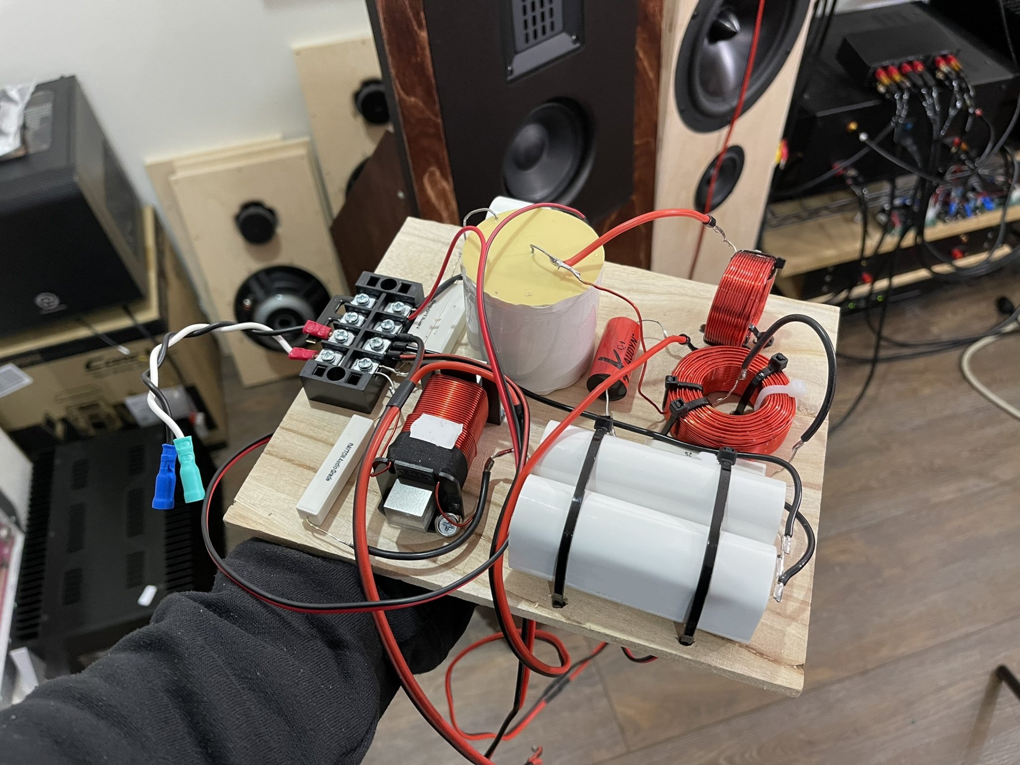

The GRS is a clone of the B&G Neo so should work. Although my crossover was designed specifically for the GRS variant. You may need to adjust the resistor padding level to balance but it should be fine.
Edit: I looked at the B&G and first thing I noticed is that it’s almost $100 more each! Ouch. But the other thing is that I cannot be sure all the rivets and screw heads line up perfectly with the GRS version. So the waveguide may or may not fit. Note that there is no screw on the sides like on the GRS.

You anticipated my worries about substituting a B&G for the unavailable and undeterminable arrival of your chosen GRS tweeter. P-E assures me I have a 2 month retunn policy if GRS replacements arrive shortly. I am taking an educated guess that your bezel fits the B&G - due to cloning similarites.
In an earlier portion of your threads, I recall you saying that you selected from among 8 GS tweeters to find a better matched pair and to me that implies a looser quality control in those GRS tweeters. I hope that B&G more tightly control their consitency so I can avoid a mismatch problem - and thus my willingness to pay a higher price.
How do you go about doing "matching" of items liks the GRS PT2522-4?
I basically don’t know how well it performs until I measure the response and harmonic distortion with REW. I am going to ask the manufacturer to provide better tolerance and quality control on ones that we will use for the commercial version of XSD. You will see (or hear) a higher level of THD in a sweep of the sound vs frequency. I suspect it has to do with the diaphragm tension or touching something as it vibrates. I also suspect the B&G will have tighter control and of the quality and manufacturing tolerances that controls this aspect. On all film ribbon tweeters, ribbon tension is an important aspect that controls the sound quality. Probably true on a planar (ribbon like) membrane.
