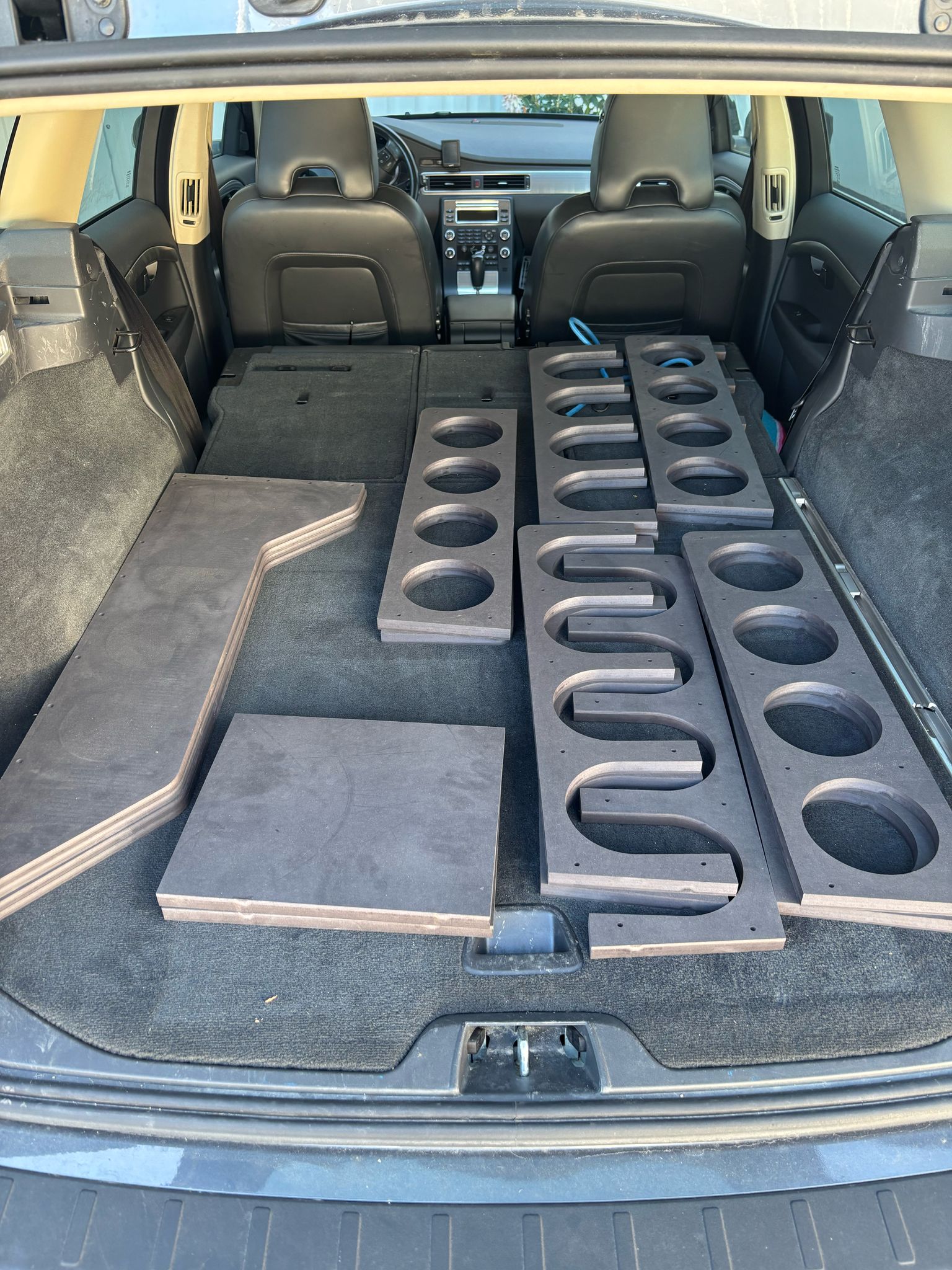

I sure wish I could of built these great speakers but when I did more research I had to come to the conclusion just not going to work in my limited RV space🙁
Neither will me beloved fully upgraded Edgarhorns. I wanted to use the 8" drivers to see what I could gain on the bottom end to hopefully not need subs to free up more space as the only place to put them was behind the XSD.

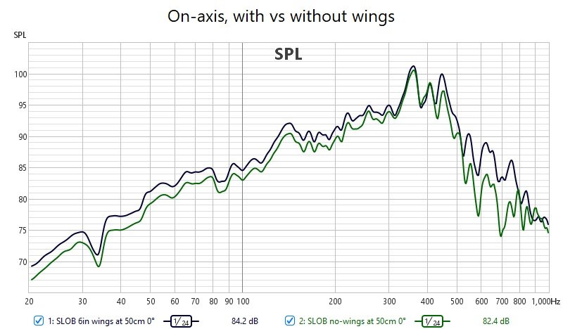

I finally got around to measuring the system, setting it up and do some listening.View attachment 1409347
As predicted by @xrk971 the response falls abruptly at 470Hz. At 470Hz the response is still 9dB higher than at 70Hz. This has me wondering if I should xo around 550Hz. I will be using active xo and Acourate to hammer down the response into the targeted house curve.
The SLOB midbass sounds amazing! Much, much better than the naked 18". A lot more impactful, meaty, yet defined midbass.
I decided for no-wings, xo at 70 and 400Hz for now. Will try going up to 470Hz and loer that 70Hz.
Big thank you!!! @xrk971
Your MTM horn top looks awesome. I bet this speaker sounds amazing. Very cool.
The wings will add a little more depth to the bass extension. Not much but should bring it to 50Hz -3dB.
Thank you @xrk971

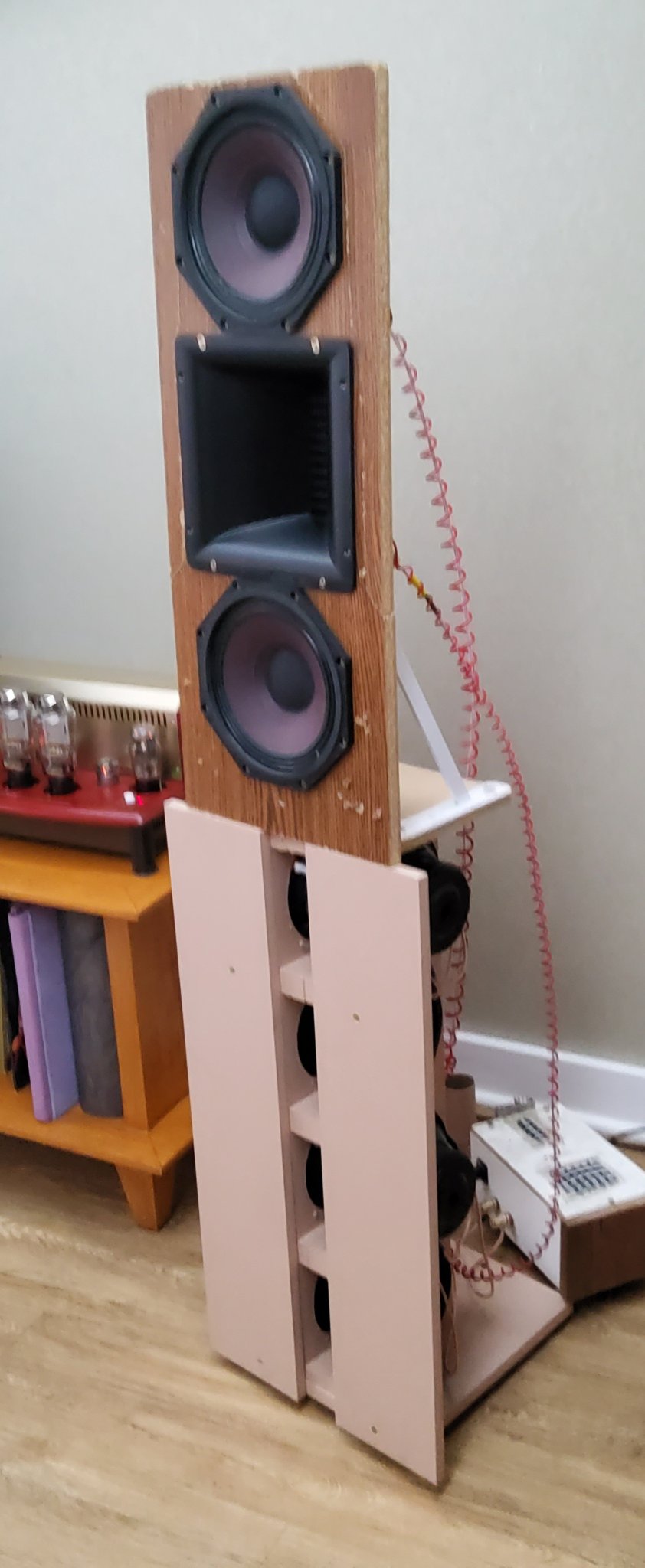

I need to give it another pass with wings. I probably tested with wings that were too narrow. How wide are the ones you are using?
My MTM top is work in progress, as can be told from the looks 🙂
The midranges are B&C 8PE21. Originally I was targeting a 45-type SET to drive the pair, just like the 45 Ihave driving the tweeters. Thise Beyma TPL are very efficient!
But for now I'm driving 8PE21 with A/B KT88 and now I'm only using one midrange per side. Toying with these and thinking about other MT options. Too bad nobody is trying the Radian LM10n as it looks interesting to pair with a tweeter like yours!

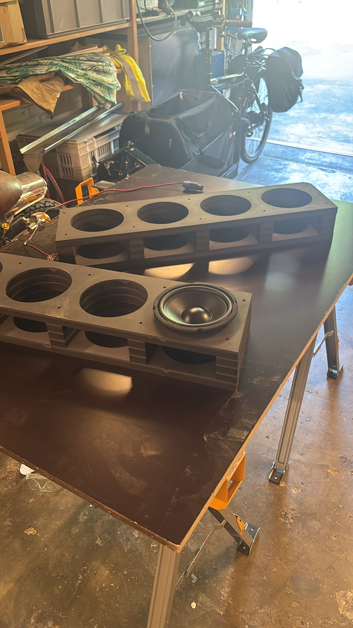

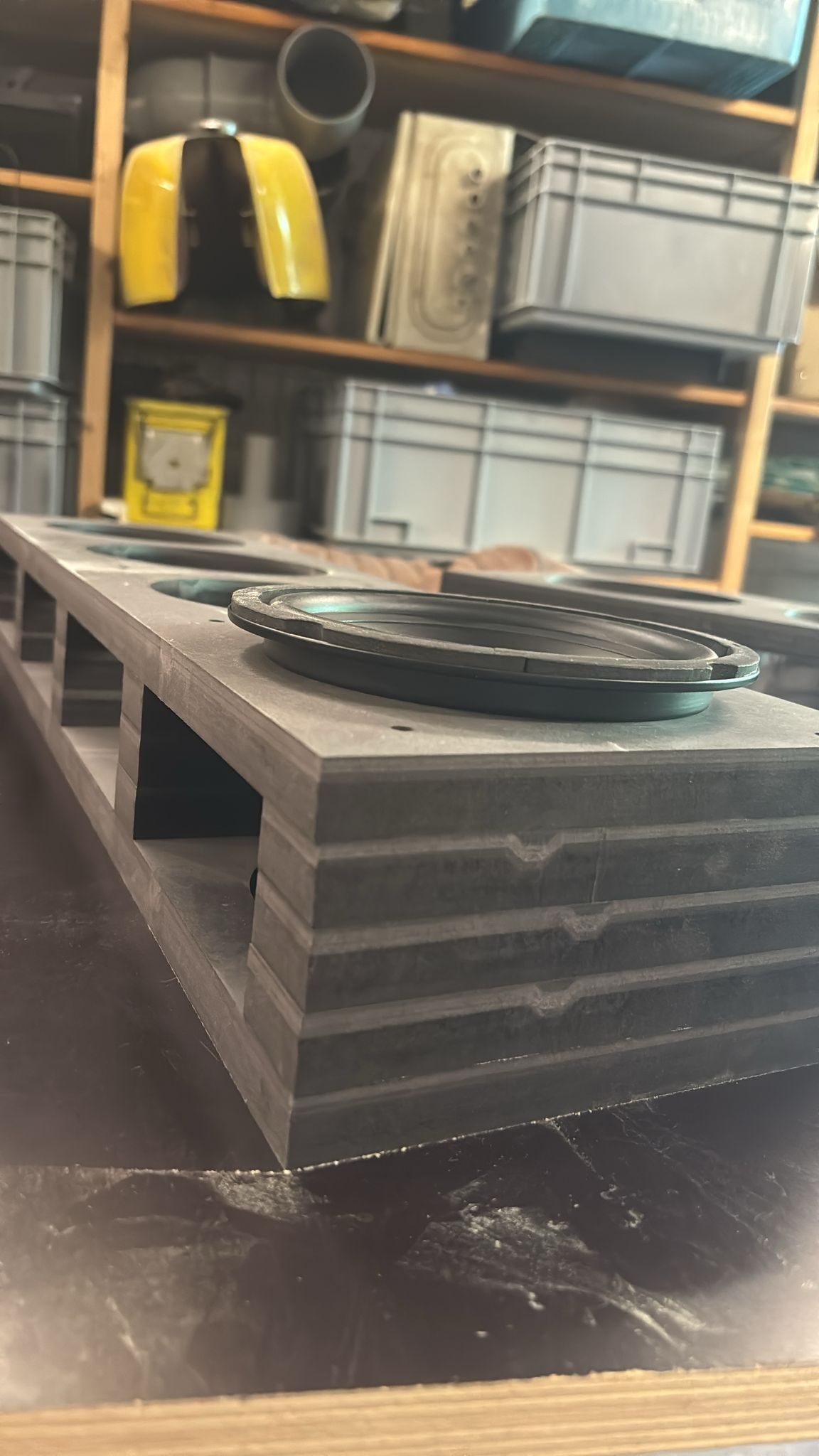

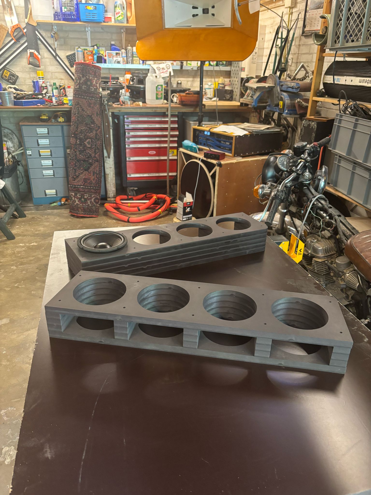

I still plan to build it and have almost everything, minus the baffles.
The woofer unit is finished, some rework is missing.
But my own development sounds so good... I need to find motivation 😀
So many projects...
So many projects...

I find your setup very interesting. Why are you not fully happy with this mid/high solution?But for now I'm driving 8PE21 with A/B KT88 and now I'm only using one midrange per side. Toying with these and thinking about other MT options
Does the 8 x 6.5" driver setup seem balanced with one 8PE21?
Are you testing with an active crossover/DSP? Do you have a measurement of the 8PE21 on the baffle you are using?
I have thought of using 8" o 10" divers for SLOB and the 8PE21 (or a 10") on top, that would limit of the SLOB to 300-350Hz, and that still might be ok with the 8PE21.
