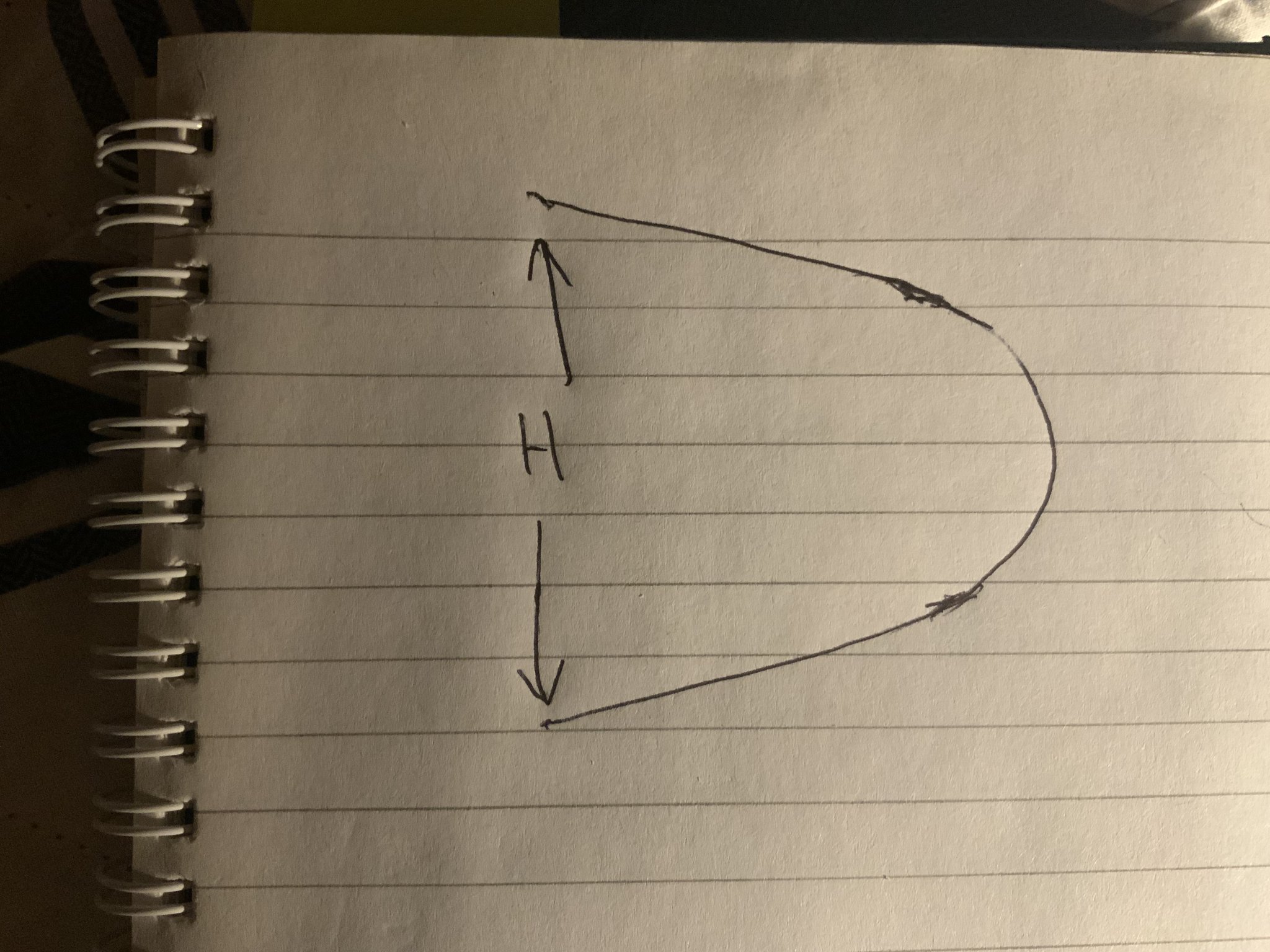

I’m going to shamelessly copy the bass section of the XSD but I want to use bigger diameter woofers and keep the width of the front baffle to the minimum width (as dictated by the required cavity spaces). However I have calculated that the front slot would then be less than a third of the SD and so I need to increase it. As stated I do not want to increase the width of the slot, so I’m left with increasing the height, H. I propose doing this by angling the lines coming off the circular cut out that forms the cavity, like this (seen from the side):

That’s fine but might as well make it a semicircle to straight walls. You want room for the cone and magnet to fit in the cavity. Or were you thinking magnet out on both sides?
