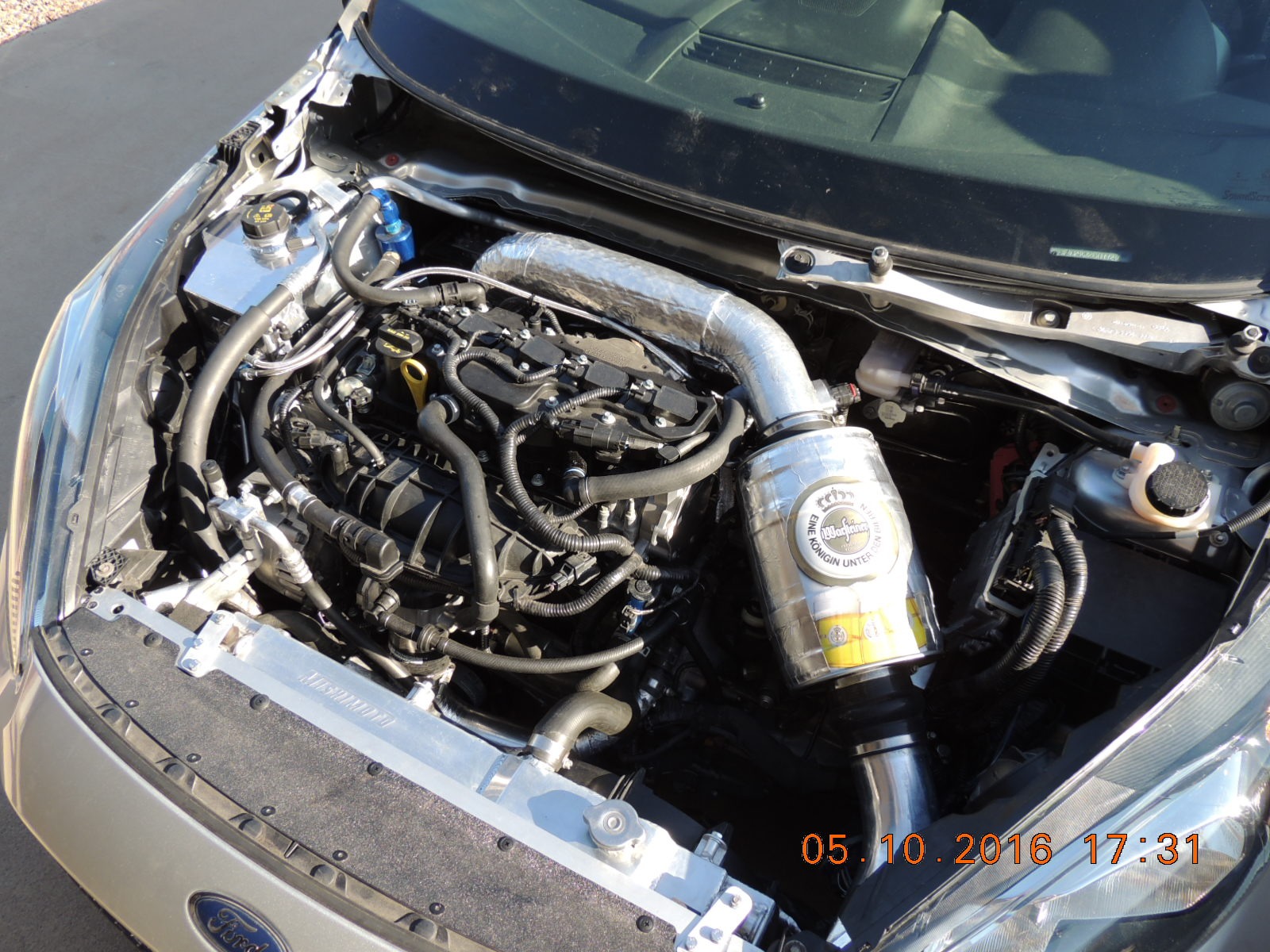

I had the guy that ran the Ford performance school and had dozens of variously modded cars at his disposal look it over then drive it, he absolutely loved it and called his whole shop over to check it out
He used to run the Audi factory race team prototype program and approved of every single mod I did and ones I chose not to do. Only one recommendation was to build an extractor at the rear of the full length front under tray to help pull hot air out of the engine bay, which of course I did the very next day. Though not able to see it all the coolers were ducted and there was a cooler duct for the alternator. Top race grade coolant and all lubes including $70 a bottle brake fluid. I did start modding cars when 8 years old, lol, model cars, then building slot cars around 10 years old including winding and balancing the motors, been playing with cars ever since and mostly had low funds so I learned how to do things for cheap and consistently beat cars costing up to 4 or 5 times more than mine, sometimes 10 times more.

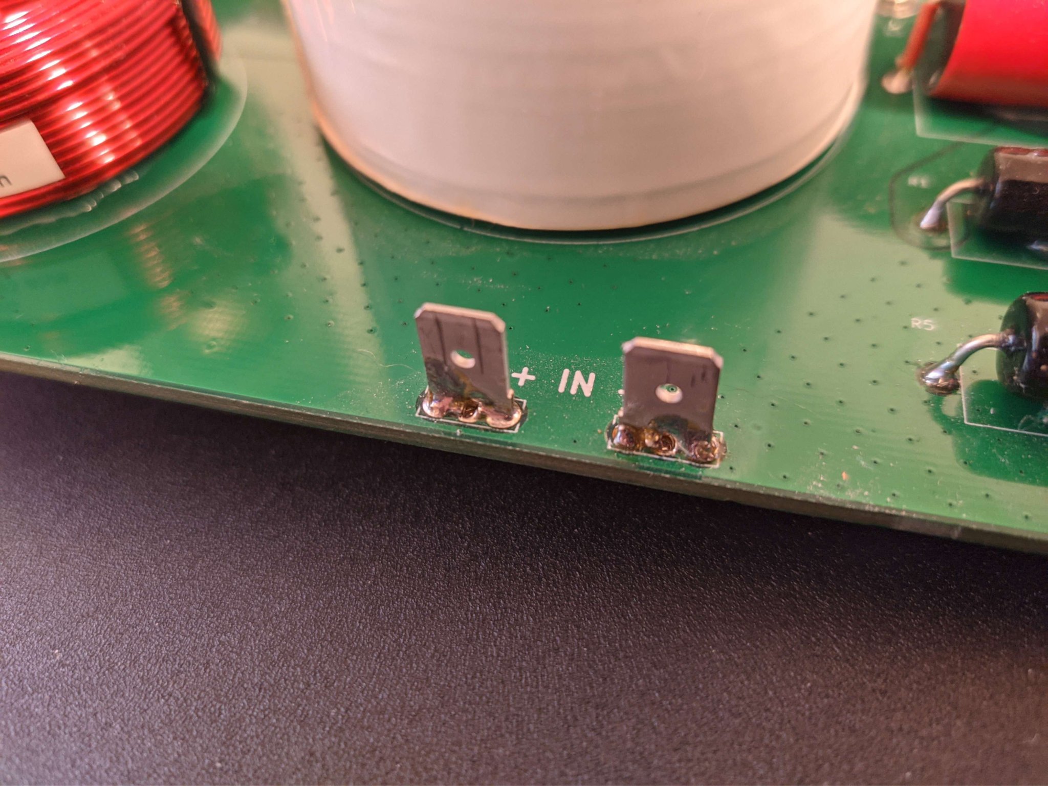

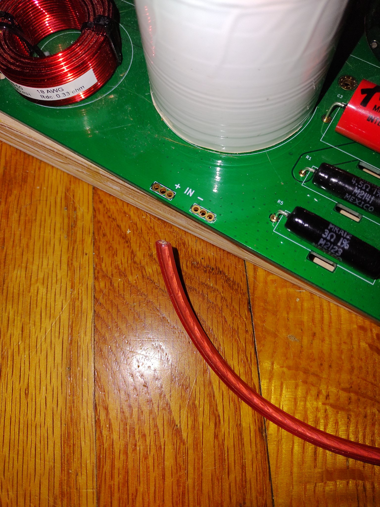

I have his boards, the connections are three holes each, the center one slightly larger. I didnt know he made it to fit a particular fastener. Which faston was it made for? Any info much appreciated. May be I missed it in the banter concerning the crossover boards is possible. I am getting down to final wiring.I have used what I think are called pin end crimp terminals. They are metal version of shoelace tips. For example here. They won’t make the wire much smaller but will reduce wire strain and allow insertion into solder holes. But you should use Faston tabs in crossover board to the drivers. I think the boards made by Bloqhead has provisions for Faston tabs?
Russellc
