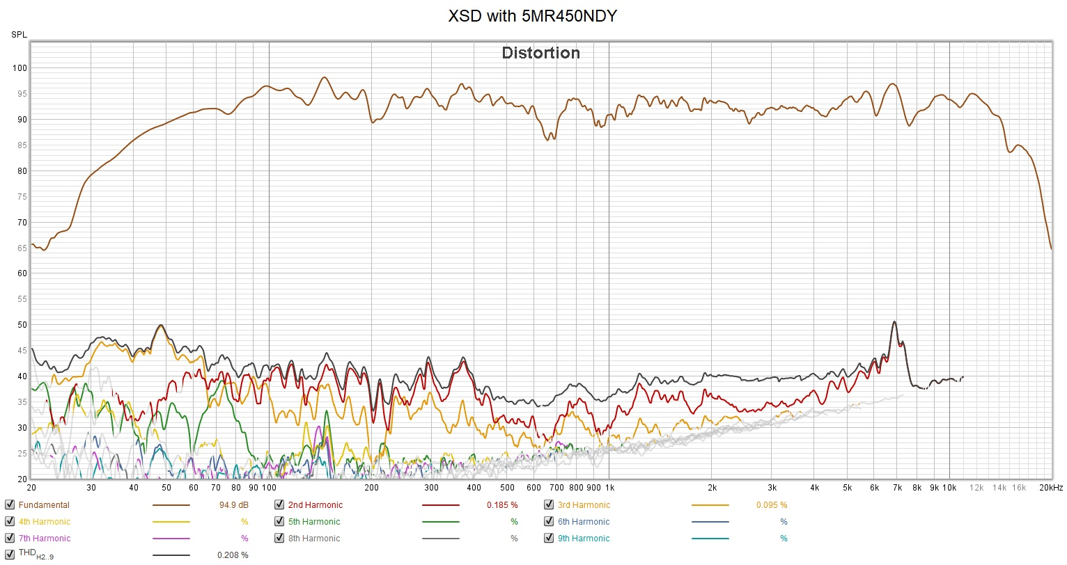

A question on the baffle tilt…..was this a primary power/polar response feature and was the angled baffle compared to a perpendicular approach?……my listening distance is around 11 ft and seated ear height would still remain on almost the same primary horizontal axis.
Tilt was mostly to give stability for the speaker so that it doesn't tip forward so easily. It does help give the tweeter some time delay to match the acoustic center of the mid range.
If you look at the measured phase, it is flat between the mid and tweeter, meaning they are time-aligned.

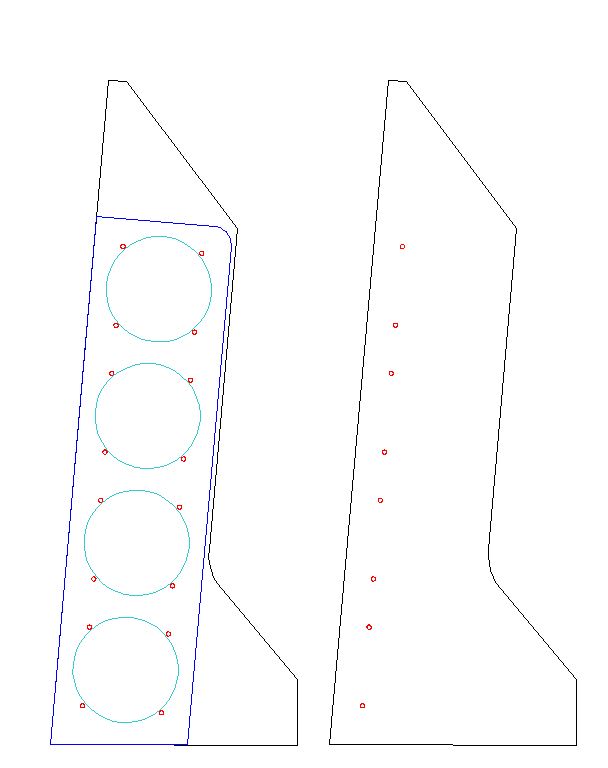

My thinking is just the opposite. I want to glue the entire thing together...everywhere. To facilitate removal of the woofers, I propose drilling holes in the wings, just large enough for a long screwdriver to reach the front screws (the back ones appear easy to reach). See attached showing the woofer array overlaid inside the wings.
This results in holes in the wings (probably 1/4" each in diameter). I see two options at the moment:
1. Leave them open provided the sound waves don't care and the "air leakage" thru them won't matter.
2. Put plastic plugs in them.

Make sure it is air tight between the wings / baffle / woofer box. Leaks will destroy the bass extension and power. Maybe you are thinking of what Linkwitz did to separate Z baffle woofer from the top on LX521?
Note that the woofers are opposed drive - meaning they are force cancelling. The only vibration is possibly from the pressure generated by the air being pushed out through the wings. 3/4in panels mounted to square ledgers is very sturdy and I have not had issues with vibrations from the woofer affecting the tweeter or mid. Look at the harmonic distortion spectrum. It is very clean and circa -50dB through the range for 1W drive (2Vrms). That’s about 89dB SPL (same as middle of dance floor ina nightclub). You are welcome to make it now we you like but just telling you I am not noticing any problems from mechanical vibrations (except woofer baskets which need Noico).
