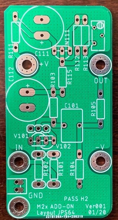

JPS64 designed the Pass H2 circuit ...

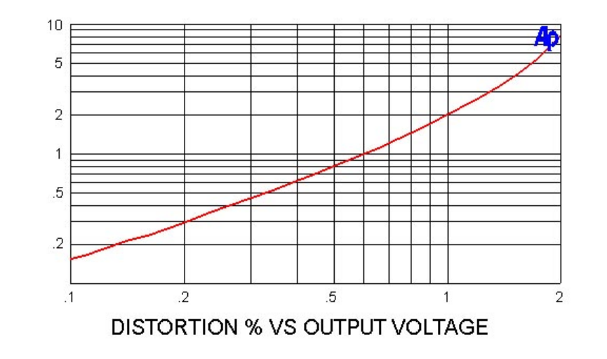

I was, and still am, slightly nervous about that circuit. It might not be able to drive an M2x to full volume. M2x needs 3V RMS at the daughterboard output bolt, to produce full rated output power. However the First Watt article about the H2 circuit, shows an output voltage plot which only goes up to 2V RMS:
_
_
On top of that, one must include the signal attenuation created by the voltage divider in the new circuit, where R105 drives the 600 ohm input impedance of the Edcor transformer.
I am giving these H2 boards away to give folks who need some DIY'ing to lighten their days in all of this quarantine business.

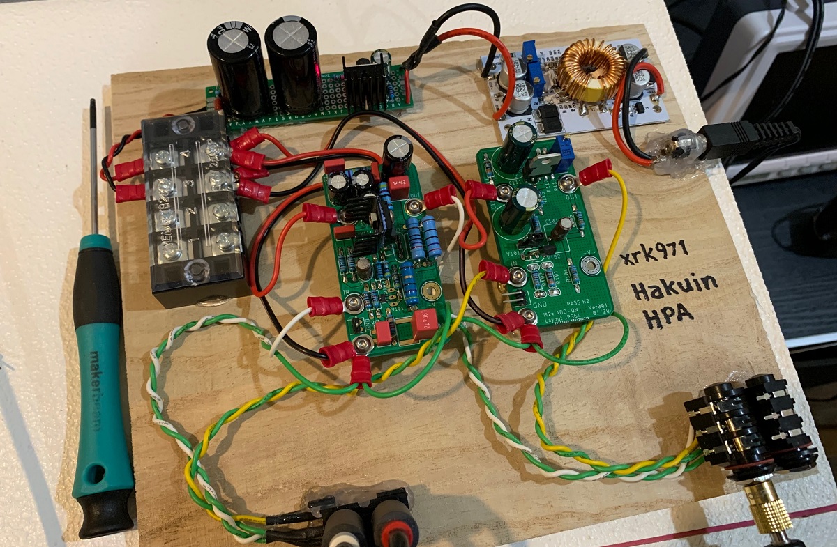

The Pass H2 board has been verrified to work. It sounds quite nice. I tested it using my Hakuin amp on a plank.

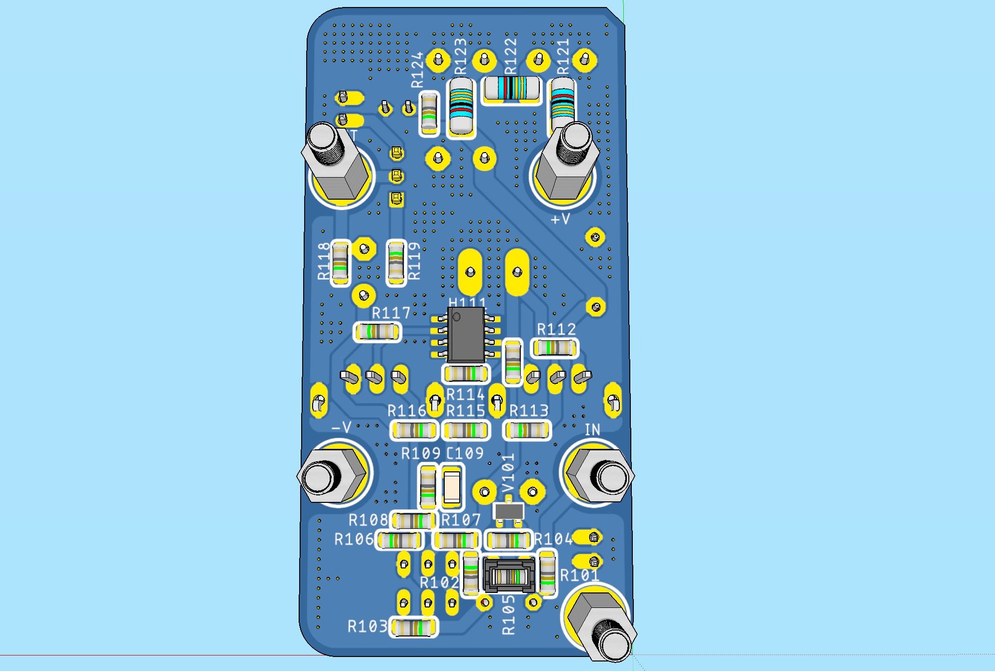

So to keep busy during this spare time, I went to work on the Hakuin M2x boards. I used the exact Mouser cart from post# 1224. Since these Hakuin modules will be used strictly for preamp duty in the Yarra, I eliminated a few redundant components the main board already has. I used the adjusted resistor values for an all ‘Vintage’ Toshiba edition. (Right on GaryS)
Yarra rail voltage is 28.5vdc feeding the Hakuin, after its onboard CRCRC the voltage drops to 24.5vdc. Voltage across R112 is 11.9v, that’s good for a tick under 80mA bias. I strategically placed a few components on the underside of the pcb to allow clearance for the 2SA1837 heatsinking and to give R121 room to breath, it gets a bit warm.
C113 and C114 were not populated at first because the Yarra main board is cap coupled. But, I noticed a slight DC spike when powered on and off. Installing a 5uF film cap in C114 totally eliminated the DC spike and offset is now rock solid hovering at 0mV.

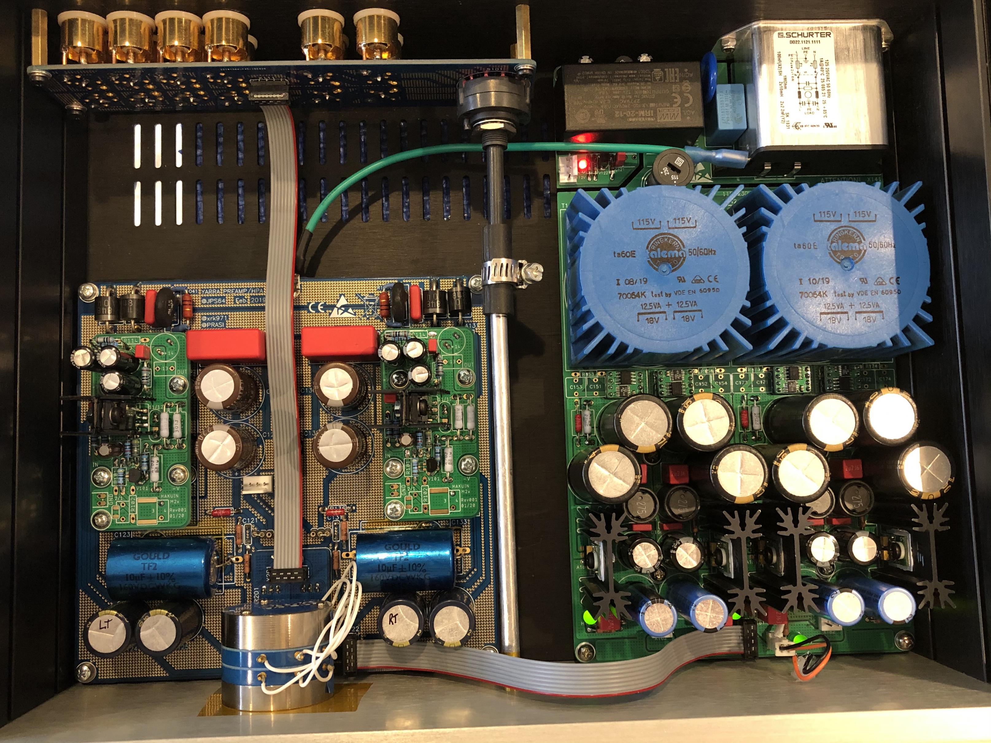

First listening impression is this circuit is extremely quiet with a deep black background. The Yarra/Hakuin preamp combo is now in my main system so it will be getting a heavy workout in the coming weeks![]()

Teaser pic

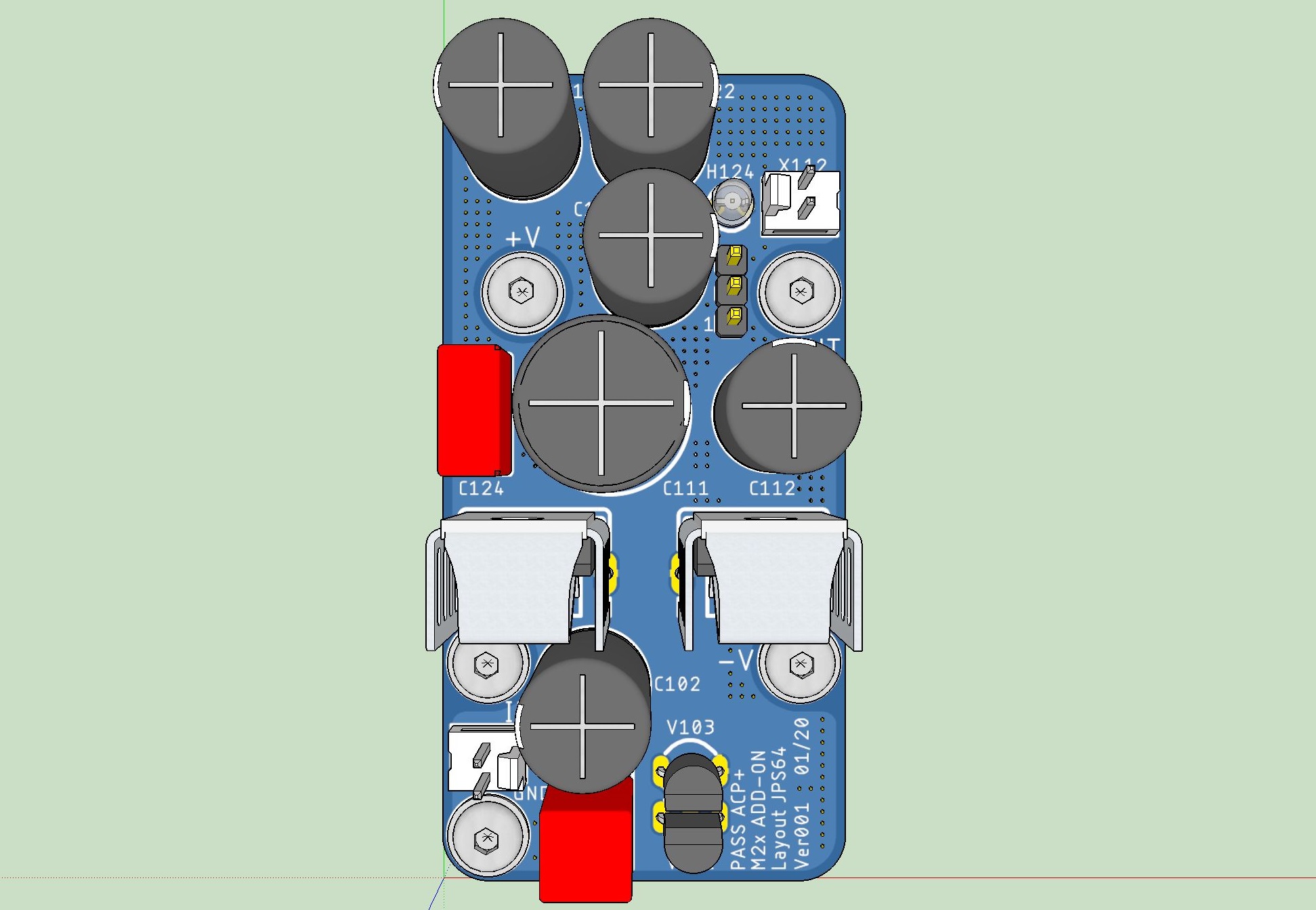

Amp Camp Pre+Headphone Amp - ACP+
The matched set of LSJ74 will be the bottle neck for most. I happen to have a matched pair from DIYA Store - cost about $55 IIRC.
This may be a good candidate for inversion to use n-channel jfets (parallel 2SK209GR are cheap, and reportedly work as good replacements for 2SK170s) and p-channel outputs. The ACP is very similar to the J2, so EUVL’s work will probably be helpful: UDNeSS, or You don't need Semisouth's
