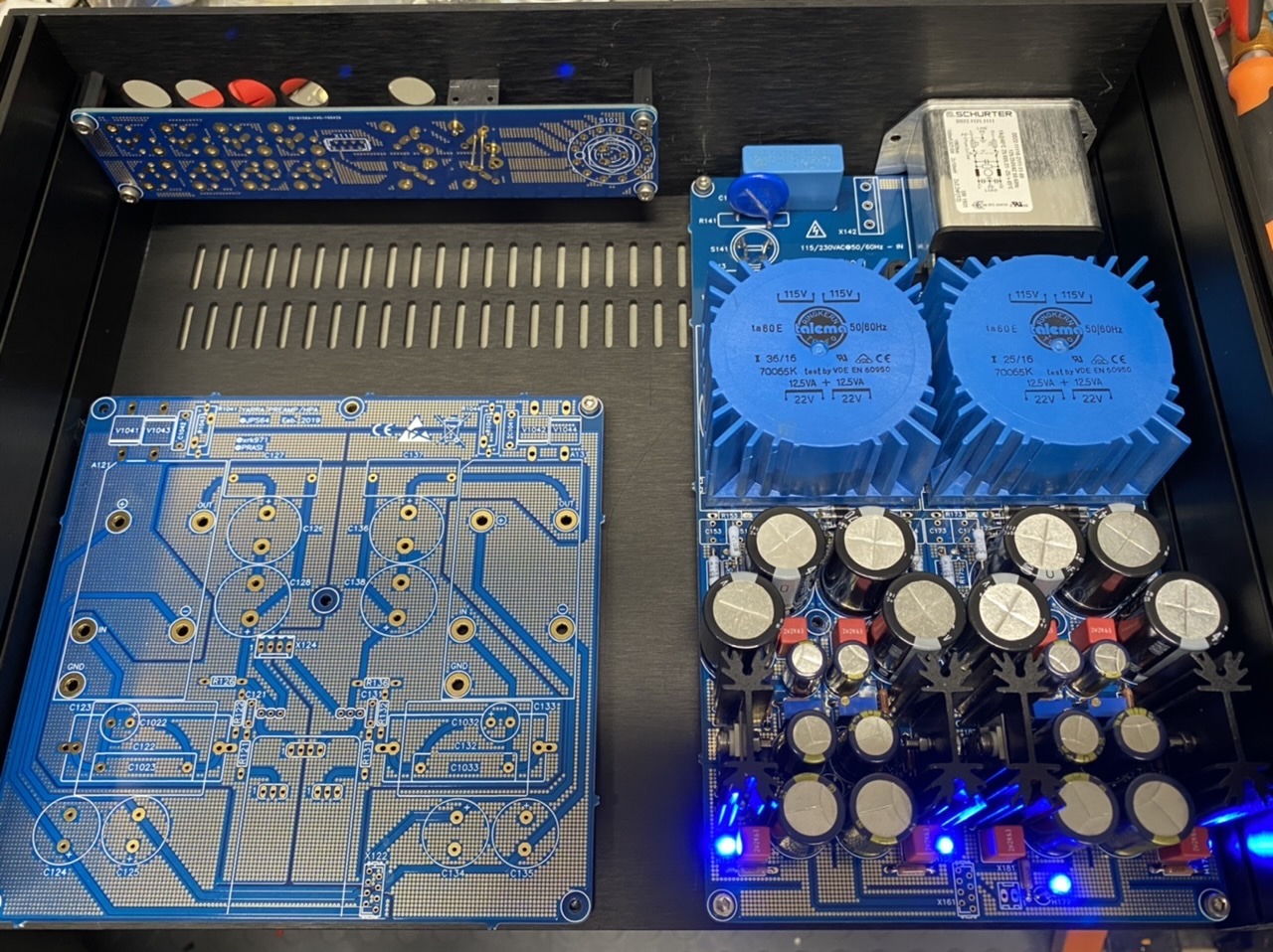

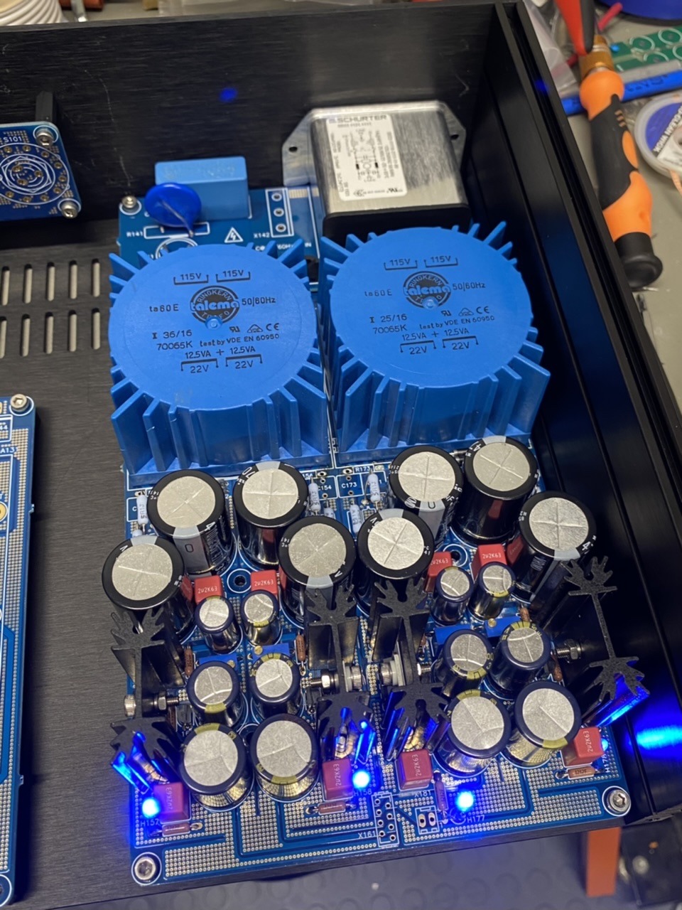

Another Yarra PSU up and running. I can’t say how amazing it is to have the case done before the boards are soldered up. Thanks again especially to JPS and Gianluca on that! Voltages are at about 30.5 across the board with 5.1R 1W resistors in front of the CapMx. I have a bunch more on the way to test, as well as the correct snubber components that I forgot to order on the last round.

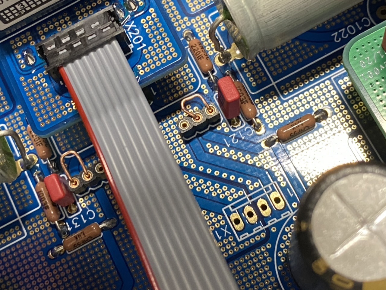

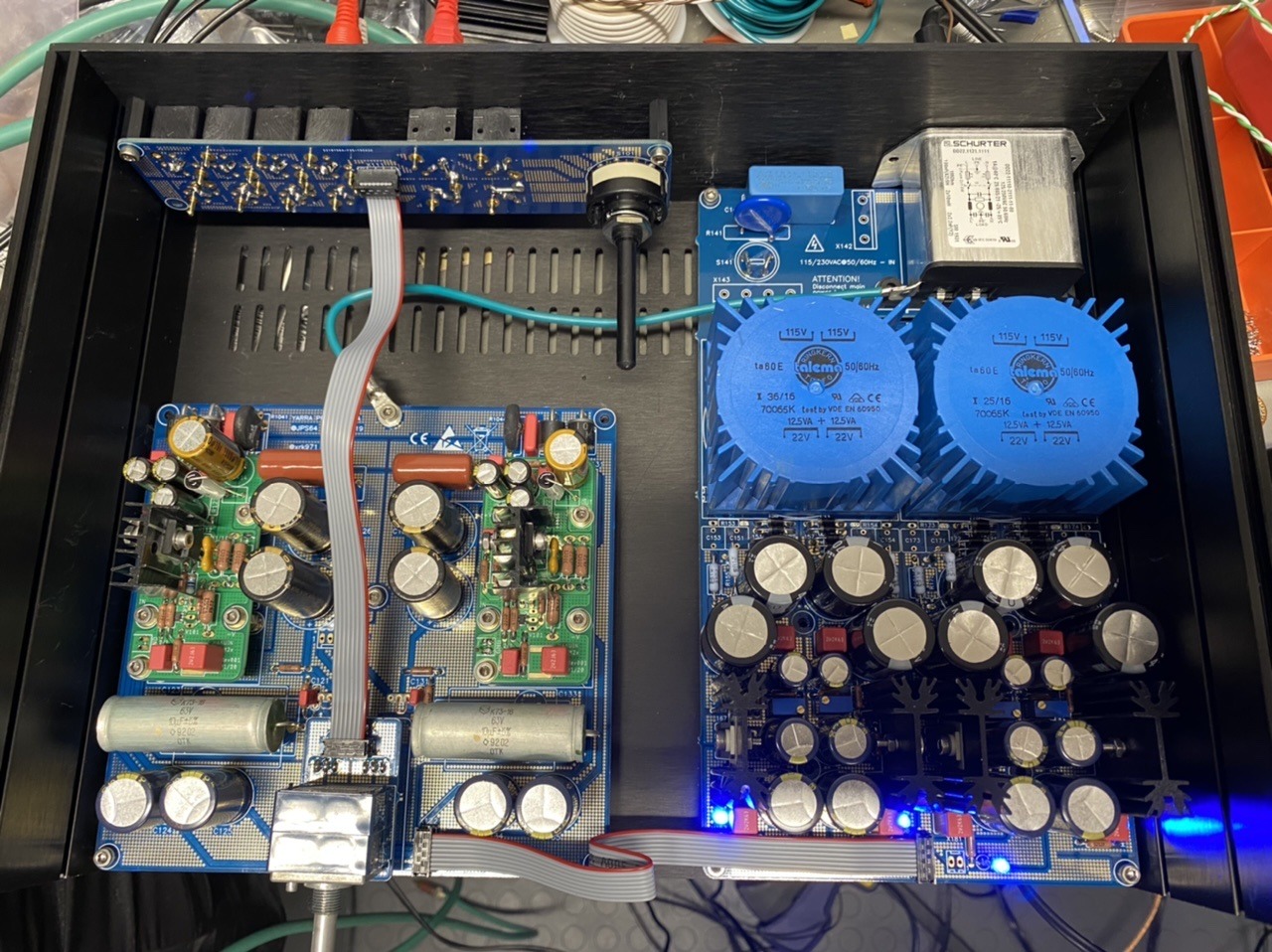

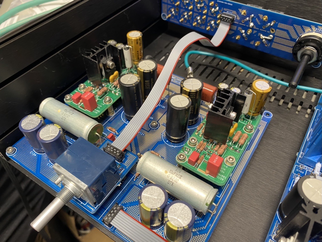

So I got a pair of Haikun boards soldered up today. I plugged them in and fired up the Yarra. I measured 24.4v at the Toshibas. Perfect! Using my usual little Bluetooth source I plugged into the Yarra and plugged outputs into my Lufo-Lite. No sound at all. I was a little perplexed. After switching inputs. Adjusting volume. Double checking source and amp we’re working by plugging the source directly into the amp. That worked. So back to the Yarra. I bypassed the I/O section and went in and out of a Haikun board directly. Sound! Great sound in fact. A little more fiddling around. I took the ribbon cable from the I/O board and flipped it upside down. I got sound out of both channels but the volume pot doesn’t do anything. What could be going on here? I’m out of brain power for tonight.
My brain wouldn’t let me quit so easily tonight. I was thinking it should be a very simple solution if the Haikun boards are working correctly. Sure enough it was. In my haste to get the main board soldered up yesterday I forgot the most obvious and important signal path in the amp. I forgot the jumpers at X123 and X133. Doh!!! Jumpers are in and the Yarra with Haikuns is playing sweetly. Sounds really good so far. More listening to come tomorrow in the main system.

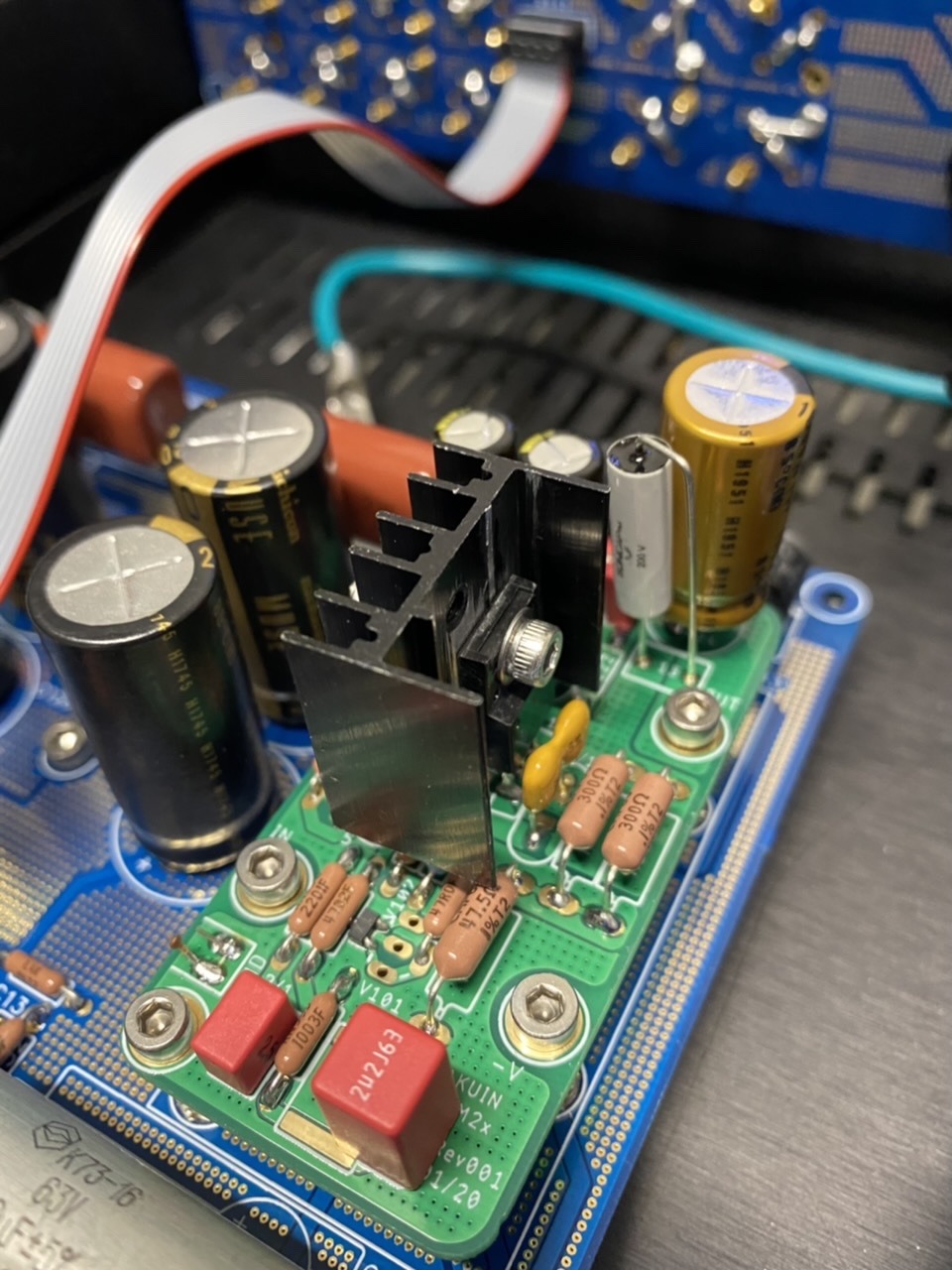

Another note about my Haikun boards, one has a genuine Toshiba 2SA1837 and the other has a 3CA1837. I came across these, and their complement, on LCSC.com when ordering some other parts back in 2019 (see below). They were made under the Foshan Blue Rocket Elec company, which I suspect was an alias that re-badged genuine Toshiba parts. Or something along those lines, maybe. They appear to be VERY similar in the appearance of the case and leads. And so far the 3CA1837 seems to be performing as well as the genuine Toshiba part in terms of general listening. I'll see if I can perform any other measurements on these in and out of circuit. I may wish I would have bought more as they have been discontinued since.

Been listening to the Yarra and Haikun boards for the past week and a half or so and I am loving it. My system has never been so quiet. My speakers are about 96db so it’s been tough to get them quiet. The Yarra has pretty much solved that. Such a great design.
