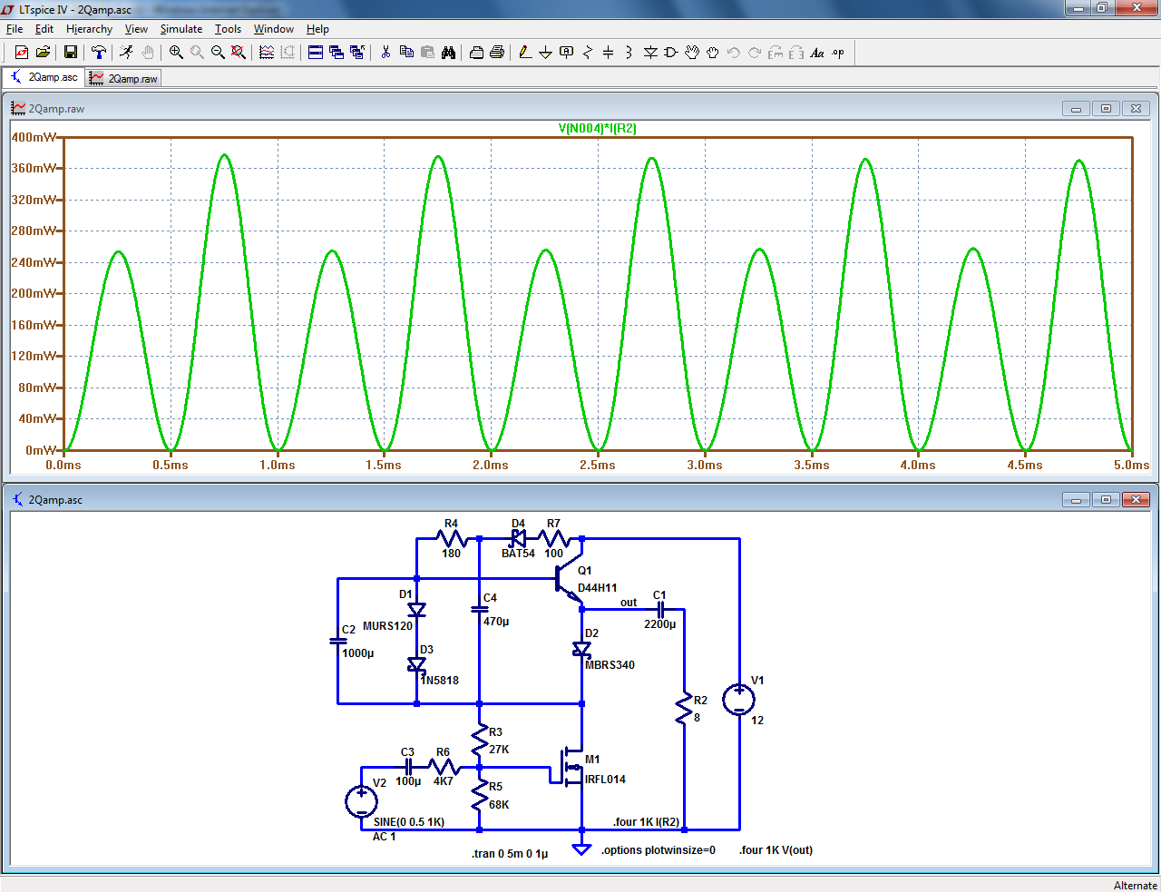

Place the mouse over a component, press Alt, you see the pointer change to a thermometer, left click to plot the power.I never learned about this "power probe" thing. How are you doing that?
But what this does is simply to generate automatically the power equation for the component: it is not actually associated with the component, and if the circuit is changed, the waveform's equation remains the same and plots something else.
I never had problems with that, because I understood from the beginning the way it works.
I know about that, but what he described is actually a label that goes on the schematic which remains on the schematic and displays the average power. Like a .op data label, except pre-loaded with the equation for power dissipation.
Almost every program has its quirks and deficiencies. If you like the program, you learn to work around them.I never had problems with that, because I understood from the beginning the way it works.
Sorry for my wording. I believe it is just as described, where using "alt" changes the cursor to a thermometer, then the display shows the instantaneous power trace for that component.I know about that, but what he described is actually a label that goes on the schematic which remains on the schematic and displays the average power. Like a .op data label, except pre-loaded with the equation for power dissipation.
