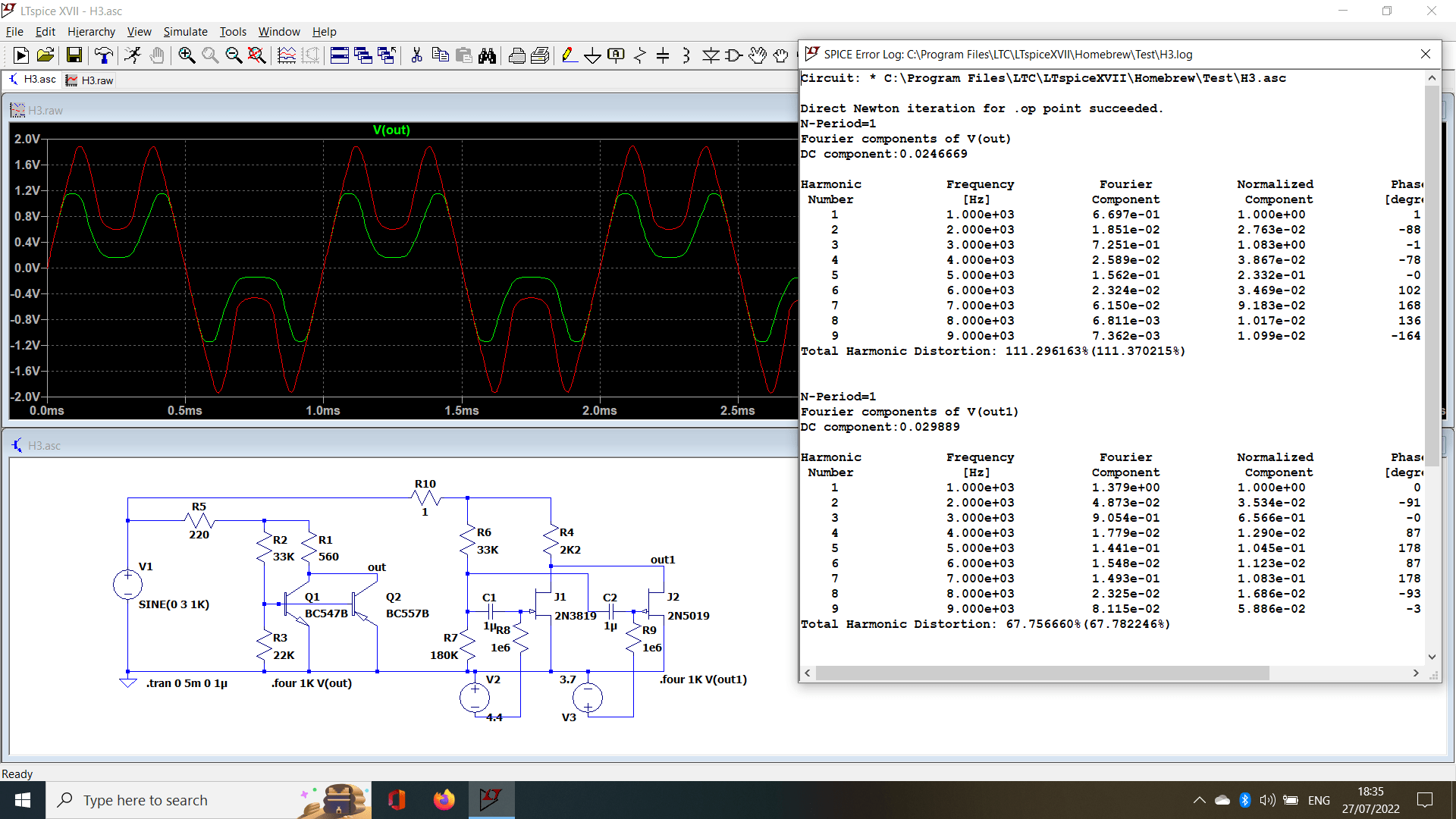

I'm no expert, but I could imagine that the arctanh of a simple bipolar differential pair is closer to what a saturating tape does than pure third-order distortion.
The polarity of the third-order term in my circuit is such that it is expansive rather than compressive, x + a x3 instead of x - a x3. It can easily be fixed by subtracting the output signal of the circuit from an undistorted signal.

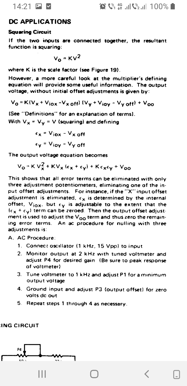

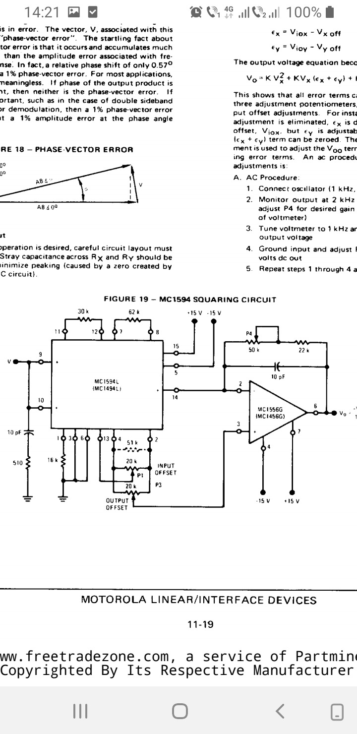

I thought multipliers are only good for H2 synthesis .I saw AD835 used for h2 generation in the past and i planned to use some of my mc1594 chips that I have.I can't afford ad835, but MC1594 might do the job as well while not as fast as AD835.
I understand that I really need some math skills that I never had to undestand this circuit, but I'll try to simulate it and get a picture at least.

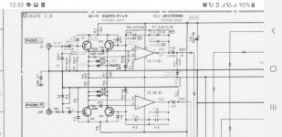

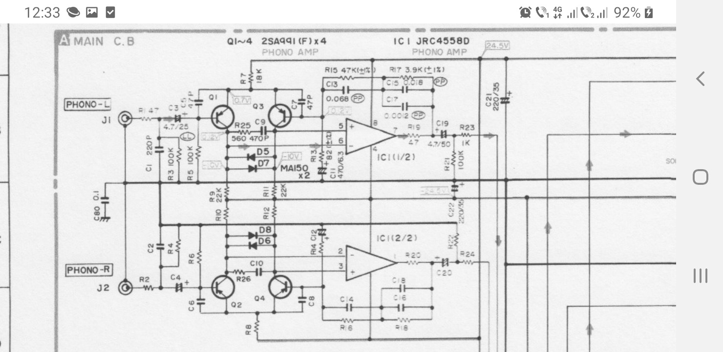

Please correct me if I'm wrong! Changing the diodes clamping the input stage of a Aiwa c 30 phono stage like or just clamping the inputs of a normal op amp with some germanium or schotky diodes in conjunction with a controlled input can do a simpler job at getting h3 products or more simillar tape like sound products or just going with very mild guitar germanium or Marshall fuzz circuits would be acceptable? I tried the Marshall way with many series diodes in the feedback path and it's very dependent on gain and input level but getting the right level is tricky to get just the acceptable amount of compression.When driving hard the record tapeheads i got a wider gain or input level range for acceptable distortions, but while very pleasing(probably more h2) still didn't sound like my Pioneer ct 777 when dolby C activated on real tape which was as emotional as can possibly be.
First of two silly mistakes: I meant tanh rather than arctanh.

@Elvee ...I've read before that reversed bias was used in the early days of germanium in fuzzy circuits and very low voltage switching circuits and it happends that I have many of them.I might try some on your circuit.Seems very compelling.I bet @marcel's circuit is complex for linearity reasons cause i also know that compression ratio varies with input level in guitar effects.Now simulating tape compression is kinda level depending so it may work.

I would just try a bipolar differential pair, probably with a big capacitor between the emitters to reduce the effect of offset, make the input level adjustable from 1 mV to 50 mV and check if the resulting hyperbolic tangent distortion sounds as desired.
