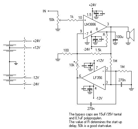

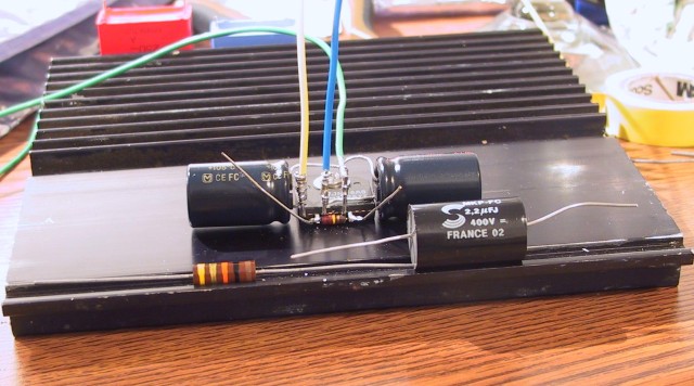

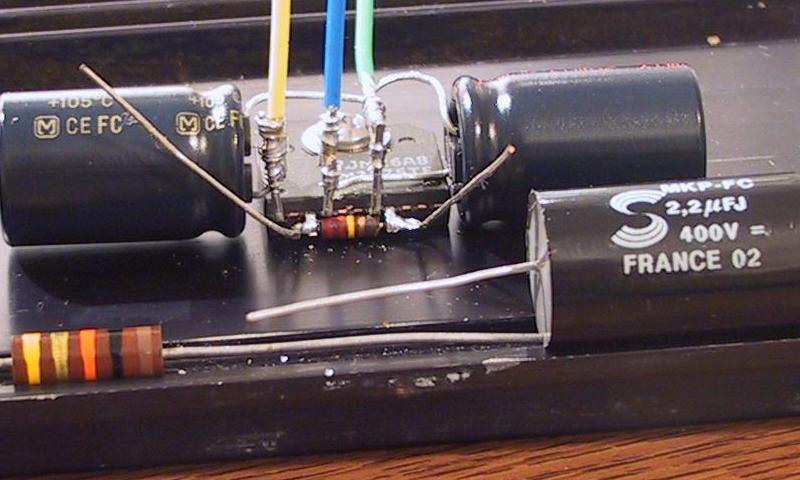

Well... I decided to start my gainclone tonight while waiting for the ball to drop. I am going to make it cheap for my first one. I picked up heatsinks for $1 each from a surplus store, Allen Bradley resistors (recommended by Thorsten) for $0.06 each at another surplus store, $2 solen cap, panasonic fc caps from digikey, $2 radioshack 100k stereo alps pot. I will use my aleph 5 transformer for this (25v secondaries). I calculated ~$17 in parts not including transformer or chassis for the 2 channels that I am making for my first gainclone. This should fit in the Fruglephile(tm) category.
I kept the feedback resistor path as short as possible.

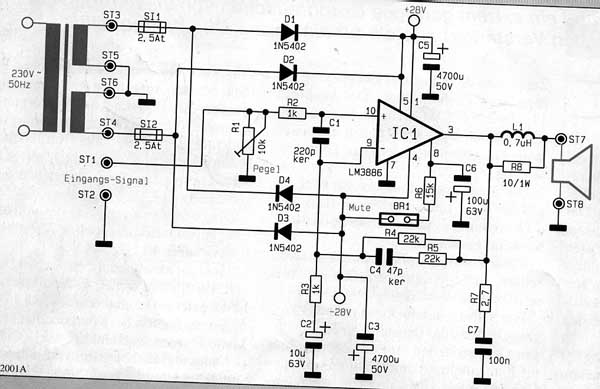

I used this circuit for my gainclone.
You can buy PCB´s from an Elektor-like magazine.
If you disconnect the pot R1 you´ll get a real big DC offset.
A friend of mine fried his speakers like that.
I installed an additional resistor from the input to ground which resolved the problem.
Any comments? Is this circuit useable as it is?
To the last posts:
There are a lot IC amplifiers that are crap but chips like TDA7293/4 or the complete overture series from National Semiconductors are definitely an exception.
