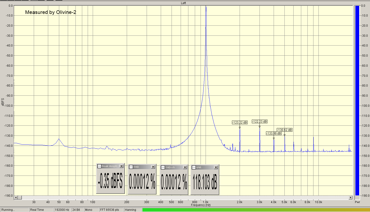

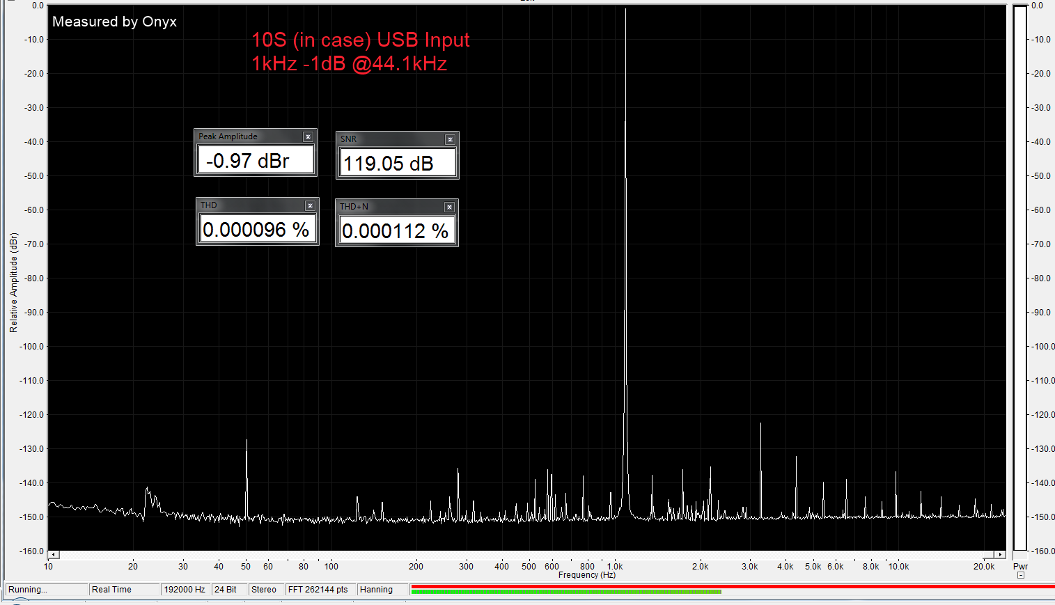

Markw4, I talking about formal specs as THD+N, dynamic range, SNR. As I see, Allo got THD+N .0003% with ES9038Q2M, i.e. the same as my tiny #9038S(46x20mm PCB). To get 3-10 times worse result is a trivial task which requires no engineering, I looking for promised .0001% and SNR 129dbA.
...talking about formal specs as THD+N...
THD+N is a pretty useless number, especially for dacs. Sigma-delta dacs in particular can reproduce a single steady state sine wave tone with much better THD numbers than they can reproduce signals with significant dynamics and many frequencies at the same time.
In any case, I have an Allo Katana here they sent me for review. Most likely they will send a USB dac when they have one. If you want to send me one of yours, I will give you a fair review. If you have done well, I would be very happy to say so. It would be to the benefit of people who like music if clever engineers could bring down the cost of really good dacs. I support anyone who can do that, including you.
However, also have to say IME its harder than it may seem to make a really good dac. I'm slowly getting better at it, but maybe you leaped ahead. If so, good for you. Progress is what counts.
Hi IVX
our new DAC is measured at -113.5 THD+N thats equivalent to 0.0002
Please note that we are measuring at the floor noise of our AP machine.
THD only is at -123. Thats close to the best measured DAC (the Matrix using PRO version is closer to -124)
Still I think thats pretty meaningless . We are concentrating efforts on sound quality.

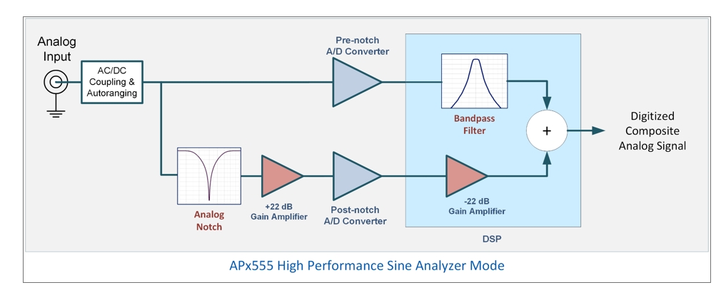

cdsgames, I'm not sure what DAC you talking. I talking about engineering challenge itself which is not detected if you got specs worse than DAC promised. I've got similar THD+N but with tiny and minimalistic 46x20mm board @32ohm load 200mW(340mW@THD+N=1%). However, technically that project is trivial as well and was done during few weeks. I love a serious engineering challenge, for instance, the built-in 555-like analyzer would be cool, regardless, interesting that to somebody else or not. I have feeling that the audio industry is seriously sick because lost a passion, ideas, novelty.
The built-in analyser is cool I agree but why waste it on just a DAC? A full analyser is useful in itself and perhaps a better engineering challenge for your skills - for a piece of measurement equipment the lowest possible THD+N does matter. For a DAC its debatable whether such low numbers bring any subjective benefits.
Such an analyzer is mostly SW task and someone already starts to solve that FFT и прочее - как правильно?
Guys, have you been a curious boy ever? I was, my older brother even did beat me because I asked too many questions )) He was sure that it is a sign of silly if younger bro asking about why the grass is green or why a rainbow is an arc? Abraxalito, let me ask you, why you talking about "such low numbers" when you obviously can use the analyzer+solver system much more creative way? You can set the input signal composition of fundamental + 2nd + 3rd pretty much up to you and solver will fit the DAC THD performance accordingly. Up to .5% of the THD, I hope it is high enough to notice a difference? ))
Hi IVX - yes I am a curious type but I can't get the context of your question to me. 'Analyzer and solver system' means what?
ES9038Q2M is the plant or actuator, the goal of regulation functions is minimizing of 2nd and 3rd harmonics difference vs reference. If the input reference signal is the clear sine(1kHz), the system will adjust the DAC to reduce 2nd and 3rd harmonics, however, if your input reference is the combination of 1kHz 99.75% + .2% of 2kHz + .1% of 3kHz(kinda SE harmonics emulation), then DAC's THD will be the same as your reference. In other words, you can modify the THD profile of your DAC randomly.
PS: BTW, when I adjusted DAC up to <-120db for 2nd and 3rd harmonics level, I noticed the difference Foobar2000 vs MPC-HC x64 players, and the last one was better. So the analyzer+solver probably able to compensate that difference too 😉
