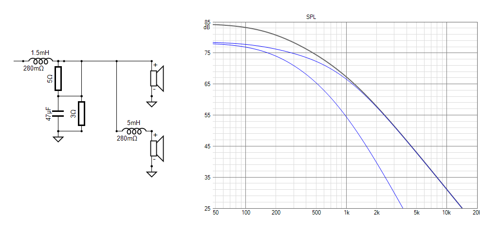

I am using an L-pad. There is 5ohm resistor in series.What you do is not the way it should be done. Putting smaller and smaller resistance across the speaker is basically shunting an audio signal to ground.
But you are presenting lower and lower impedance to the amplifier. Not only this leads to higher distortion, but at higher power may damage amplifier.
If you want to attenuate some band after crossover going into speaker, use proper l-pad. It reduces the volume, but maintains constant impedance for amplifier.
See pic.
And btw what you describe 0.47 being louder than 2.2 ohm is nonsense.

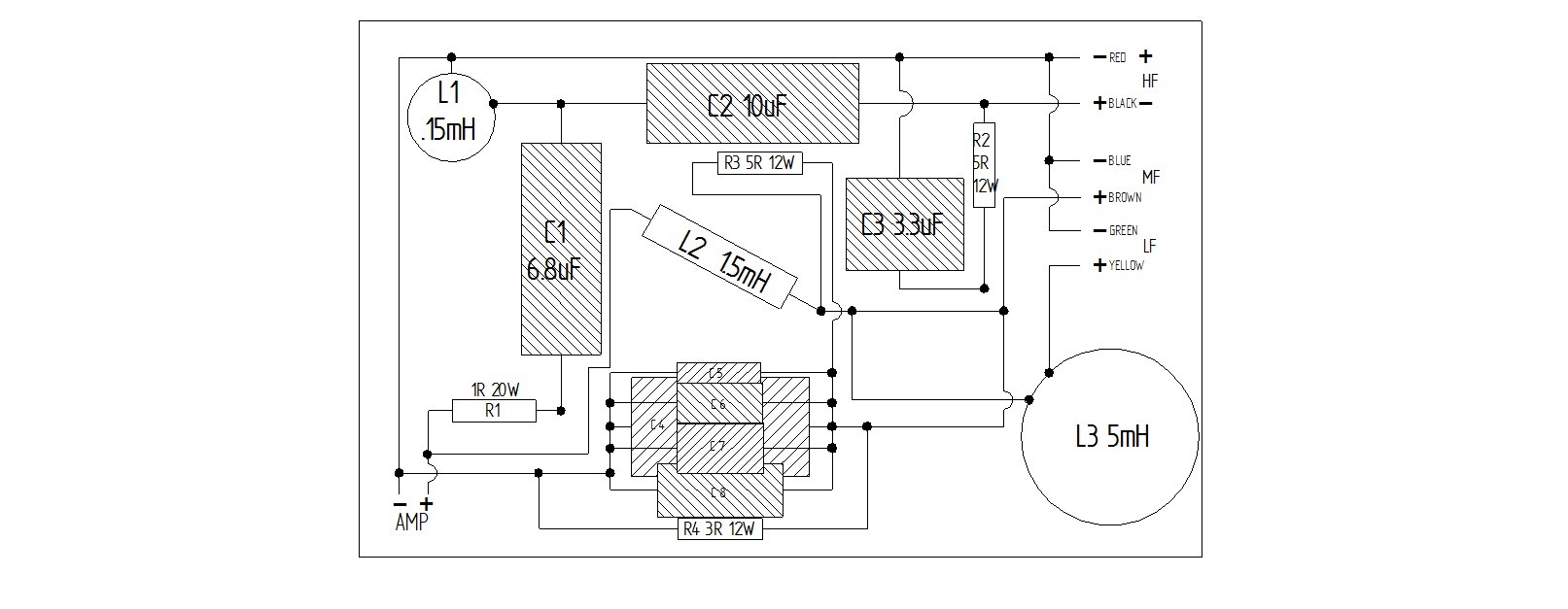

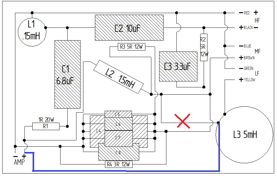

I don't know if you made it intentionally, but the input of the woofer low-pass L3 should be connected to the Amp (+) connector and not on that side of the coil L2 of the Midrange. Basically, in your diagram the woofer sees a higher inductance (6.5mH) and the x-over frequency between WF and Mid is lower. The slope and the level defined by the coil L2 are slightly modified too. See diagram below.
What he's saying is, in your schematic you also have the midrange going thru that 15 mH coil, according to your schematic your midrange wouldn't play much frequency above roughly 100 Hz. Either the schematic isn't correct or you aren't getting any vocals out of your midrange.Your mark ups are not correct. The woofer only gets the sum of L2 and L3.
That makes more sense hahaIt's hard to see but it's 1.5mH. This is a variant on a 2.5 way.
By cascading the two you get closer to 2nd order on the mid and 3rd on the woofer. Eg...
Sorry, got confused by the many schematics of this long thread and I did not notice the original filter topology was a 2.5 way.Your mark ups are not correct. The woofer only gets the sum of L2 and L3.
Caps in the final midrange filter are 5.6, 6.8, 5.1, 2.7 and 1.5 for a total of 21.7uFThat makes more sense haha
