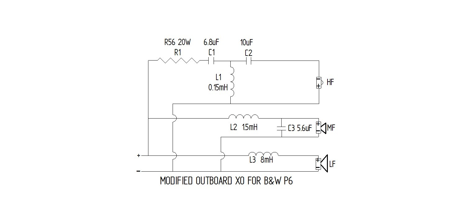

My tweaks include replacing tweeter caps with Obbligato Premiun+ caps, adding a Jantzen 5.6uF Superior Z-cap to the mid range filter and replacing the two iron core inductors with air core inductors. And I will consider adding an R2 to the mid range filter. And R1 is 0.56ohms.What a confusing thread! All is muddled! Here's what I have learned. Because I know B&W quite well.
I'm not convinced R1 at the tweeter input is 5.6R at all. It might be 0.56R! Written R56. It is seven watts for sure. 20W would be for a bass circuit. Measure it!

Well, I looked up the P5 circuit which is all we have really. And did some simming. I doubt if it matters much the precise bass coil arrangements.
But the interesting thing is that adding a 4.7uF shunt capacitor and 1.8R resistor to the bassmid is a well known tweak on B&W 6" Kevlar speakers. Reduces cone breakup around 5kHz. People usually take the tweeter level down too. Because B&W can be a bit showroom bright.

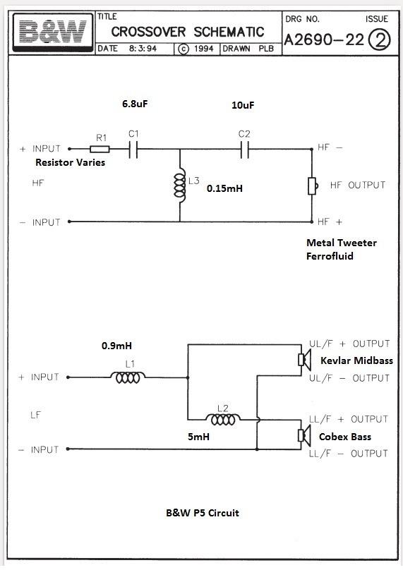

The B&W P5 low pass filter diagram has + from the amp first going to L1 to the mid range and L2 is connected to the + line between L1 and the line to the midrange. So is the woofer seeing the seeing the combined induction values of L1 and L2? In one of the other diagrams + from the amp goes directly to L2 and L1 is connected after L2. Is this woofer seeing just the inductor value of L2.What a confusing thread! All is muddled! Here's what I have learned. Because I know B&W quite well.

I made a mistake in my drawing above, and put L2 on the wrong side of L1. The B&W schematic is correct for P6 (even though the drawing says P5).I have no clue what you are referring to. My question was about potential differences betwen XO diagrams.

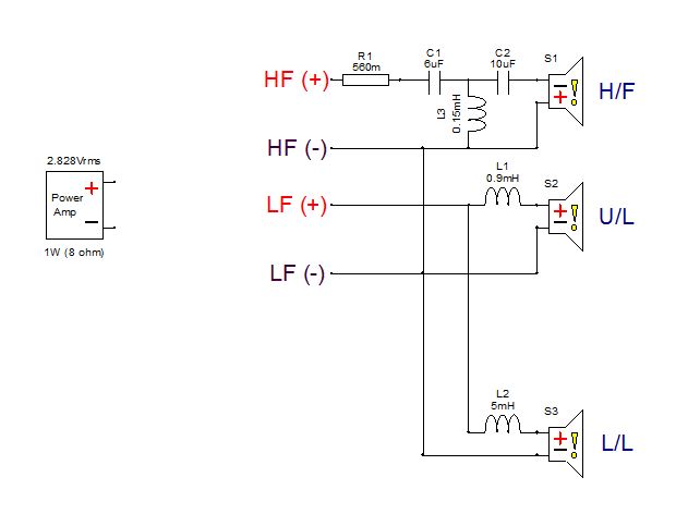

Yes, the inductance is the series sum of the two coils for the lower woofer, which makes the crossover somewhere around 200Hz. Both woofers have a nominal low pass crossover slope of 6dB per octave, however the actual crossover frequency and slope is indeterminate without knowing the drivers' impedance and impulse response.So does the woofer actually see the combined inductance of L1 and L2

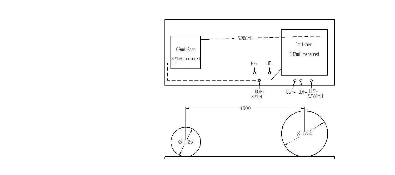

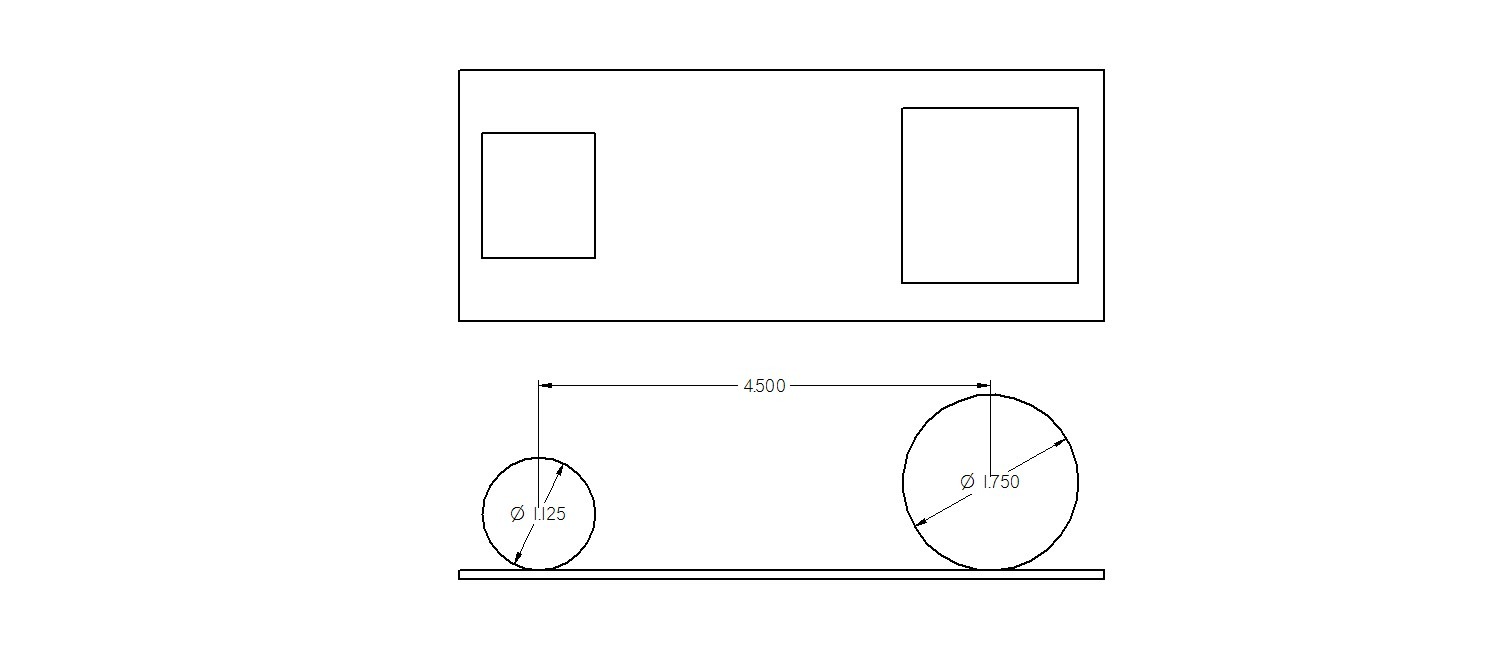

Now I don't know much about electronics but I thought if inductors are connected in series the total inductance of L1 0.9mH + L2 5mh = 5.9 mH. But I also believe the total can vary depending on the position of the two inductors. So the Fe core inductors on the PCB are shown in the sketch. Any idea, based on their positions, of what the sum of the mH value would be?
No, the woofer would roll off faster because the mid connection between the inductors disrupts them. I can arrange a basic demonstration if Henry would like.Both woofers have a nominal low pass crossover slope of 6dB per octave,

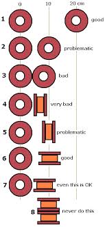

Yes that is true, but not by very much, and the ceramic cores (especially with the discs on the ends of L2) reduce the mutual coupling by an order of magnitude as well. I would expect the effect on inductance values would be irrelevant compared to the normal manufacturing tolerance range of value of the individual inductors.I thought if inductors are connected in series the total inductance of L1 0.9mH + L2 5mh = 5.9 mH. But I also believe the total can vary depending on the position of the two inductors...

I attempted a simple sim of this (without the necessary driver data) and unless I made a mistake the rolloff for the lower woofer approaches 12dB per octave, so AllenB is correct.A demonstration would be helpful
