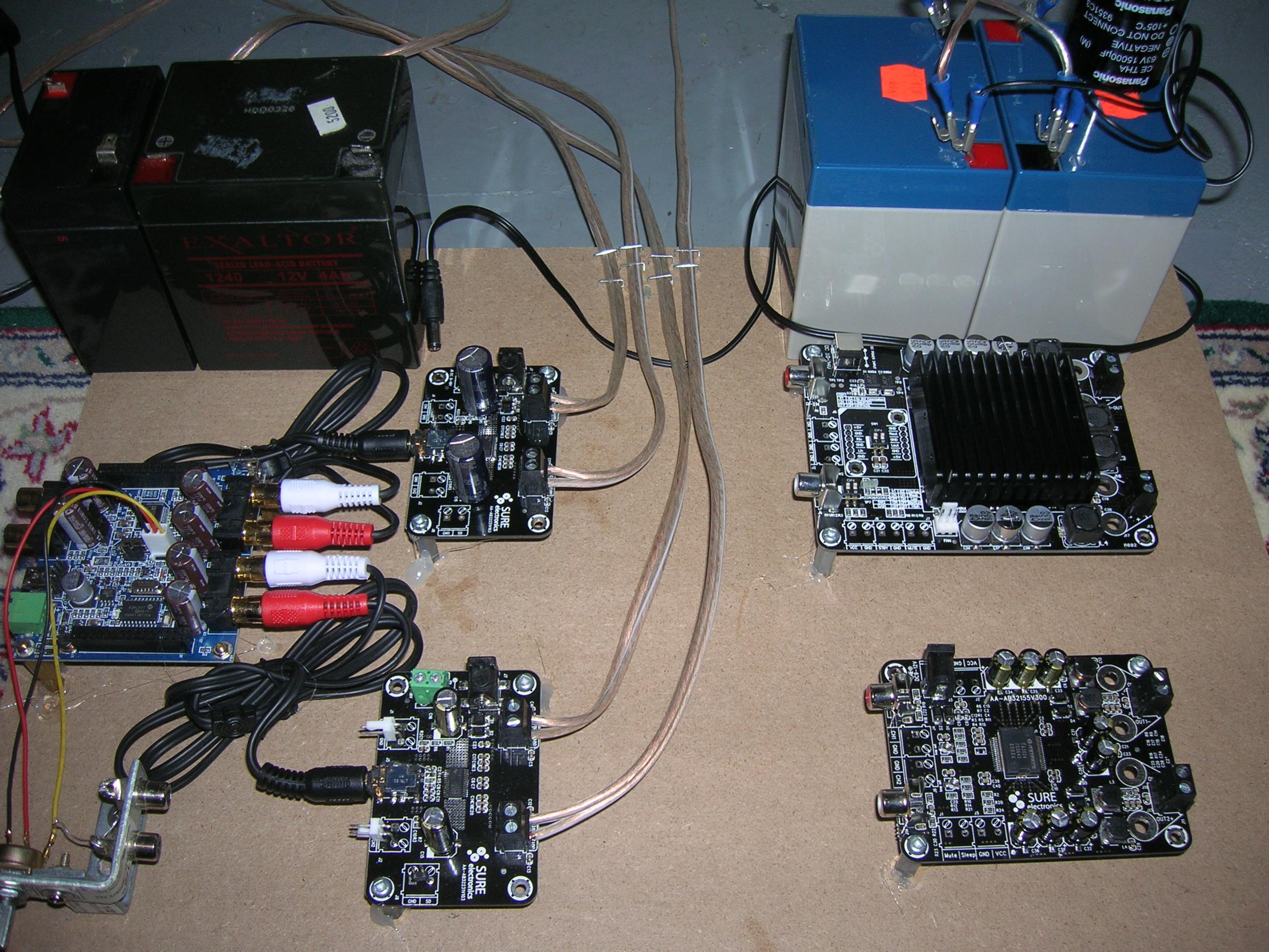

I've been having a ball playing with digital amps ... in fact, I've gone all digital! ... Even in the shed!
Used the 3100 for both amps on my 3 Pis and other set-ups. I replaced the PS caps with Pan FM 470uf/25V and lowered gain for the tweet and used Pan HFQ 1000uF/25V and stock gain for the woof.
Fantastic at low volumes! Crisp and clean.
But ...
I actually found the 3116 worked better for me:
The 3116 were able to transition to medium volume and had better bass control.
Davids and Goliath!
My post on the 3116:
http://www.diyaudio.com/forums/class-d/237086-tpa3116d2-amp-55.html#post3679022
I didn't replace the input coupling caps on the 3100 so ... maybe I'll do that and re-compare.
Piezo = high and rising impedance = possible danger! ... but sounds good so far ...
Other things I found, re: 3100:
-picked up interference from a near-by computer but the 3116 didn't
-output terminals, a little wussy compared to the 3116
But ... I'm not really saying it's 'better' (chill, mu-shu pork) just more suited to low power apps. Get both! and while you're at it get 7297, to keep shmuck happy.
![TPA3100 and DSP.jpg TPA3100 and DSP.jpg](https://www.diyaudio.com/community/data/attachments/342/342514-32a08d3c749ca4c05803cd45c9824cd9.jpg)
But ...

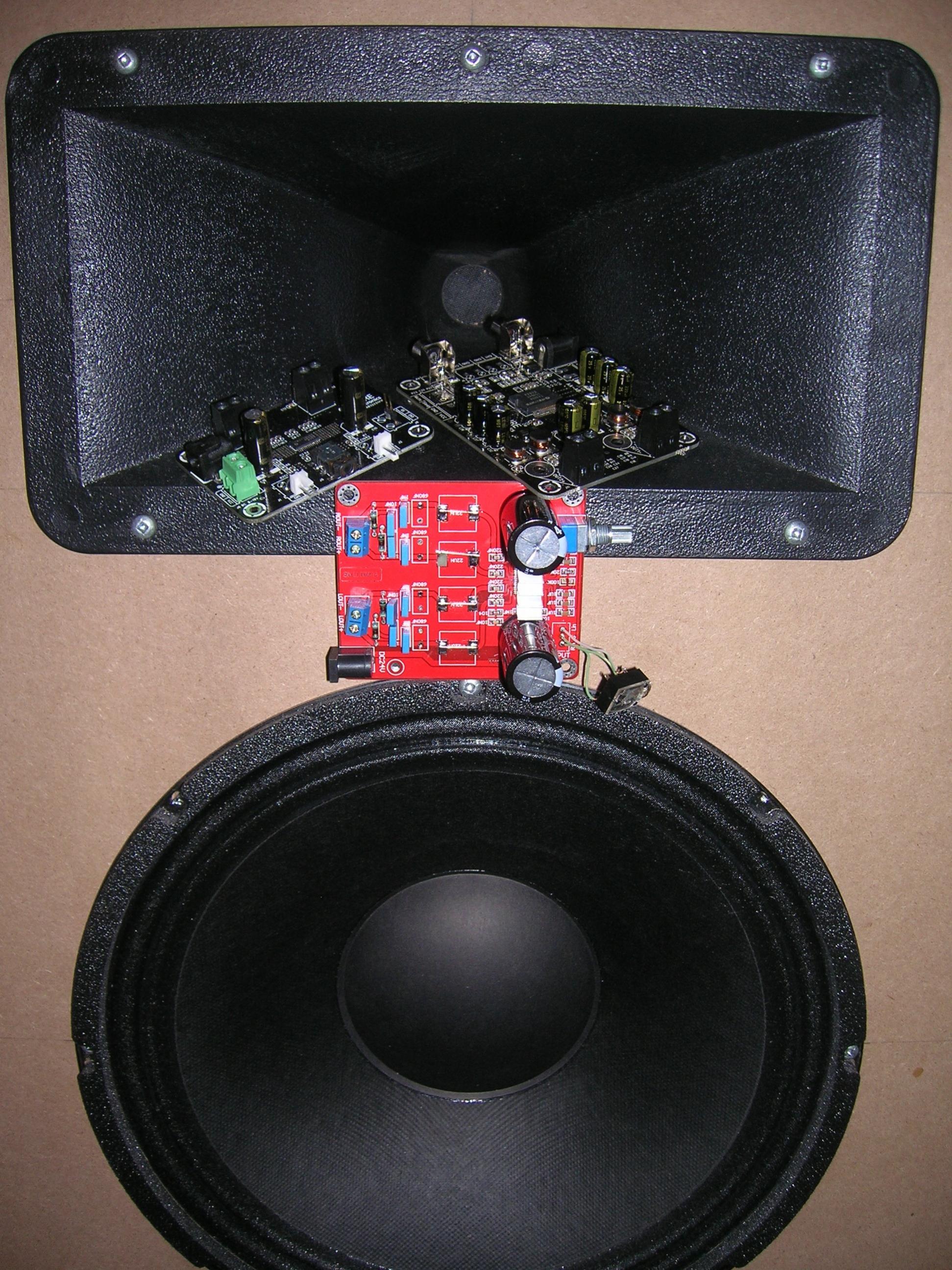

![miniDSP2x4 with digital amps.jpg miniDSP2x4 with digital amps.jpg](https://www.diyaudio.com/community/data/attachments/342/342528-f17bb95bbae8b07fc0870dea8fc58aa2.jpg)

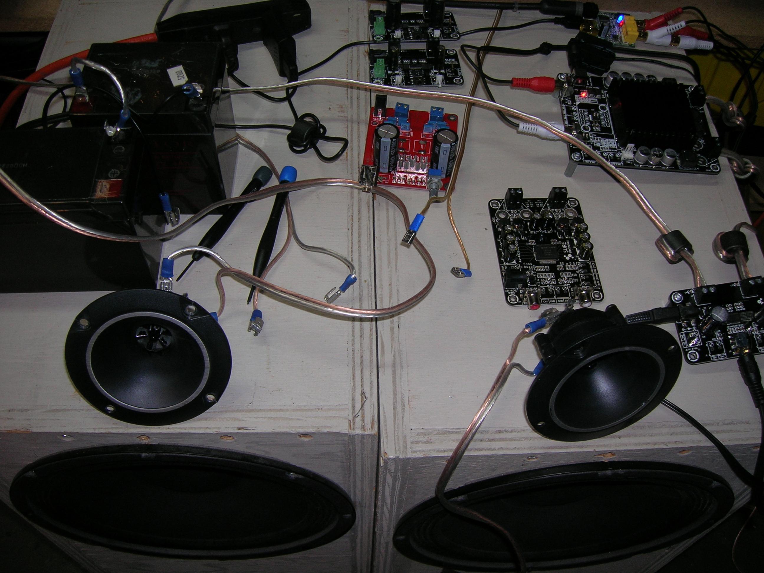

![Davids and Goliath.jpg Davids and Goliath.jpg](https://www.diyaudio.com/community/data/attachments/342/342551-7e2fa9da590a5669f938a0d19b11a5fb.jpg)
Davids and Goliath!
![3100 on piezo.jpg 3100 on piezo.jpg](https://www.diyaudio.com/community/data/attachments/342/342687-bcc8d68457e7f28d70d309031ae1399c.jpg)

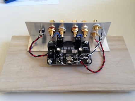

I fabricated a makeshift test chassis using some scrap wood, Aluminum angle stock and better connectors. So then I connected my amp to my iPhone and played some music and the noise went away.
![2013-12-20 15.47.33.jpg 2013-12-20 15.47.33.jpg](https://www.diyaudio.com/community/data/attachments/362/362509-6fa08d199afdc9e4c9097656f839be80.jpg)
![2013-12-20 15.47.50.jpg 2013-12-20 15.47.50.jpg](https://www.diyaudio.com/community/data/attachments/362/362513-5d1b3d48083a382543ba7d27e77c64ef.jpg)

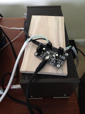

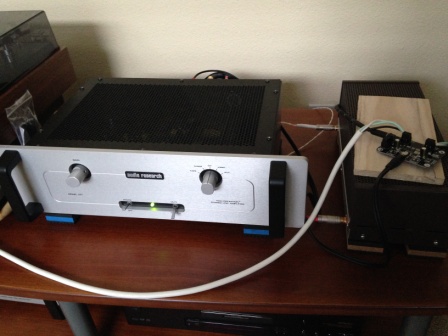

- Anyone have any ideas as to why I am hearing noise with my preamp?
- Is it an impedance-matching issue where I need to add 47kohm resistors between the signal inputs and ground?
- Is it a shielding issue where this amp needs to be in a metal enclosure with shielded hook-up wire to limit RFI emission?
I was able to sort out the noise issue by installing 33kohm resistors between the signal inputs and signal grounds. No more weird RFI and now all I get is room-filling sound. Ideally, I would put in 47kohm resistors, but these were the closest I had in my stash. I may install a 50k Panasonic EVJ volume pot. For now, it sounds great as a power amp paired with my ARC LS7 tube line stage preamp.
