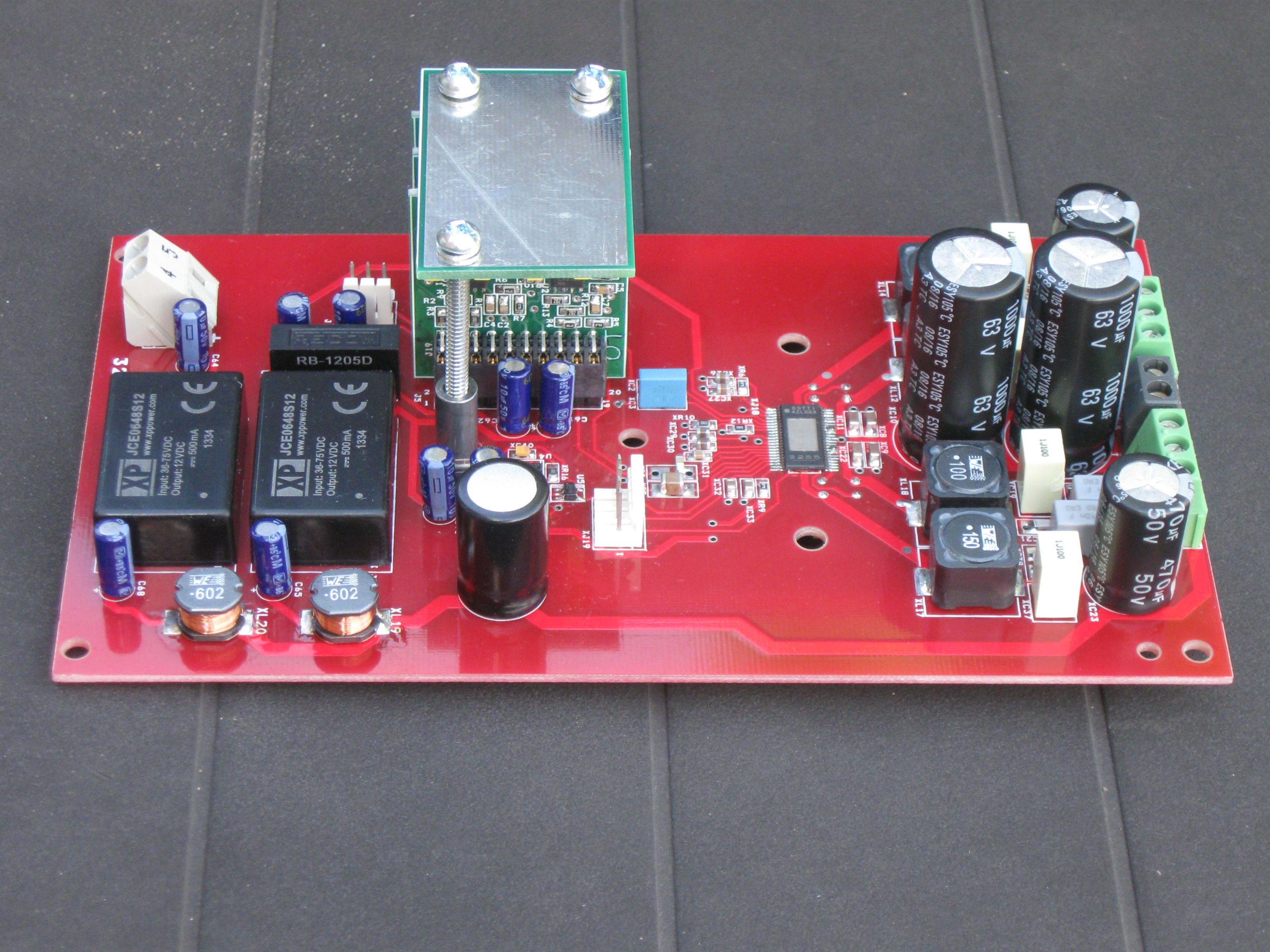

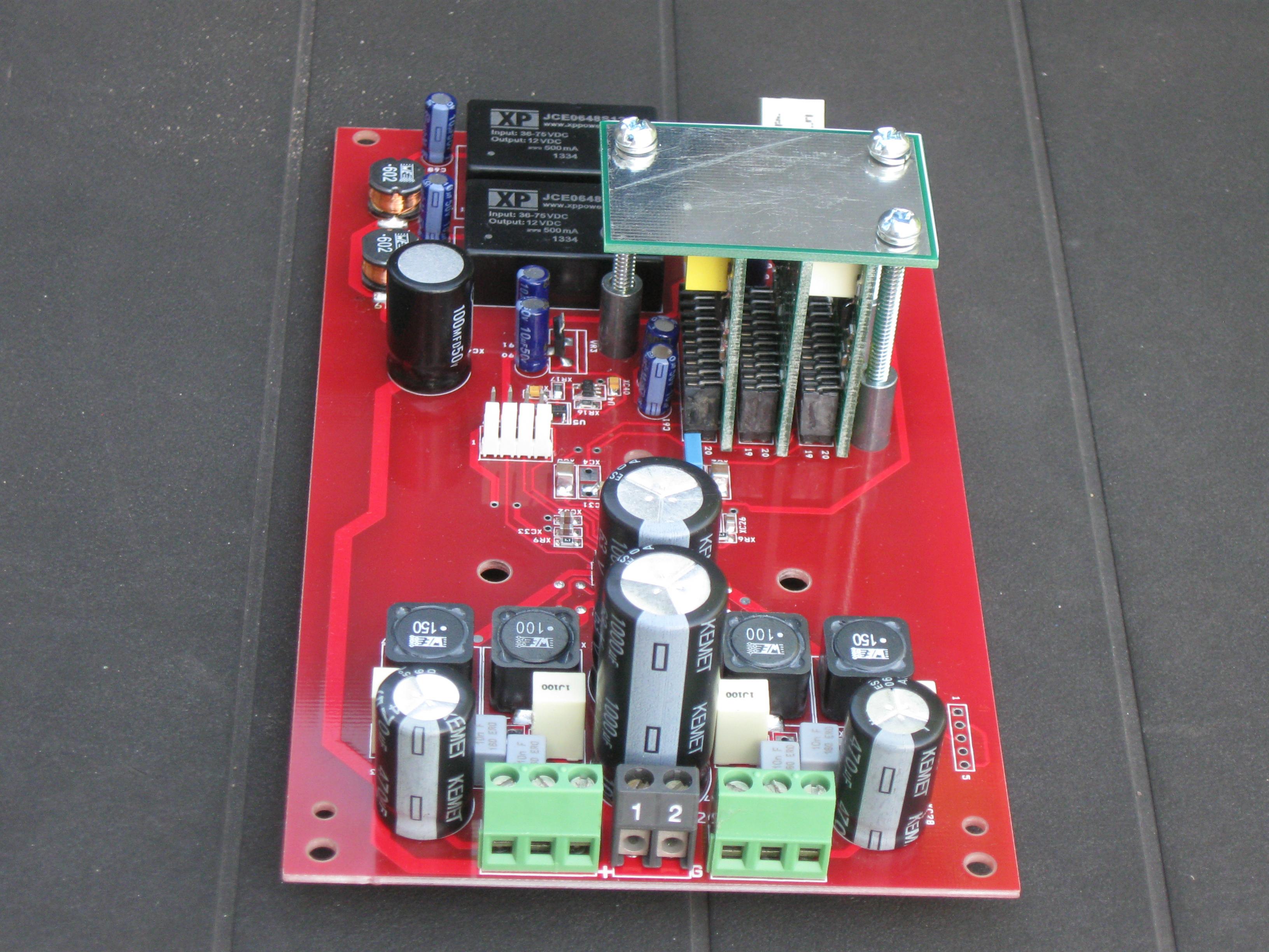

Has someone used these boards in 4 channel mode.

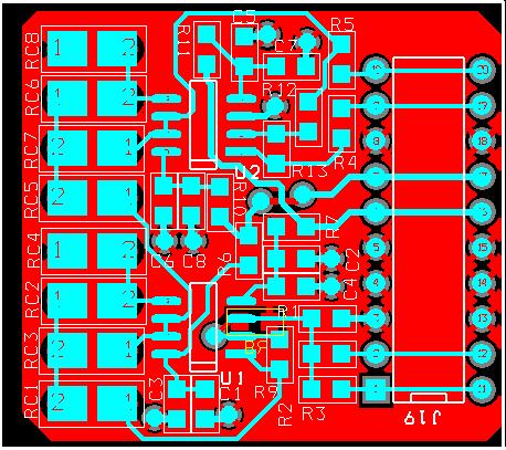

I’m building an active crossover.
BTL for the sub and Se for the mid/tweeter. One channel not used.
Plug in filters. HP for the mid/tweeter, BP for the sub.
Had to use TPA3255 because of 40V supply.
My own board though...a little off topic, sorry.
I'll be using them in 2+1 mode. If you read through the EVM manual, the 4+0 mode is described. Just note that it accepts single ended connections in this mode.
Thank you.
I may just have to find a way of acquiring two boards.
Though it’s good to know I can use it in 4+0
