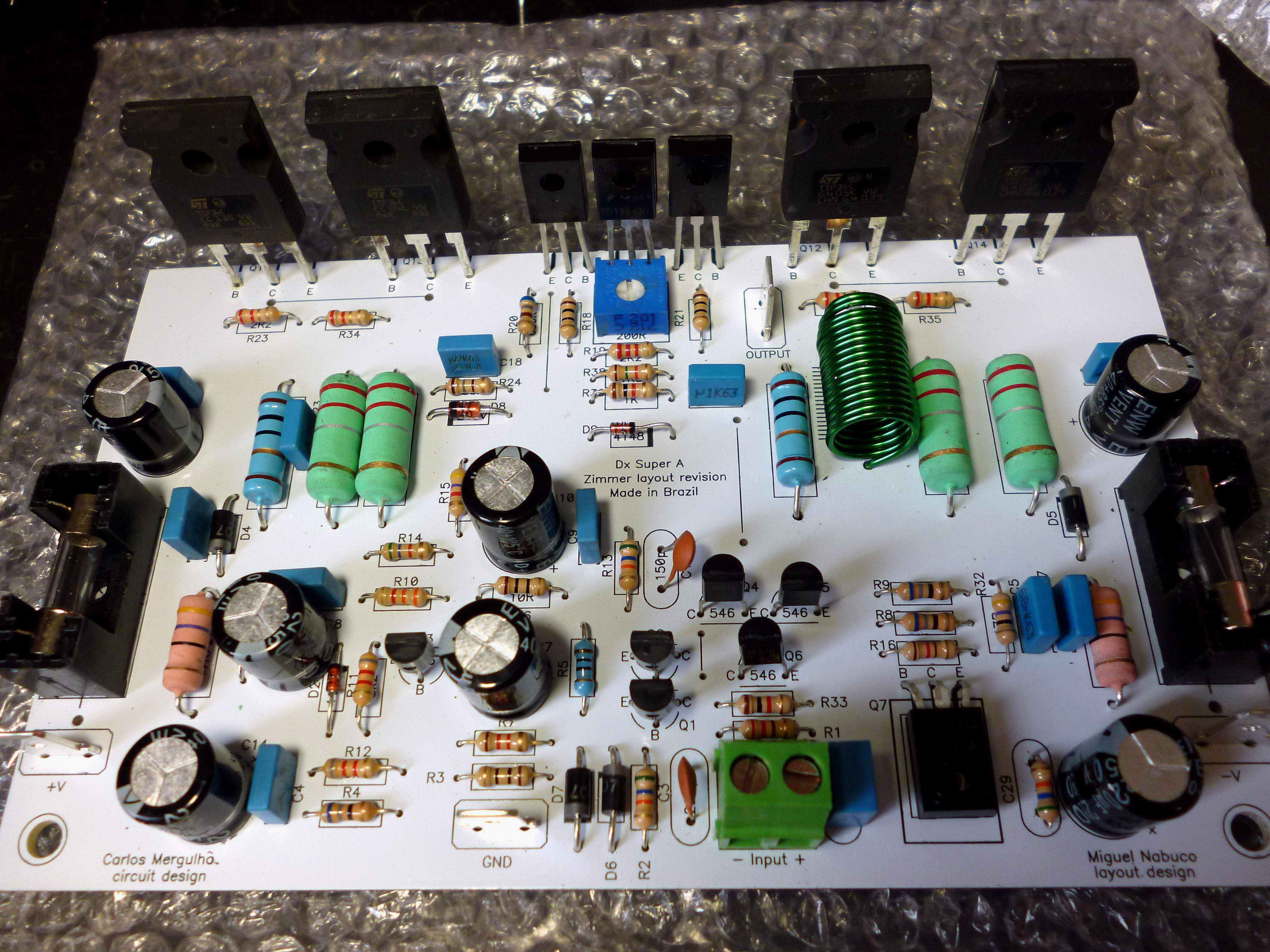

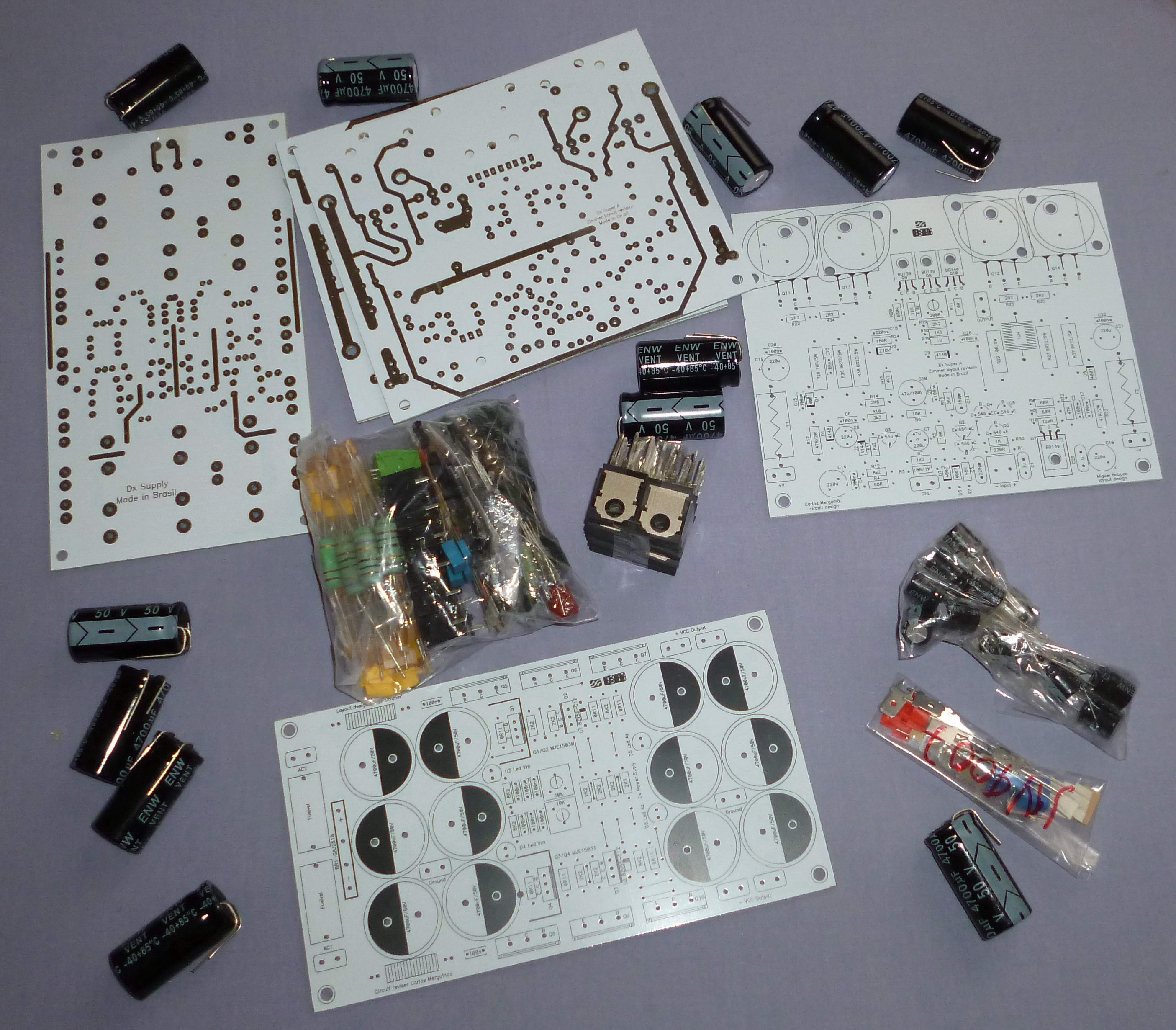

We are using them in Brazil...hundreds of kits spread in my country
The big trouble is the derated power at 70 degrées celsius...... this is the power you should understand as safe.... the problem, the weak point of this device, is the power dissipation.
Watch graphics and calculate your stuff considering derated maximum safe operational conditions.
We are using them in our Brazilian kits because they are cheap, easy to find and not so bad...... problem is power dissipation...you should manage to reduce supply voltage and adjust you power amplifier parameters to use them inside the S.O.A. ..... and as i have said..... dissipation derated to 70 degrées is the power you may use as reference.
regards,
Carlos

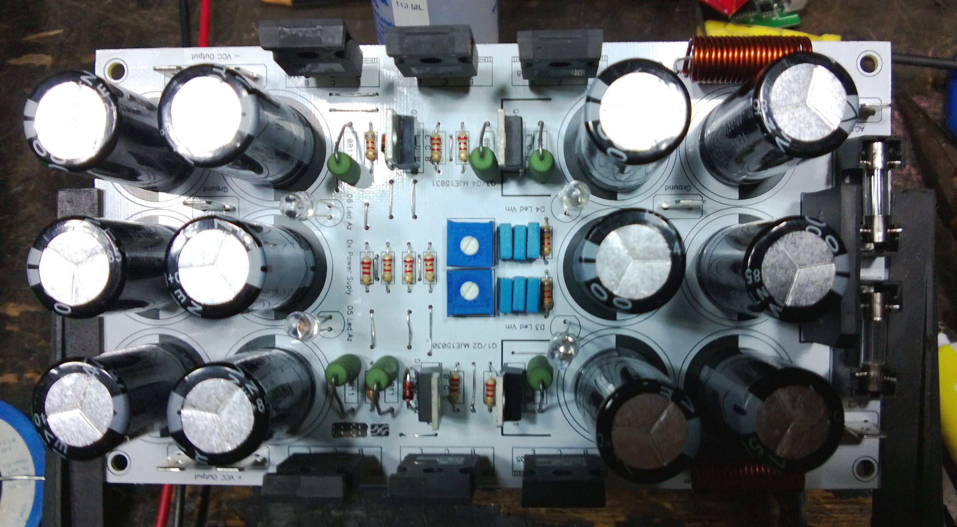

Here you see them in use
We are not accepting orders from foreign countries due we do not trust in our postal system now a days....in the future this may change, as in the past we had a very good service from them.
Joseph Siejack, from Canadá may order a hundred units..... Duda will come to Brasil and will get the package and after return to U.S. he will send pcboards to Joseph Siejack (Evette in this forum).
We do not think it is a very good transistor...we are using them because available in Brasil, easy to find and cheap...but we think there are much better choices.... MJL23194 and MJL21194 are a hell unstable devices (tested!) ... i have asked my people not to use them to avoid loose the guarantee.
regards,
Carlos

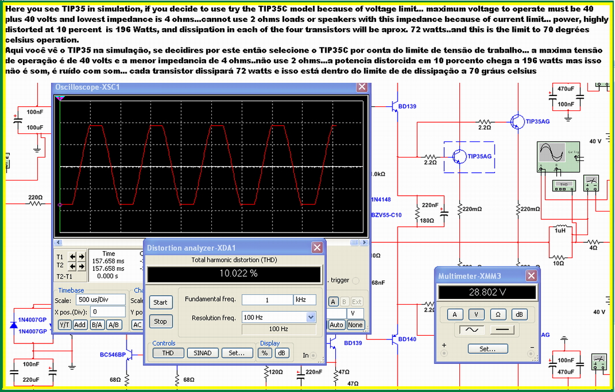

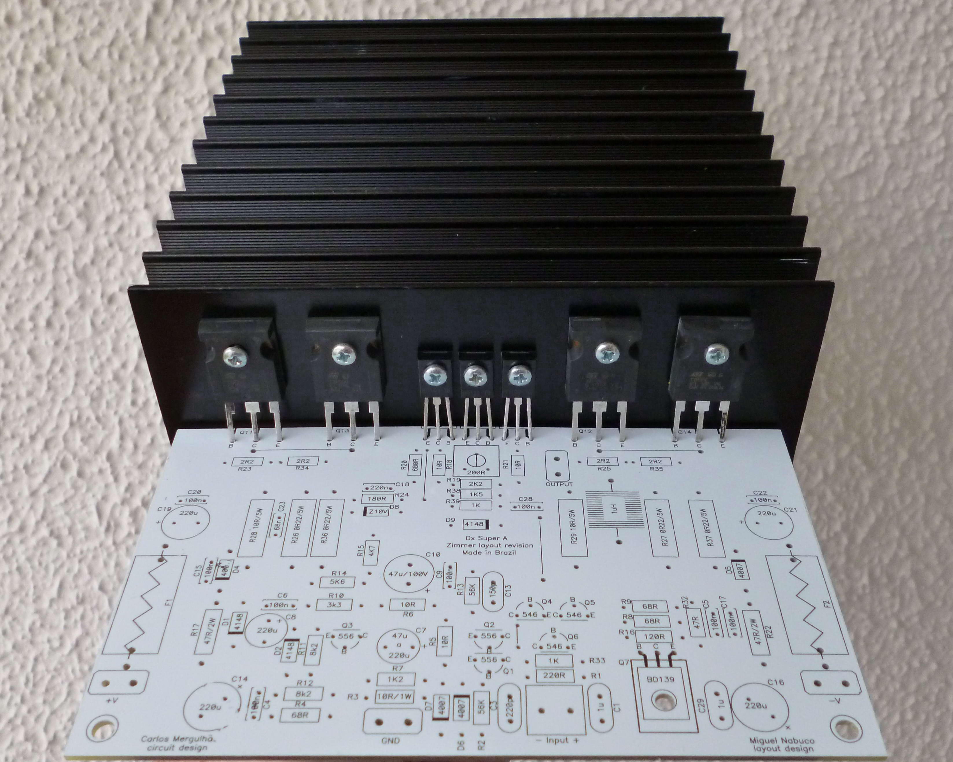

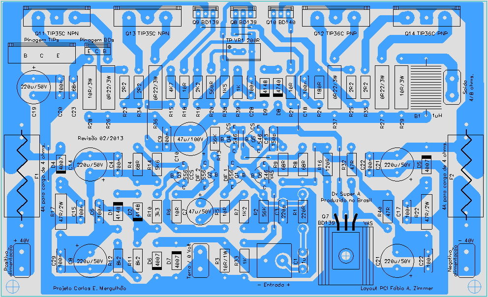

We have even reduced the supply voltage to 40 volts because of TIP35/36
To keep these transistors safe..also it is not suggested to use 2 ohms loads..when the original design was powered with 42 volts and able to face 2 ohms loads..... it could reach 350 watts RMS

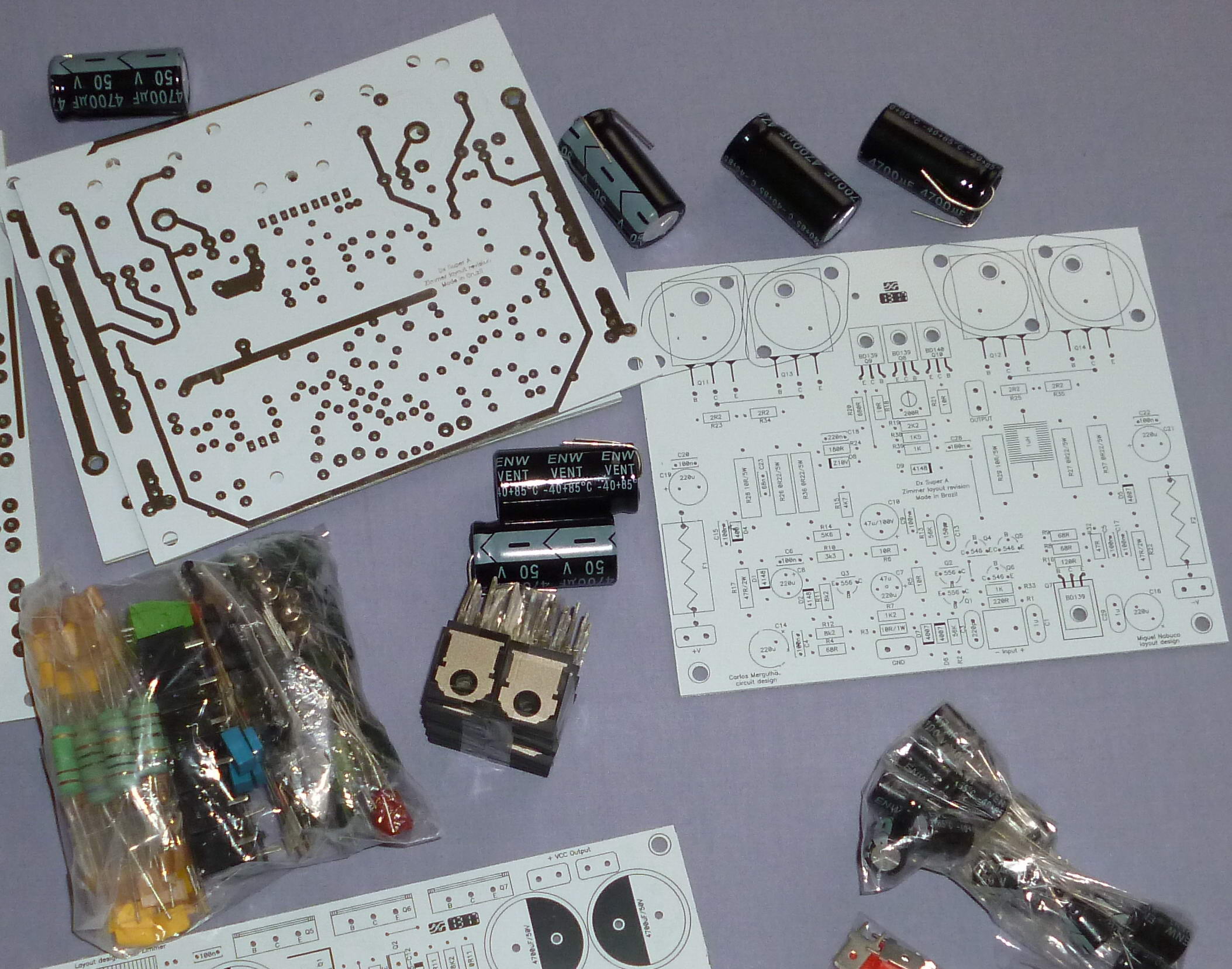

You see the new pcboard layout.... to Brazil only (sorry)
regards,
Carlos

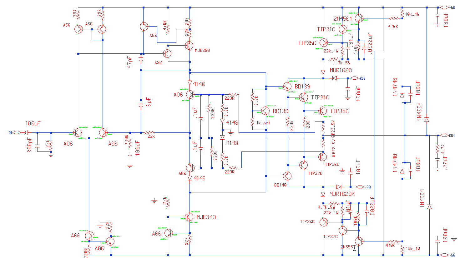

Actually, I'm working on a little project - how to build a Real Amplifier using TIP35/36. Over 100W/8R without breaking the bank on semi's, transformer, heat sink, or caps. More to come when it's more than vapor.
The point of the exercise is all about the power stage (where the money is). I'm still deciding on the front end - whether to go op-amp, dual differential, blameless, or current feedback. Of course the choice needs to be made with the cheapskate in mind.... any votes?
Might do a variant with TIP142/147 darlingtons - just to say it can be done. I think discretes will offer better performance and won't cost a cent more if you use cheap (TIP31) drivers.

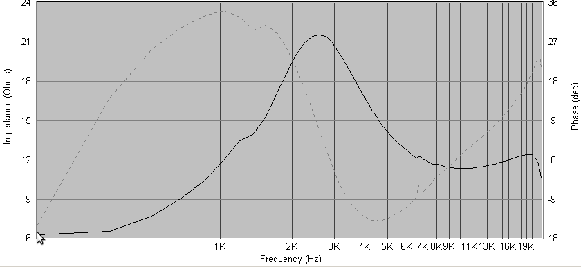

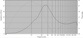

Current is highest at Zmin. Phase hits zero at impedance maximum or minimum. Phase is usually worst case somewhere in between a minimum and a maximum. Your chart doesn't look too bad - but the real worst case phase might be in the bass where you have no data. It's not uncommon to hit 60 or 70 degrees just above the box resonance peak - especially with high Qms woofers in vented boxes where acosutic stuffing is not used. It won't be at an impedance minimum, but it may still be below the "nominal" impedance of the speaker/driver. This may be the worst case, if not for dissipation, at least for SOA.
