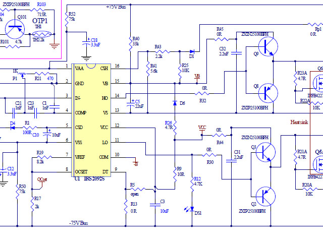

I spent some time over lunch drafting a first schematic, however there are some inconsistencies between the IRS2092 datasheet (http://www.irf.com/product-info/datasheets/data/irs2092.pdf), the AN-1138 application note for the IRS2092 (http://www.irf.com/technical-info/appnotes/an-1138.pdf) and the schematics of the various demo boards. For example IRAUDAMP9 (http://www.irf.com/technical-info/refdesigns/iraudamp9.pdf).

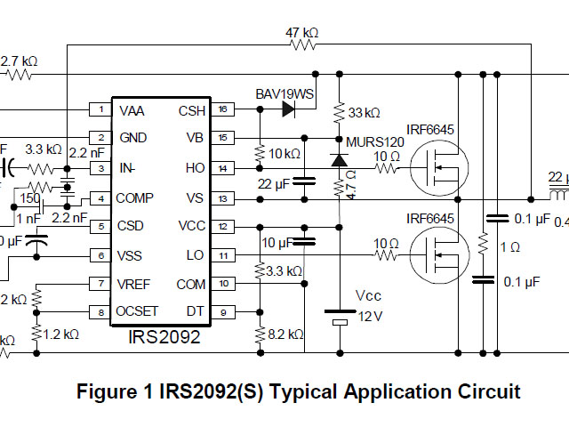

Most of these inconsistencies have to do with the MOSFET gate drive configuration. For example the typical application circuit in the AN-1138 application note (page 2) shows the CSH pin (16) connected to the positive rail via a BAV19 diode and the VB pin (15) connected to the positive rail with a resistor as shown below and a resistor between the CSH (16) and HO (14) pins:

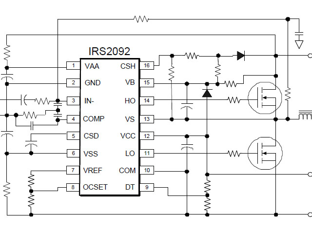

However the IRS2092 datasheet (page 1) shows a different configuration, with the CSH pin (16) connected to the positive rail with a resistor AND a diode and two resistors between the HO pin (14) and the CSH pin (16) as shown below:

The IRAUDAMP9 demo board schematic then shows something which is different again. The HO pin (14) is not connected to the positive rail in any way and the VB pin (15) and CSH pin (16) are now connected through two resistors (R25, R43).

Hence we now have three variations of how to wire the IRS2092 into a schematic and the datasheet and the application note, nor the demo board documentation lists any reason as to why these pins are wired differently.
Is this application specific? A way to prevent current sharing between pins perhaps? Are they all correct?

For some reason the images in my post #47 have stopped showing, here's the images again in the order they should appear.
AN-1138 - application note schematic
attachment.php
IRS2092 datasheet - principal schematic
attachment.php
IRAUDAMP9 demo board - schematic detail

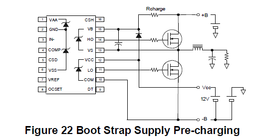

CSH is measuring Vds voltage when High side is on.
In figure attached, D1 is reverse blocking diode which blocks high voltages into CSH pin when high side is off.
It is forward biased through R1. Since HO == VB when high side is on, R1 can be attached to either HO or VB.
CSH is internally fixed at 1.2V, so R2 and R3 voltage divider is used to program the high side OCP into higher threshold.
Resistor connected to pos rail and VB is required for bootstrap capacitor charging at startup.
So all schem are correct.
1. In AN1138 schem, High side OCP trip is being set at default VDS = 1.2V. CSH monitors I * Rdson. 33k resistor is startup bootstrap charger.
2. In IRS2092 Datasheet, a voltage divider is added at CSH, which will set the OCP threshold higher depending on the resistor values. Bootstrap resistor is missing.
3. IRAUDAMP9 schem is the same as #2. Also has resistor R26 which slows down charging of bootstrap cap. R40 is startup bootstrap charger.

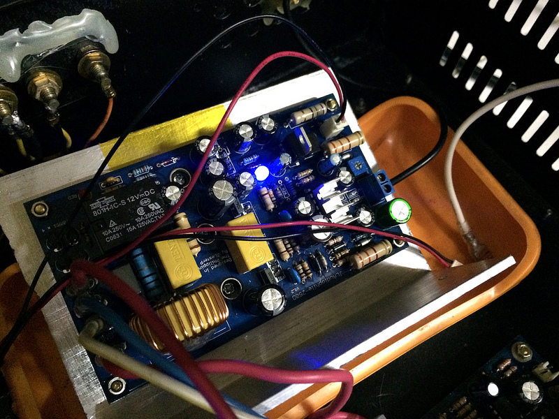

Can't provide detailed measurements 😱
At idle condition 270kHz, left for more than an hour, chassis closed,
IRS2092 with DIP heatsink stays at 48deg C, Inductor around 42deg. What bothers me is the bootstrap cap, I'm using 47u 63V low leakage, it is hotter than IRS2092. Though it is rated at 105deg at 2000hr.
Zobel resistor and inductor heats up when operating frequency is lower than 300khz.
4227 is as hot as TIP31C VCC regulator. Heatsink is 40 deg celsius.
At 55V DC rails, module power consumption is only 7W 🙂

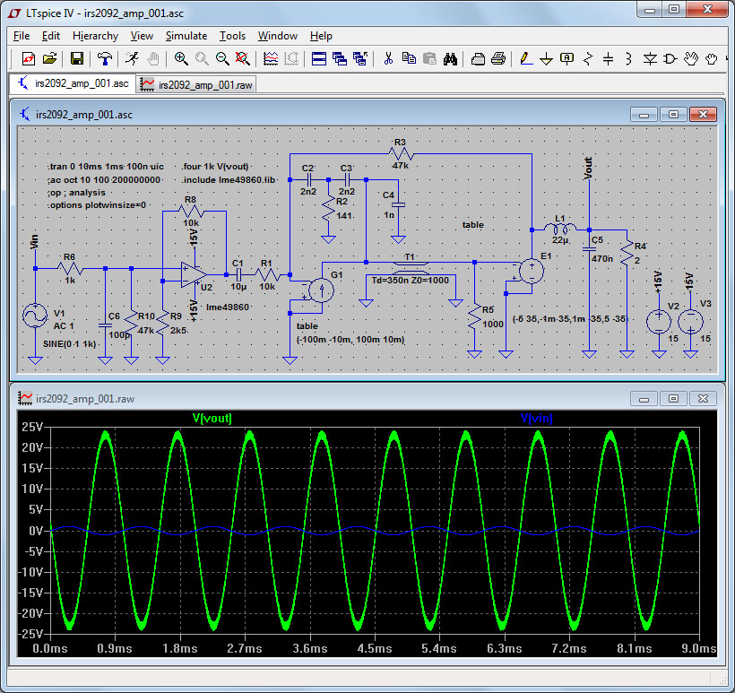

@jlester87,
Thanks for the insightful reply. I hadn't thought about that yet, but after looking over the application note in greater detail once more it is indeed as you described. I had not gotten around to calculating these resistor values yet, hence I didn't read that part of the datasheet in enough detail.
I was a bit of a slow afternoon at work, so I figured I'd throw together a quick simulation of the schematic I posted earlier. This is just to look at loop gain etc. as the switching behavior or the MOSFETs etc. are obviously not modeled.

Some details from the output stage drive circuits you posted:
- Image from post 48 is missing, I was not able to see the schematic.
- The pull-up resistor that biases high side current limiting (10k in some sch) is shown connected to VB in some examples and to HO in others. Connection to HO is more efficient and has no drawbacks. Connection to VB requires lower value (VB-VS) charge resistor(s). For the current limiting thresholds I recommend leaving room in PCB for dividers, 2 resistors, although one of the resistors may not be needed.
- Using a single resistor to charge (VB-VS) implies that a speaker load must be connected, or the amplifier may not start. Turn-on pop is increased. My approach is to add a second resistor from VS to VCC, this allows starting with no load.
