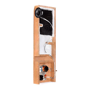

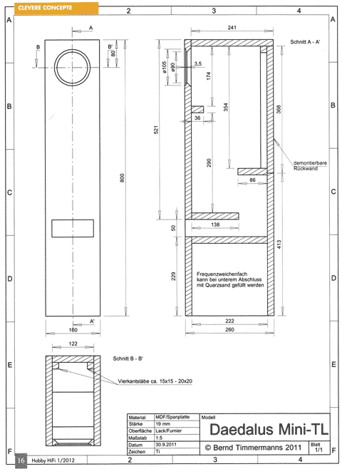

I'm going for a mini-tower. 4ish feet tall.

How about the Daedalus Mini-TL, floorstanding speaker in Hobby HiFi 1/2012 (fill the bottom with sand, etc)
https://www.lautsprechershop.de/hifi/daedalus_mini_tl.htm
compare the Visaton B80 vs Dynavox LY302
https://www.parts-express.com/Visaton-B80-3.3-HiFi-Full-Range-Driver-8-Ohm-292-660
