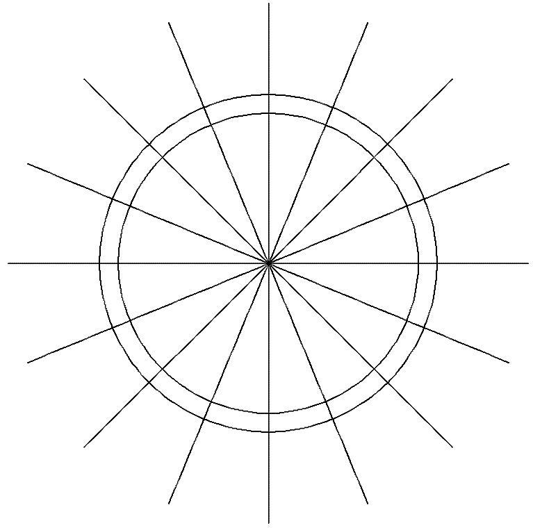

For the 11.25 degree angle, I'm going to use Sch3mat1c's idea for that by using a little board and some lines which are drawn using a regular polygon, something akin to what Faustian was talking about.

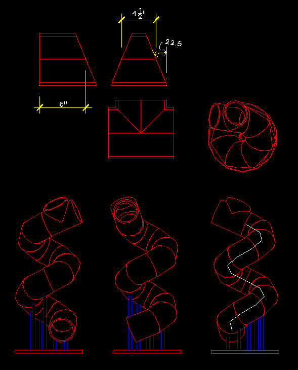

a little insight into the modelmaking process. i built it basically exactly the same way the pieces would be assembled in reality: piece by piece. i didn't use any formulae for laying out the spiral; i just stuck each piece together and rotated. you'll just have to trust me that the dimensions i noted are correct.
so yes, if you build it according to my scheme, it will look pretty much like the drawings. i didn't do any 'fudging'.
and i'm pretty sure the overall form will look very similar if you use the rotated cut method as well. i hope that method works for you because it will look better at the joints.
now, as for the base connection piece...that's a bit more complicated. as you noted, the bottom piece is neither parallel nor perpendicular with the ground, which would have made things easier. i'll have a go at determining an angle to cut the last 'wedge' that will allow for mounting a true vertical base piece. the trick is to get the center of gravity more-or-less over the base, for stability. you will still need to attach the base piece to a heavy base, because otherwise the whole spiral will be prone to toppling once you mount the driver.

I'm sure your modeling process is accurate.. have you looked at it to scale... relative to the thickness of the pipe? If you take a piece of 2 inch scheadual 40 pvc and join two sections cut at 22.25 degrees.. you can twist them 11 degrees and still make contact on all edges.. though that contact will be skimpy at some points. What if you take a 6 inch sceadual pipe and do the same thing? The thickness of the pipe does not increase proportionately with the increasing diameter.. I suspect that the pipe will not make contact at all points..
Aparently this issue is resolved by making each cut with the pipe rotated by 11 degrees. Which brings up another problem.. how to line up the pipe for the cut in the first place .. here is a easy solution.. the first cut for each piece is of no particular consequence.. cut it any orientation that you like.. the next cut needs to be oriented at 11 degrees to the first... place a cut piece of pipe in your jig rotated 191 degrees to your intended cut.. then just line your work piece up against the end of the first piece and make your next cut.. but then... I could be wrong..

i took a closer look at the joints using 'my' scheme. if doing the rotated cut doesn't work out for you, i think my scheme's joints will be okay, if a little rough-looking.
at the smallest overlap, they still seem to have about 1/4" coverage. i.e. about 1/16" projecting on each side. i think that's enough to offer structural integrity, although i can't say what it does for the sound. probably negligible effect.

Man, that is a GREAT diagram. What software are you using?

if i'm not mistaken, FOR THE END PIECE ONLY i think the long side is 7.5" and the short side is 4.5". a 3" difference...so if you need to add length, keep that in mind.
all the dimensions should still be valid, even for the rotated cut. (because the key dimension is 4.5" down the center of the wedge piece...that doesn't change no matter how much you rotate the pieces.)

Here's how I plan to do it: measure and cut the end segment at 7.5" to the 4.5" mark for the 22.5 degree angle.
The second and succeeding segments follow thus: I measure 7.5" along the longest point, the 1.5" along the shortest part. Then, instead of cutting there, I'll turn the pipe 11.25 degrees and "slide" the marks over, which effectively changes the actual outside lengths, but, as I understand it, retains the 4.5" inside length.
Therefore, 2-dimensionally, the segments will each still be 7.5" and 1.5" long, respectively. The difference is the 3-dimensional orientation. See pic.
Any objections?
Dave
