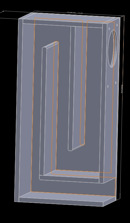

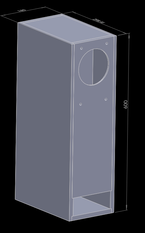

I am hoping to put two W5-2143's in TL boxes. My design is very simple (I am not very keen on the intensely theoretical aspects of TL design, shoot me now), and I have drawn it up in Solidworks, with some simple variables that drive the design so that it can be modified for different sizes of drivers and line lengths. Basically, the calculations take the Sd of the driver and a user selected taper factor and use them to size a three fold design. The baffles are straight, but each successive fold is a bit smaller. (I have an earlier version with angled baffles). The cross section of the line is then driven by the Sd and the desired width of the box, and tapers from an area equal to the Sd times the taper factor (I usually use 1.5) down to an area equal to the Sd at the port. Then the design contains a sensor that measures the line length, and I adjust the height of the box manually to get the line length I want, which I usually match to 1/4 wave length of the Fs of the driver.
See screenshots 1 and 2 attached, I am interested in what anyone thinks about this approach to TL design, is it too simple, or might I be lucky on occasion and get a great sounding design out of this?

I haven't time to do a proper check at this minute (give me an hour or so). However, I suspect you'll end up with a relatively low tuned line without a great deal of gain (output) due to the restricted cross section. The CSA of a TL has no connection to driver Sd and in general, designs that use Sd as a basis for the line CSA end up having too small a volume to produce decent output, especially if you tune to Fs. Line resonant frequency is also a function of axial length and taper, not just axial length.
You might get lucky on occasion designing like this -the thing is, those occasions usually tend to be rare; and more likely with drivers that have a very low Vas for a given Q, Fs.

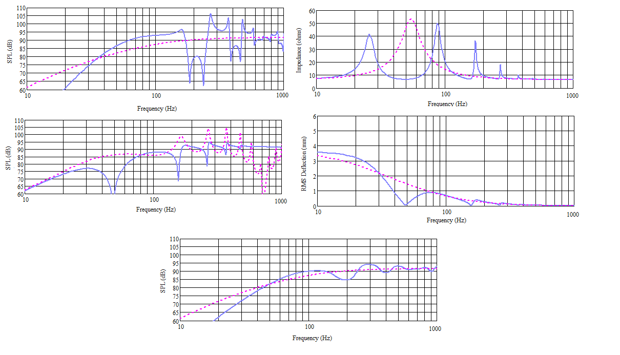

The attached is roughly what you'd get from the given line length, taper & CSA. Plots are undamped, apart from the lower, which is assuming lagged walls.
If you want a suggestion for a starting point (please do not take this as a finished design) you could try this: 35in line axial length, with 12:1 taper. Driver offset 11.75in from the sealed end. St = 564cm^2 (87.42in^2). That will put you tuned to ~Fs, & with the top, back & one sidewall lagged, will be more or less maximally flat under anechoic conditions.

Hi there, your approach in designing transmission lines is closer to guess work than anything - first of all there are 2 ways of doing it - the theoretical way (based on known things such as formulas, rules of thumb etc), 99.99% of the time this is how you design an enclosure, the other way would be by practical method, by building several enclosures (or an adjustable enclosure) to see what happens, your method is not based on either.
TL are designed based on desired frequency response (and size concerns of the owner, and sometimes impulse response) based on the main TS parameters - Qts, Fs and Vas; I don't have the formulas immediately available to see which one influences what but here the simple version: the smaller the Qts (under 0.4 values) the less you get from your larger than bass reflex enclosure choice; Vas gives you the internal volume (larger Vas = larger enclosure, not Sd!); Fs and Qts will give desired tuning frequency / steepness of response bellow tuning. Ideal Qts for TL in therm of output is 0.5-0.6.
Other important observations: a constant cross section TL will have a simple formula to determine tuning frecv. but if the geometry is expanding or contracting the same formula is no longer valid; a contracting geometry will have a shorter line length for same tuning (don't think 0.5%, it may be 30%). Very important - TL are tolerant with variation in internal volume, a 10% variation sounds about the same, there is room for error. Another thing you have to know and understand about TL is the driver offset technique, when you place the driver at a position lower on the line, maximum is 33% from the closed end of the line; this will smooth out the response by controlling the other resonant frequencies (harmonics) of the pipe; the key spots are 20% offset and 33% offset, but you get similar results in between. Look at the graphs attached by Scottmoose - they don't look smooth, do they? because the driver is a the end of the line. In practice you might want to back off a little with internal volume to compensate for room gain etc etc.
As far as W5 2143 is concerned it's a driver that has low Qts (might wan't to measure it, it's not that simple in this case, measures done by others don't confirm Qts from published specs) and is not going to be particularly bassy but might need unexpectedly low internal volume - check this enclosure design from Bjohanessen - https://www.diyaudio.com/forums/full-range/88787-tabaq-tl-tang-band-223.html#post5606346 (https://www.diyaudio.com/forums/att...1542654890-tabaq-tl-tang-band-w5-2143-sim-pdf)
