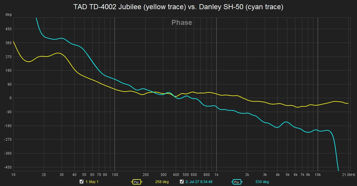

I think a portion of the effect that Danley reports is phase fidelity of the loudspeaker, i.e., getting the loudspeaker's phase response substantially flattened. If you look at the phase response of typical direct radiating loudspeakers not using DSP crossovers, the phase growth from 100 Hz to 20 kHz is typically 900-- 1400 degrees...or more (as reported by Toole).
I experienced this image deepening effect as part of the "subconscious auditory effect" of linear phase loudspeakers that also control their polar coverage angles down to the Schroeder frequency of the listening room. Here is a link to the thread where I first reported the rather startling subconscious effects of getting the phase flattened and corresponding excess group delay controlled above 100 ms using a pair of slightly modified Klipsch Jubilees (original edition):
https://community.klipsch.com/index...speakers/page/3/&tab=comments#comment-2379562
The yellow trace, measured using REW in my listening room at 1m, is shown below as compared to a Danley SH-50 (cyan trace)
I also lowered the K-402 horns 8" (20 cm) to get the 450 Hz crossover point well within 1/2 to 1 wavelength. What I experienced was large jump in the perceived depth of stereo images (and 5.2 array imaging), along with a dramatic increased perception of deep bass response/ naturalness and elimination of perceived harshness, as reported in the linked thread.
So there are several effects of cleaning up the phase and SPL response (which together are also called the "transfer function response"), along with substantially co-located drivers (within 1/2 wavelength of the Jubilee and 1/4 wavelength at the center K-402-MEH), and controlling early reflections via full-range horns down to ~100 Hz (about the Schroeder frequency of my listening room).
