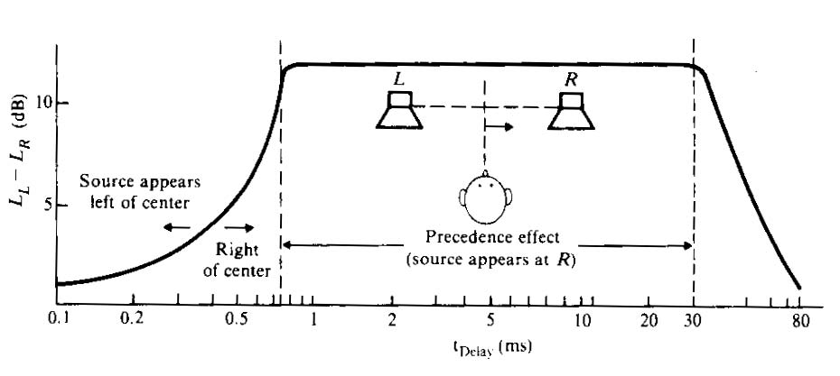

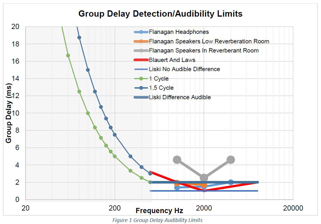

So the effect that Tom is apparently talking about is the psychoacoustic effect dealing with very short delays (he mentions "...on the order of two inches..."), which correspond to the regime of time delays less than 0.7 milliseconds, as shown in the figure below. This corresponds to acoustic delays of physically less separation than 8-10 inches. The figure below illustrates this as a distinct psychoacoustic effect from the precedence effect (a.k.a., Haas effect):
Dual source time delays less than 8-10 inches apart from the listener (in distance or time) produce a perceived localization of sound that moves to between the two sources of sound, with the latter sound source delayed by less than 0.7 ms. This is what Tom is talking about in terms of in-ear cancellations that combine to give hearing cues to source distance/delay. Only one sound is perceived (just like the precedence effect) but the perceived source of the sound is moved to a position between the two sources, very unlike the precedence effect (longer delays between sources greater than 0.7 ms) in which the sound source is localized to the position of the first source arrivals.
So there are two psychoacoustic effects in play that affect our perception of distance, one at less than 8 inches of (time-based) separation, the other at greater than 8-10 inches of (time-based) separation.
In multiway loudspeakers using multiple horn apertures or drivers separated vertically and horizontally on a flat baffle, there is another effect on stereo imaging that is related to a phase difference (time-based separation) of 1.0 to 1.5 wavelengths:
For typical tweeter-midrange crossover frequencies that are used in loudspeakers --crossing typically at 4-6 kHz, the physical separation (time misalignments) of 0.25 ms (0..00025 seconds) to 0.16 ms (0.00016 seconds) are audible. For even higher frequencies approaching the limit of human hearing, the phase-based time delays are even shorter.
So for perceived distance perception, the human hearing system seems to be less sensitive to estimating distance to the sources than in the case two-source phase separation due to crossed multiway loudspeakers, as much as 10x less sensitive.
In my own experience, once the loudspeaker drivers are within 1/4 wavelength at the crossover frequency interference band in x,y,z space (i.e., including depth) as they are in a time aligned MEH (such as Danley produces), they will appear as a single source to the human hearing system as close as putting your head inside the aperture of the horn mouth.
When you think about the physical size of multiway loudspeaker drivers mounted on a flat baffle (i.e., multiple drivers physically separated--not coaxial), there is no way to achieve time alignment off-axis of perpendicular to the plane of a flat loudspeaker baffle. The more off-axis you go, the greater the time misalignments.
