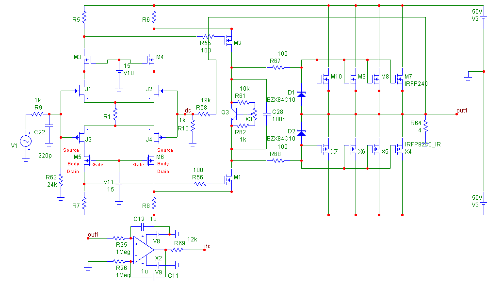

Here is why it will not work well without source resistors. Let's look at Vgs = 4.5V and Vds > 10V. In that case, the drain current is:
For temperature = 25 Celsius, it is Ids = 0.6A.
For temperature = 150 Celsius, it is Ids = 25A.
That is not a reduction in current with increased temperature!
All the parallelled transistors have the same Vgs so the hottest one will work harder than the others. Drawing a load line and pointing at it is nonsense. It is current sharing that is the problem, nothing to do with the load line.
However, the BUZ9** transistors you mention on your page do not have this problem. They can be parallelled just fine without resistors.
Exactly.
It is impossible to support IRF240/9240 design by making reference to properties of lateral BUZ devices.

Federman, please post somewhere .cir data for your "amplifier"

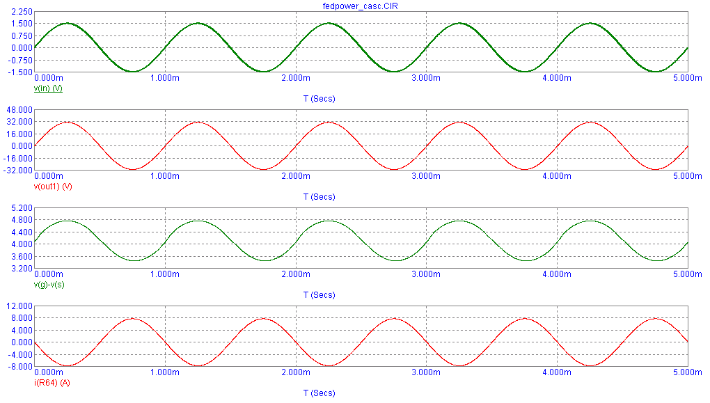

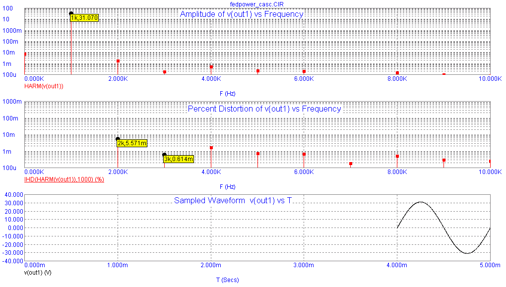

By the time we are waiting for the data, I have implemented the discussed output stage into another amplifier, which I believe can be used for evaluation of the output stage behaviour. First, let's normal operating conditions.
Supply voltage ± 91V. Sizes of resting currents
Burden 4Ω
Burden 2Ω
Burden 1Ω
Burden 100mΩ
Burden 10mΩ

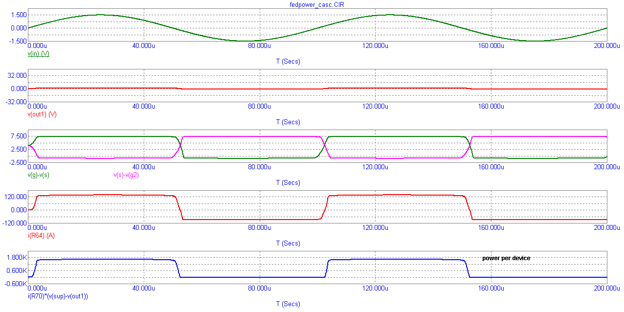

Burden 4Ω
Burden 2Ω
Burden 1Ω
Burden 100mΩ
Burden 10mΩ

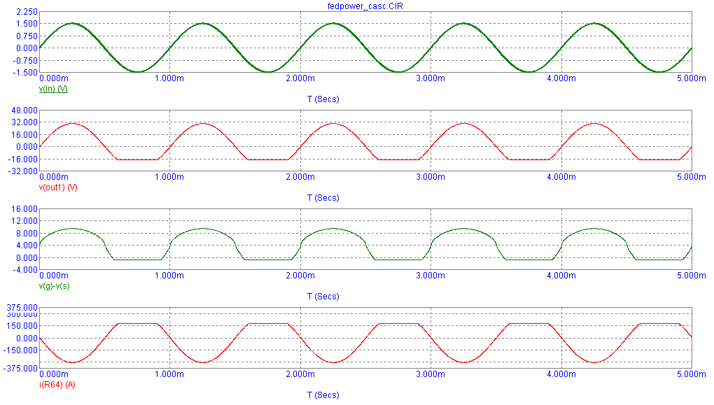

I wonder if it is possible to make it so and to keep both linearity and protection. I am saying IT IS NOT.
I agree; it is NOT possible.
Overcurrent "protection" is one mistake, showed frequency compensation second.. It will be for sure power oscilator (for short time before explosion), slow output stage and "fast" input and VAS without local compensation closed in global NFB..Unrealistic. We have to wait for measured results.

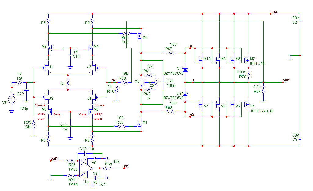

To explain a bit. 5 years ago I posted a thread
http://www.diyaudio.com/forums/solid-state/40543-new-error-correction-amp.html
This thread described MOSFET output stage with error correction. The output devices were Hitachi 2SK413/2SJ118, similar to IRF range of devices rather than to laterals. The circuit operated pretty good, with one exception - the error correction acted as current limitation as well. It did not enable dVgs of both output MOSFETs above some level. It was fine, until the dVgs limit was reached - then horrible current limitation appeared, with terrible sound effect.
There is a similarity in the design discussed here. dVgs must be let to find appropriate level according to drive and output voltage. It cannot be used as a current 'protection'. It is impossible to achieve this goal without loosing linearity and rated power.
The current protection must be done in a different way. Also, it was proven in this thread, that hexfet MOSFETs cannot be paralleled without source resistors. These are 2 basic technical issues of Federman's design.
