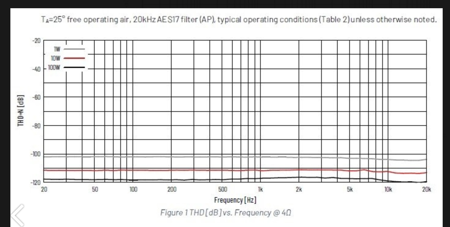

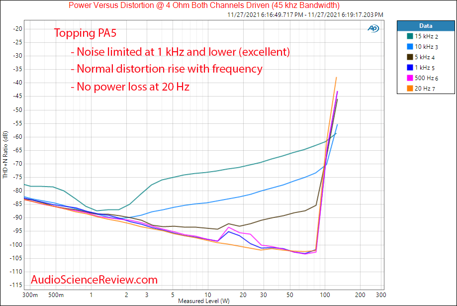

what do you mean by ‘overshadowing the Purifi’? ASR measurements showed that distortion rises fast with frequency. Unfortunately they stopped measuring the CCIF spectrum (eg 18+19kHz 1:1). In this test, 1ET400 has side bands suppressed down at the -120dB level which is better than for AHB2. The ASR SINAD is simply THD+N at 1kHz, 5W - that measures only noise for good amps.

This is what everyone should be focusing on. High end amps don’t do this.

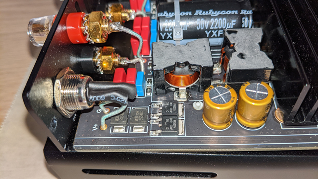

The pictures have been shared by a member of ASR

I spoke to Audiophonics and I ve been told that Topping sanded all the inscriptions on their main components to to protect their design. In the end I find it a bit of a shame ... because the most expert users are able to guess with the pictures...
The inductors are probably the :
CoilCraft SER2915H-103KL
or
Wurth 7443630700
The same used by XRK Audio and 360 Customs

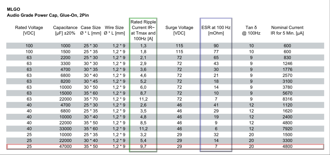

Topping PA5 -> audiophile tweaks
Maybe
Rubycon 50V 2200uf -> Mundorf MLGO 63V 2200 / 3300 uF

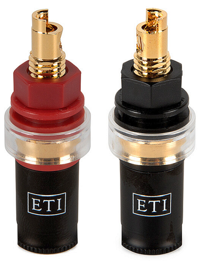

Binding posts -> ETI Research Binding Post BP-20C, Neutrik speakON or direct connect (wire).
This is the graph that lends credence to the idea that it's actually a composite amp wrapped around the TPA3255. If you look at the Neurochrome charts, their composite amps also degrade at higher frequencies (although not quite to this degree) as you run out of loop gain. IF (and it's still to be verified from what I can tell) they have in fact made such a composite amp, I think it's a pretty interesting achievement.
Kept in context, I'd still say the performance is a notable achievement. Sure, this isn't something I'd choose over a Purifi, or even a Neurochrome, but in terms of off-the-shelf turnkey amps at anything close to the pricepoint, it's clearly a great performer.

What are the redactions in your pictures?
It looks ike someone has purposely sanded off the top of the inductors, I wonde why?
That’s just thermal paste residue on the TPA chip.
‘does not blush’ - agree with that. A fine little amp with very good value.
Interesting that Amir wrote ‘normal rise with frequency’ - it is not uncommon but definitely not desired…
