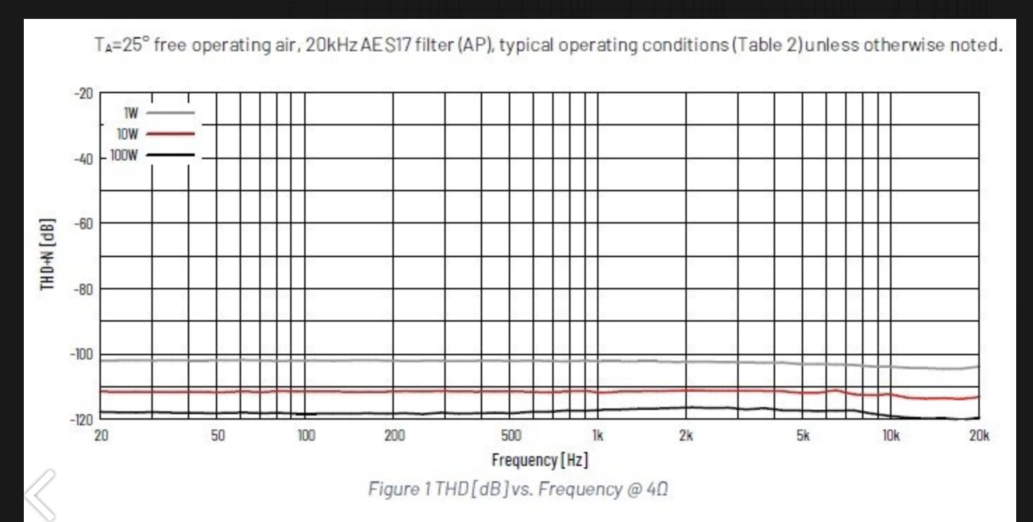

This is the graph that lends credence to the idea that it's actually a composite amp wrapped around the TPA3255. If you look at the Neurochrome charts, their composite amps also degrade at higher frequencies (although not quite to this degree) as you run out of loop gain. IF (and it's still to be verified from what I can tell) they have in fact made such a composite amp, I think it's a pretty interesting achievement.
Kept in context, I'd still say the performance is a notable achievement. Sure, this isn't something I'd choose over a Purifi, or even a Neurochrome, but in terms of off-the-shelf turnkey amps at anything close to the pricepoint, it's clearly a great performer.

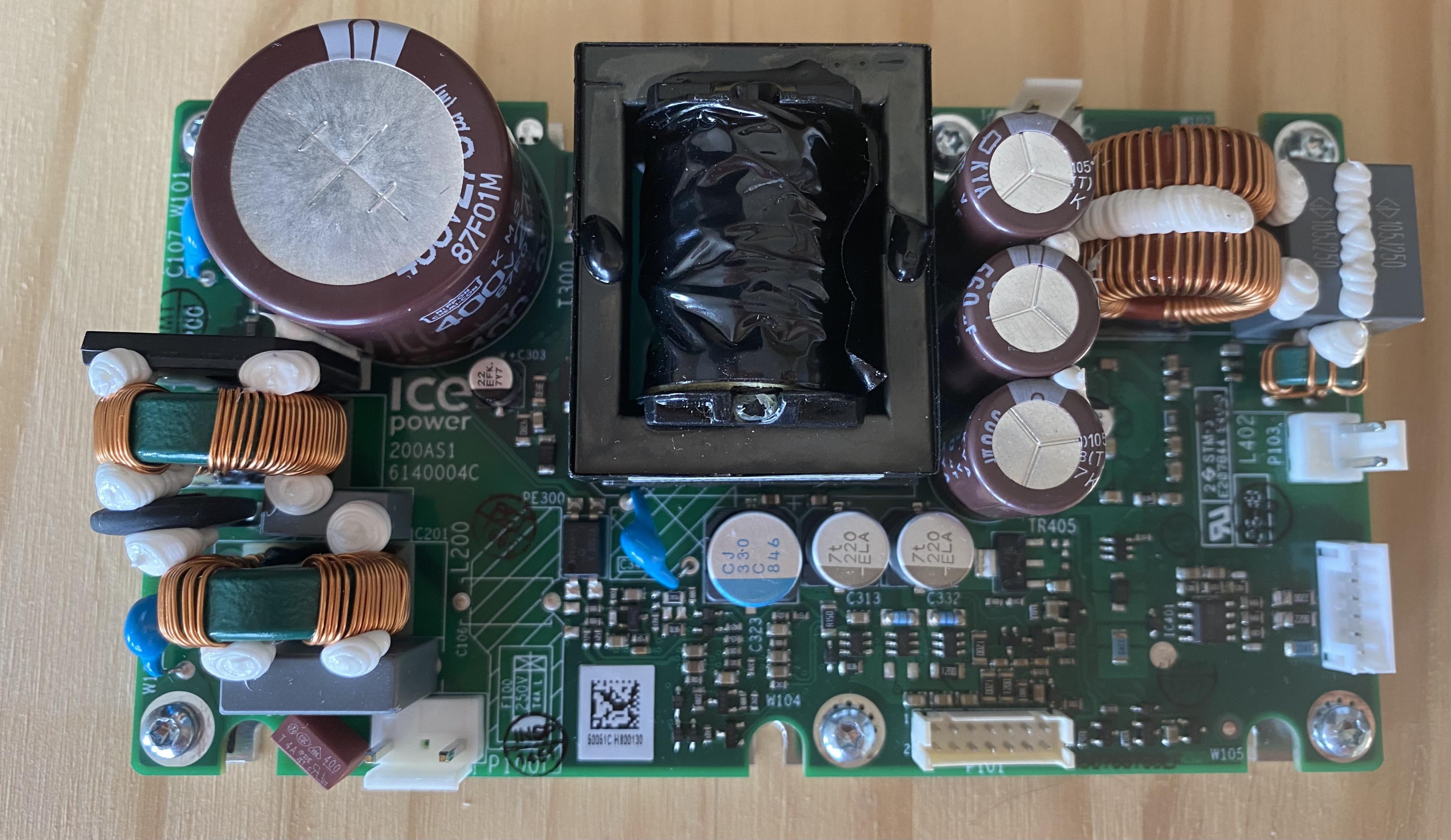

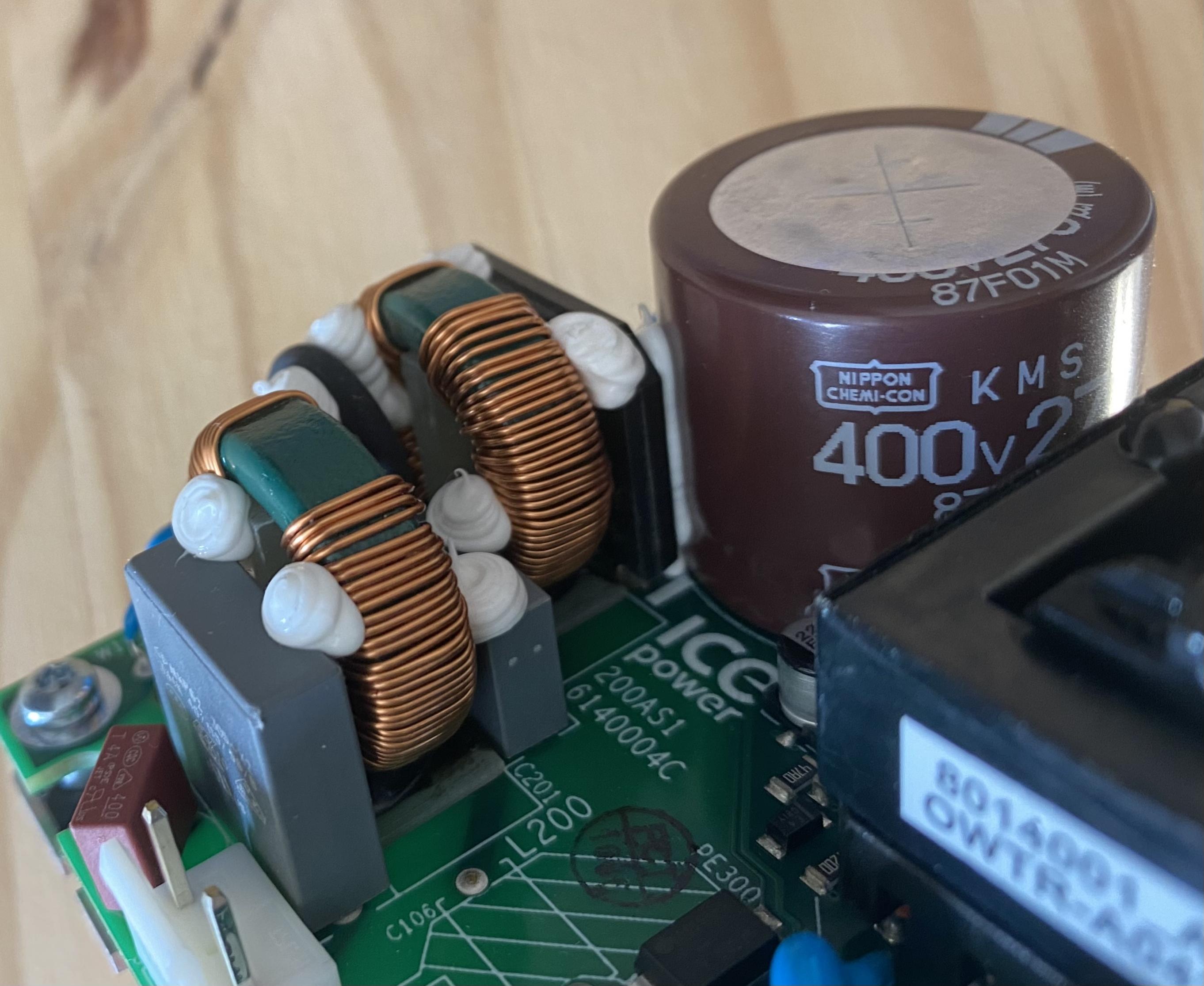

Yes it’s slightly better than the $35 TPA3251 based Icepower 100AS2 module. Only the Icepower module uses much nicer parts, and a much cleaner board layout. Pictures of the TPA3255 based 200as1. Same power supply and PCB as the 100AS1 and 100AS2.

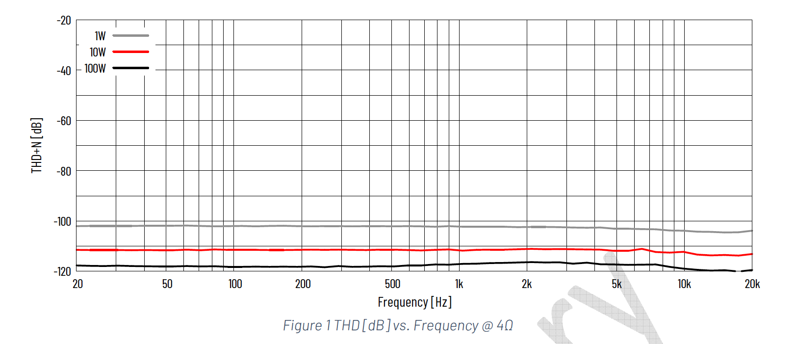

If it was fair he would focus on the shortcomings, rather than downplay them and hype up what matters little, the 5w 1khz SINAD. If he was fair the de facto standard to judge amps would not be 5w 1khz SINAD, it would be THD+N vs power vs frequency over a 20-20k bandwidth. much like Purifi uses in their data sheet.
